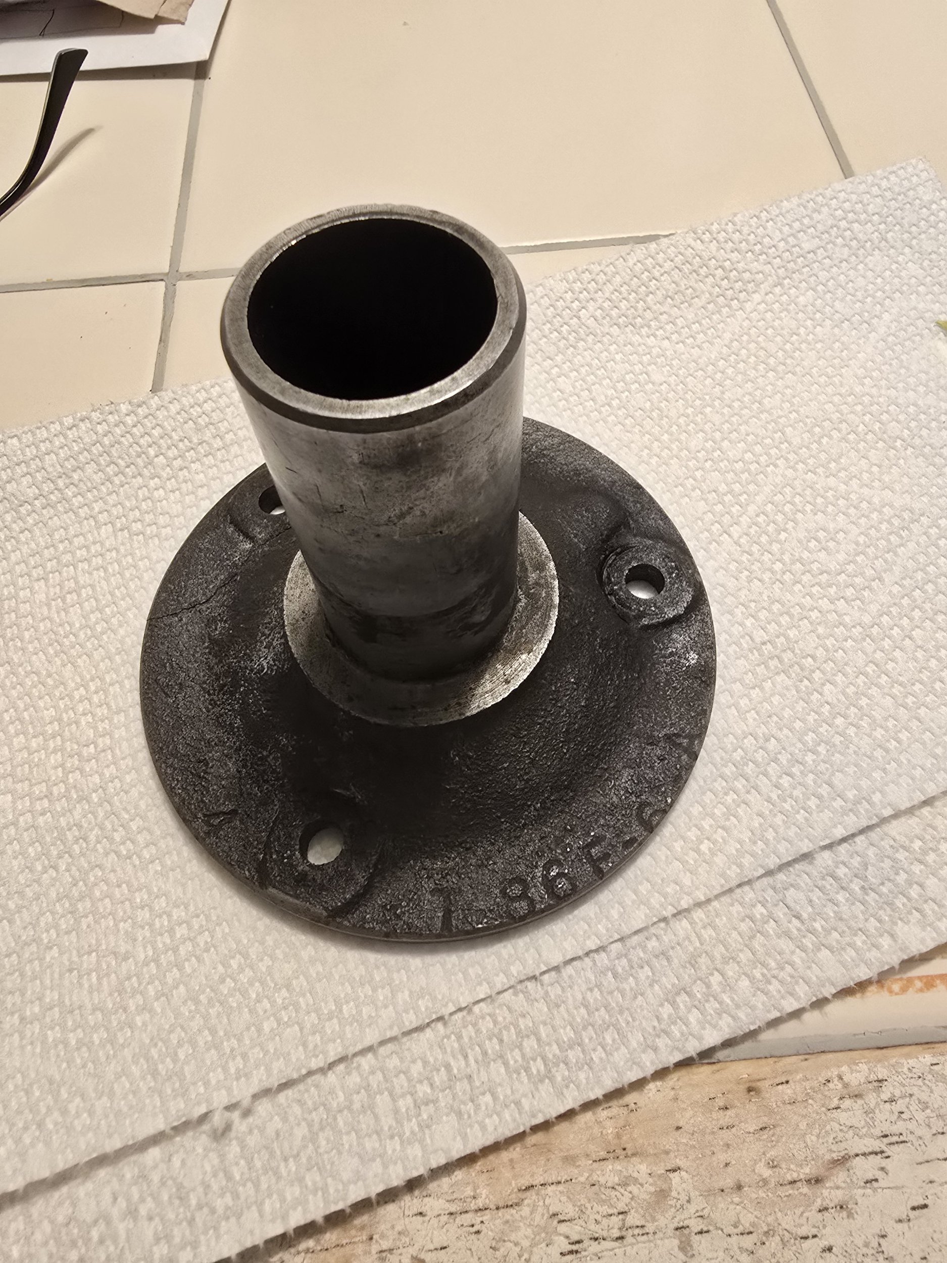

    Hello all,
    I was wondering where I can find a bearing retainer for t86 r10 3 speed with a 3 bolt pattern. The one i have is cracked and having a hard time locating one. It is going on a 1955 ford ranch wagon

    If one doesn’t turn up try the Ford Barn or yblocksforever. Van Pelt sales as a last resort, maybe a trans they’re parting out. Lord knows there should be enough T-86’s around blown up that parts are out there.

    They were made with and without the pocket for a replaceable front oil seal. I know we’ve got some without the pocket but not sure if we’ve got any that accept the seal. If the transmission uses the regular 207 type front ball bearing, I usually just rebuild the transmission using a sealed front bearing so I don’t have to worry about having a front oil seal.
