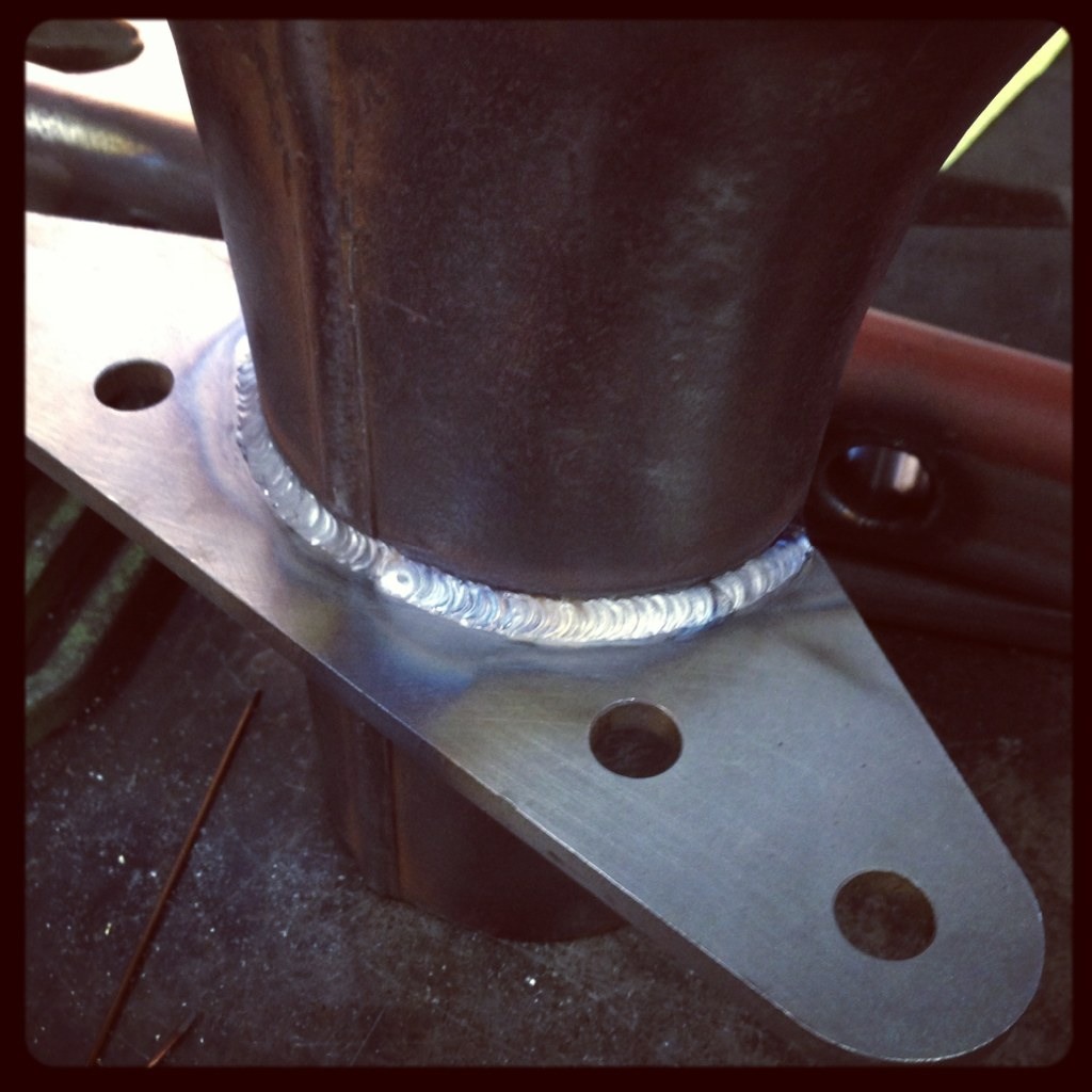

    Another quick update... I still need to mount the rear end in the chassis and was surfing around the web when I came across dwrfab's web-site. Mounting plates already cut and good to go for the rear-end uprights! Hot Damn! I'll take them! Here's the delivered goods.
    Thanks again Don for such great parts!
    ~Robert M.

    THE-SYNDICATE
    And a shot of the plates trimmed to fit the chassis. The bolt layout and rear end brackets are basically identical to the original car. At least that's what my pictures tell me! ;-)
    ~Robert M.

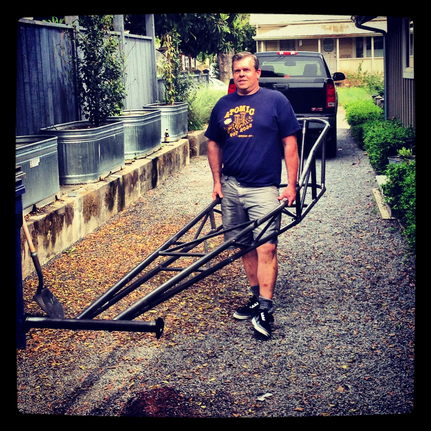

  18. THE-SYNDICATE
    Joined: May 13, 2003
    Posts: 827
    THE-SYNDICATE
    The car had been thru so many changes that the frame was used up. Rod Bradshaw decided it was best to toss it and move on with new pipe at the time. Luckily they un bolted all the parts before tossing the whole thing!
    ~Robert M.

    THE-SYNDICATE
    Quick update! It's off the JIG and the final welding is underway...
