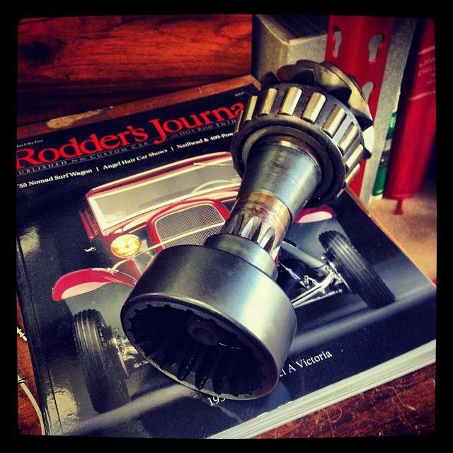

    Did a little prep on the 3rd member yesterday. I pulled it all apart and will be machining a solid piece to replace the crush sleeve this weekend. While it was apart I decided to go ahead and trim the casting around the outside edge. I did notice that the lip was digging into my leg on one side so this should help alleviate this issue. All the guts will go to the rear end shop next week for re***embly. Check it off the list!!!

    Hmmm... Couldn't post a pic on that last one. So here's the old hunk of Iron!

    Hey Robert, what gear set are you going to use? Stocker or did you find a after market?

    I'm just using the stock set of 3:90's for this. I don't think there were many options beyond stock to tell you the truth. There were some aftermarket goodies for the spider gears and a few spools but otherwise stock was the way to go. It should be fine even if a little burnout is in store for the car.

    Wow!! Time is flying! So here's a few quick updates of what's going on.... Finished up machining the "No Crush" spacer for the rear end, fiddle ****ed with the Greek coupler to make it fit the pinion splines, and then hauled all the goods to the one and only Don Doan.... This guy is the **** and really knows gears etc. He worked his magic and really dialed this thing in. Here's a few snappies:
