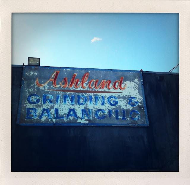

    Collecting parts is all good but at some point we gotta start work'n on ****... So I loaded up the 2 cranks and headed down to the Bay Area. These need to make it to the proper shop with a guy who still knows his ****... They are becoming few and far between... This One is still the PLACE.
    The cranks are looking pretty good. The one is a simple stock crank but the other one is the winner! It's either a "Hank the Crank" or a "CrankShaftCo." deal from the 60's. Added counterweights, lots of grinding and polishing, full groove Main Journals, etc.... We are focusing on this one and just checking the other one to make sure we have a good spare lying around.
    While I was down there I was stoked to get my Favorite Mask Back!!!! I have worn this for every p*** I have ever made down the ole 1320.... So glad to have it back!!! And glad I will get to use it again!
