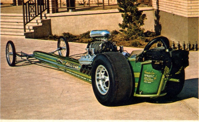

    Here's a great shot of the car from Above... This is taken from the 1966 Drag racing Mag article.
    Deuces likes this.

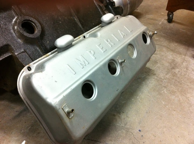

    And do you see those nifty little breathers on top of the valve covers??? Too cool... Gotta Have um! Well I'm not sure if these are the absolute correct units but they are really Damn Close.... Close enough!!! Steve Sellers had these cast up and I was able to get the last set he had in stock... Here they are on their own:
    And here's a trial fit on the IMPERIAL covers....
    Just Right!
    Deuces likes this.

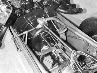

    The car first started out with an Olds Rear End as did most of the cars of that era but was quickly changed over to a 8 3/4" Chrysler rear end. According to Lee this happened pretty soon as they were breaking the Olds constantly... Then they did the move back about 3". You can see the Double rear-end uprights very clear in these pictures....
    And then you can see some of the inside details from this *****in X-Ray Drawing that was done of the car.
    More Data!!!

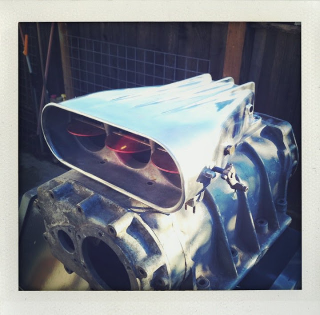

    Here's the latest pice of Yum Yum to arrive..... I have been struggling like a SOB to find one of these Hats. Yep It's an Enderle Bug Catcher... But, It's the original ShowerHead style that had a thin mounting flange, and the 2 side ports to take the nozzles in it. Well I could have bought a new one and done some cutting and hacking but I really wanted the Right Stuff. All it took was asking the question! I posted this to a Drag race e-mail group that I'm on and had 2 offeres in less than 24 hrs.
    Funny Side Note.... I also posted this to the Nostalgia Funny Car Board, in their Cl***ifieds Section. I had lots of looky loo's but only one response. Cl***ic Scam'ing Proposition from some ***-Hole. I knew it right away but I continued to **** with him for a bit before he finally bowed out!!
    So anyways... On with the goods! Check this thing out! PRIMO....
    Riceman had a Barrel Valve and I just need to redo the anodizing on those ****erflies to match the orig version.... So Slick!
