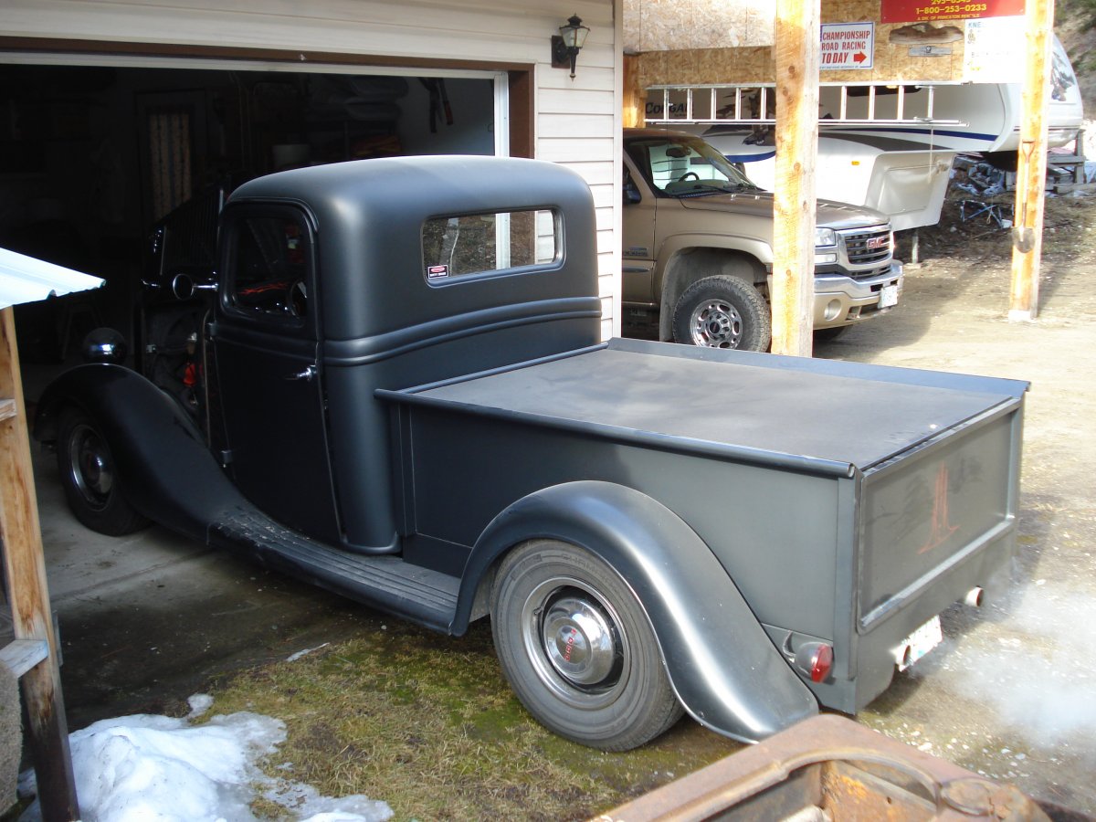

Technical Been chasing a shake
Discussion in 'The Hokey Ass Message Board' started by trollst, Jun 7, 2018.

    I'd go along with finding a shop with an on the car spin balancer and have them spin the front wheels up to speed. If you were closer we would use one of mine.
    Over the years I have found a lot of drums that were out of balance and a few rotors that were out of balance. I have also found a couple of hubcaps that were way of on balance. That was a big part of what I did when I did front end work at a Pontiac dealer in Texas years ago.
    You can just jack the truck up with the front tires a couple of inches off the shop floor and set something close to the tread and turn the tire by hand to see if it isn't running true. That will give a quick eyeball of if one isn't running true. Tire stores should have a dial indicator gauge to check run out more accurately. It's a pretty simple job to check the runout in the tire both around it and sideways.

    More frustration, used a highly scientific method of checking for round, wood block freshly cut with a sharp edge up against the tire,........perfect, tire is round. Move same block to side of wheel with pencil marking the rim all round, you got it, deadly, right on, no wobble or out of round. Tomorrow, got help coming, will jack her up and check rear stuff at speed. Tires were inflated to 32 pounds, dropped to 30, truck weighs 2770 pounds, gonna try that too. Hang tight, more action to come. LeRoy.

    So....underneath today with the truck in drive, driveshaft turning slowly. IT'S BENT, right in the middle, ever so slightly, you can barely see it, but it's there. Never been off the truck till this winter, all i can think is it got bent or was bent when it was made, twenty years ago. It'll be some time till I can fix it, but a new one is next. LeRoy.
