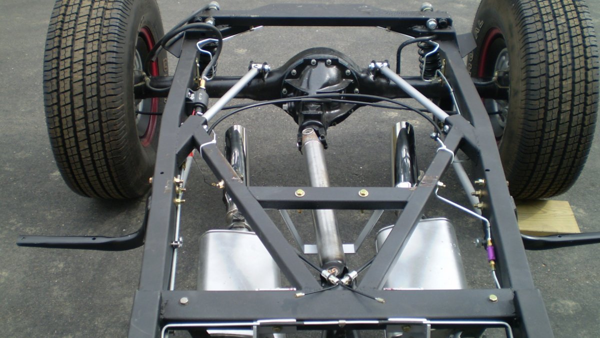

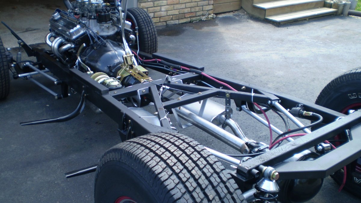

    20140731_160152_zps3751b2b9.jpg~original-2.jpeg 20151228_124655.jpg 20160428_145457.jpg
  17. Just remember that now is the time to make the rest of the drive train compatible with a modern V8 engine. This is a hot rod you're building and no matter how easy you think you're going to be on it, there will be that kid in the rusty 95 Civic " tuner " that pulls up next to you at the lights thinking he is king of the road and that is not the time to question your choice of drive trains. Always, always , over build the drive train from a strength standpoint, unless you're building a trailer queen to tow from show to show :(:( which I'm sure you're not. A SBC and a TH 350 with an 8 or 9 inch or a MOPAR 8&3/4 would be my choice. Just like this, It didn't really cost any more to beef it up early on. Just my 3 cents worth. 001490.jpg 001450.jpg
  18. woodhawg
    Joined: Apr 11, 2009
    Posts: 1,021
    woodhawg
    Is your drive shaft heading toward the p***enger side or is that just a funny angle of that photo? Chasis looks good, clean and strong!

    That's not correct. "Drive" in a Powerglide is 1:1, just like any other non-OD trans. It's "Low" on a Powerglide that is different, it's rather tall for a low gear. A loose torque converter can help with that.
    F&J likes this.
  20. That's a Mopar A body 8 & 3/4 rear and the pinion is offset to the p***. side on those. the angle of the driveshaft makes no difference at all as long as everything is square and parallel. I prefer that so that the pumpkin is centered when you see it from behind. There are a TON of posts about drive shaft angles on here, do a search. Very helpful.
  21. The photos in Post 16 show it is definitely not an original rear end. I am sure the brakes in the rear end came with the rear end but I doubt it has the original brakes in front, how about some photos. Before you go to far try to figure out what it will cost when you are finished (it looks like a money pit). You might be better off starting with something more complete (maybe the missing parts are just not in the pictures) and in better shape (like less rust and having a floor).

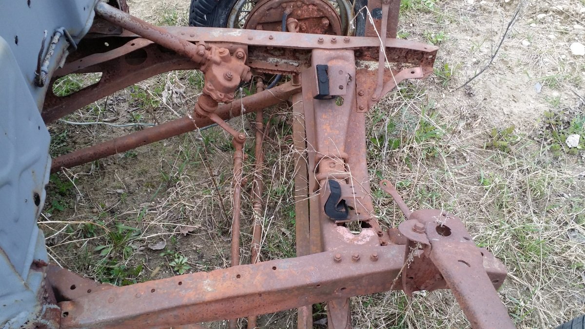

    Can you take some pics of the motor mounts on the front crossmember..
    and also get the camera up front where the radiator was, looking back at the center X tunnel where the trans was. I see it never had split front bones, so I wonder what trans they used. It may be cut out for clearance, and maybe have a rear trans mount that can be identified

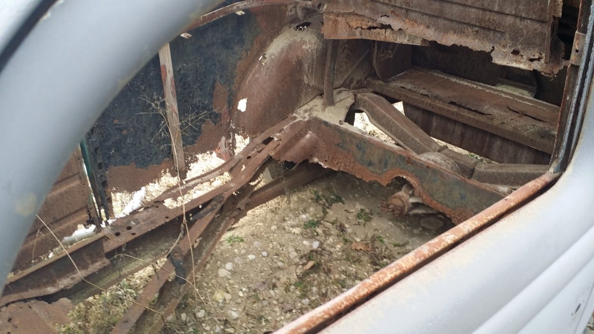

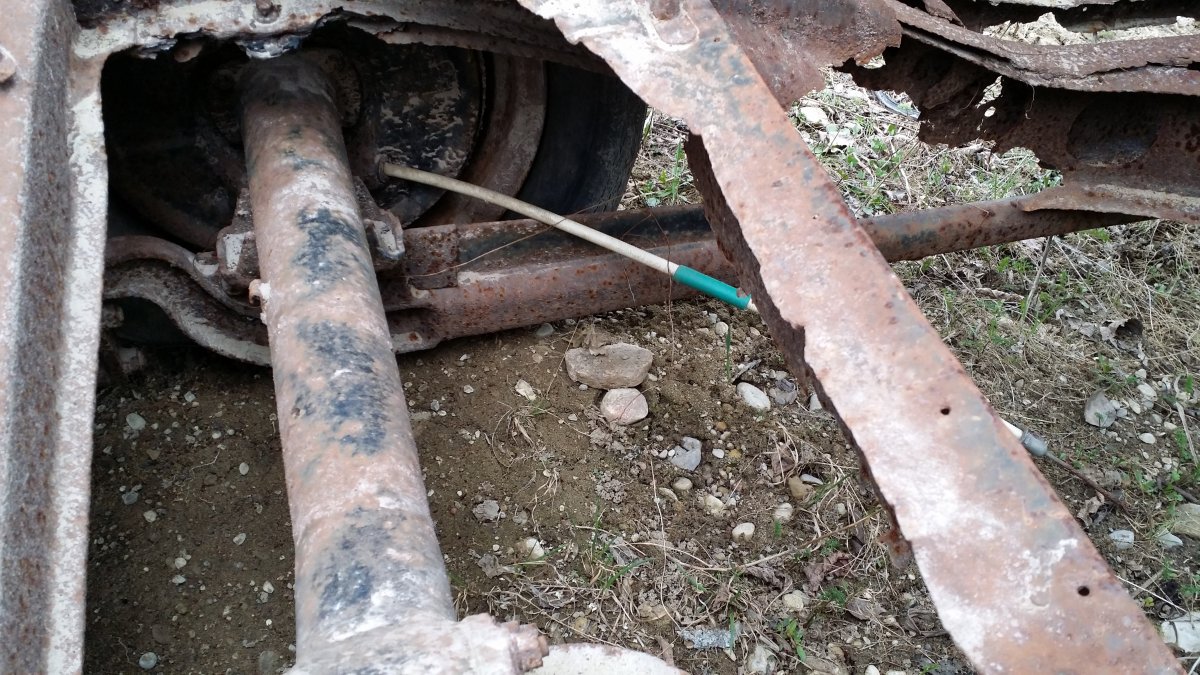

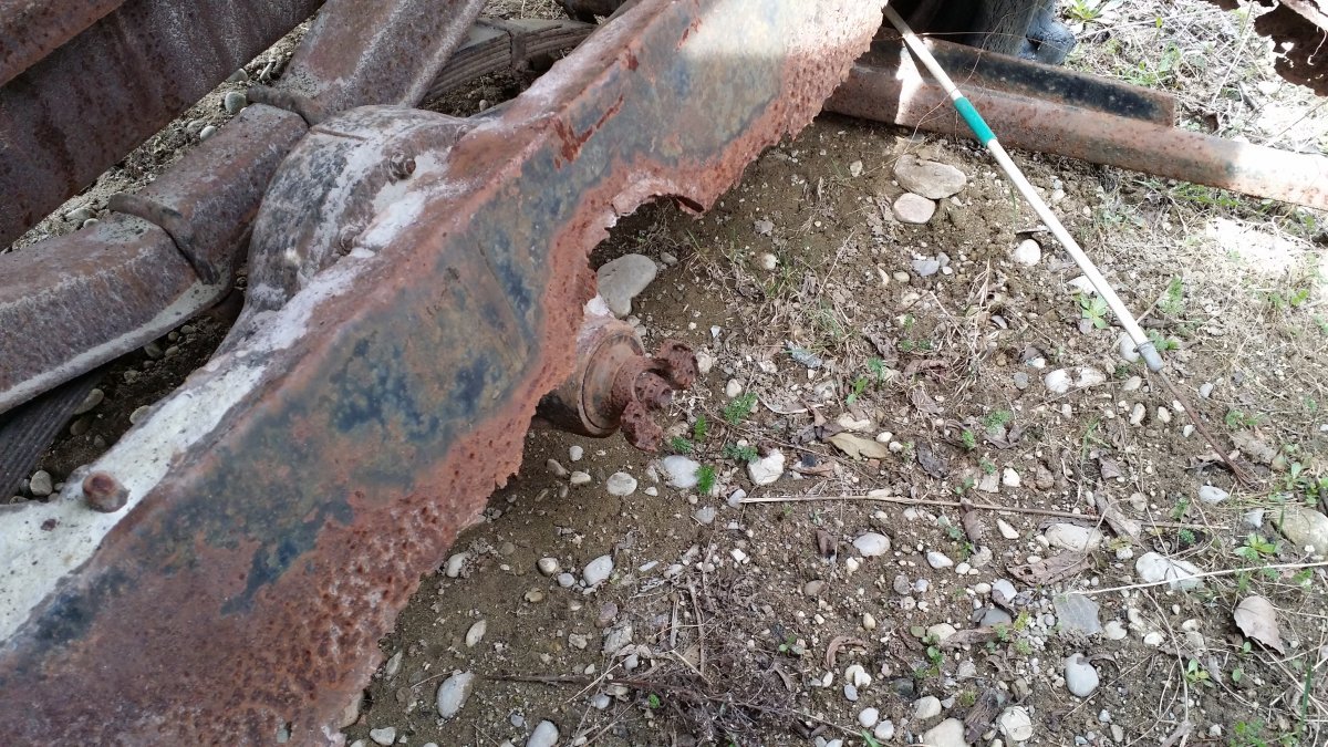

    More pics there for all of you guys. Thanks to everyone!!!
    I have a spare frame that is solid. I am not intimidated by the metal work on the body. I plan to run this car without fenders. Ideally I want to run spoked rims, but I am not sure if I can if I use my 9 ".
    20160428_181844.jpg 20160428_181900.jpg 20160428_145457.jpg 20160428_181722.jpg 20160428_181731.jpg 20160428_181747.jpg 20160428_181821.jpg

    Cool pics... my favorite thing about hamb is seeing really old builds, and what the young guys were bolting in, so long ago.
    We need more guys to ID these modified parts. Look at the very wide 2 bolt pattern on the homemade trans mount plate???
    - the rear I don't think is Olds. I am wondering if it might be 49-56 Ford car??? Just a guess based on nothing, except I think shoebox Fords were said to have that U-joint style?
    -I have no clue on those front motor mounts.....and they sure are way forward? Could they be for a long motor like a 6 cyl? I doubt it, but they are just too far forward to be "side mounts" for a typical V8 locatation. I have no idea how the front of a Ford Y block mounts up, or where. I mention Y block in case that rear is from a Y block Ford car.
    -never saw a master cylinder mounted that far away either.

    Ford barn says 59 1/2" wheel mounting surface for 1935 ford rear. If anyone has definite measurement please verify.
    Ford explorer 8.8 is 59 1/2" wheel mounting surface. Many 3.73 with "posi". If you go this route grab the driveshaft too.

    I think the rear is a '49-56 Ford, too. Hung on beefed '36 wishbones. But the bigger issue is the center part of the frame. Since it is already badly hacked, you could take out the remainder of the center crossmember and put in a Ch***is Engineering or similar piece to let you use a modern transmission. Then you can use whatever engine, automatic or stick you prefer. Once you get the ch***is ironed out, you still have a ton of work to do, but you're on your way.
  30. Hardtail75
    Joined: Jan 18, 2014
    Posts: 117
    Hardtail75
    from Canada
    How can we ID it for sure? Can any numbers be found on it? Or is it best to get pictures of it off the car? Yes as I said that frame is completely shot. Need to brace up the body and remove it so I can put it on the new one. Oh and, on the new frame it looks like they widened the transmission area to support a bigger ******.
