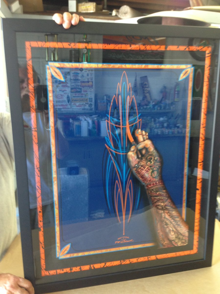

    37BF79B2-A980-4F57-AD1D-EDA610ADD4D2.jpeg Lettering and pinstriping are two completely different art forms using similar techniques. When I first started I focused on the lettering side. I found a sign cl*** at a local jr college and signed up. T.hey taught me letter style , spacing , how to hold a brush and the right paint consistency. They also emphasized repe***ive motion and consistency, in other words, a lot of practice . This cl*** was a five day a week four hours a day, lots of practice. There are several threads on this site regarding pinstriping that should help you and don’t be afraid to ask questions. The advice that Quicksilver 46 gave was absolutely correct, I know him and he knows what he’s talking about. Good luck and don’t get to frustrated, it takes a while to get comfortable with the brush.

    philly the greek I love that pinstriping! do you think it would make sense for me to separate pinstriping from lettering practice sessions? Quicksilverart46 gave great advice that I am definitely taking.
