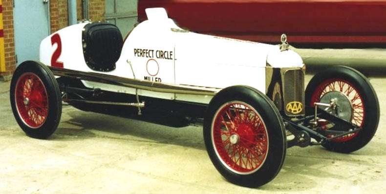

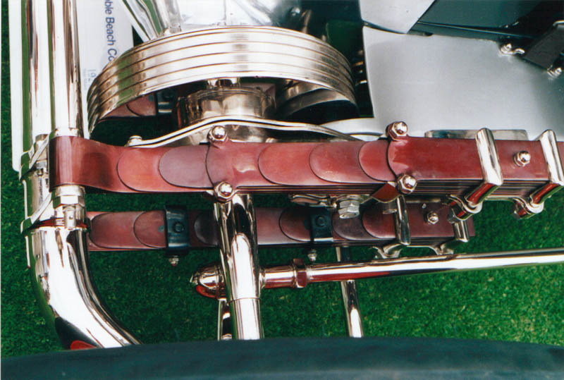

    Suspension Ive decided to play with quad quarter ellipticals in honour of the Miller race cars, no all wheel drive or DeDion tubes however. Springs are on their way from Posies. My Grandfather scolded me for the planned springs. " they were rubbish , rode terribly, overlanders used those and cracked frames, you'll have to reinforce the frame, they walked away from that idea after a few years...." so some good advice on ch***is reinforcement but even if they dont ride great, its not what the cars about, its about being a throwback to the traditional builds and people who ultimately see the car can go away with some history.

    As I mentioned in your other thread, we seem to have related likes in cars. I'm collecting pieces & parts to build a similar "tribute" racer, as influenced by late 20's early 30's Indy/"Big Car" single seaters (like No. 2 below). I have all the main components. No intent to drive on public roadways. Will use a narrowed c1930 Chevy ch***is, front parallel leaf semi-elliptics mounted outside the rails, Hupmobile tube front axle, maybe cross-spring, or quarter elliptics in back, small Toyota (OT) pickup rear end, to match the 6x5.5" bolt pattern of 18" Chevy wires. Front wheels may be 17" Plymouth wires, which (I think) match the Hup 5 lug pattern. Or I'll use Chev 6 lugs if it appears easy to adapt the Chev hubs to the Hup spindles (or Chevy spindles to the Hup axle). No front brakes, so not the head-aches you're having!
    Engine will be a Jaguar 3.4, 3.8, or 4.2 (but with the early smooth cam covers). I have triple Weber as well as triple SU inductions, but I think people tend to ***ociate them with with postwar sports cars (although they both go back at least to the early 30's). So I'm thinking of using 3 1954 Corvette 6 cyl side-draught Carter YHs, or 3 side-draught Linkerts (which were aftermarket Harley carbs, have br*** bodies, which would look pretty cool polished.)
    Transmission (OT) will be something I found at a swap meet that is used in some oval track race series. (So I'm told; I've never seen one, before or since.) It is a two speed; the back is readily removable (need to drop driveshaft) and has standard quick change gears therein. Has late model GM bolt pattern, so need to make/buy an adaptor.
    The red car I just snapped a picture of from the March issue of the British mag "Cl***ic & Sportscar". It's a Rajo Model T, owned and raced by a chap from Queensland, bought decades ago for £13!

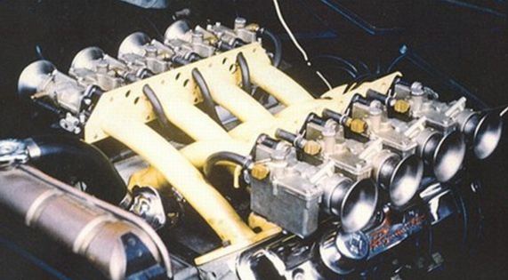

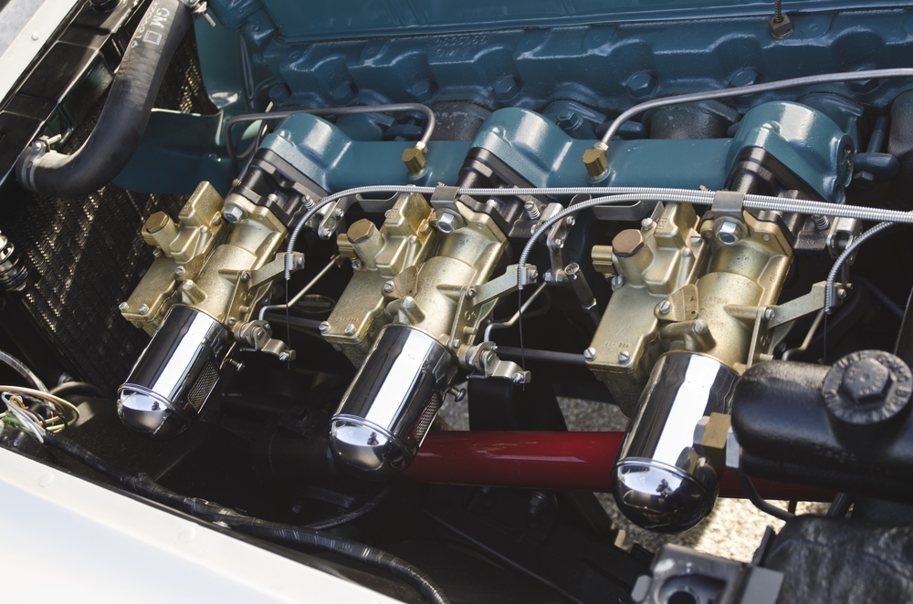

    Cool carburetors for Jaguar:
    Linkerts--
    Carter YHs --
    SU Twin Choke (ever heard of these?) --

    modified to use with Model A spindles ...its a piston ring[​IMG]

    S.U.'s have been around for more than 100 years; anyone who ***ociates them only with post-war cars doesn't know their automobile history, oh, wait a minute................which war?
    I love your project! But REALLY looking forward to your first post AFTER adjusting the valves in that engine ;)

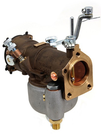

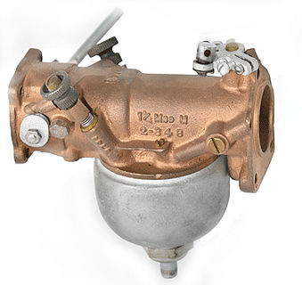

    Not suggesting any of these (expense) but if you are looking for 1920's look; Stromberg and Zenith both produced really good (for the period) solid br*** carburetors. Detroit Lubricator in the late teens early twenties, produced a couple that, while they didn't externally look a lot like the S.U.'s, were an engineering (internally) ripoff.
    The Carter YH was introduced in 1952, so definitely post-war. Great carb!

  16. Thanks for posting Desmodromic. Those twin choke SUs, no Ive never seen those before. The configuration remindeds me of a weber, they look great. What were they used on/ for?
    I tried pretty hard to find a triple carbied engine, the triples sell for good $$ here and new one seem to be about $4500 with manifold.

  18. Those Carter Yh's do look the part thats for sure.
    Ive heard stories of shimming and adjusting the Jag valves, you think you get it right then by the time your back around to recheck nothing is right. I take it you have had some experience here?
    Unless your familar with older vintage and veteran cars, a lot of people think of SUs on Jags and Austin Healeys etc from the 60s so hence the post war reputation.

    I have an E-Type triple SU set-up, but I'm thinking of using a modified twin carb manifold from a sedan, which is more compact. I figure on milling off the carb side, including the carb attachment flanges, and fabricate a new aluminum side with flanges for three Carters or Linkerts. I'd tig (well, not me, somebody more talented!) this on to the manifold, smooth and polish the welds so it looks like an original casting. Could just fabricate a new manifold, but not easy for a Jaguar, which has integral cooling water p***ages.
    I have an extra Jag manifold with dual downdraught single barrel carbs if you could use it. The carbs are surely too small; they're for a 2.4 liter. Not sure if larger carbs could be fitted. Also, the manifold fits the early head, not the later "straight port" head.
    Another thought I had was to use 3 updraught carbs, e.g., Model A. I'd guess
    this style could be found made of br***. Since I don't have these carbs, I haven't tried to mock this up. The distributor might be in the way.
