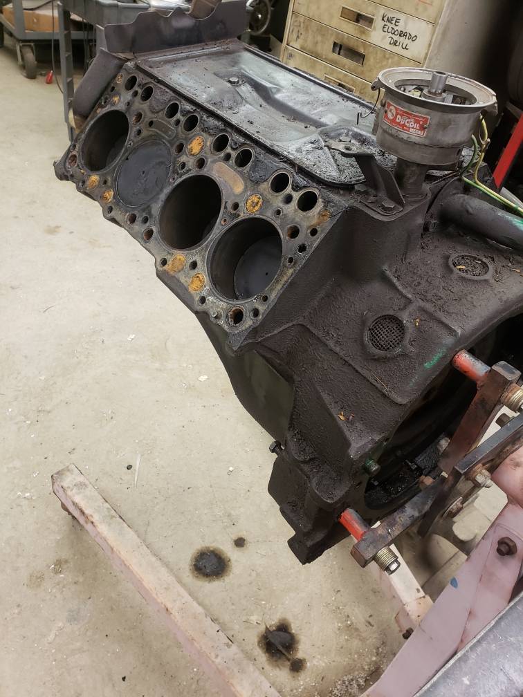

    A few more shots from the No Fly Zone event turned up today. We're doing our annual Thanksgiving morning cruise in a couple weeks and I'll update with some pics and video of that in a couple weeks.
  17. Nick Flores
    Joined: Aug 13, 2009
    Posts: 1,358
    Nick Flores

  21. Paul
    Joined: Aug 29, 2002
    Posts: 16,974
    Paul
    Editor
    Love the mix and match going on
    Early 303 block with 324 pistons and heads with 371 intake manifold
    None of which are a bolt on without careful machining and attention to detail
    Be interesting to know how much meat is left in the cylinder walls after the .125 overbore

    That's all I've got for now. I'm working on a few projects at once and need to catch up on this one. I'll pull the sonic tester out and check a couple holes and I need to calculate compression ratio because we are planning on bumping that up some. Cam is getting sent out for a little more bumpy too. I know of few of you guys have been following this and I'm sure you're used to my ******* and sporadic form of updating... as always, more details as I come up with them.
