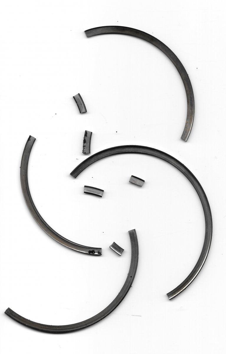

    Why do you think it broke?

    Why broke? Best guess is a backfire;,it dose a pop from carbs some times when I'm stupid enough too try an take off from a lite,were we{line of hot rods going places} didn't really stop fully at,as it turned green just as we were almost stoped,so am still in 2 gear,not first{is not syc. 1st}. I'm the only hot rod old enough to still be standardshift 3speed,all the others have Grandmom ******s{Automatics} LOL
    The cly wall had no big scratchs,so I honed it and looked very good.

    Retire for the nite,its 9pm. So far I hunted up another stock Y piston ,cleaned ring groves an match balanced it with in 2GM. of one I just took out{I don't trust ringland size,trashing one I took out}. Honed cly,cleaned an put newer piston with new rings back in motor,lockT the rod bolts<<so that's back together. AM if I feel like it,start putting head an intake back on,and pan/put the oil ,filter,an water back. Then all the rest.

    Have to ask. What's the taper on the cylinder and did you check ring gap down below where the stroke ends?

    There's a lot of both cly an piston wear,too many miles,and no $$$ to do anything about it,rings are stock=gap is now fairly big,but its what it is an will have to do what ever for now. I fully know this is a Mickymouse fix,just what is posible for now to get rolling again. Plan is keep having some fun,an try an s**** enough $$$ together for a good rebuild. Tell then,we'll see if this fix works better then having 7clys an smoking like a cho cho train. Should be running by this week an I'll report on bad or good. Not every thing I ever fixed worked over the last 65 or so years of nuts an bolts,but most has!

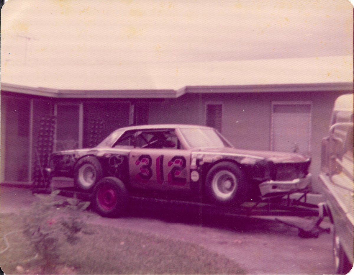

  14. B.A.KING
    Joined: Apr 6, 2005
    Posts: 4,039
    B.A.KING
    THANKS FOR THE PIC .Those guys were my heros. I have a lot of pics of B A cars but never seen that one. There were 2 brothers who raced down there,They move to Southern TN and started racing with us at Huntsville . I think his name was Kenny Andrews.Anyways don't want to hijack your thread.Good luck on Y-block

    I wonder if this issue would have still occurred even with a fresh rebuild. If: Lugging in 2nd gear is what did it... Denotation is denotation. Therefore don't feel guilty about being frugal...

    Not much done today/sunday,did do a new PSI check on #5 cly after hone an other piston put in,head back on.= now 95lbs,better then the 35# it was,may even get a little better after rings seat better, if I get the rest running close to right again. !

    95lbs. What was your supply pressure?

    95 psi is pretty good for rings that are not seated.

    OK,good day,we're back running !!!!
    After doing first start after another piston,hone n rings,oil,filter,gaskets it still sounded like ***** but didn't smoke! ****
    So time to fix why the rings broke,an that as I said before was likely a backfire/detonation maybe from lugging or something.
    So I now added another set of plugs n gapped them{OK actully not new plugs but cleaned another set of old plugs in sandblaster plug gizzmoe with the little sand bag. Also cleaned n gapped points,plus replaced condenser*****.
    Started it again,WOW rans like new,well OK not new but sounds good now an no smoke.
    My guess is condenser was ****ping out/yes I love my points n condenser just fine,an do have spair set in tool box behind seat.
    Thanks to all those that p***ed along ideas!

    If you don't remove the cylinder wall ridge before putting in the new rings and pistons they can break the rings just like this.
