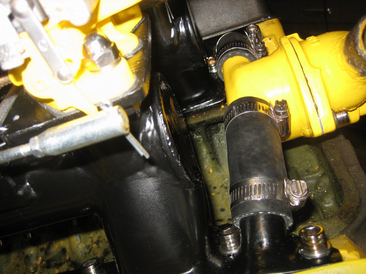

    First sat. in a few weeks now we don't have lots of rain in Miami,so was planning on a run to a car show about 20 miles away! Didn't make it passed the 2 mile mark,water spray on the windshield ! But turned out it was not raining! My weld on my homemade "Y" water conector from rad. hose too each head,desided to show me a pin hole on top of "Y",this after it has worked fine for like 5 years. Yes,back when I made the thing,I had put PSI into it ,and checked with soap out side for bubbles. My guess is a little rust got to a thin spot I didn't know about. Got to addmitt,I like it when this stuff happens close to home,an can just run back to the garage. Will clean, reweld n paint it sunday,so test run sunday afternoon,fun fun. 001 (4).JPG Leak is hiding in pic behind oilcap !
