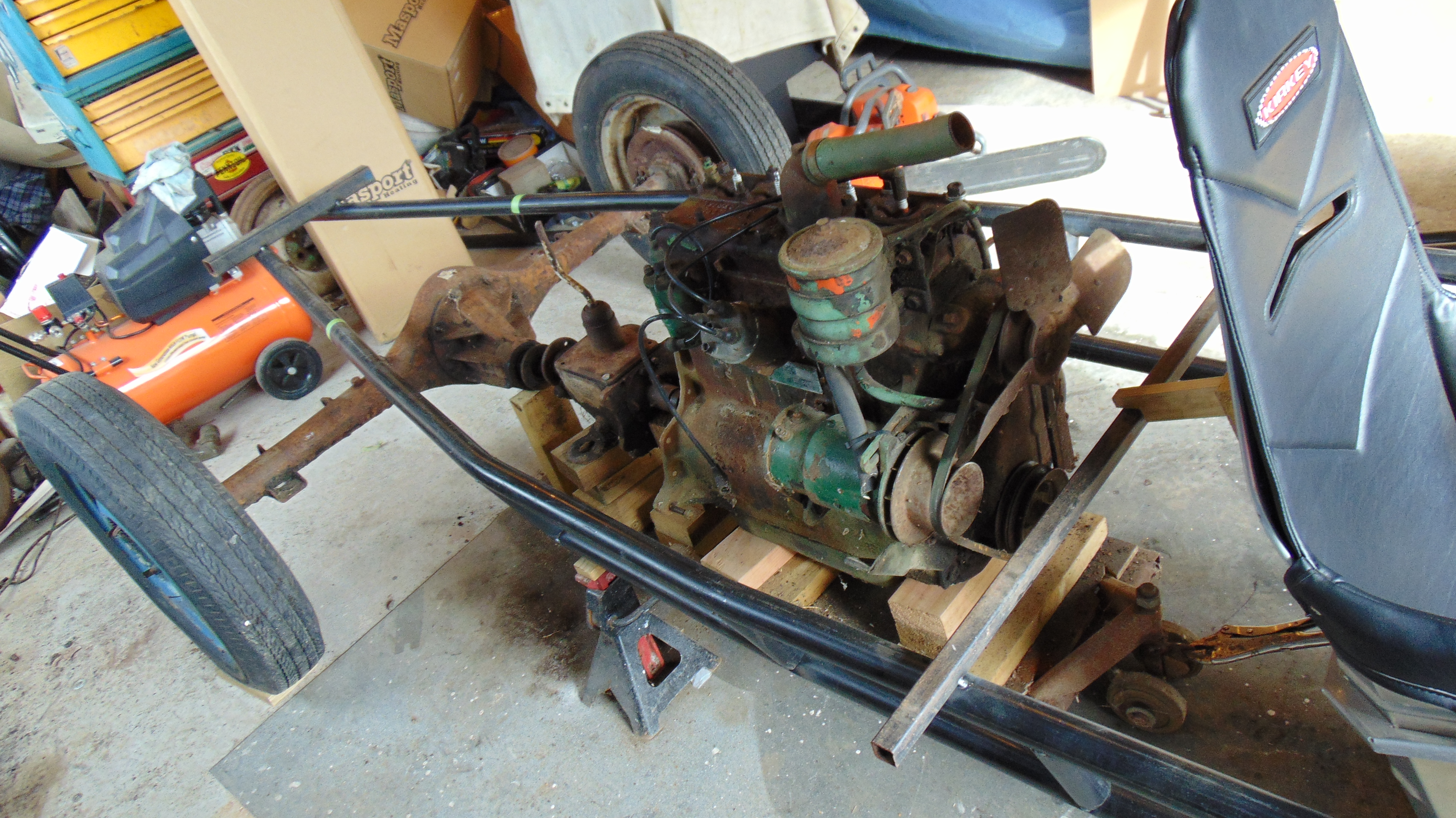

    So why not put the motor in there as well. JW

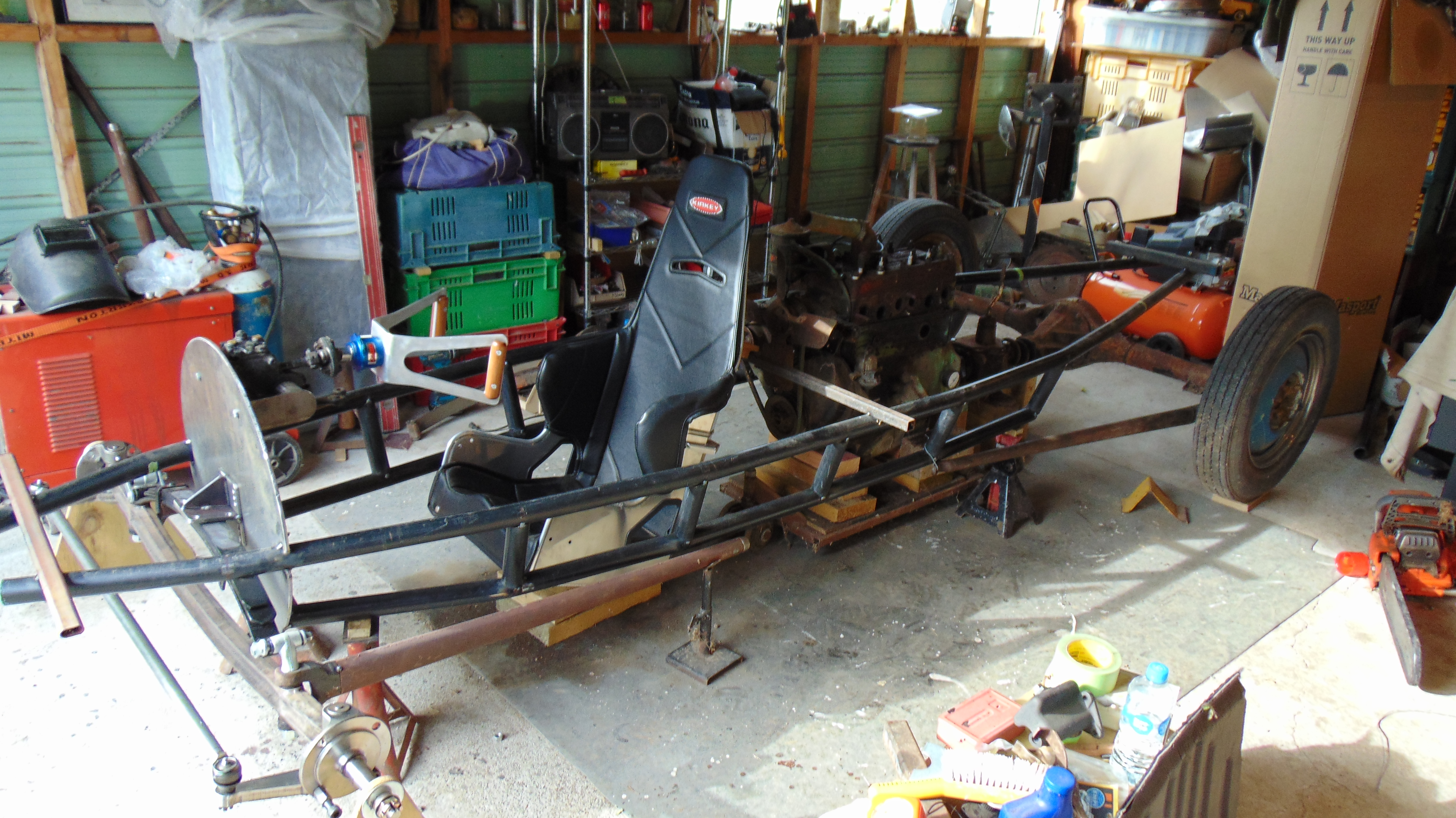

    The gap between the two flanges on the drive line will be filled with a single universal, it just happens The Willys flange and the axle flange are the same, even the bolt pattern. JW

    The rear radius rods will be fitted for looks not to be functional but will give some rigidity just by being there.
    The wheel base as it sits is 111 1/2 ''but will make it 112''. JW

    The oil filter will go along with the generator. I will put the oil line into a cooler instead. I am in two minds about a radiator or a water tank, leaning more towards a radiator. There will be just enough room in front of motor and behind the bulk head but there will be more room and better air flow if i mount it beside the motor on this side, will wait and see. JW

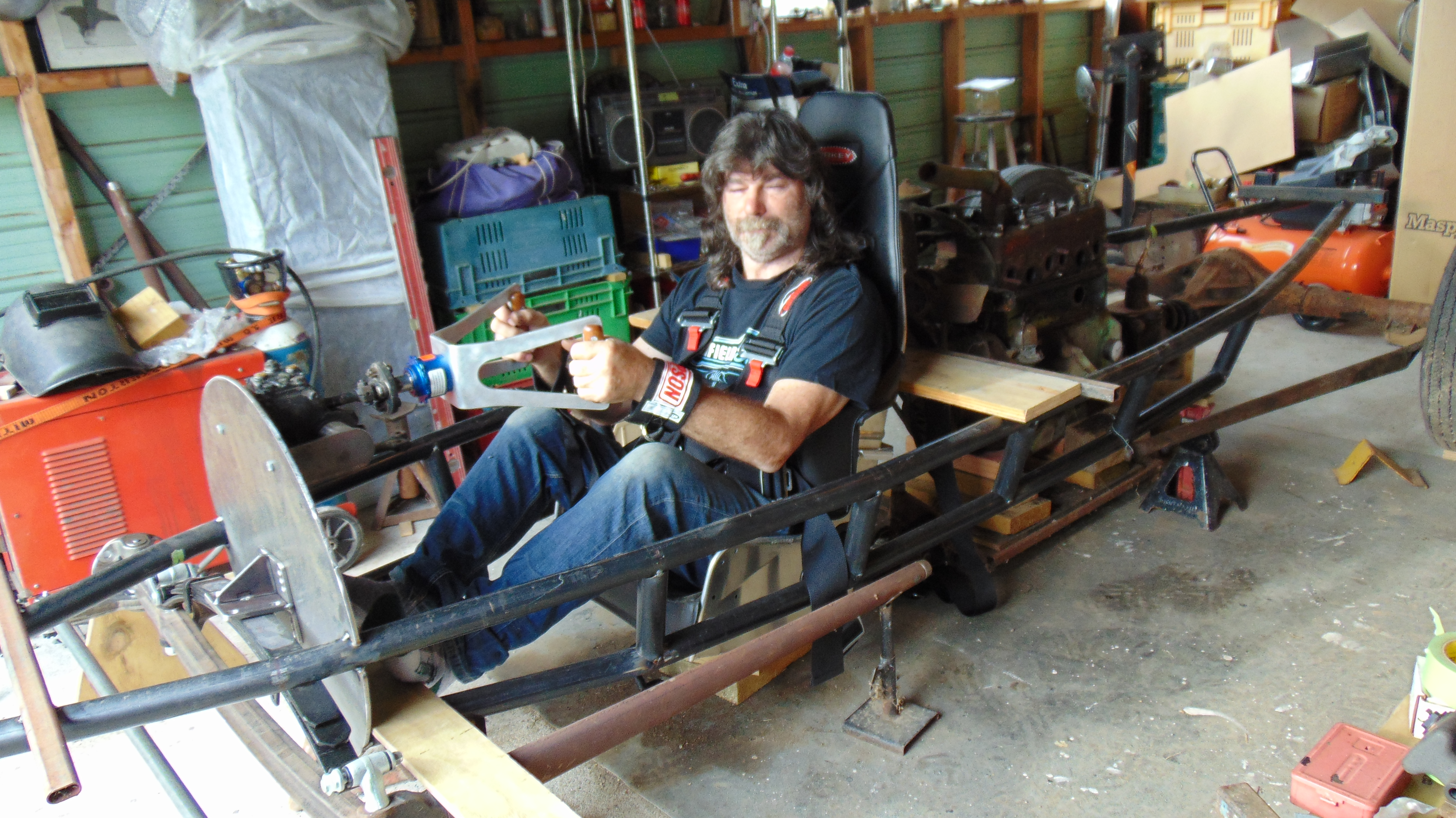

    So what's left to do but see how much room is there for me. The seat can go back a bit more and my feet will be lower... even got my harness stuff out for the photo.:rolleyes: JW
    Oh; the sun was in my eyes.;)

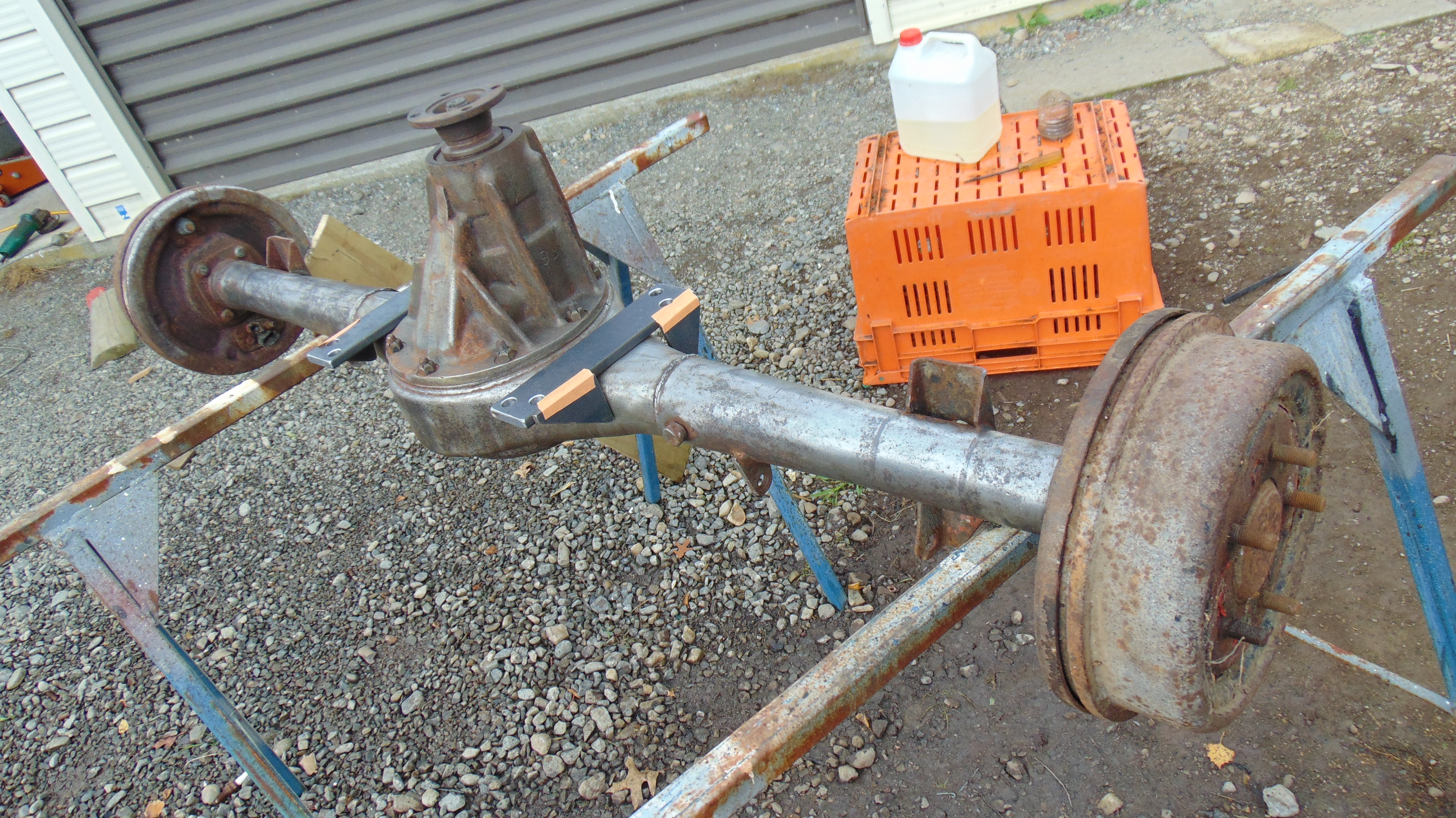

    Spent a few hours cleaning the rear axle in preparation for fitting the adjustable mounts. The spring pads will come off but for now will serve as a platform to get thing square. Wiil do the backing plates when i overhaul the brakes. JW
