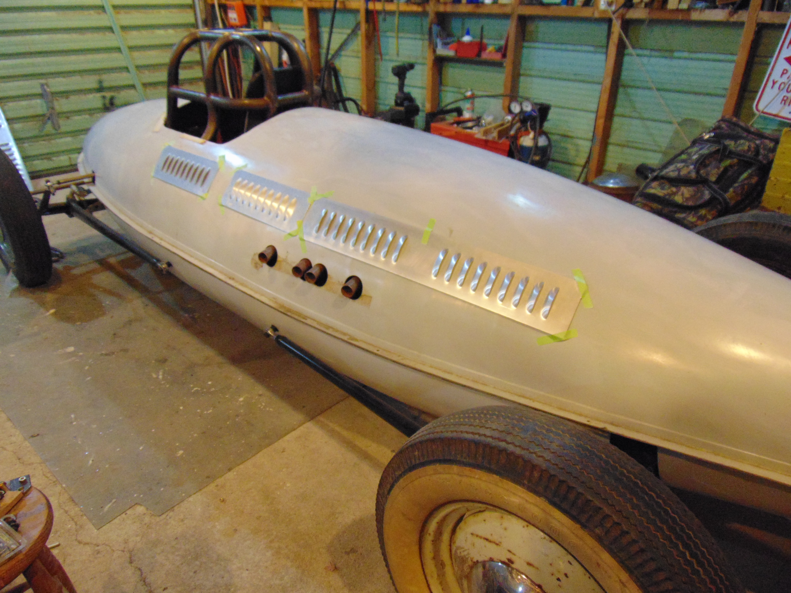

    Rearranged a few things in the workshop to give be a better work area and had a play with the louvers to get a visual on things. JW

    And from the other end, the front one will be for air out for the drivers area as there are gaps around axle/tie rod will let air in. The engine bay will have a bit less for air in and twice as much for out. There will be a full fairing that will most likely have some in that as well. In the fairing i will have a shallow scoop on top just behind the roll cage that will direct air flow in front of the shrouded radiator hence the more air out louvers. I will work some into the lower section as we go. JW

    I like the louvers, aesthetically I think all the same direction but I can see what your saying about letting air in as well as out.

    I do not have the knowledge to understand airflow over a body, but a thought from the limited stuff I do think I understand...
    The louvers next to the ****pit likely will create turbulence of air as it slips over the body. With the 'intake' louvers directly in line behind the 'exit' louvers, the turbulence may impact the amount of air that the 'intake' louvers grab, or intake. Might be a benefit to staggering them on the body.
    Stogy and 26 T Ford RPU like this.

    And you have to taking into consideration the "Boundary air layer" close to the surface like that is why the old prostockres started using the snorkel on the front of their hood scoops to get clear air above the flat hood surface. :)

    I do understand clean and foul air and i have thought of what you say about staggering them when i sat them on there, was just my first visual of them, also you can't get the hot air out if you don't get air in. With a sealed firewall the engine bay will only will have the louvers to get air in and out. Its no 200 mph car but it still needs to work the same way. I want to have some on the lower body section too but this was just a start and there will be a lot of thought happening before i commit to it , I also need to be mindful of the modifications and mounting of the fairing on top. Cheers though.:) JW

    That would be a type of Thermo Flow, but in a speed (or fairly quickish) situation the air will be scooped in by the forward facing louvers and pushed out the rear facing ones and with the air rushing over them on the outside that will create a low pressure like a Venturi. It's going be interesting and fun working it out, it's all been fun so far. JW

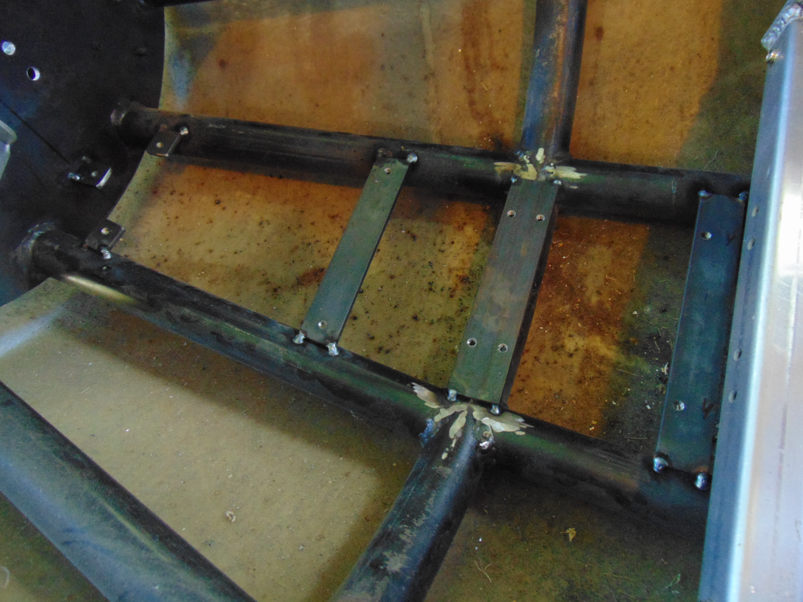

    Made some mounts for a floor and side panels, tacked the lower ones in place and will do the side soon, i made them heavier where i will be standing for in/out and where there will be a join. JW
