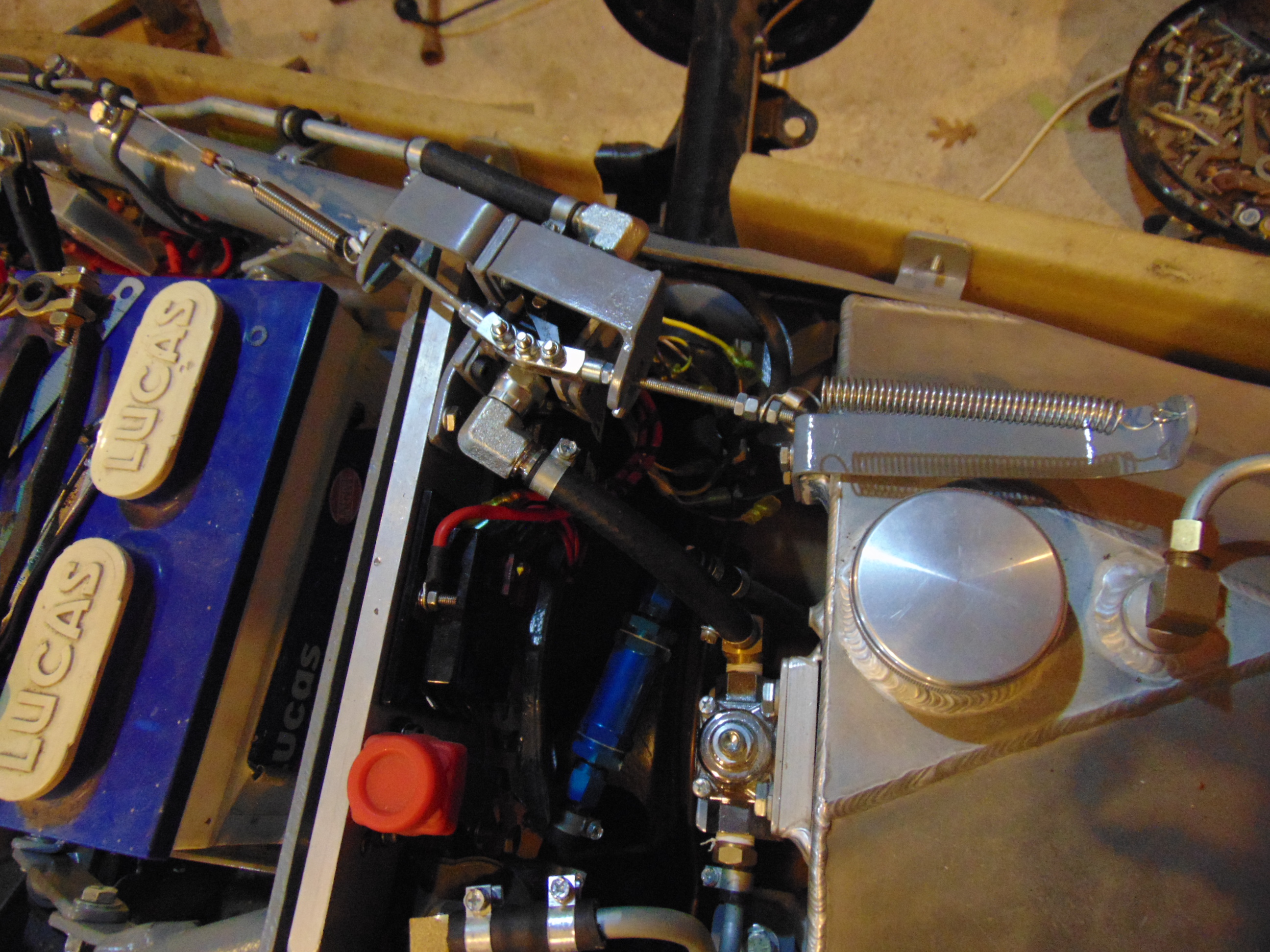

    Spent some time on the fuel tap mechanism today after much measuring i made up some bits. JW
  14. 26 T Ford RPU
    Joined: Jun 9, 2012
    Posts: 12,585
    26 T Ford RPU
    The other side, will make proper spring mounts soon. It works well so that pleases me. JW
  15. 26 T Ford RPU
    Joined: Jun 9, 2012
    Posts: 12,585
    26 T Ford RPU
    Will tidy it up by reducing any extra bulk. Been a long time in the design corner of my head. JW

    Tidied up all the parts and painted. Need to play with some spring combos and spring attachment points. As it is it works ok but i want it better. It's in the tap closed position JW
  26. 26 T Ford RPU
    Joined: Jun 9, 2012
    Posts: 12,585
    26 T Ford RPU
  27. 26 T Ford RPU
    Joined: Jun 9, 2012
    Posts: 12,585
    26 T Ford RPU
    Activation lever in closed position. JW
  28. 26 T Ford RPU
    Joined: Jun 9, 2012
    Posts: 12,585
    26 T Ford RPU
    And in open, just need a bump forward and it snaps shut... quick an easy. JW

    Is the threaded rod retained in the steel guide at all?
    The reason I ask is could they move out of the slot on a rough track or beach and cause any issues?
    The car's a credit to you.
    41 GMC K-18 and saltflats like this.
  30. 26 T Ford RPU
    Joined: Jun 9, 2012
    Posts: 12,585
    26 T Ford RPU
    They are and the slots are long enough to keep the rods retained and due to the springs holding tension on the nut stops and the slight angle of the slots it can't come out, i tried it and all's good. I thought of that at the beginning. Cheers. JW
