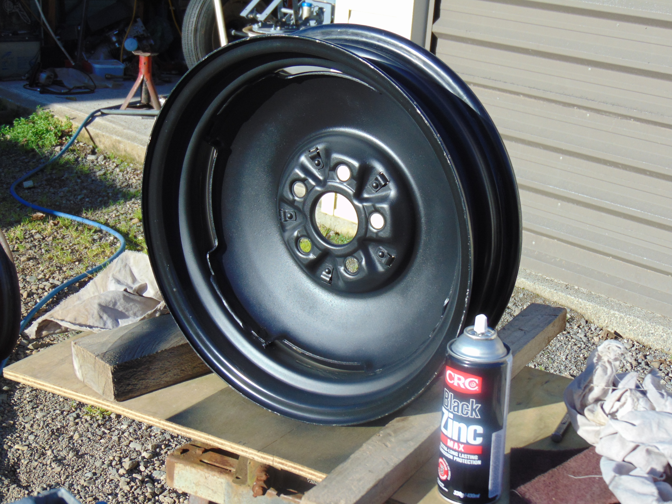

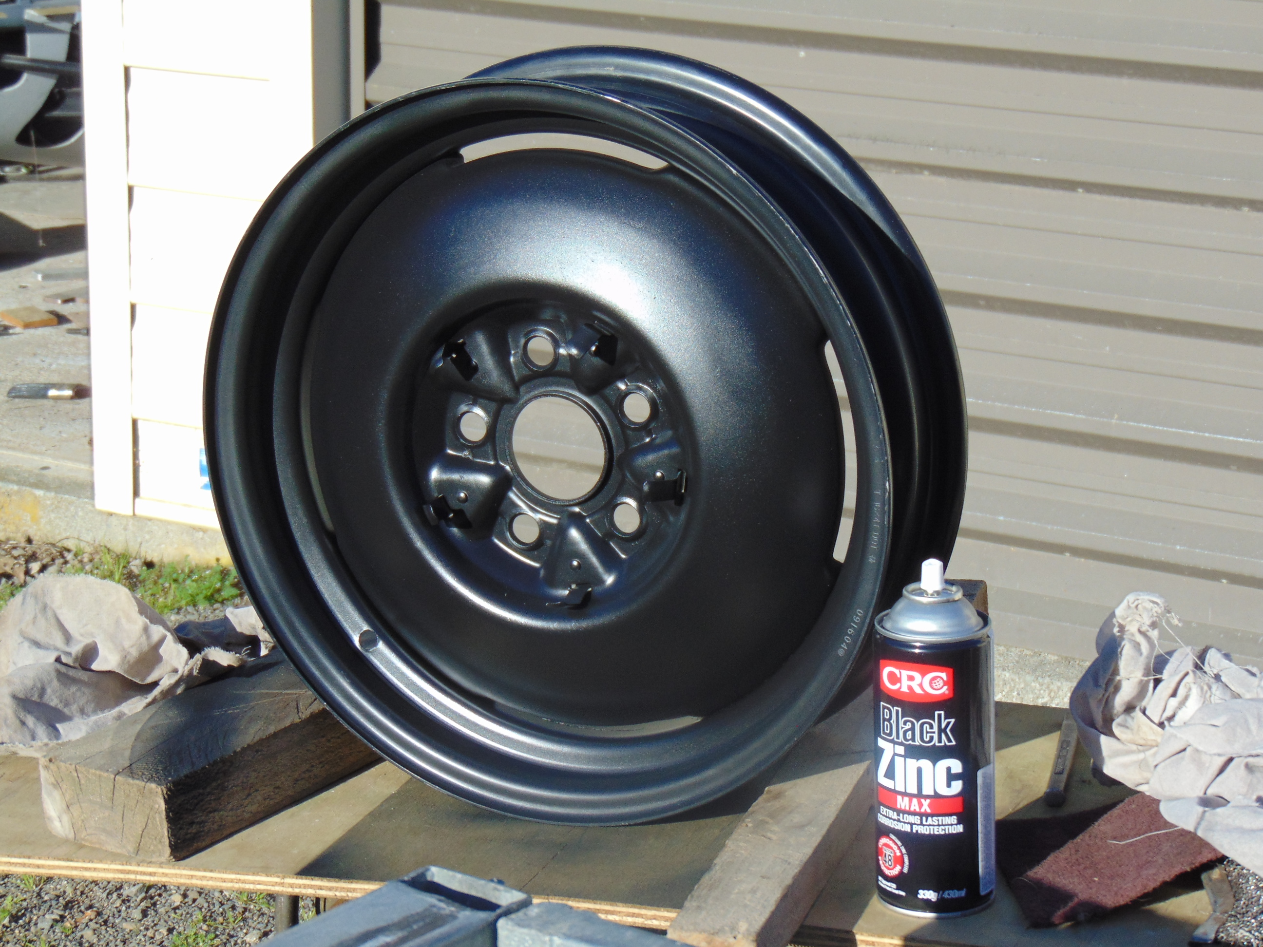

    Should get the front tires this week and remembered i hadn't cleaned up the front wheels after getting the new hoops welded on (thanks Todd for the tidy job) and paint them black. JW

    First coat of black zinc. I used this on the axles, radius rods and all the black bits on the RPU. JW

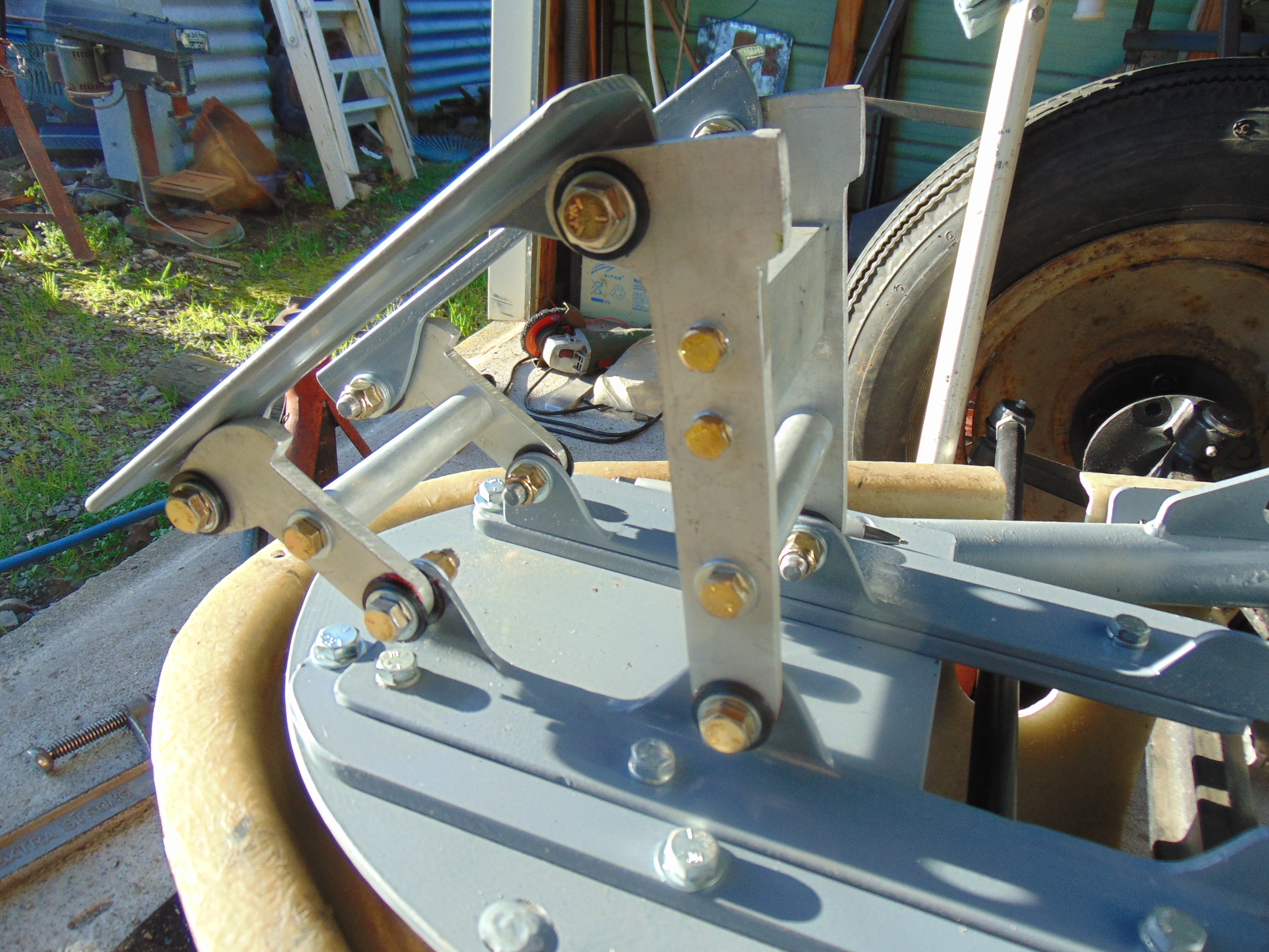

    Painted all the steel parts on the front hinge and ***embled for good and fitted a block to mount a a gas strut on. JW
