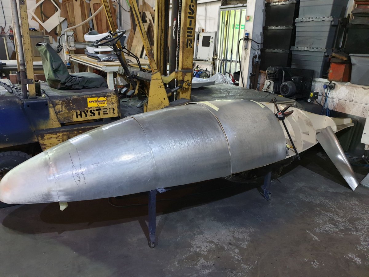

    Well after lots and lots of looking for a P38 drop tank I came to the conclusion I'd headed down the road of unobtanium, so out comes the English wheel and a large tub of elbow grease.
    I'm now about eighteen months into this build now so will post pics of progress so far.

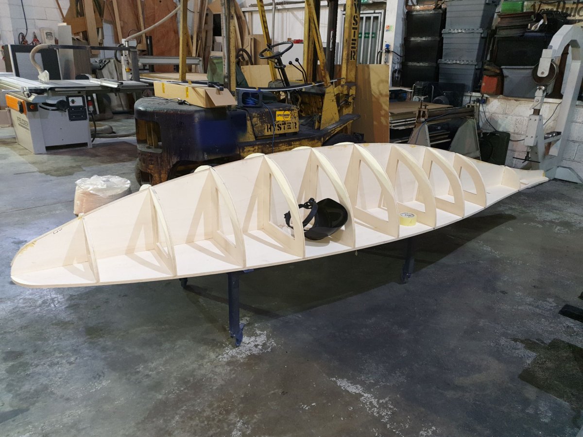

    First off a buck was built luckily my business has a CNC wood router so this was the easy bit.
    Followed by lots of hammering and wheeling.
    Lots more hammering..
    Lots more wheeling...
    This is the bottom side so a section was cut out to make flat bottomed.

    Next bit was shaping some aluminum angle to make the exterior lip using a shrinker stretcher and propane torch to anneal. The tight radius at the back took a few attemts and about ten anneal cycles to get right.

    Welding on the lip
    Then TIG welding in the bottom panel, I've not done much aluminium welding till this project but by this stage I'm starting to get the hang of it.

    Well first side took about eight months of my spare time, the second side went much quicker. Fast forward another two months and both sides of the body are done, still some finish panel beating to do on the top half but this will be done after its had the top cowl built and its been sectioned up into removable panels.
