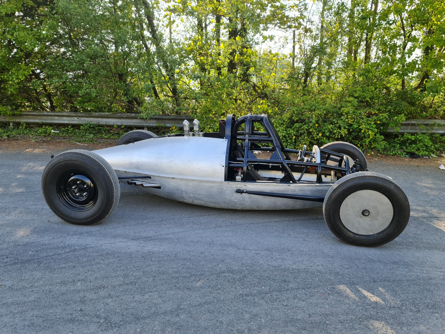

    Well just about ready for the beach, only a few days to go.
    Tank getting some carpark test drive time on the industrial estate, nice and early before it gets busy.
    Front section of the body being fitted. This is as good as the body work gets for now but I do plan to make a top cowl for it and give it a bit of paint.
    Me getting my race face on ..and checking I still fit in there OK, its shrunk a bit since the roll cage padding has gon on.

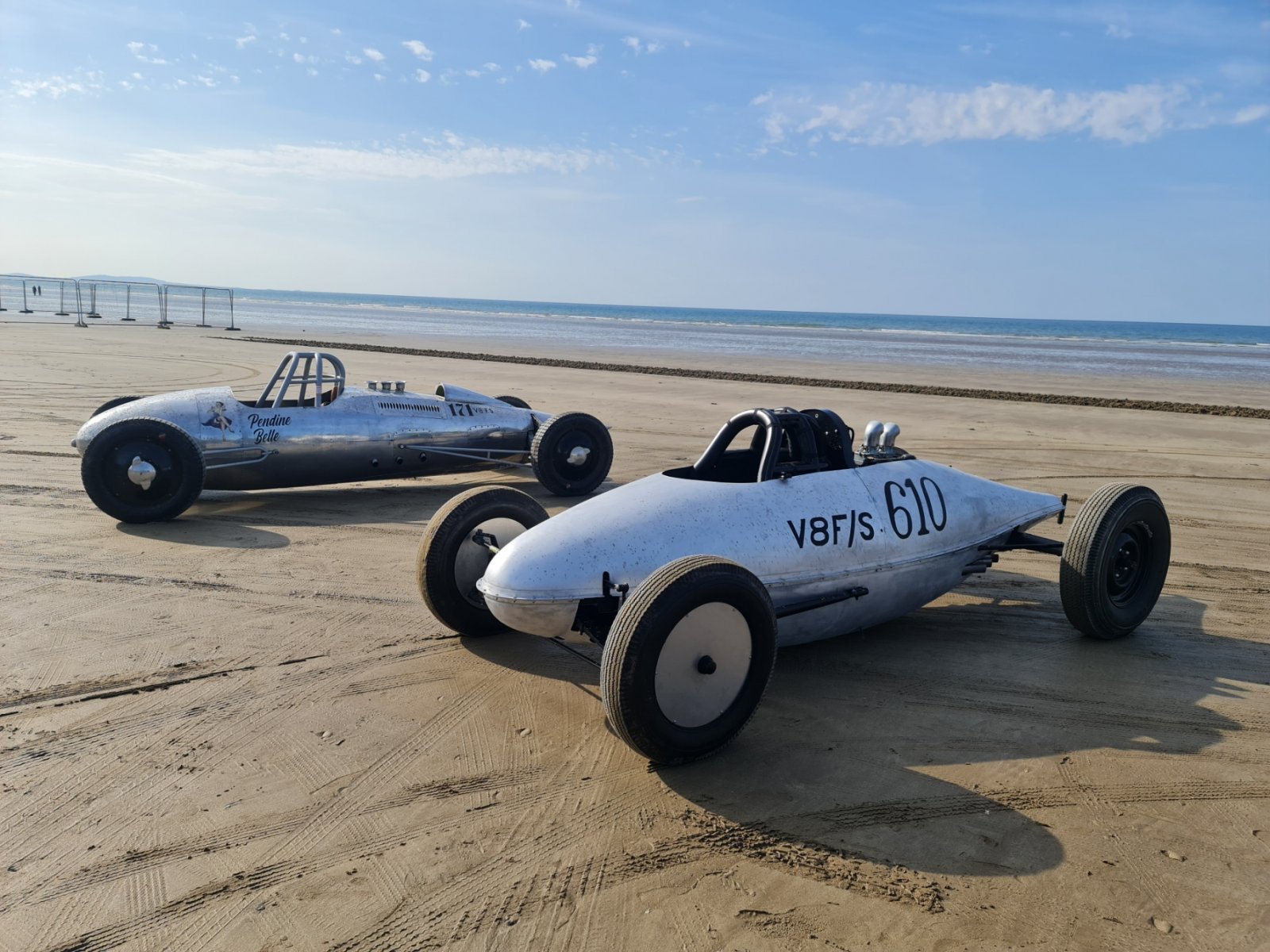

    Important bit first, how fast did it go..I'm last one on the page.
    Nice shot of the early morning pit waiting for the sand to dry a bit.
    Tank with tank crew Geoff, Vanessa my lovely wife, and Steve
    Nice shoot of mine and Brett's belly tanks

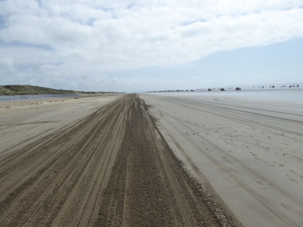

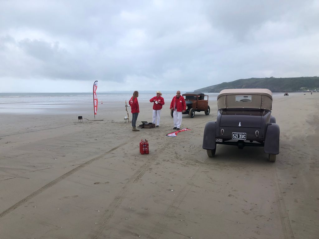

  25. Well there's a question. Now with added images!
    The tide comes in right up to the dunes. What it leaves when it goes out is all we have to play with.
    Over the years we've found an onshore breeze tends to leave us with a smoother surface. Setup procedure is:
    As soon as the water leaves space to get on the beach, around 2 hours after high tide, drive down the beach 1/2 mile from the pit area to find an area to set out the timing area.
    We then drive further down the beach to make sure there's a good straight run off area before we hit the dreaded porridge - a soft area that is typically around a mile from the pit area. Sometimes nearer. Much nearer...
    Back to the timing traps - check the track back to the pit area and measure the 1/2 mile back for the start line. Hopefully by this time a few people have walked up to check the beach for detritus. Over the years we've had driftwood, one ton builders bags, bricks, huge jellyfish, enormous rocks and hopefully no stray bits of metal left by the Ministry of Defence who we rent the beach from.
    With any luck we can mark out a beautiful straight line funnelling the cars into the timing traps.
    The timing trap is marked out at 1/16 mile between gates, 20 yards wide. Checked diagonally as well to within 2 inches because we can...
    Tall flag markers are added at the entrance and exit and the wireless aerial set up before a couple of close runs are made to check everything is working.
    Back to the start line to fix the second aerial and make sure everything is working (this orange haired freak is my son that wrote the timing software).
    Two hours since we hit the beach, four hours since high tide; by now hopefully the track is now dry enough to start running. We then try and run through the race card hoping that everyone gets at least two runs in before we have to tear it all down and get off the beach as the tide comes back in and washes it all away. Next day - do it all again.
    This year the Saturday left us with a beautiful beach with a really wide, smooth and straight run up with enough runoff and no rippling. Because of a large piece of steel tube sticking straight up a few inches, we chose to run further down the beach. It took longer to dry and the first p***es had a squirrely damp p*** with a strong crosswind. As third car out in a tall T coupe I know this! By later in the day the surface was firmer, less like running on jelly, and stood up to around 300 p***es. By this time the water was lapping at the rope marking the spectator line.
    The Sunday was completely different. A headwind left us with ripples and a very narrow smooth band further up the beach towards the dunes. At the traps this was only around 15 yards wide. The porridge was nearer. The steel tube around a third of the way up was the only constant and the track had to be laid dune side, with a gentle 'S' and hope nobody noticed...
