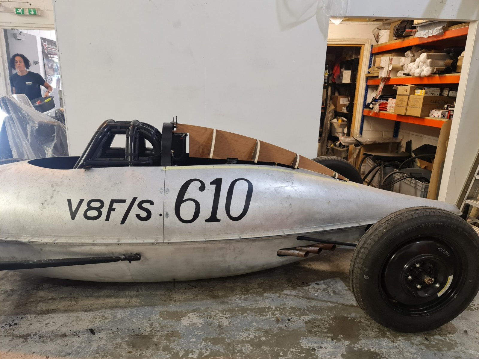

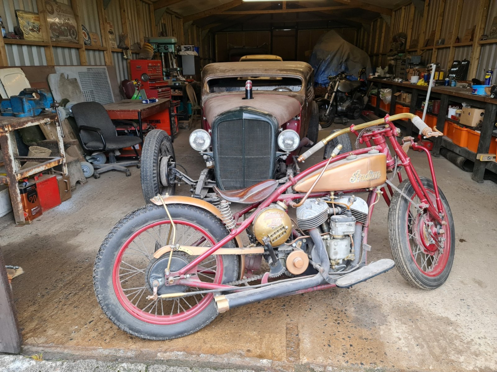

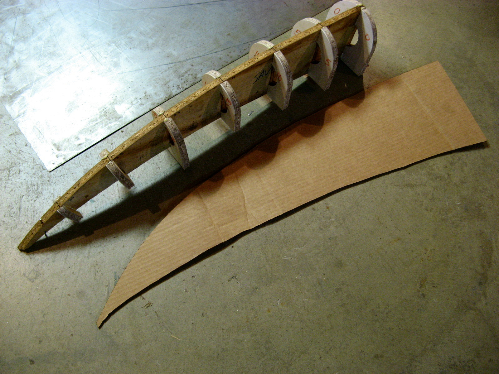

    Well I thought I'd do a litle update on the tank progress, or lack of lately, I worked like a nutter leading up to Pendine to get it race ready so its been nice relax a bit and spend a bit of time away from the workshop catching up with friends and doing general summer things, oh yeah and catching and recovering from a mild dose of the Covid.:confused:
    Next job on the tank is to finish of the body work, main thing to do is make the cowl section for over the engine, so far I've cut out a buck and about to start work with the english wheel, its quite a compex shape so there may be a bit of scap metal generated in the process:D.
    I recently paid a vist to my good friend Bob aka Tommy Toolbox and cant resist posting a quick picture of his impressive shed.... Tank170.jpg

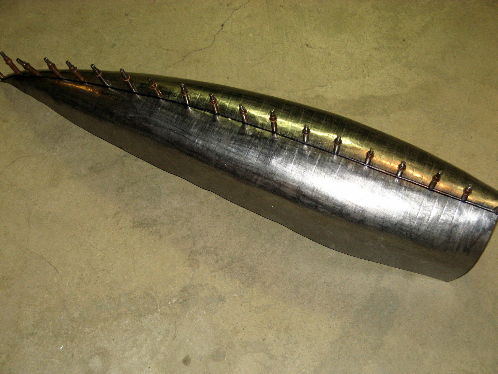

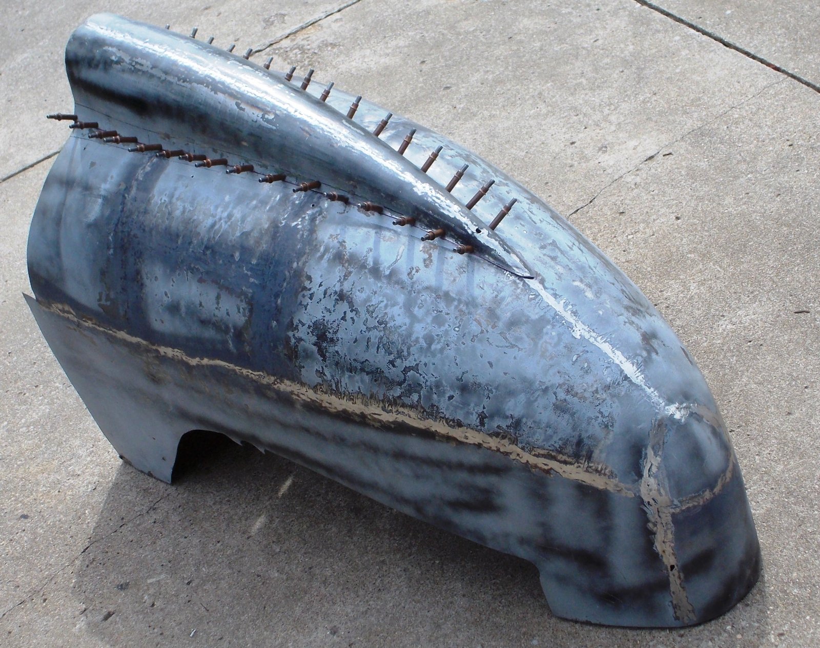

    I'd suggest making it in two halves, or even three strips. Here's one I did for my champ car - similar.
  9. JamieUC
    Joined: Jul 8, 2013
    Posts: 178
    JamieUC
    from Swansea UK
    Nice bit of metal work there. Very similar shape, I'm planning on doing it in quarters, two half's looks like it would work fine as well.

  10. trikejunkie
    Joined: Dec 2, 2011
    Posts: 237
    trikejunkie
    from Scotland
    Hi is that a Basty Bikes Indian I see there ;-)
  11. JamieUC
    Joined: Jul 8, 2013
    Posts: 178
    JamieUC
    from Swansea UK
    I believe so, its quite a work of art.
  12. trikejunkie
    Joined: Dec 2, 2011
    Posts: 237
    trikejunkie
    from Scotland
    Yes they are ,I have the first one made after Sebastian`s(Basty) I took it to Bonneville in 2017 and raced it in AVG500 class.Hand made frame -and I mean hand made , every joint hand made and ground to shape.I think there are possibly 4 in the UK ( 5 if you count my other unbuilt one in the crate)
    chryslerfan55 and JamieUC like this.

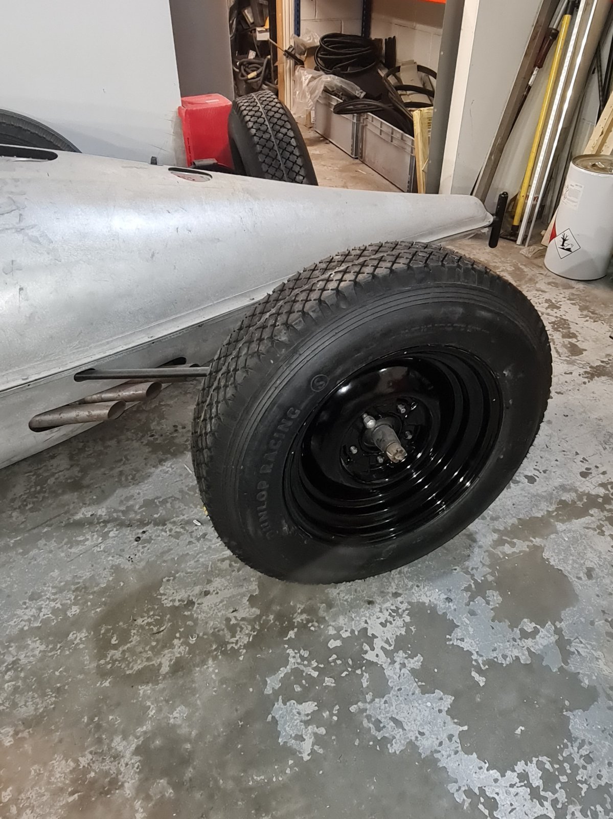

    Finaly got my rear wheels finished, got them sandblasted, painted and a very tasty set of 700 x 18 Dunlop racing tyres/tires fitted. Tank175.jpg
    Almost a shame to cover them up with racing discs but they do look good.

    I like those tires. Is that a model from their Grandtrek series? I do not see that specific design on the U.S. website.
    They would look good on my champ car.
