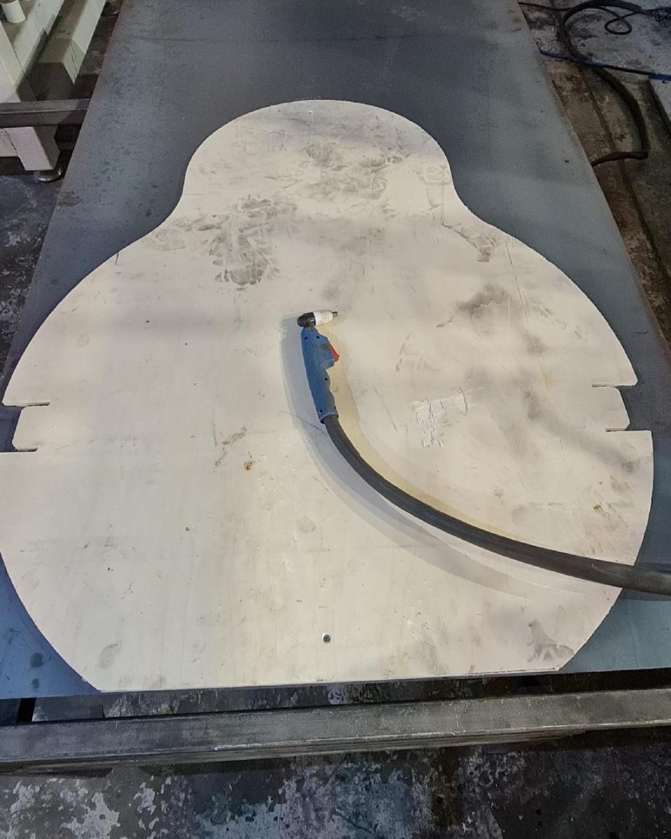

    Some photos of this weeks progress on the tank.
    I've been making a fire wall as I want the engine compartment sealed off from the p***enger space, proably a good idea when you've got a supercharged flathead roaring away six inches behing you.
    Bulkhead is 1/8" steel plate, so fairly stout. First picture is wooded template and plasma cutter, not very traditional but sure makes life easy on a big peice like this.

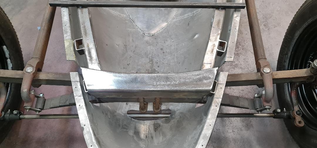

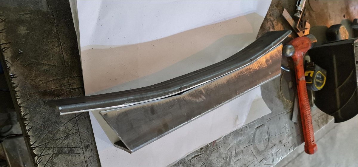

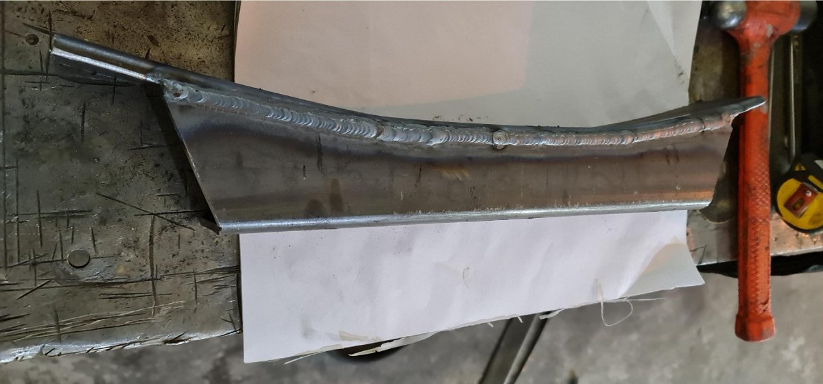

    Also spent a bit of time looking at the ride hight, rear is about right but front is to low so I need to lower the front crossmember two inches, the crosmember I've already made was to narrow for this to work so I've knocked up a new one out of a bit of box.
    Finished and ready to fit.
