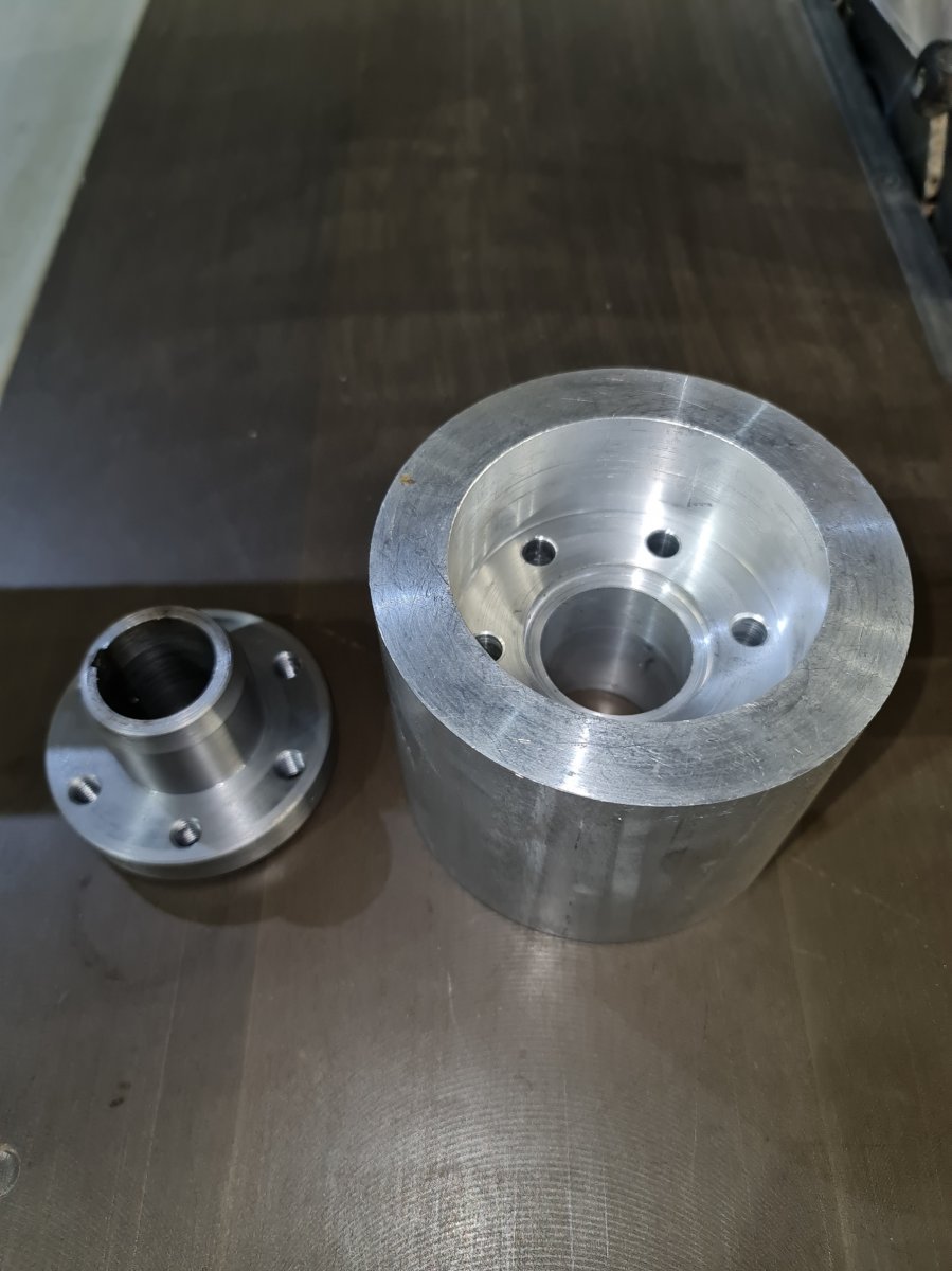

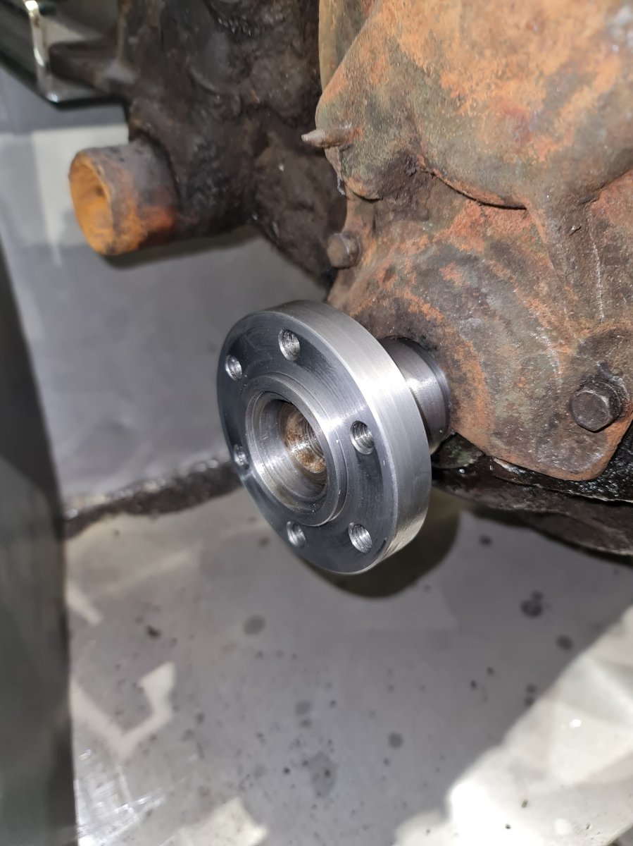

    Not a great deal to look at this week, I've been working on the crank hub to mount the V belt pully for the blower, I could order these parts from the States but I like making this stuff.
    Still got to cut the V belt groves , one for the water pump and three or four for the blower oh and possibly one for the hilborn injection pump! more on that later.

    I reckon making stuff is half the fun, neat job so far on the hub and pulley.

    Nice job on the pulley adaptor. Broached keyway? Pretty fancy stuff. I enjoy a bit of machining, but that is a bit beyond my skill set. Mart.

    Hi Mart
    Yes broached the keyway, never done one before and left it till last job on the hub, was a bit scared I was gonna wreck it but it went very smoothly, made a guide bush then just pushed the broach through with a 10 ton hydraulic press.

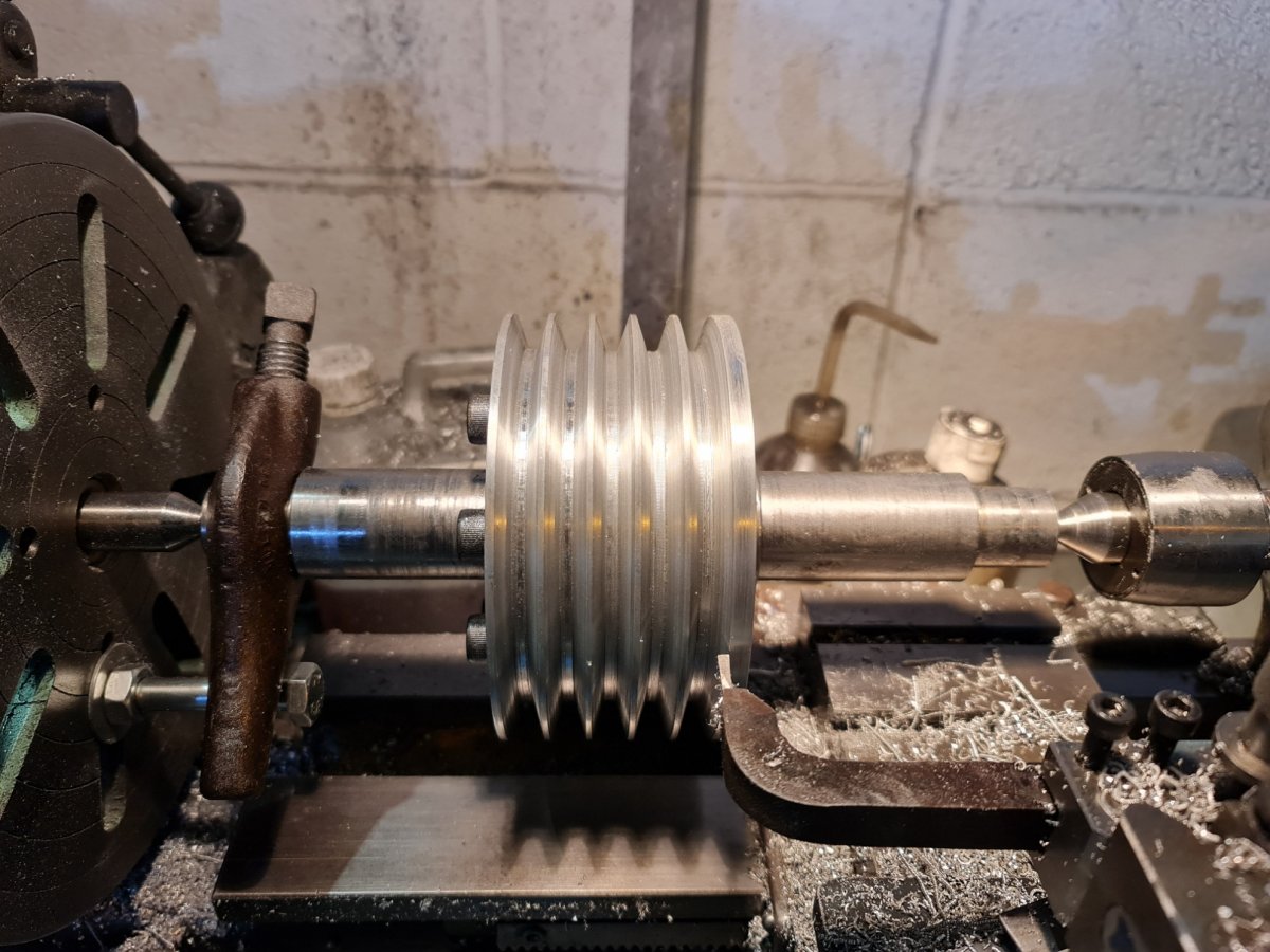

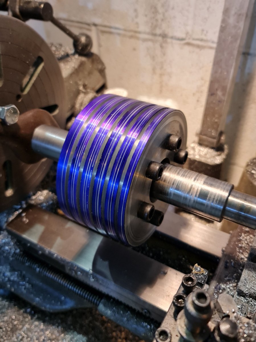

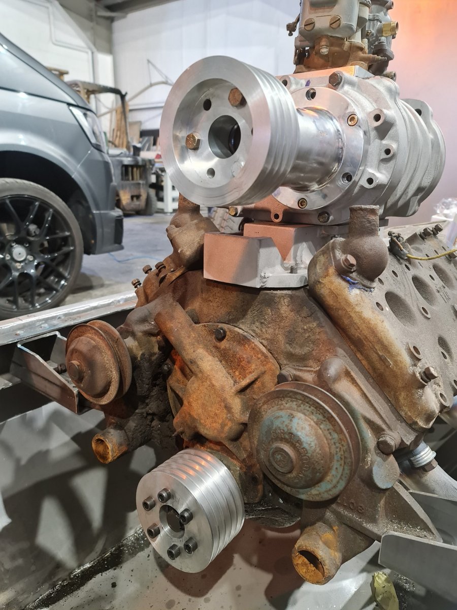

    Got some time in the workshop this weekend, made some progress with the blower pullys.
    Just got to make the ideler pully and a couple of new waterpump pullys. Takes forever turning these but gonna look good when there done.

  29. 282doorUK
    Joined: Mar 6, 2015
    Posts: 525
    282doorUK
    Did you use a form tool to turn the pulleys? If so you did well controlling the chatter.
