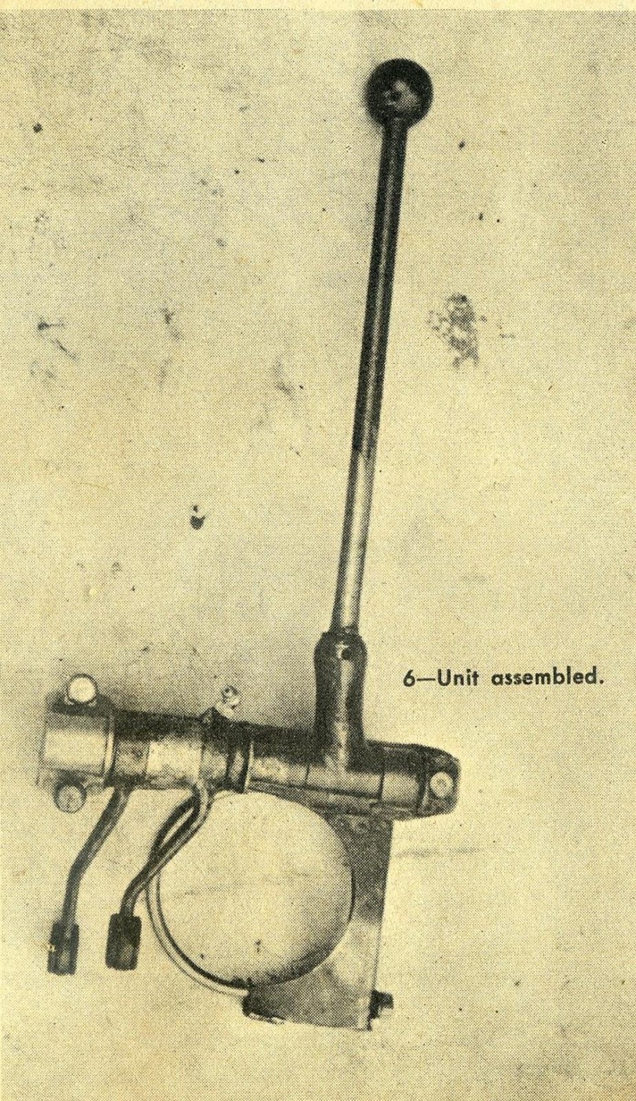

    Plan is to use a 1947 Mercury column change ***embly converted to a floor shifter, this was my mate Steve's idea and he kindly gave me the column ***embly and an artical form a 60's hotrodding magazine about how to modify it. This is a pic of one converted to clamp onto gear box tail, so mine will be a diffrent mount, on to the ch***is, but same principle.
    Here's a link to the artical
    https://www.undiscoveredcl***ics.co...rting-column-shift-floor-shift-vintage-style/
    Gear linkage will be rods so long as I can make it work, otherwise cables, but preferably rods.

  3. Marty Strode
    Joined: Apr 28, 2011
    Posts: 9,710
    Marty Strode
    That was very commonplace in the late 50's , early 60's here. Kids would do the modifications in metal shop at school. The first Mercury's in the states were built in 1939.

  4. JamieUC
    Joined: Jul 8, 2013
    Posts: 182
    JamieUC
    from Swansea UK
    That's cool info, I had not seen this done before so nice to know it was done back in the day. My mistake with the year should have read 1947 not 1937 have edited:rolleyes:

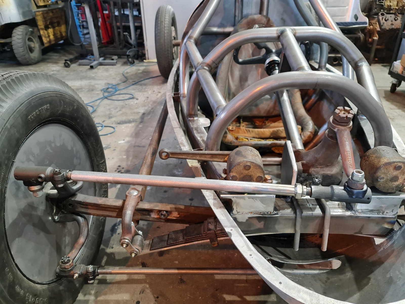

    Do you mind if I ask why you are apparently running your spindles so that the steering arms are reversed?
    Maybe I missed something earlier in the ***ociated text
    I can understand not wanting to deal with punching holes through the body for tie rod clearance but it seems to me that you are making your potential high speed vehicle unstable by discarding the built in Ackerman engineering fundamentals
    Don’t misunderstand, I like your car and appreciate your abilities but don’t understand this approach

    If you put the tie rod behind the axle there is no room for your feet and pedals and going in a straight line Ackerman doesn't come into it. You can go several degrees either way before it starts to matter and if you turn the wheel much more at speed you will be in trouble. My Tank's steering is very similar.

    With all of the engineering going into this build I find it difficult to believe that a person couldn’t get creative with heating and bending the steering arms down along with making a tie rod configuration that would clear the body without creating a clearance problem with the ground.
    If I remember correctly the steering box is 60 to 80 years old. ***uming that it is rebuilt it doesn’t take much slop even if you’re only turning a few degrees to get in trouble. Building using the Ackerman principles is insurance.
    I am sure that I will get beat up for my handle but just the same when I build I take advantage of wisdom of the engineers with my builds. I don’t want to put myself or anyone else in harms way...

    As Tman has already answered everything is a compromise on a belly tank build, in this case its so you have room for feet and pedals in the car.
    Your concern would be very relevant to a non LSR race car, but these vehicle are designed with one purpose and that is straight line speed, no high speed cornering involved....if there is something is going very wrong.
    When deciding to reverse the front spindles Ackerman was a concern but after researching the subject decided that this had little significance for this application.
    Two fine examples of this set up are the So-cal speed shop and the Tom Beatty belly tank both very successful cars with steering arms out front and no correction for Ackerman.
    As you have suggested the steering arms could be heated and bent out to improve alignment, and may well be if this is consider an issue during testing.

    The HA/GR in my avatar has 7 degree kingpin inclination with reversed spindles and ****** all Ackerman principle. I only want it to go in a straight line, not worried about self centering steering. It's a ***** to turn at the end of a run but you can let go of the steering wheel at 100 m.p.h. and it runs true.
