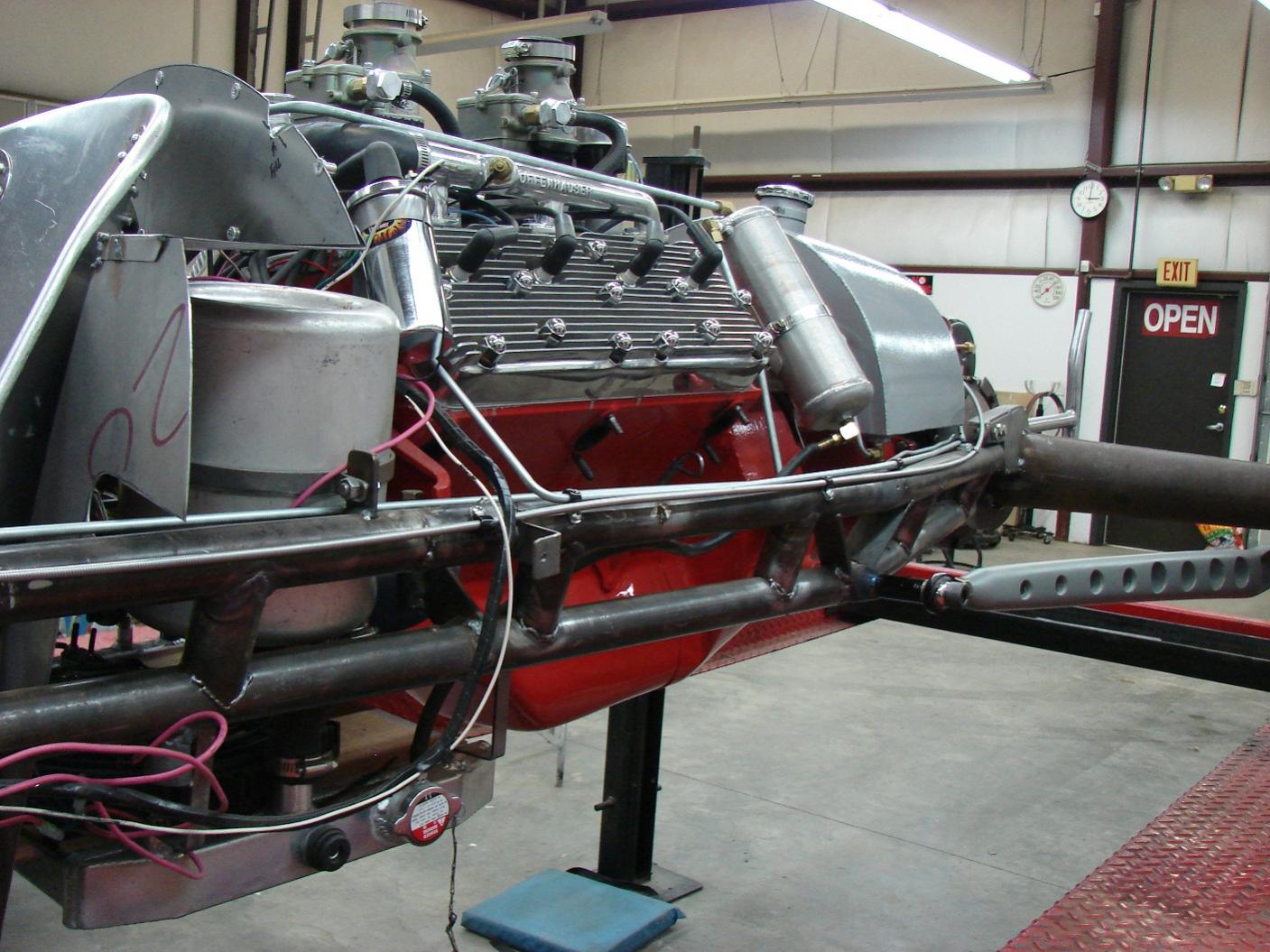

    DSC02559.JPG DSC02555.jpg DSC02553.JPG 014.jpg 007 - Copy.JPG For those of you who have been watching the build on my website, I`ve just added a new page. I`m getting close to the end, but there`s still a lot of work left to do.

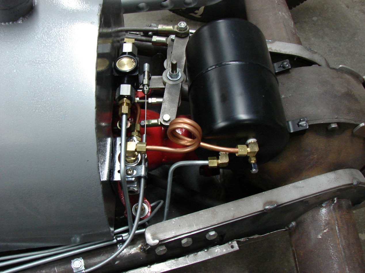

    Nice! What is your brake remote reservoir from?
    Thanks

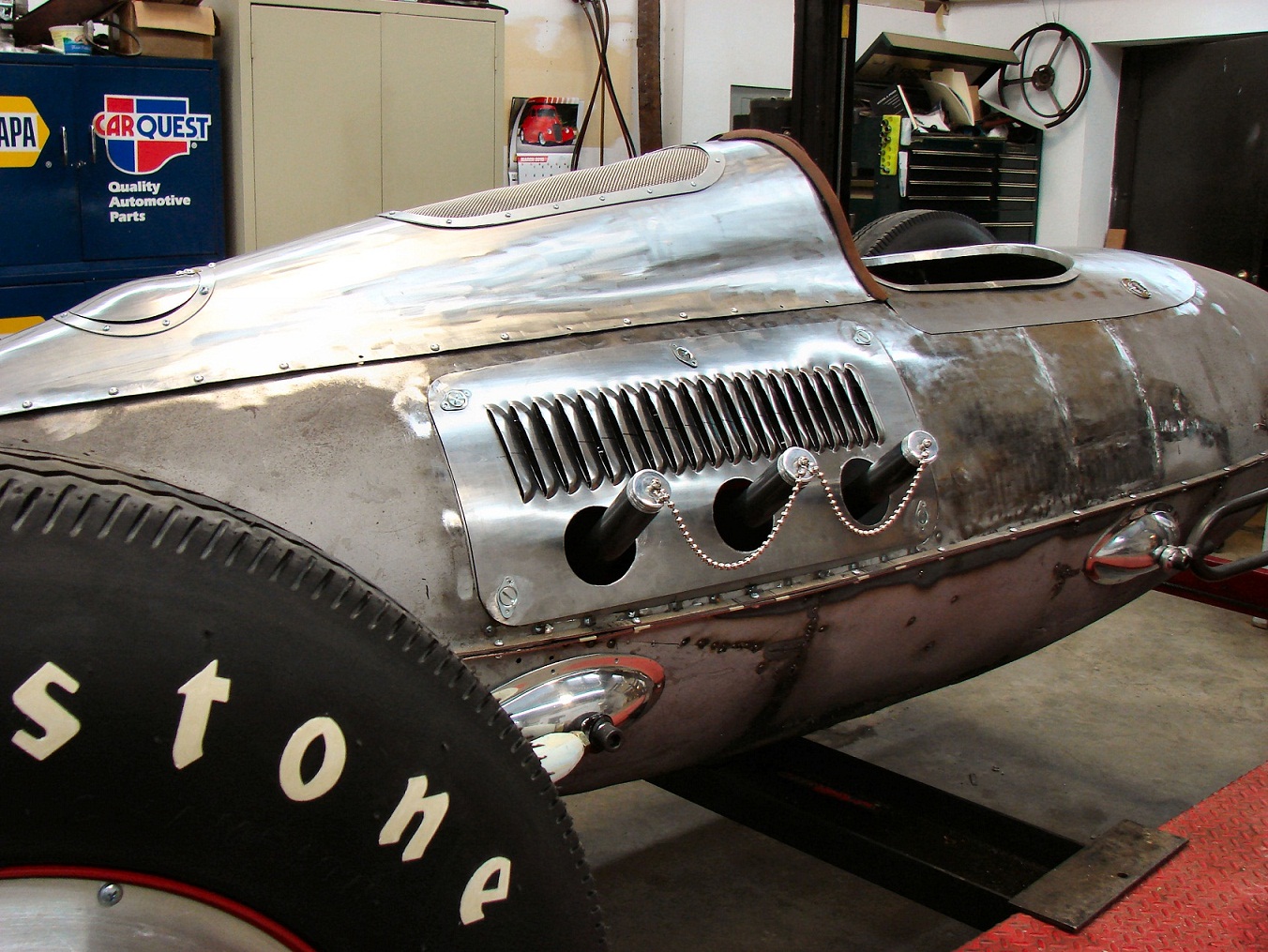

    Very, VERY nice. Nice fab work, and the dash looks killer!

    The brake and clutch resevoir came from Speedway Motors.

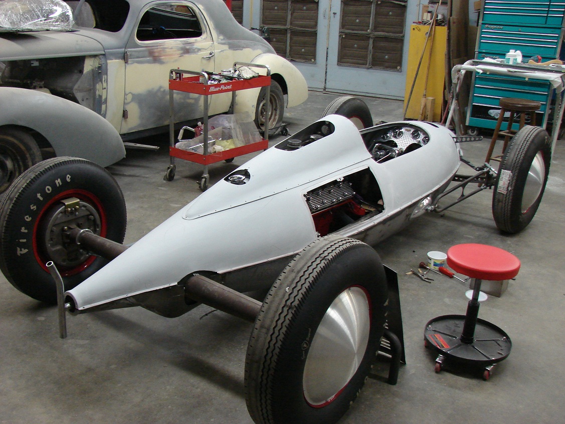

    SaltyTanks2.jpg OK guys, when I started to build this car, It was going to be a re-creation of a car that would have been built in the `50s or early `60s. As time went on,I`ve been working on this since 1994, I realised that the car could actually be run on an ECTA track if I complied with the rules. This ment quite a few mods to the car, but I figured I would see if I could make it work. I`m not going to take this car to Bonneville, but I will take it to Maxton this spring if it`s ready in time. The reason the roll bar isn`t in place is that I`m making it to fit under the headrest and to allow the engine to be removed and clear the body. The "old Crow" car has a similar roll bar set up. Some tank cars have such a tall roll cage that it defeats the whole reason for using the tank for a body in the first place and just kills the aerodynamics of the car. If I make it to Maxton , I`m just planning to have the tech guys tell me what`s needed to make it legal to run. If it p***es I`ll run it.
    The only reason we all build cars is because we enjoy what we`re doing and I`ve enjoyed building this car. If it gets to run then I`ll run it. If it doesn`t, well then I`ve had fun building it and that`s ok with me.

  23. Very nice work......
    I noticed a sticker on the right front tire and one inner tread row was worn out like the right rear? Are they used tires, I missed the rest of the build.

    The tires are Firestone Indy tires. The tread design was used in the early `60s for about a year. They then changed to a smooth design. The tires are new reproductions. To see the rest of the build go to my website http://mccainautomotive.com

  28. Yep, I talked to a buddy that ran Indy cars in 1959 and he said one tread was missing on the outside as most ran negative camber and this area did not wear...slicks the next year. Are the reproductions rated to run over 200 MPH?
