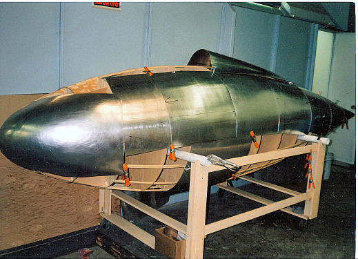

  16. sailingadventure
    Joined: Feb 11, 2007
    Posts: 283
    sailingadventure
    DSC00152_edited (1024x768).jpg Partial Body.jpg Pictures of Buck for bonneville car.jpg Here`s the one I built. It`s 13'6" X 42". After I was finished with it I didn`t want to throw it away, so I hung it over the spray booth.

  17. hotrodderhaag
    Joined: Jan 22, 2007
    Posts: 2,147
    hotrodderhaag
    Dont know anything about the company other than looking at the website and thinking some day.....some day :)[/QUOTE] some day some day is my thought too so im not putting it off anymore :)
    thanks im gonna try to make a hand formed tank. i think it will be nice.. even if its just a tank sitting in the garage.. thats enough of a conversation piece for when the guys stop in...
    lot of guys i have read would like one, but 900-1200 is a litte high for one in my opinion. just because i have seen fibergalsss products of that size and that simple of a design for less.
    do you have any information on your build?
