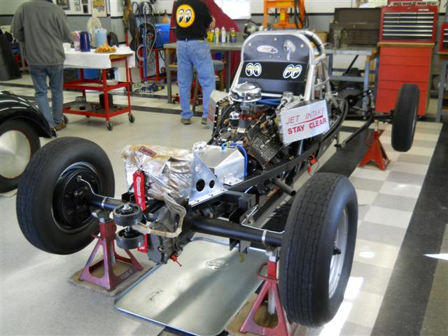

    before you get too involved order a current copy of the official S.C.T.A. rule book - scta-bni.org - to figure out what class you want to run in. suspension? no pot holes, etc to worry about. see pic for frontend & more in a legal Salt belly tank

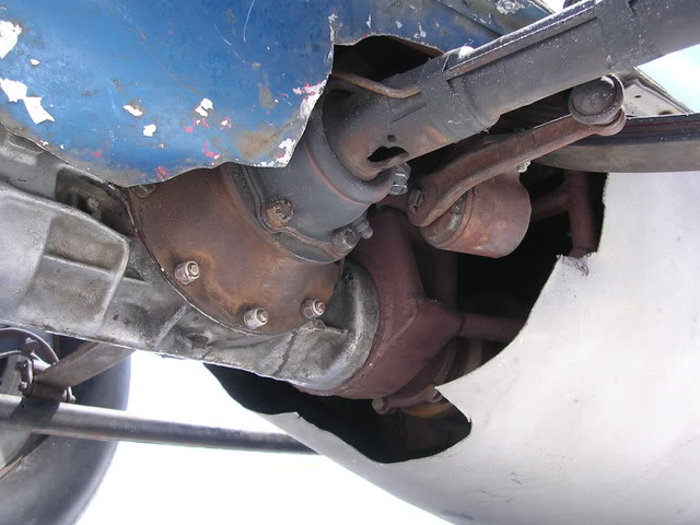

    One of the most successful tanks and most respected was the Markly's 260. It had a swing axle rear, I believe, made of mostly early Ford parts. Kenze and Leslie seem to have been first with this set up. It is what is on my roadster. With cross torsion bars the rear is very clean. Pinion is fixed. Wheels move. The front of my roadster also has inboard torsion bars to keep junk out of the breeze. A very proud member of the Rod Riders.

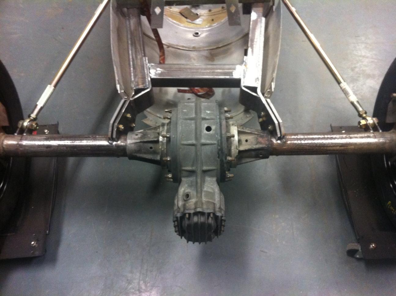

    Something like this could work. Just have to find the right parts...

    This is a picture of what I was trying to discribe just above. Mine uses Lincoln torque tube ende and u joints attached to the Ford bells and stub axles. The axle housings, brakes and half shafts are "56 Olds,obile parts.Has been working fine for 45 years or so.

    I don't think your picture loaded Rich

    I am pretty sure Rich meant the pictures I uploaded. What was used for a universal joint at the pivot point? I am assuming that the differential was connected to the universal joint using a splined pin?
  15. RichFox
    Joined: Dec 3, 2006
    Posts: 10,020
    RichFox
    fordrat. You are correct on all counts. The u joints are from per '49 Lincoln transmission output shaft to drive shaft as are the external ball connectors. Standard Ford parts in the old days. maybe not as easy to get today.
