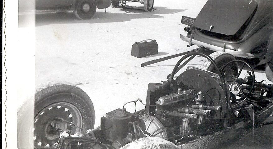

  15. Bearing Burner
    Joined: Mar 2, 2009
    Posts: 1,217
    Bearing Burner
    from W. MA
    I have one that Jerry Kugal drove over 200 MPH with a 260 Ford Fairlane engine in the mid 60's.

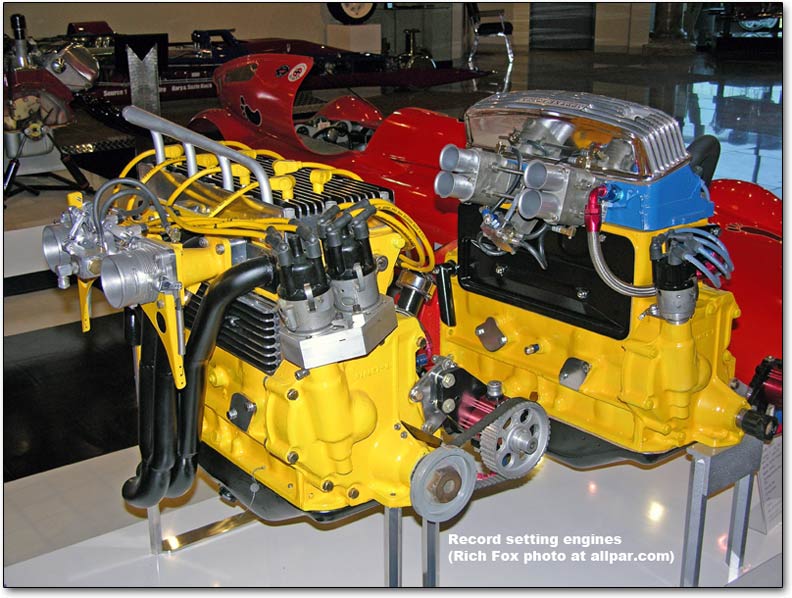

  30. RichFox
    Joined: Dec 3, 2006
    Posts: 10,020
    RichFox
    engines.jpg That will work. But just to be different, if it was mine I might run one of these throttle bodies on the upside down intake and drill for nozzles in the runners. Score a pump and metering block somewhere and make a pill box to use Holley jets for the return. That seems to go more with the idea of a Willies powered tank for the salt. Maybe I would make a cool twin plug flathead and dual distributor drive while I was at it. Why be normal?
