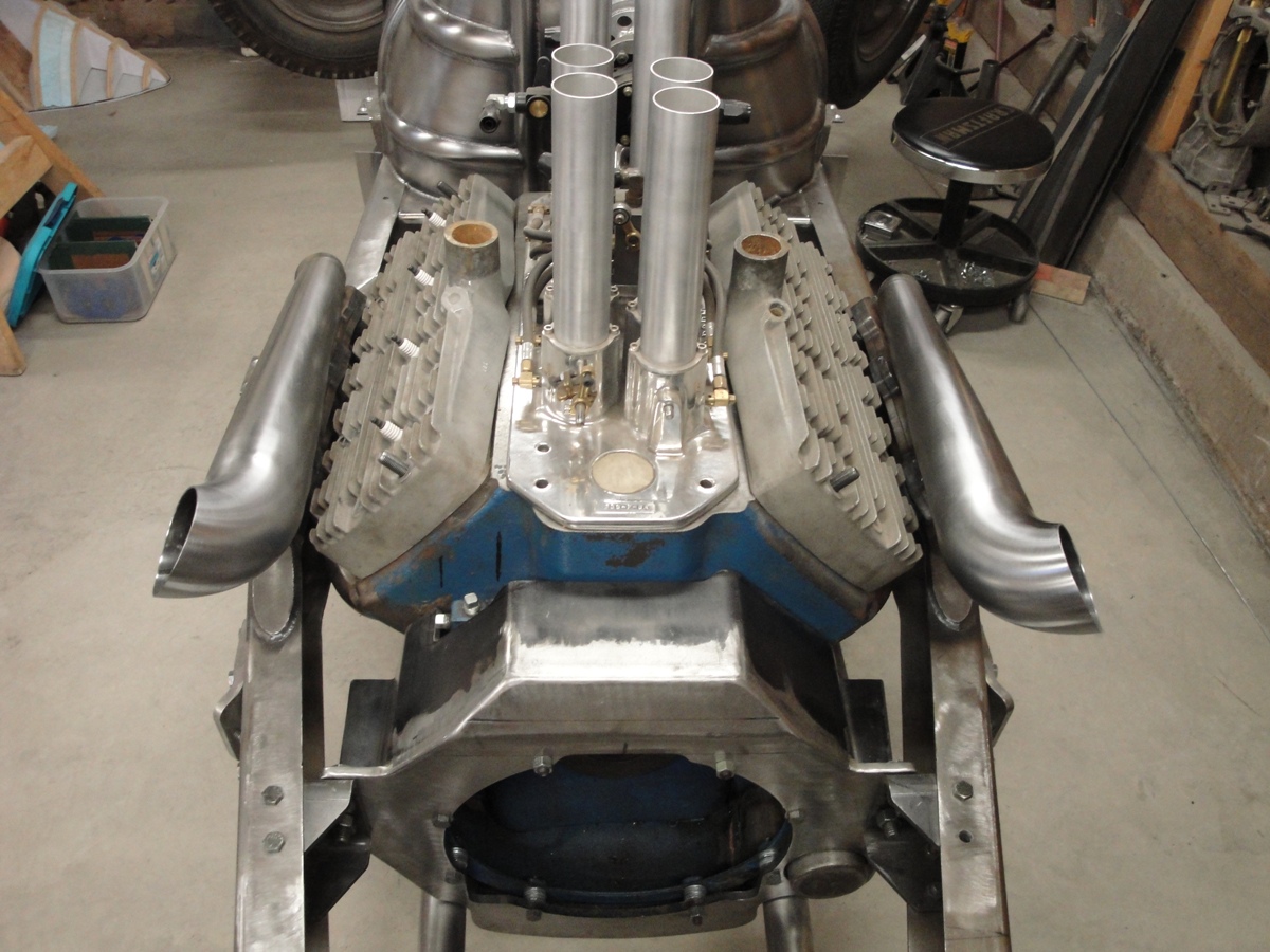

    Wow, its been a long time since any update so here we go. Still in process, working on it as much as possible, so many details.
    Last summer I had to take a break to pour new concrete in the garage, so the tank got rolled around the block into my wife's garage. This proved to be quite the experience with limited ground clearance.
    The pictures will speak more than my description but have worked at plating the rear of the cage and sealing the engine compartment from the drivers area. Some of the pics show bellhousing shield and lower frame tubes for added stiffness. Also some tubes and plates on the front of the cage for foot protection.
    One main change has been changing from a water tank to twin radiators and electric fans for engine cooling. I was afraid with the water tank capacity if I could keep the engine cool, especially if ending up sitting on the line idling for too long. This also allowed easier access and mounting of fire extinguishers and a few other items.
    Also parachute frame, gauge mounting & canopy frame, headers, etc...
    Still a huge list to do, alot of parts laying around still to get mounted.
    More pics to follow.
    Andy

    The tank above the bell housing will serve as an upper radiator tank & fill point, electric water pumps will drawn from there and push through the radiators into the block.
    that's all the interesting pics I have for now, time to get back to work.
