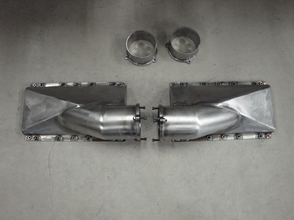

    Here is some more recent work with my radiator fan shrouds. They are actually a structural piece that reinforce the lower frame tubes and hopefully will act as ballistic shields in case of bottom end flathead carnage. The tubes each get a ducted fan intended for extreme brake cooling. Pretty cool at under 4" dia. and will each flow up to 500 cfm with adjustable speed.
    Thanks again for the feedback, Andy
