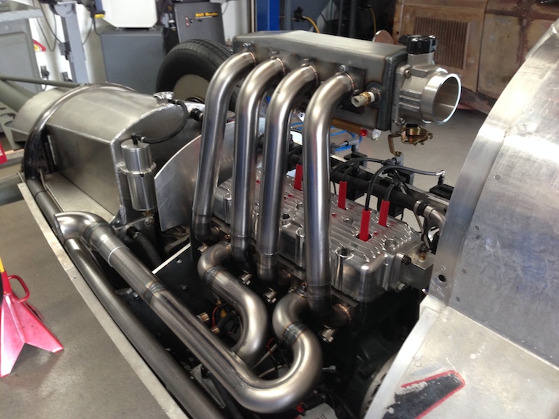

    Well, it's been a long time since I posted an update on here. After a bunch of upgrades, a canceled trip to Bonneville, and a pair of trips to Loring and the Ohio mile, the racing year is behind us.
    So now what?? First it's a trip to the Jalopyrama show to show off the new upgrades and help promote the Save the Salt cause here on the east coast.
    If you are coming to the Jalopyrama this weekend stop by and check out the Blonde *****.
