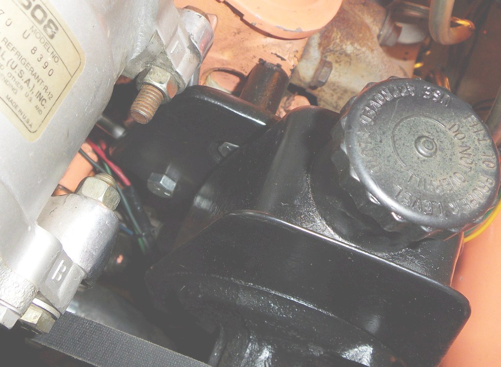

  9. bracket recess.jpg Update.
    The only threaded boss I could use to mount some type of backside idler would make the belt do a 90* turn. Would give me lots of clearance, but a lot of load on that idler mount. That, and the fact that car is all together, I could barely reach the area, let alone work in it. I filled and re-drilled the holes on my pump bracket, so that it would move closer and higher on engine. I recessed the top mounting bolt, so that I could swing pump closer in as well. These modifications changed the belt angle, and gave me better clearance on the hose.
