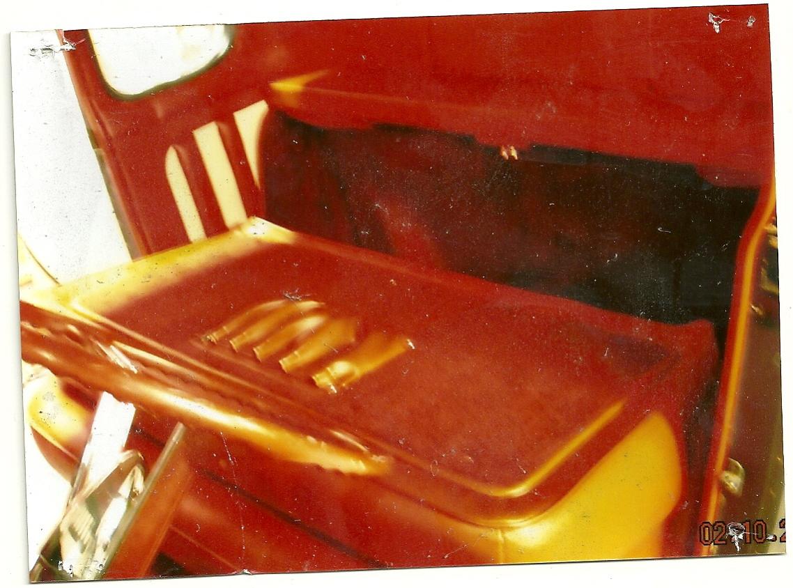

    So why is it useless. We modified this one so it would fold like a bed. Also built a package tray to fill in the void behind the seat. Which is where we mounted the speakers.
