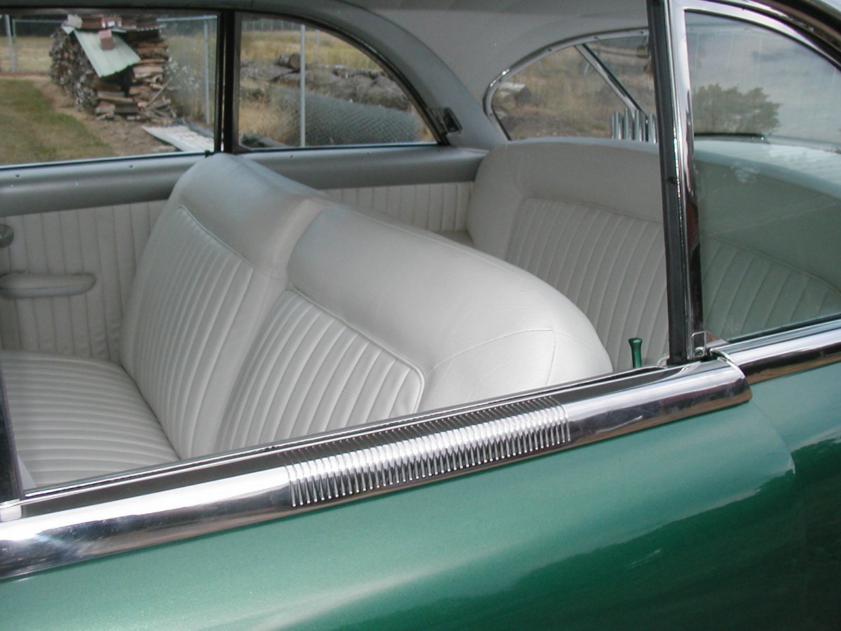

  2. Well for me, in my car nothing but the original would be correct. I can tell you that when the fabric out and the foam turns to dust the other issue is the spring ties are also gone. Now you have no support to sit on. Unless the springs are broken all that's needed is to put it back together as it should be. That's what a good upholstery guy will do for you. My seats were gone and now they are not. It sits and looks correct and after 45K miles it's still looks Correct. This was done in house as was the total car. You don't have to brake the bank to do a nice job.

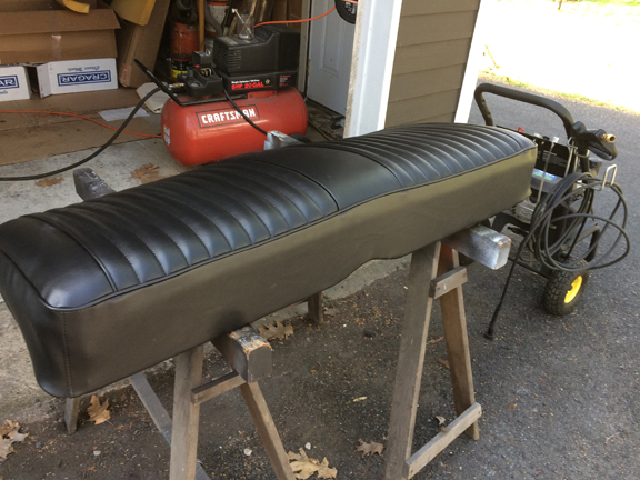

    IMG_1322.JPG I'm no upholsterer, but when I did my seats I tied the S springs together with some plastic zip ties and I ran some heavy wires across the length of the seat. I actually used electrician's fish wire which is flat and very stiff like spring steel. Then, as a base layer, I hog ringed some canvas across the tops before the foam layers.
    The goal is to get the springs to help each other.

    Wow that looks nice! I must just be a dumb*** cause mine just looked ok and feels terrible. Thanks for the tips. Ism a ways out so I have time to year it all down and re do the springs if I can't talk my so******t friend up north into it. Thanks for the pic

    Thanks, but actually I accidently over stuffed it. It's comfortable, but I sit too high and I'm not even very tall. I'll be removing an inch or more of foam sometime soon. BTW, I layered 2" foam + 1" foam, plus 1/2" batting.
    If you flip the seat upside-down you can do some work on the springs without removing any upholstery.
