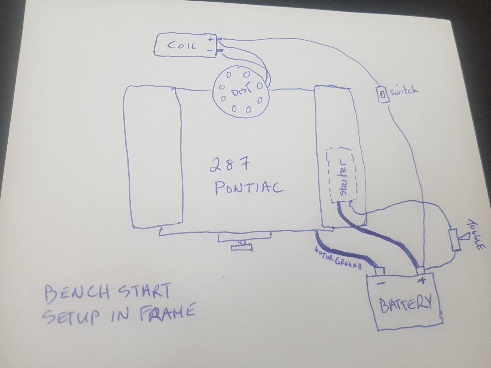

    Hi,
    I have my Pontiac 287 in the frame set up for a bench start. I've drawn a diagram below to show my set up. I'm not concerned about hooking up oil pressure. All plugs and wires are new and the firing order is correct. I'm running a Mallory coil (#29216) which has .700 ohms primary resistance and 8.90k ohms secondary resistance. My Pertronix ignition module has burnt out, so no more spark. Is my coil incorrect or is my bench start set up incorrect?

    Posts: 20,470
    Tim
    from KCMO
    Are you missing a ballast resistor in the pos wire to the coil?
    427 sleeper likes this.

  11. DaveDCanada
    Joined: Jun 19, 2023
    Posts: 88
    DaveDCanada
    Also guys, does the bench start diagram look correct? Am I missing anything?
  12. Bench start diagram looks fine, if you can use a spring return to centre toggle switch on the start solenoid circuit, it makes it a little easier when it fires up (you may get excited and leave the solenoid "On" when she lights up!)
  13. Tim
    Joined: Mar 2, 2001
    Posts: 20,470
    Tim
    from KCMO
    Yeah looks fine otherwise
