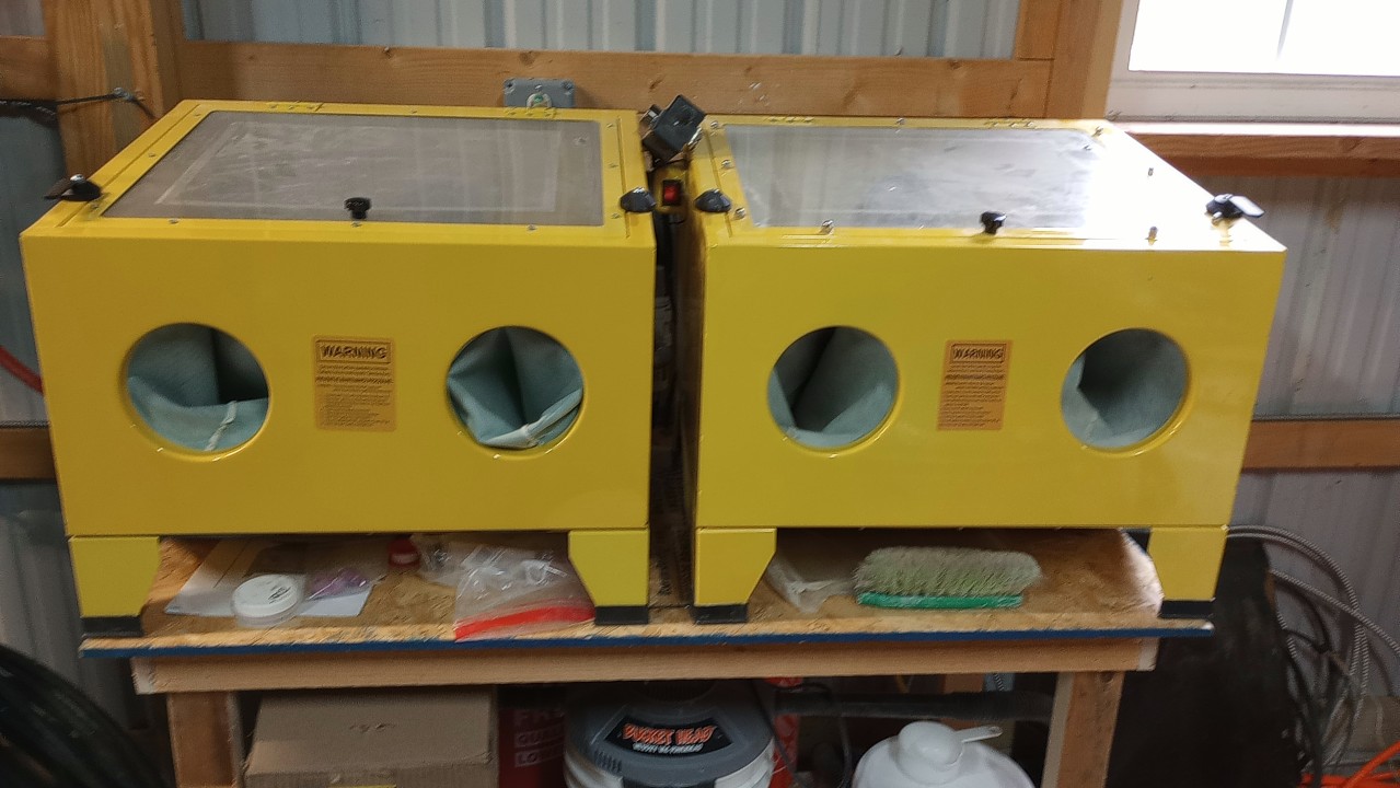

    I have two Jeg's benchtop cabinets. One is for soda and the other for medium gl*** bead. They each have a 5 gallon cyclone and I use one vacuum. I move the hose back and forth between the cyclone buckets.
    Soda doesn't work well as they come. No flow to the pick-up tube. I cut the top out of a gallon jug to make a big funnel. It fits under the perforated floor. A notch in the neck fits over the tube. I cut a piece of cardboard to fit the floor of the cabinet. I cut a hole in it over the funnel. As the soda piles up, I sweep it back to the funnel. You can keep working much better.
    Gl*** bead works way better. The pick-up hole is off to one side. You end up moving material end to end to keep going. Mostly, I tilt the cabinet.
    They each have their own regulator/water separator. I run the small nozzle and 75psi for soda and a medium nozzle at 90psi for gl***. The soda won't etch the plexi lid. I don't even run a tear-off. Gloves will last forever. Gl*** eats the tear-offs up. One carb and you are looking through fog. The gloves are 7x bigger than I need. I waste a ton of time and effort fumbling. I've taken to wearing cloth gloves to fill up the mitts a little. I have a 5hp-60gal-150psi compressor. Between soda, gl*** and blow off, it will run 8-9 times to do one 2bbl. It is hard on your compressor. Soda makes a total mess. Some goes right through the vacuum. I have a router speed control on the vacuum. I found that you can have too much suction. Wastes media. I probably use about 75% on my rig (Home Depot "Bucket Head" vacuum, both gl*** and soda). Run the exhaust outside if you can. I still have to put a hole in my wall. It also blows out of the smallest leak in the cabinet. When you work on shoveling it around you will get covered and the dust goes everywhere too. It's part of it. At least it makes everything "fresh" :) Gl***, while still a mess, is not near as bad. I can feel it on the floor around the cabinets. It gets around. They both get continuously finer. I have re-used the soda out of the cyclone bucket. You keep getting finer, and dustier. The stuff in the vacuum is finer than talc, you'll make a mess just throwing it out. Moisture is the enemy of soda. It won't flow at all. I keep a 2 pound bag of desiccant in the cabinet. I dry the bag in the oven often. With gl***, not near as much gets ****ed out of the cabinet. I add some fresh occasionally, keeps up the grit content. I have not looked in the cyclone bucket. The fine soda works great on carb bodies. It won't touch rust on steel at all. That's why I added gl***. Gl*** has worked good for that. I have done ~150 carbs with the soda. I've used about 50#. I've done ~25 carbs with the gl*** and am about 1/2 way through 35#. The gl*** doesn't go away as fast, most of what I have used was to fill the cabinet. The Jeg's guns seem ok. The soda gun will last forever. I can see the gl*** working on the nozzle. It's not going to last forever.
    It would **** to empty out the soda and switch to gl***. The soda it a total mess to move around. Two cabinets is way better. Jeg's are only $117 these days (came way down between my first and second).

    The cabinet, media and a spare gun made free freight. I did spend some money on plumbing and regulator/water separators. Blasting is so much better than the alternatives, I put up with it.
    Mike
    Edit: The Jegs cabinet is welded and mostly ***embled. It only leaks around the lid.
