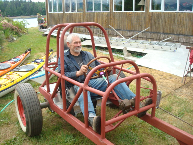

  17. wuga
    Joined: Sep 21, 2008
    Posts: 729
    wuga
    This cage of 1/8 wall 1.75 DOM was bent on a Speedway bender.
    Warren
    saltflats likes this.
