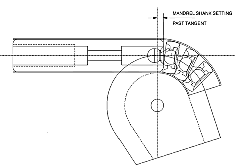

  29. budd
    Joined: Oct 31, 2006
    Posts: 3,478
    budd
    i have looked at pics of that type of bender before and i think without to much trouble you make it into a mandrel bender, just a plug mandrel. that would get rid of the wrinkles. heres a pic of a segmented mandrel, a plug mandrel does not have the little dunuts on the end.
