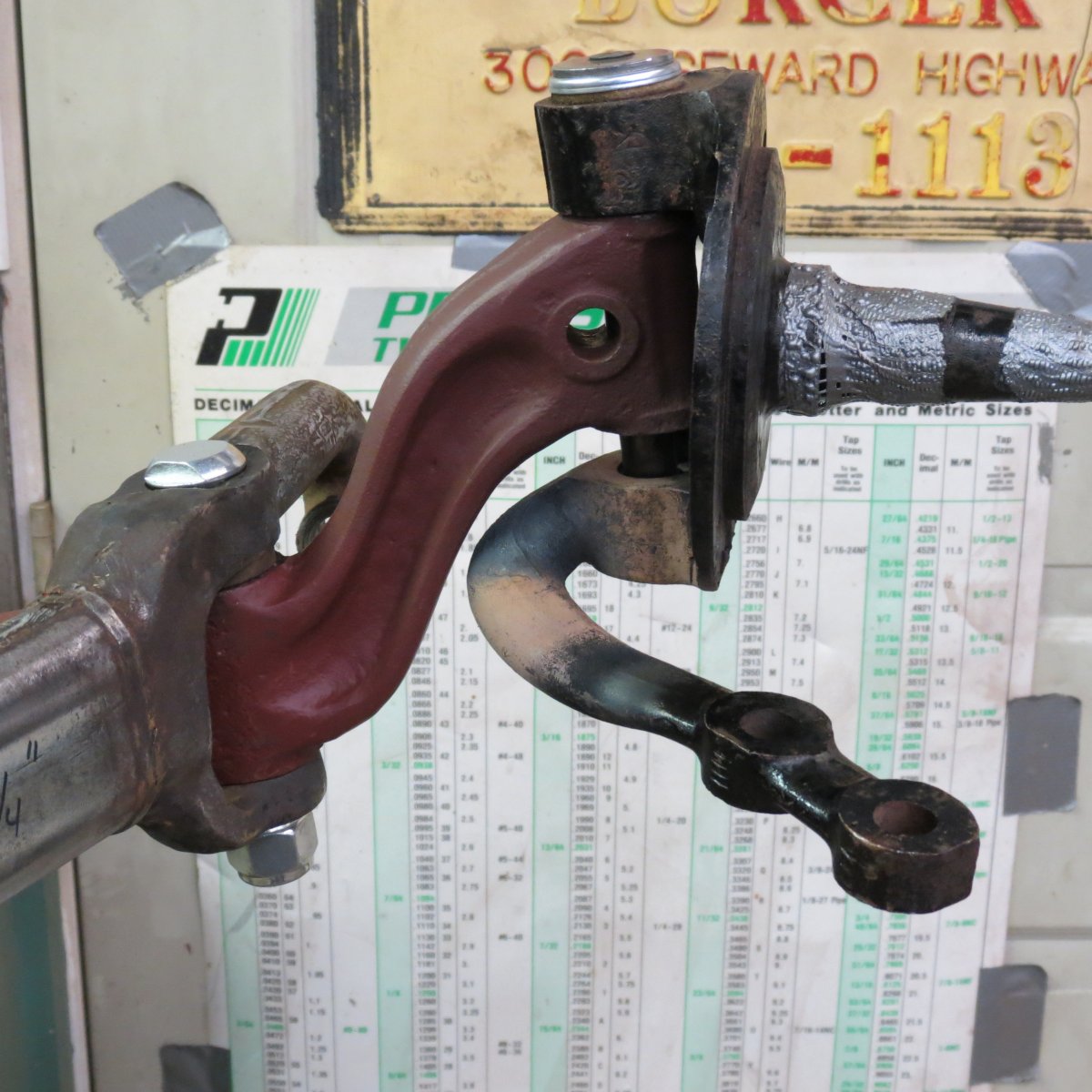

    IMG_2532.JPG IMG_2533.JPG IMG_2534.JPG IMG_2535.JPG IMG_2532.JPG IMG_2533.JPG I'm building a 40 ford dropped axel to swap under my 36 coupe. I need to heat & bend the steering arms for the tie rod to go either over or under the wishbones. It would be easier & less bending to go over than under. The question I have is, is it ok to heat & pull the steering arms to the outside (toward the tires) and then back straight. As it is now the steering arms hit the axel on both insides. If I did this would it stretch & weaken the steering arms at the point that they are formed at the lower bushing boss? See pictures. Thank you. Bill

    F&J, Thank you. I don't think that I will have to bend the steering arms up very much as they are only about 1/2" from the top of the wishbones now and the tie rod ends might have enough height to clear.them. I am more worried about streaching them rotating them outward. I plan to take measurements to try to keep the ackerman angle correct. I plan to put this ***embly together and swap it out with the one under my car. The axel ***embly in my 36 is been there for I don't know how long, and is kinda glued together and there isn't enough room under there to beat it apart. I tried to just swap the axels but couldn't get any of the pins to budge., even with heat. I'm doing this outside & it's on the verge of cold out up here. So swaping everything out is the easiest way. I want to take this axel & another outside to have Greg Haynes at Anson Dropped Axels do his thing to them next time I go out.. Bill

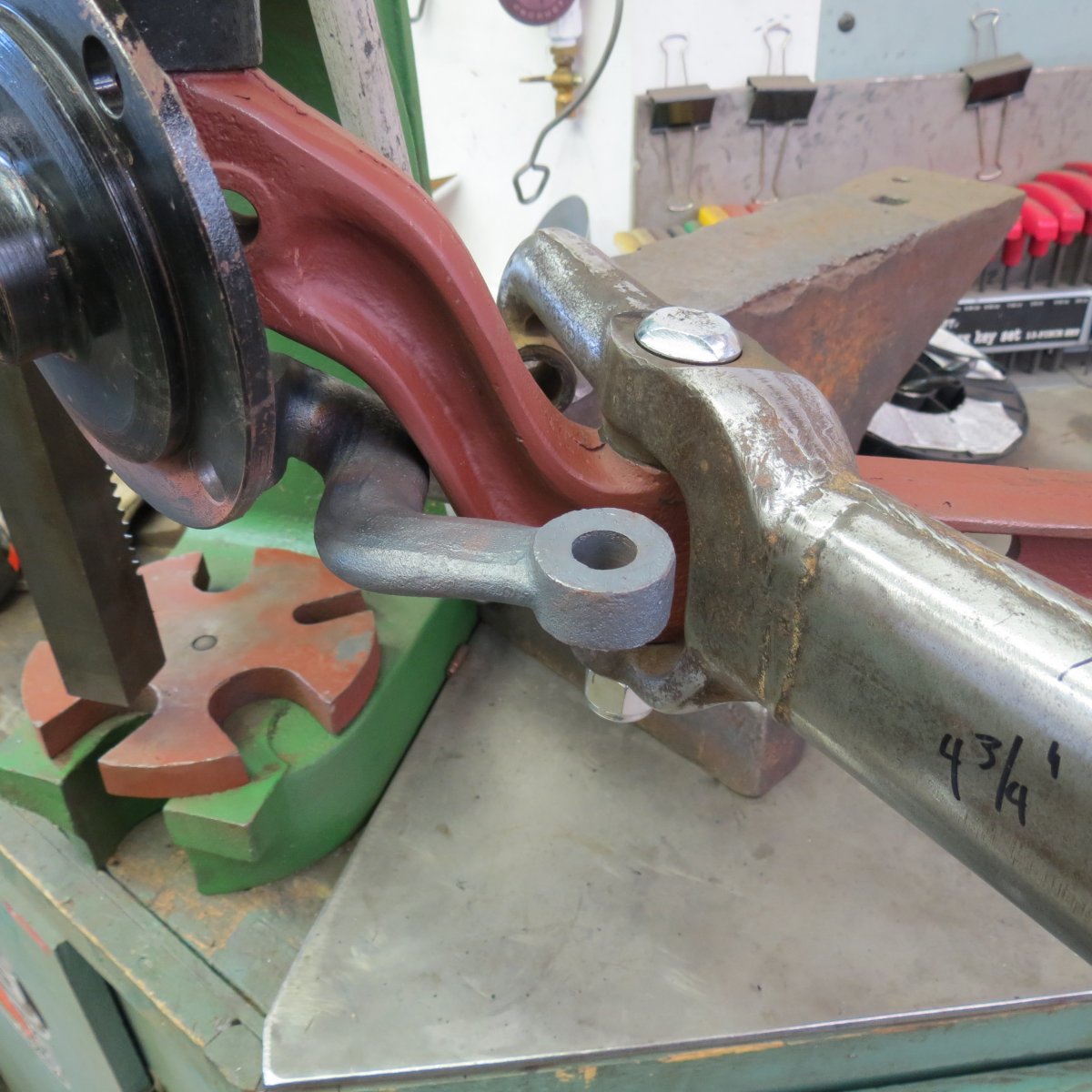

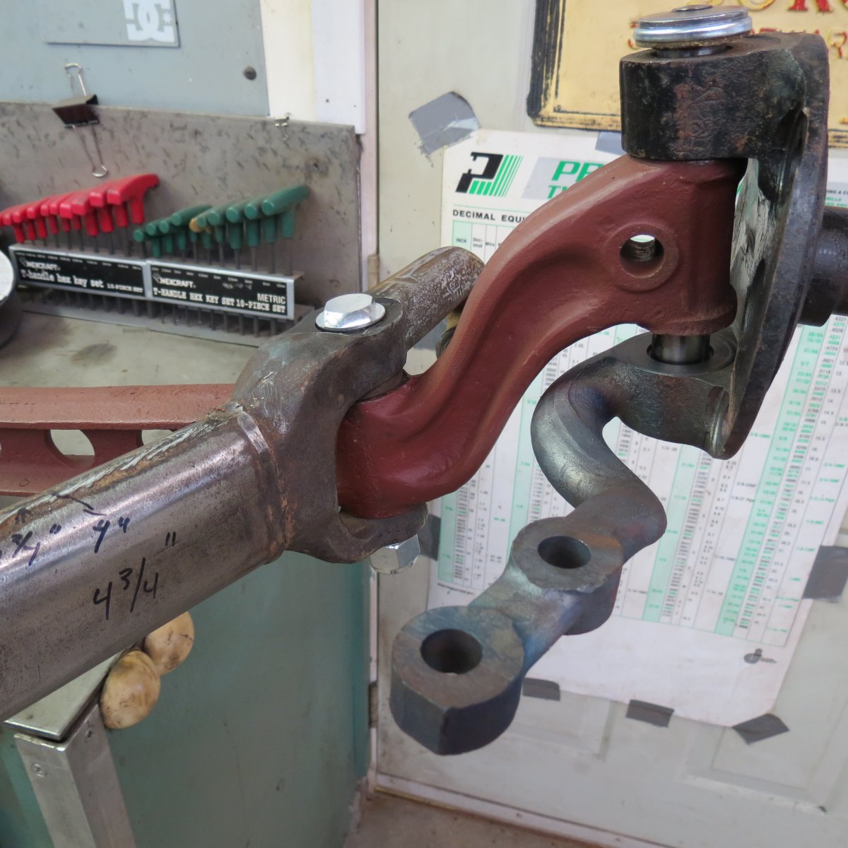

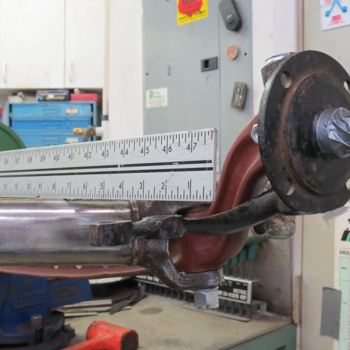

    :) Ok I think that I got it right. I ran out of oxygen in the middle of this & had to get some more. How does this look to you guys? Please let me know if you see something not quite right. Eventually I will get these magged. For now this is just to swap axels under my 36 roller. No motor or trans. .Thanks again for any advice & opinions that are given. Bill
  30. F&J
    Joined: Apr 5, 2007
    Posts: 13,312
    F&J
    We differ on where to bend. But, if the job works, so be it.
    I would like to know a few things, as I can't answer your question of "how's it look", yet
    1-Did you end up with shorter arms, measured out to the tapered holes?
    2-Why are the axle "stops" not in place to check "lock to lock"
    3 and related to #2, why is the tie rod not on, so we can see if it clears the bones from lock to lock, with the caster you are set at?
