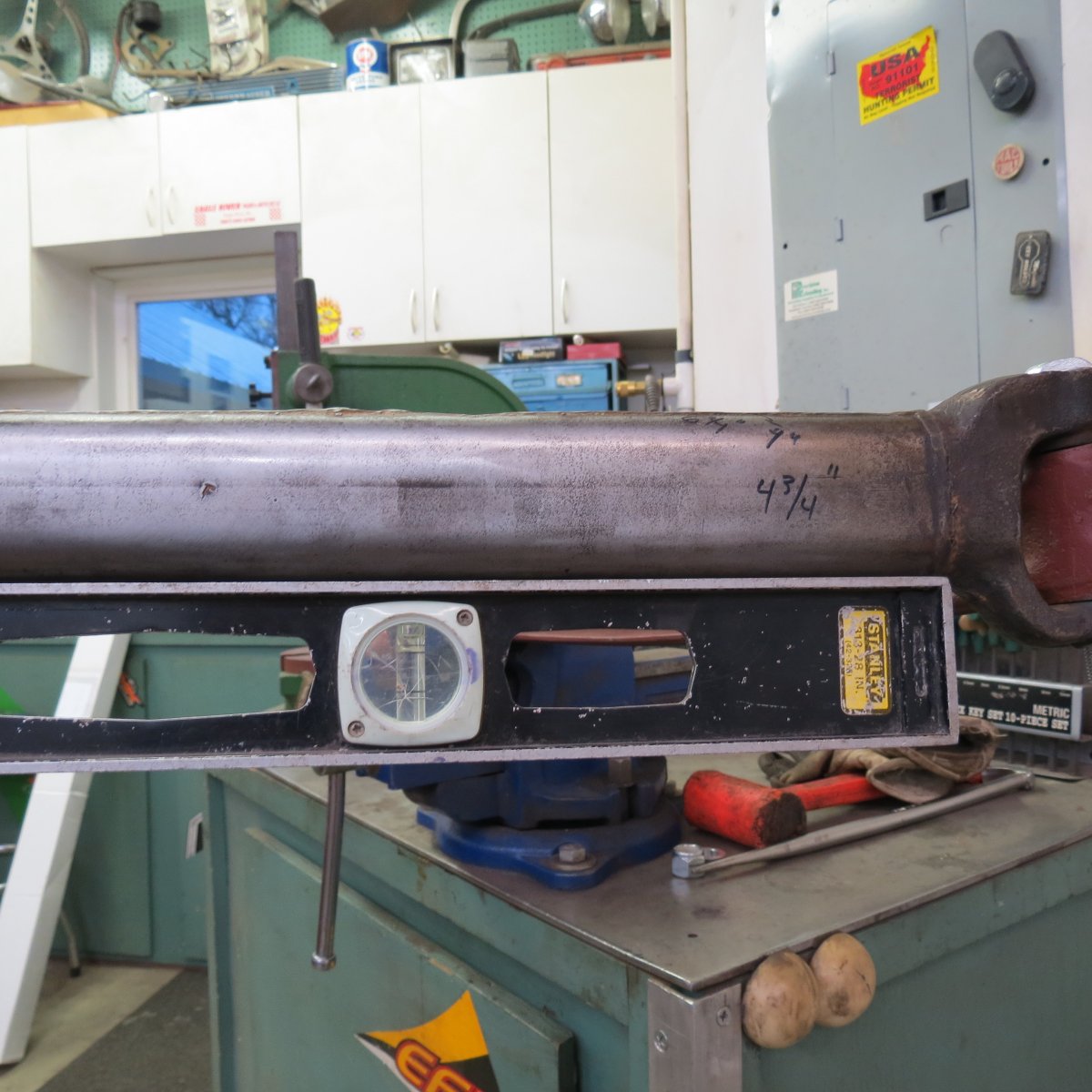

    Ok back at it again. This is about straighting the wishbone that had a "dip" (bend) in it. 117harv, thanks for the advise. I went to work this afternoon & used the big press to straighten out the right side wishbone. I forgot to take my camera, so sorry no pics of that.:( I bent it back cold, but it took a little playn with to make it work. I would sure like to know what someone hit to bend this. These things are really strong. It would flex back & not wanting to over bend it I wasn't sure how much pressure to put on it. It would keep splitting the 2"x4"s we were using to support it & push against. We had 3 of us holding it in position & holding the wood & running the press as unsplit bones are welded with the tops tipped outward at a angle away from the bottom side & you have to support them with the opposite side held a offset angle to keep the side that you are pushing against vertical. Finaly we used a 2"x4" steel block under the pin boss & a wood block with a 1/2" thick piece of uhmw under the thinner section towards the rear of the wishbone tube. We laid a wide piece of 1/2" thick uhmw on top and pushed down against it. It took quite a bit of pressure but I didn't pay attention to the gauge. I do have pictures of it after we were done & mounted back on the axel. IMG_2580.JPG IMG_2579.JPG It came out almost perfect. :) Thanks to all for your comments, suggestions & opinions. Sincerly. Bill PS: I will try to do a follow up after I swap out the axel ***embly.

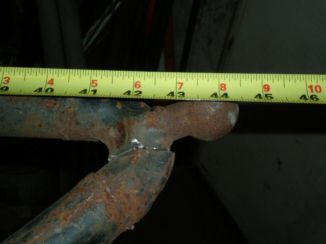

    Just measured the bones from a 40 pickup ch***is.41 inches.
    Also measured a 47 merc set at 44-1/2.

    Stuck a set of '36 bones on an axle, measures about 41" from center axle to center ball like Bader2's '40 measurement. Maybe the references to the 44-1/2" length is down the axis of each leg of the wishbones as shown in the picture.

    The 35 axle/wishbone I have is 40-1/2". The 40 is 41",and I MYSELF took that out of a 40 ford ch***is,the mercury is 44-1/2. These are all known axles,no speculation involved!
