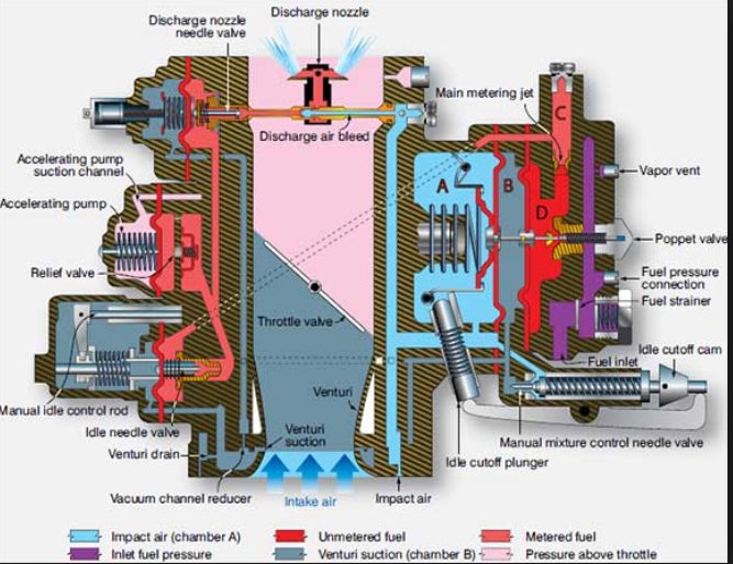

    One of those trains of thought I tend to have when left unsupervised. It occurred to me that this is one Frank (@FishFry ) in Germany might find interesting.
    First: any precedent for running Bendix-Stromberg aircraft pressure carbs on cars in the immediate post-war era? The PS and PD ranges can be fitted as downdraught and might be of CFM capacities suited to car engines, which turn a lot faster than aircraft engines commonly do, or at least did. Surely more than one bright spark tried it, based on WWII experience? Presumably the instrument would have needed to be modified for automotive response requirements etc. Whether that was viable I do not know. And if there is photographic evidence I'd surely like to see it.
    But be that as it may: I'm more interested in the fuel-supply principle on its own. Float chambers work but I can't mentally leave stuff alone, and this has bugged me ever since I ran a Weber 28/36DCD on a daily, which would stumble in long right-hand sweepers taken at speed due to the fuel level going diagonal. I like the idea of that entire issue going away.
    Could a four-chamber ***embly like this be adapted to a conventional carb?
    At it's simplest it's a vacuum-advance canister pulling a needle fuel valve. The atmospheric side of the diaphragm is connected to air-cleaner pressure; the vacuum side of the diaphragm is connected to venturi pressure (i.e. relative vacuum); the inlet to the fuel valve is connected to a pressure-controlled fuel source; and the outlet from the fuel valve is connected to a fuel sprayer bar or nozzle downstream of the throttle ****erfly. This last could be a spacer arrangement as commonly used with carb-based N2O installations. All other carb ancillary systems like accelerator pumps etc. might possibly be able to remain as is.
    My first elaboration of this was to consider that it should work just as well on a constant-depression carb like an SU — because I'm into that polished-vacuum-bell loveliness. The system should respond just as well to a vacuum signal which varies according to a needle in a variable annular jet as to one which varies according to variable air flow through a fixed venturi. That should make for a particularly neat application, as the H and HS series' float bowls bolt on in their entirety, so the diaphragm/valve ***emblies can be shaped to bolt on in their place.
    (SU did make downdraught carbs. Their D2, D3, and D4 types weren't all that uncommon before WWII. I was blissfully unaware of their existence until I saw four D4s on a Lagonda V12 Le Mans replica a few years ago. That put my mind to rest about the vacuum piston being able to work without help from gravity: though apparently the damper-oil filling and breather detail was different on the D types.)
    My second elaboration was to realise that if we're introducing a spacer with a sprayer bar or nozzle anyway, why not injectors in the relevant intake ports instead? There is no longer anything which requires the venturi and the introduction of fuel to be in the same place.
    Are we then on this side or on that side of the boundary between carburettors and fuel injection? Best of both worlds or a particularly wriggly can of worms? Would there be any percentage in this apart from being able to go around corners upside-down? It's Monday, isn't it? This time of year I can never be quite sure ...

    1. The PD9 (one of the smallest two barrel Bendix pressure carbs for aircraft) has two 3-3/16" throttle bores. That is a flow area about a third bigger than all four barrels of a Holley 4500 Dominator. To me, the best fit might be one or two of the PS (single barrel) carbs.
    2. If you look at the diagram, there are four or five 'rubber' diaphragms in a Bendix pressure carb that control the fuel flow. One big watchout would be finding a source for diaphragms that have the flexibility the carb designer intended. Sixty plus year old diaphragms (even 'new' old stock) might be too dried up / stiff to work.
    3. You cannot call Jegs or Summit for a different set of 'jets' (orifices) if you are too rich or too lean like you can with a Holley 4150 or Carter AFB. You likely would have to make (or have made) jets to match the application.

    Valid points, but my speculation was as to using the principle rather than the actual hardware, and as I mentioned, a literal vacuum advance canister off the side of a distributor — or at least the diaphragm out of one — might do the job. Of course it wouldn't be a bolt-on operation; it would probably be a process of experimentation as a sort of ongoing hobby. It would be cool if got to work.

    "...my speculation was as to using the principle rather than the actual hardware..." For a pressure carb I made in my ba*****t, I am chasing two (or more) 'rabbits' at the same time; do I have the diaphragms and springs sized properly for the pressure differential(s) AND are all the jets, etc. properly sized for the application. On the other hand, if an actual Bendix pressure carb is used, it is just a matter of matching it to smaller displacement but higher rev auto engine, the basic operating issues were already solved by Bendix in the 1930s.
    A Bendix PD5 pressure carb has a single 2-3/16" diameter throat. They were used on the Continental E225 engine, 470 cubic inches (7.7L) 2600 rpm at take-off (maximum power). There are five or so of the PD5 carbs on Ebay at the present time.

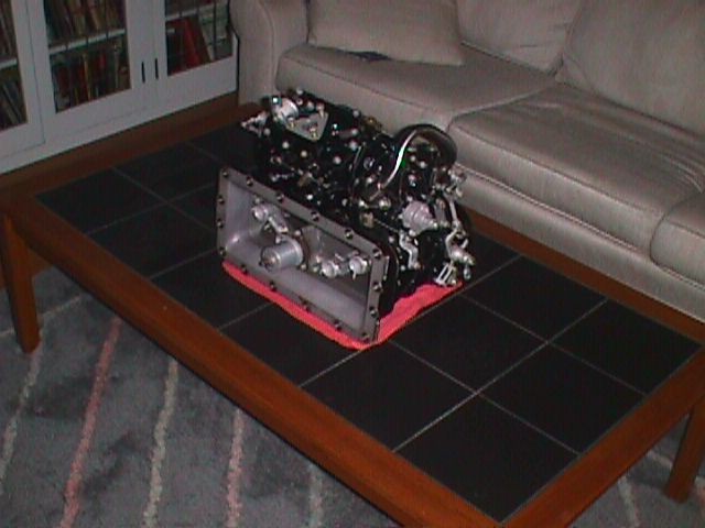

    I have one of those aircraft pressure carburetors, it's supposed to be for the engines in a B-29 Superfortress. I think it's probably a little too big for automotive use. ;)

    ...I was also curious how these carburetors work because they have to go through such wide barometric pressure and temperature changes that we don't encounter on automobile use...
    If you look at the diagram in the original post, as the al***ude increases (the inlet air pressure decreases) in chamber A, the fuel pressure at upstream side of the main metering (area D) jet is decreased, correcting the mixture for the change in al***ude. I cannot see it in the diagram, but I ***ume there is a thermostatic element that makes a similar change as inlet air temperature changes.
