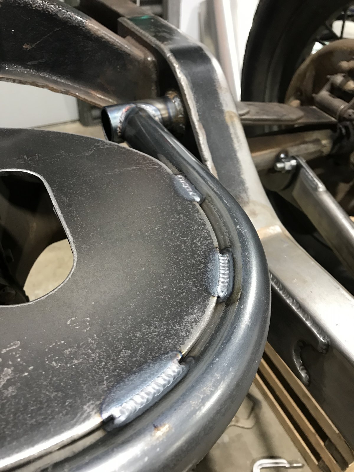

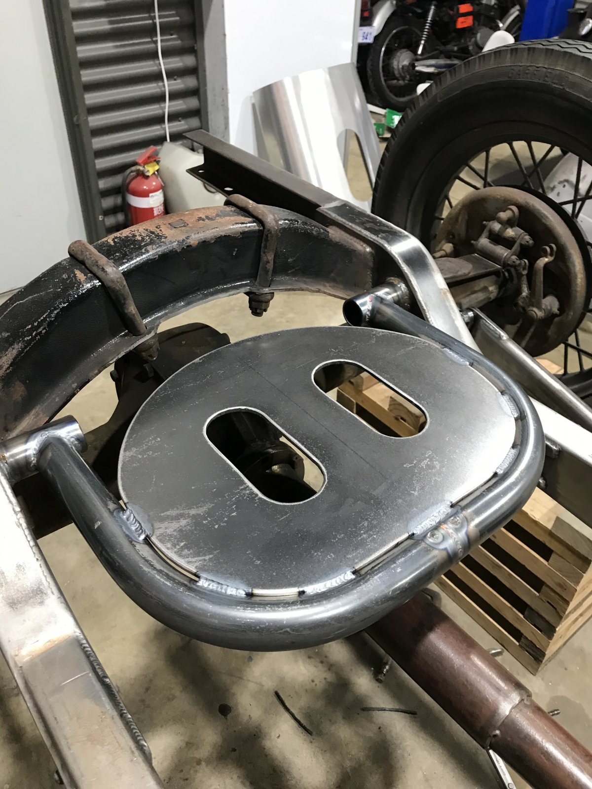

  13. Added some 20x20mm square tubing around the edge to finish it off and add structure. I didn’t have my bender so it was the old ration way of many pie cuts and welding, let’s of bending but happy with how it turned out.

    So many cuts! So much grinding! Looks professional now it's done! Are your hands still tingling from the grinder?

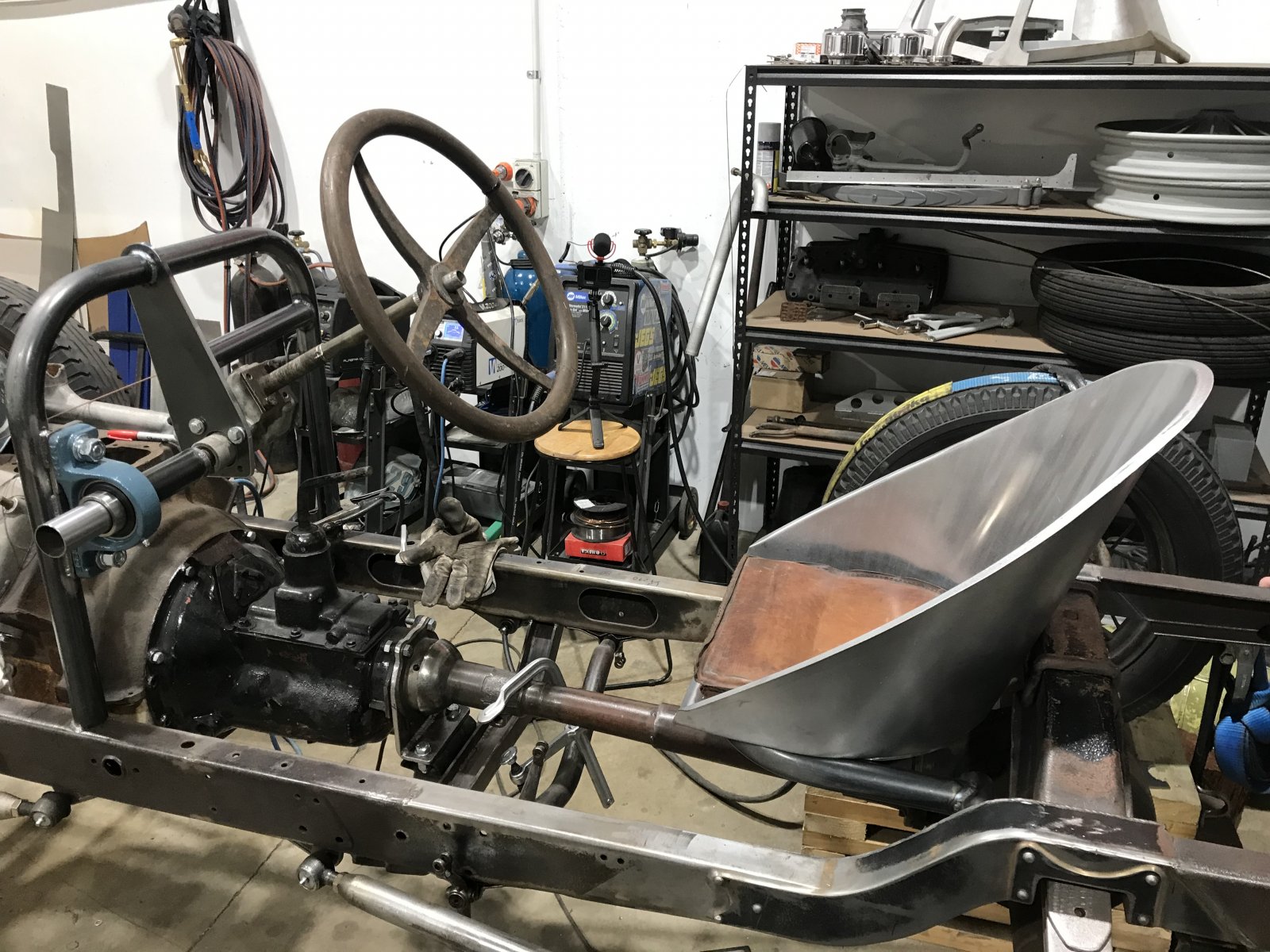

  19. Starting to sort out the structure for the steering box that may lead into a roll cage but not sure yet, more today coming 064530C1-AAC0-465A-BE60-6B252E70FAD5.jpeg 16675BAA-EF04-4DC5-BD7F-379B0A0BF886.jpeg
  20. Steering coming along nicely, pitman arm and drag link tomorrow. CB9FA2D5-5FCD-4A3F-B69E-2ECE716C564D.jpeg FFCFB150-48D4-4A30-BBC0-A1E0F18675EB.jpeg 26D9E554-A1AC-41A3-B5F3-CB39D774EF20.jpeg 5FE35992-51ED-4DF2-B1D5-E8899B694B53.jpeg A1FFA36C-90E2-4133-896E-5C456138D37F.jpeg 3EE5E44B-2F52-45B1-A55F-E8581BC95EBA.jpeg AA15F15C-3312-4F94-9C19-894D90E402B6.jpeg

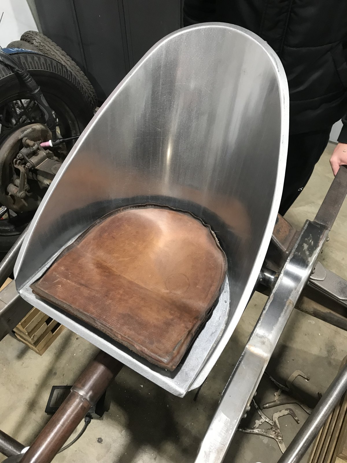

  27. Made a seat, seat frame and seat pan that looks like a pigs nose! Another few items off the list
    This will get Upolstery at some point. 5F2CE5E2-DCF3-42D9-820F-6E892D92A083.jpeg 37E659AC-F3DA-476B-A0AF-3FE0C840E9D1.jpeg 4119863D-19BB-40A4-BAA8-83E427562838.jpeg F0B2F055-F4FA-4981-8E61-697AA9A400A9.jpeg 919FE2BD-480A-44D5-891C-0E1F045A6FCD.jpeg 653B060F-11B3-4439-8480-51123E0866D6.jpeg

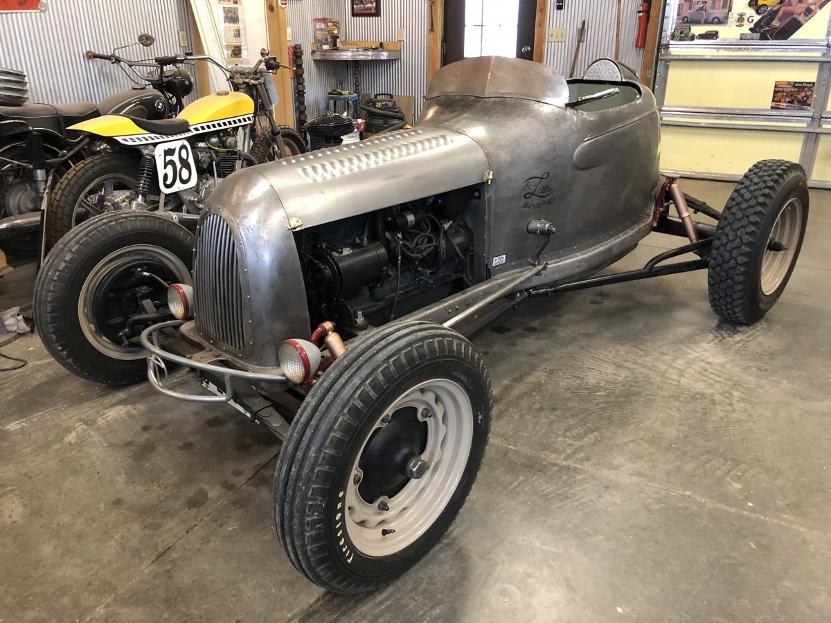

    Looking good. Any pics/info on the engine?
