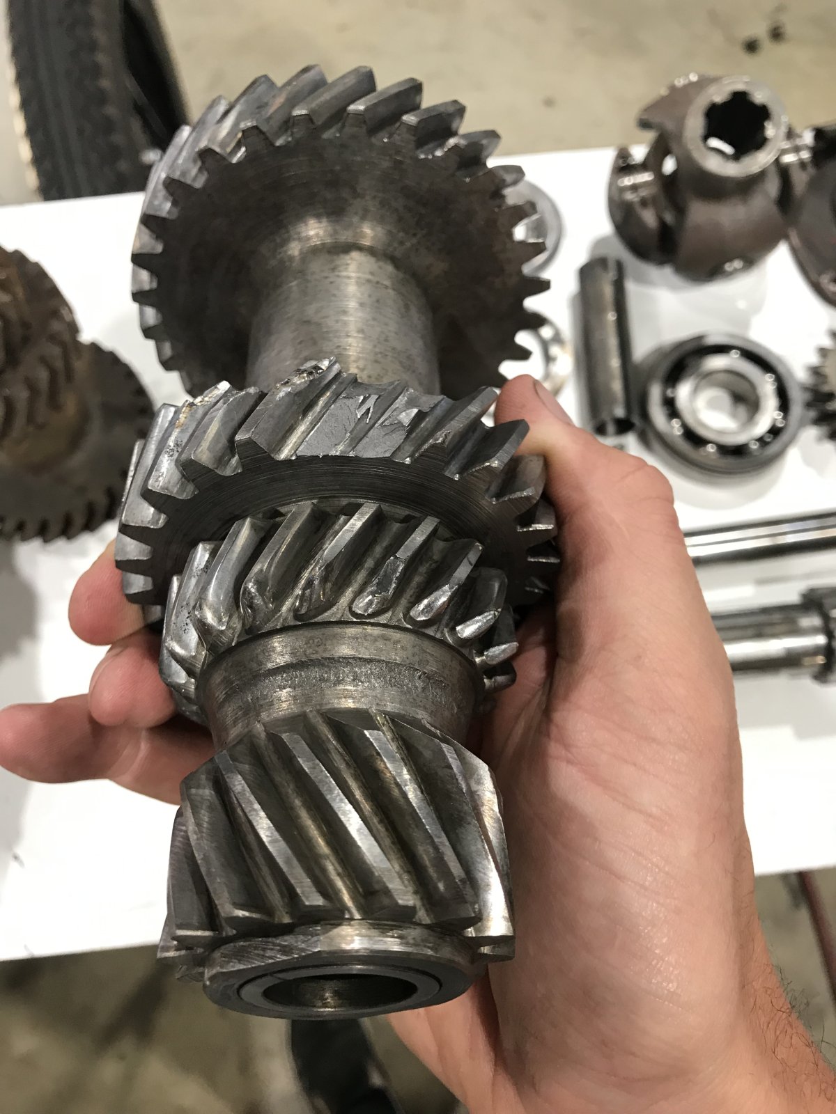

  5. Well there’s a test and tune coming up next month and I’ve got no second gear and apon further inspection a damaged main shaft too. So out with the box and try to find parts to rebuild this. If I have time id like to try get a list of things altered and fabricated to make this better on the track! Lots to come next week.

  7. Well I thought I had a 39 box with synchros but upon further inspection it’s just a late 36-39 box and no 3” fork. All good just need to find a cluster and 2nd gear! Would be nice to run a later set

    I don't see how those skinny tires could hook up hard enough on dirt to break the gears.
  9. This was on a race track no dirt
    Stogy likes this.
  10. You’re not wrong. I need to get it fixed

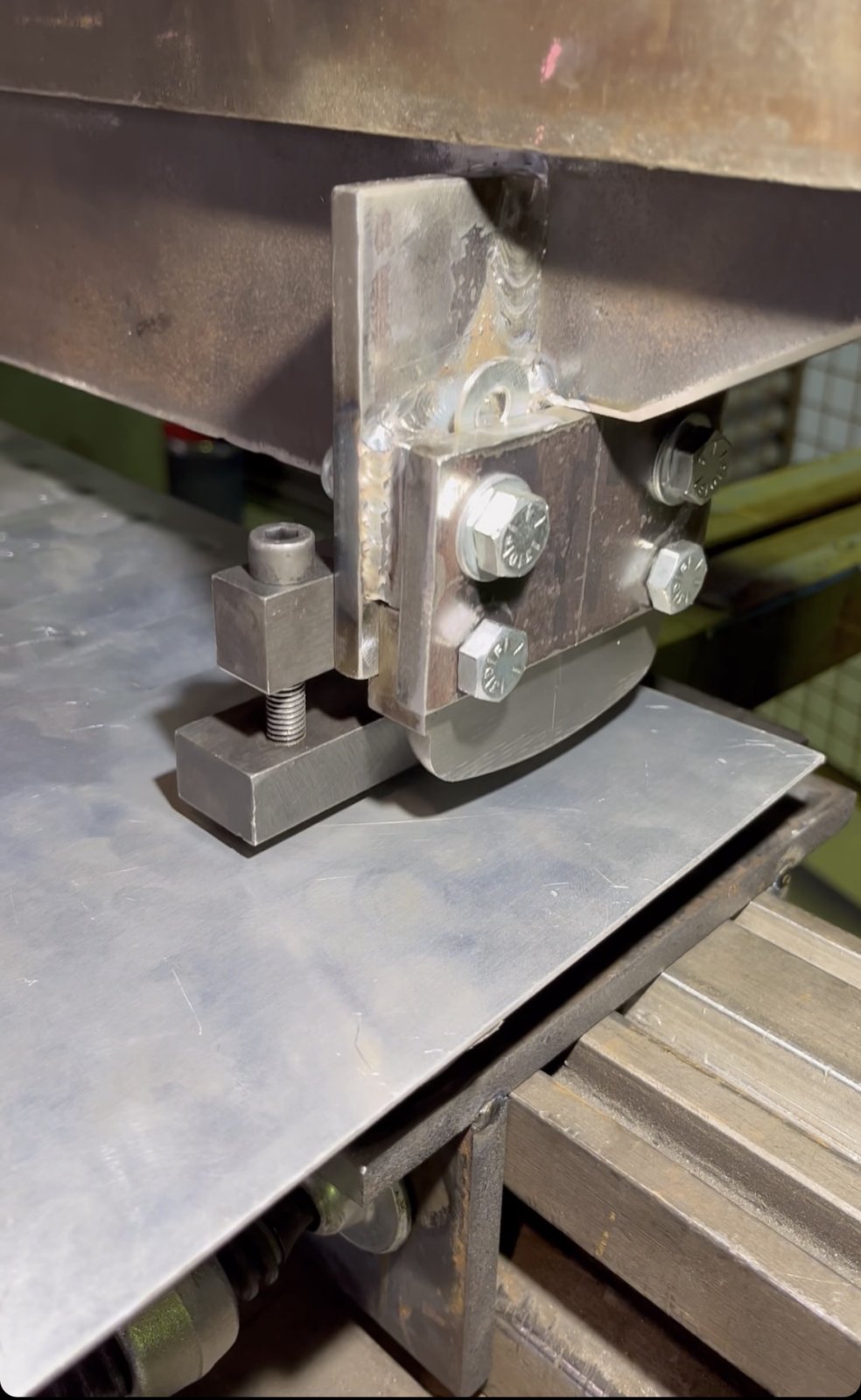

  13. While I figure out what I’m doing with the gear box I decided to make a louver die mount that attaches within the press brake. Took some tweaking and m***aging but the out cone is getting better.
    I’m undecided but thought about painting the hood and sides body colour but leave the louvers polished in the shape maybe a fine pin line the separate the colours.

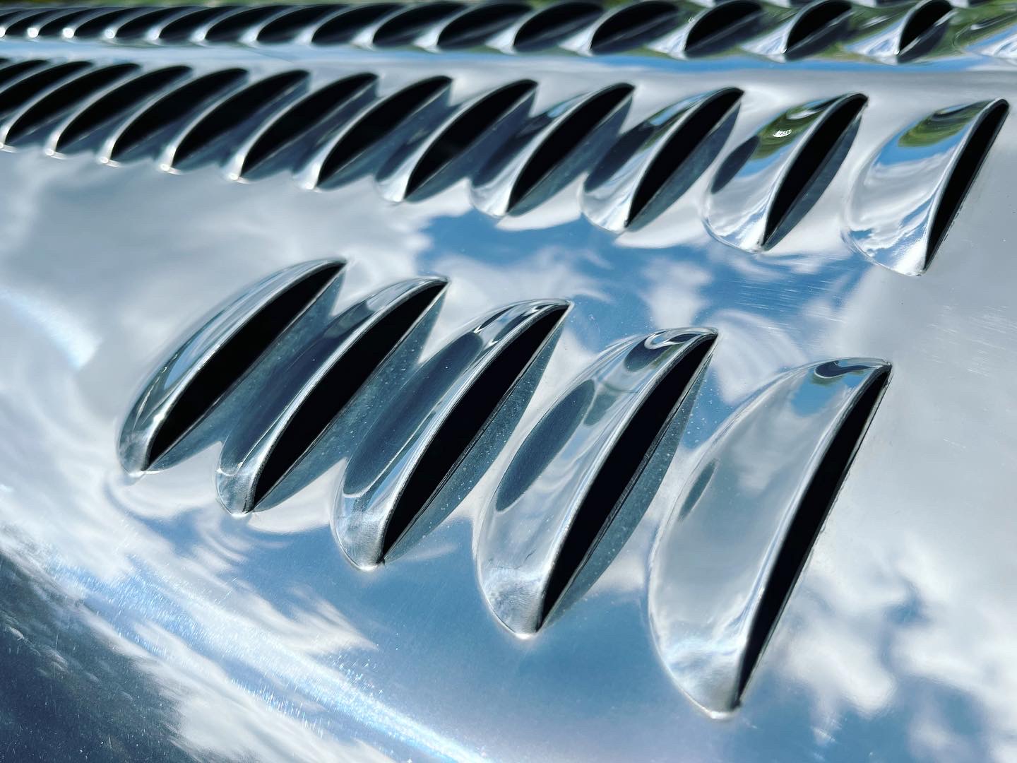

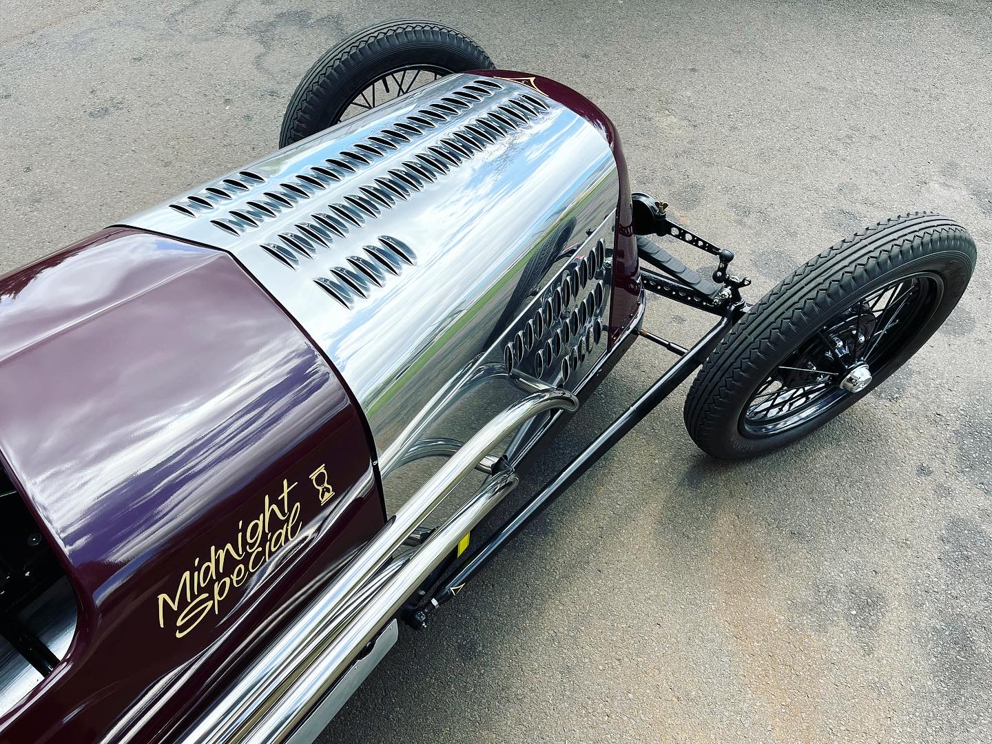

  14. 92 louvers later and a mission to polish.
    Looks cool 230C79A2-A550-4D69-A88B-B61EE6F5518B.jpeg 1FD43D2B-A162-4B30-8513-C4796F7BFA5F.jpeg A6024DD0-77B6-4906-8F9F-72DE7A3F9061.jpeg AFCCBEBB-91B7-409D-A651-1D8AD3C5529E.jpeg 512D6D78-8BFF-44A3-85C4-97CFA10DADA6.jpeg 1040989C-85FE-49B1-9659-3F3CBBF3D28C.jpeg 4CE70D3E-537B-4339-88C2-2CAACAF2294D.jpeg F6C43C55-A24B-487F-A169-C608D429495E.jpeg

    How do you align the louvers, hold the piece in position? This is a neat tool, great work!
    Stogy likes this.
  17. Works by using the bottom plate and has adjustment
    Stogy and Six Ball like this.

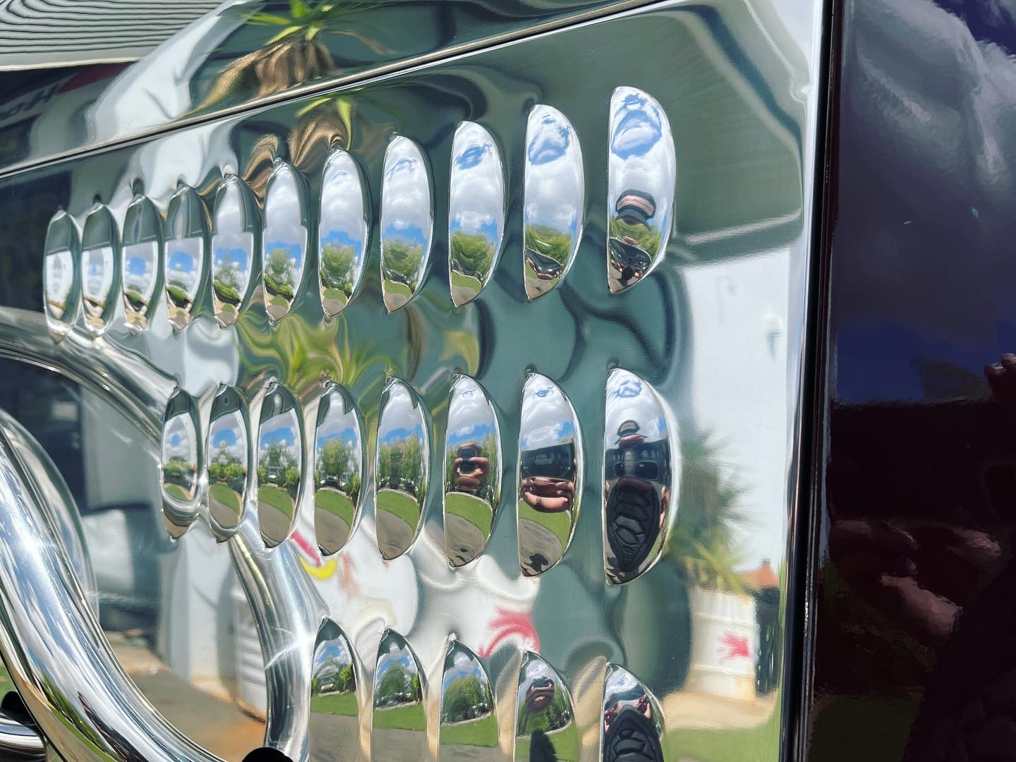

    Watched the video yesterday good stuff. Did you modify the male due when you cut the female a little rounder? I think I missed that part
    I’m Also curious if your hood sides have a little distortion/ pucker between the rows of louvers or if it’s the reflections of the louvers themselves onto the polished hood side?
    I didn’t have to modify the male, just the female part of it just trying to make the radius smoothers.
    It didn’t distort too bad, a very small amount but the cut and press is so smooth it helps a lot with that. The back press also helped with this as well and came out better than i could have imagined

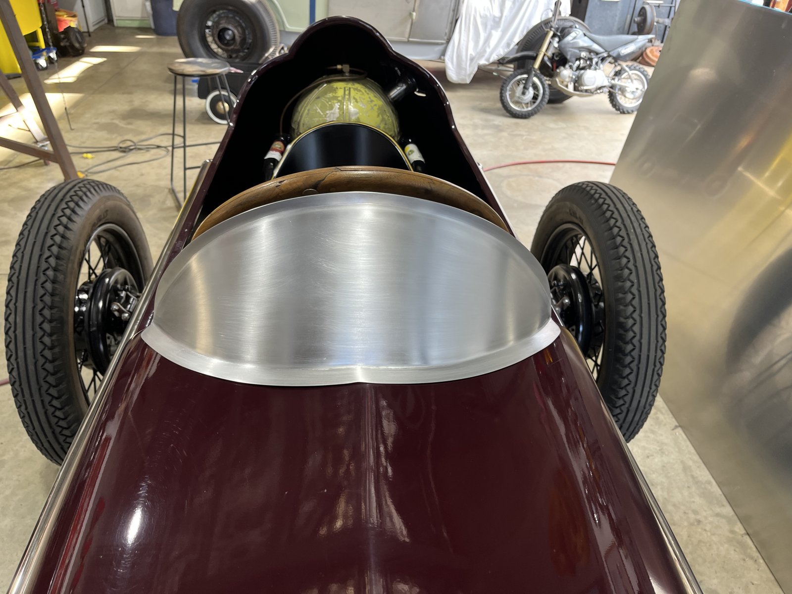

  25. Made a wire buck and formed a little screen from some 1.6mm aluminum. I’m on the fence with painting it body colour or polishing.
    Definitely breaks up the flat cowl section.

  26. Tim
    Joined: Mar 2, 2001
    Posts: 20,385
    Tim
    from KCMO
    Hey that’s cool! I vote leaving it brushed/raw but polished would be my second choice
  27. Flatrod17
    Joined: Apr 25, 2017
    Posts: 698
    Flatrod17
    I would polish the flange and leave the rest as is.
    Stogy, Six Ball and Tim like this.
  28. 05snopro440
    Joined: Mar 15, 2011
    Posts: 3,037
    05snopro440
    That looks great. My vote is polish the outside and leave the inside brushed.
  29. alchemy
    Joined: Sep 27, 2002
    Posts: 22,749
    alchemy
    Heat a sheet of plexy over your form.
  30. Six Ball
    Joined: Oct 8, 2007
    Posts: 6,968
    Six Ball
    from Nevada
    Paint it so there is not a break in the visual flow. Too many pieces with different colors, shapes, or textures. Have someone photo shop it. You do fantastic work!
