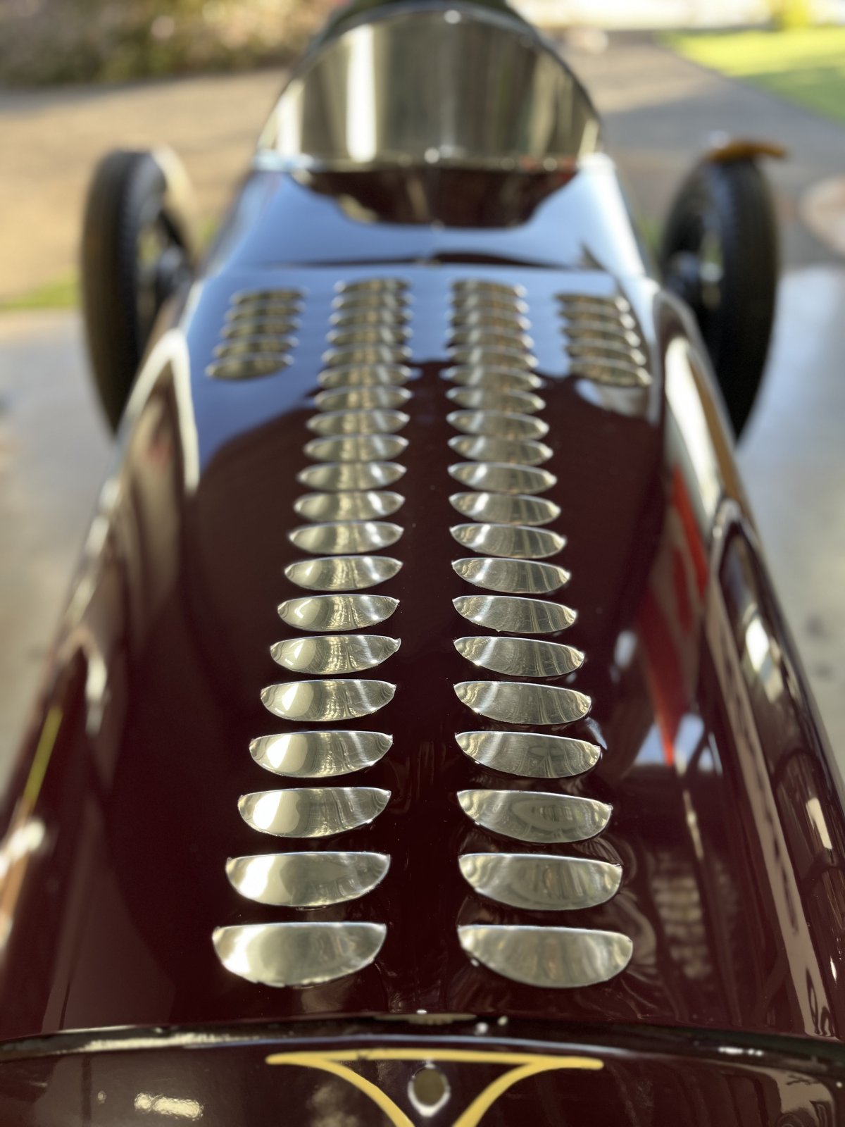

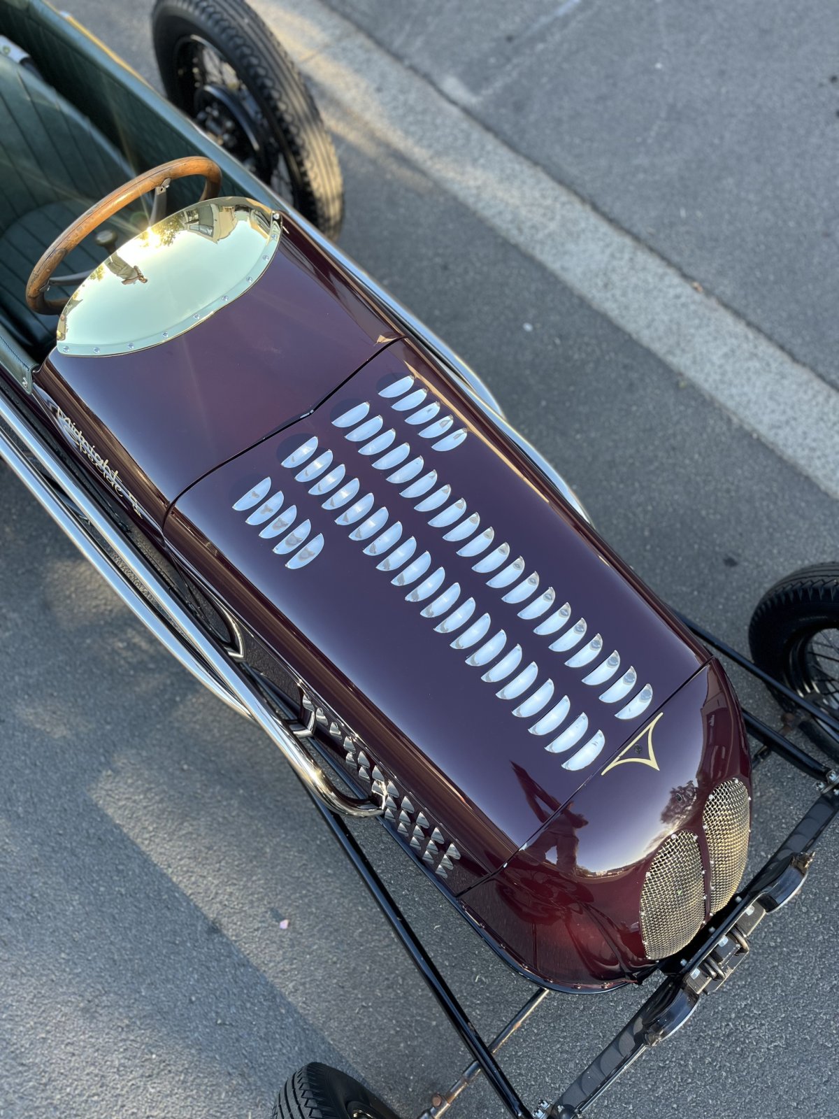

    Stunning and beautifully detailed build!

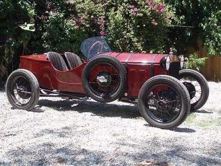

    Not that quality, but the best I could do with my ability and budget.
  15. SS327
    Joined: Sep 11, 2017
    Posts: 3,916
    SS327
    What’s wrong with it? I’d be seen driving that in a heartbeat!

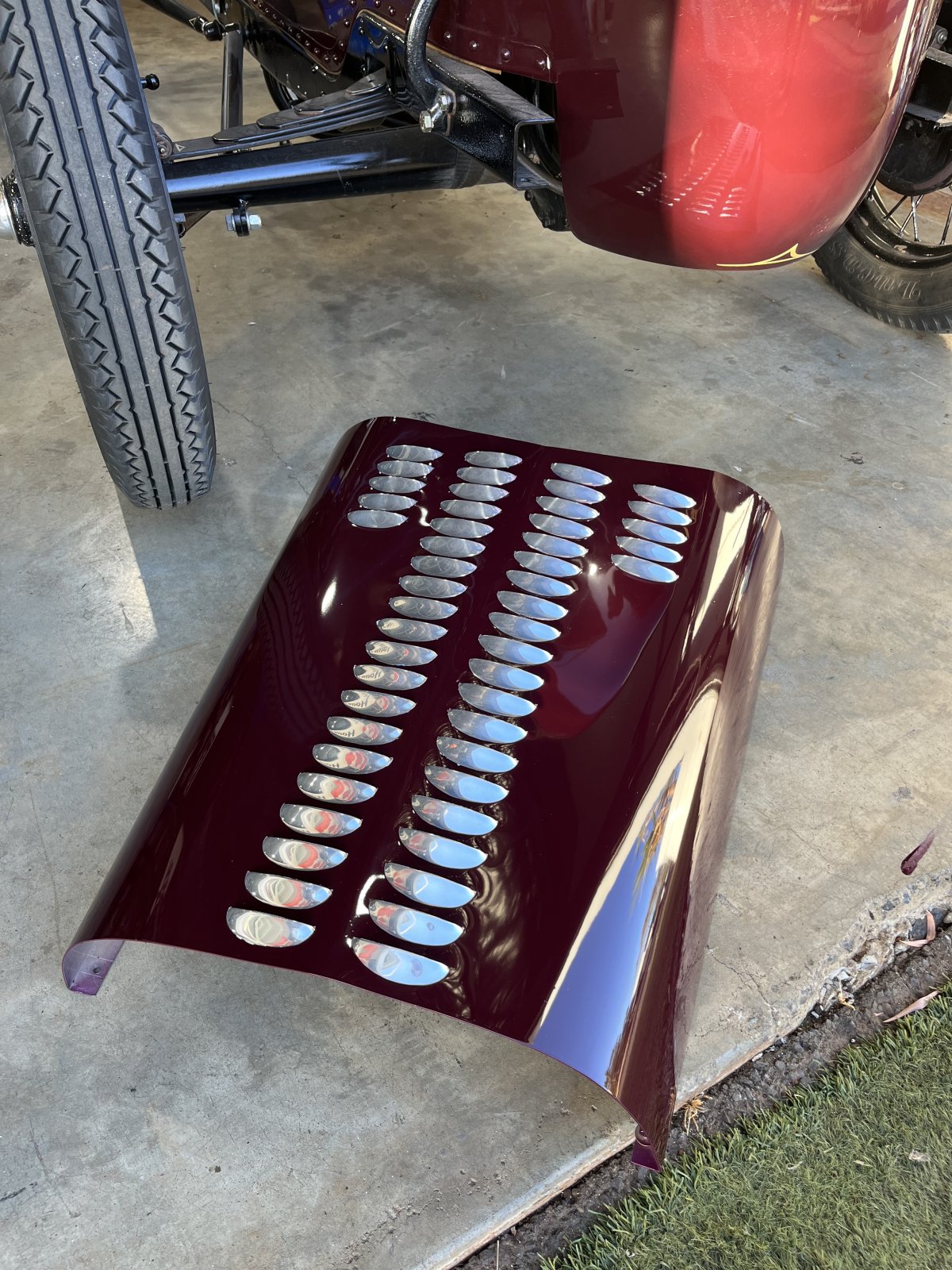

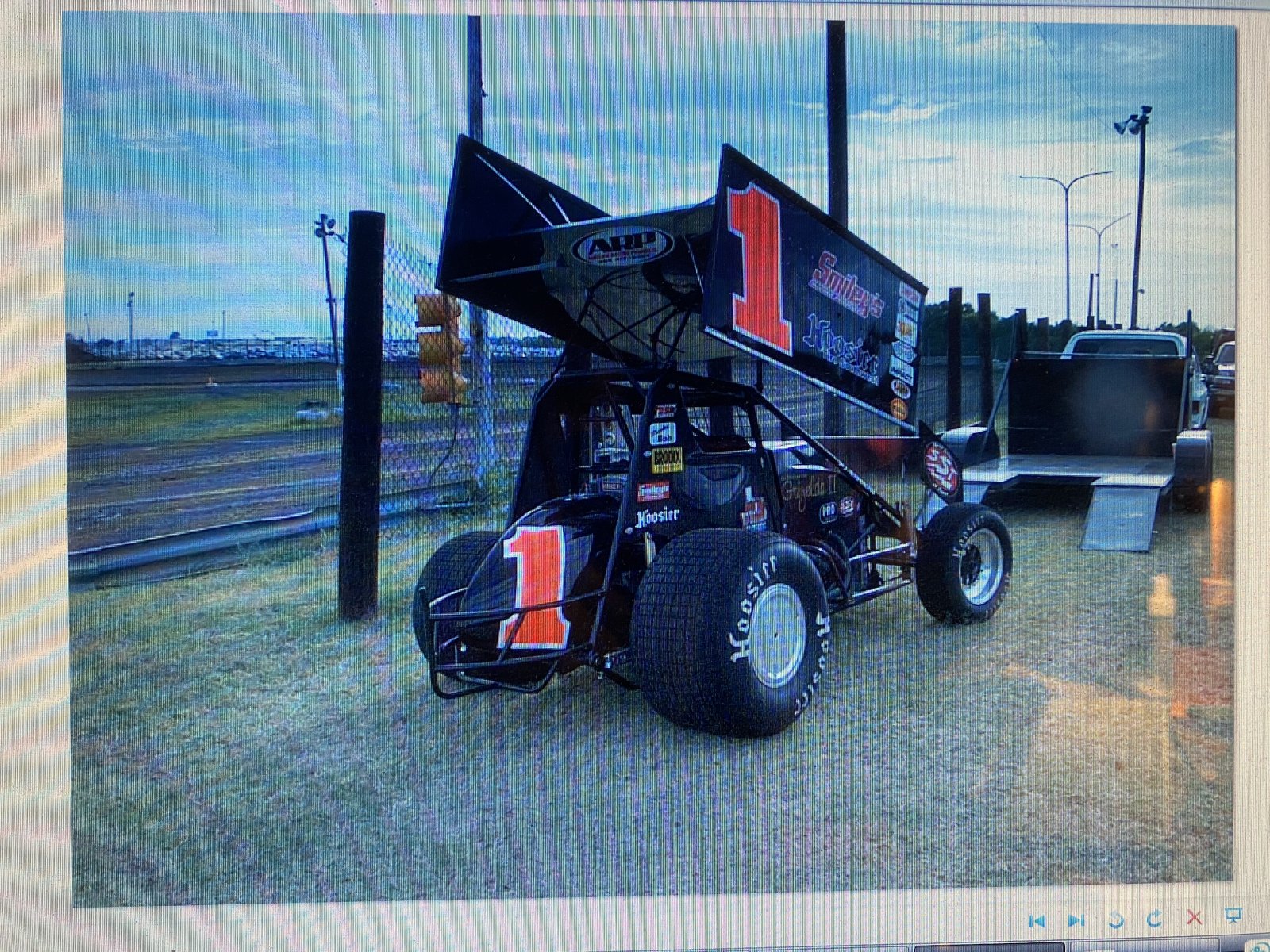

    If you are trying to get more air thru your Louvers turn the panel over and punch it again on the same cut line see attached picture. Our 410 car IMG_3264.jpeg IMG_4859.jpeg IMG_1497.jpeg

    What a Great Idea! Never seen that one before. I know just the place to try it:D

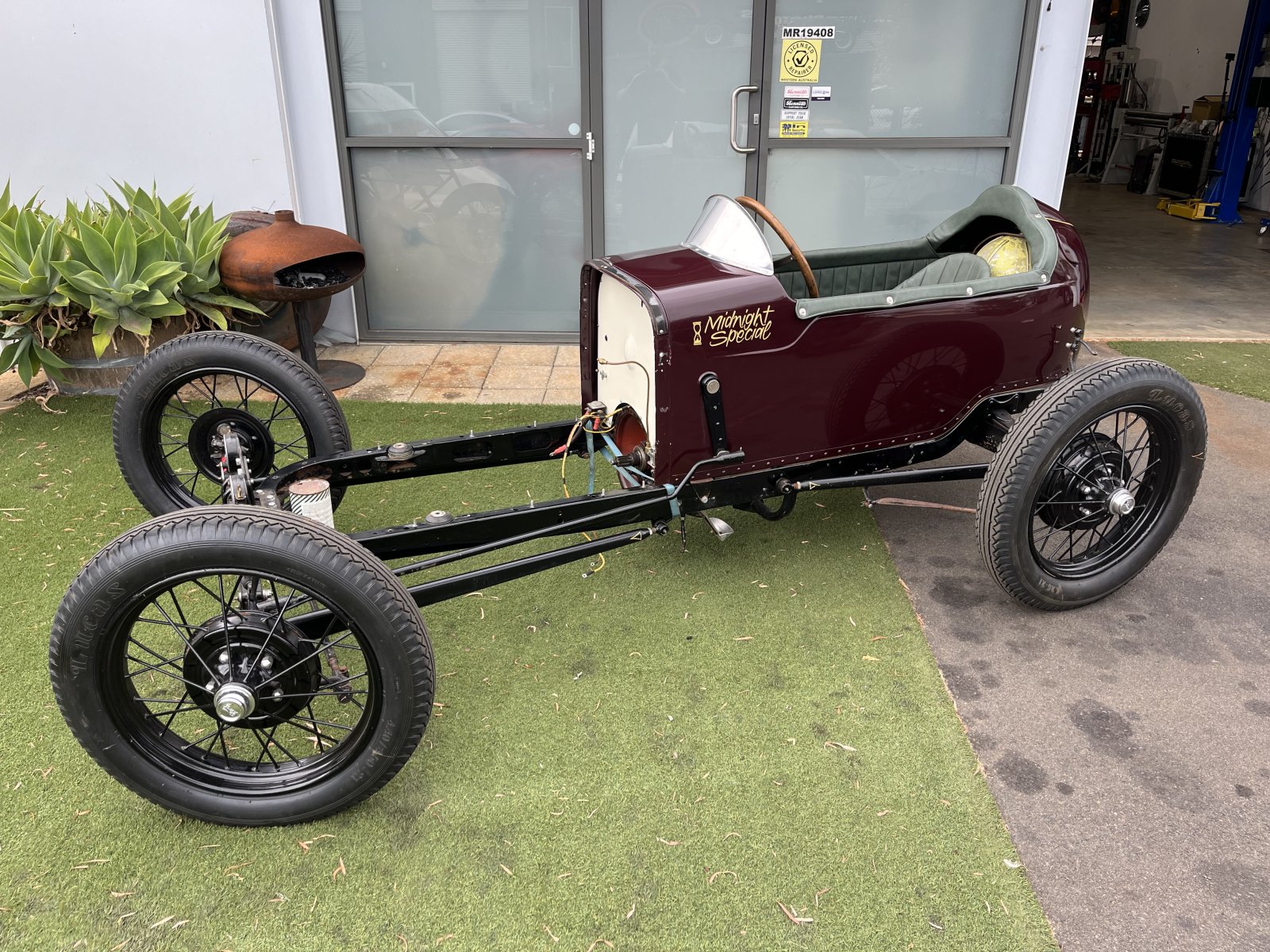

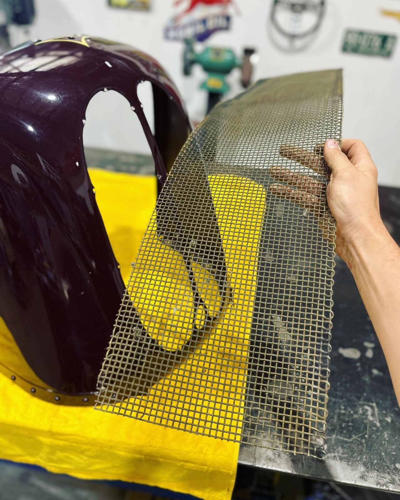

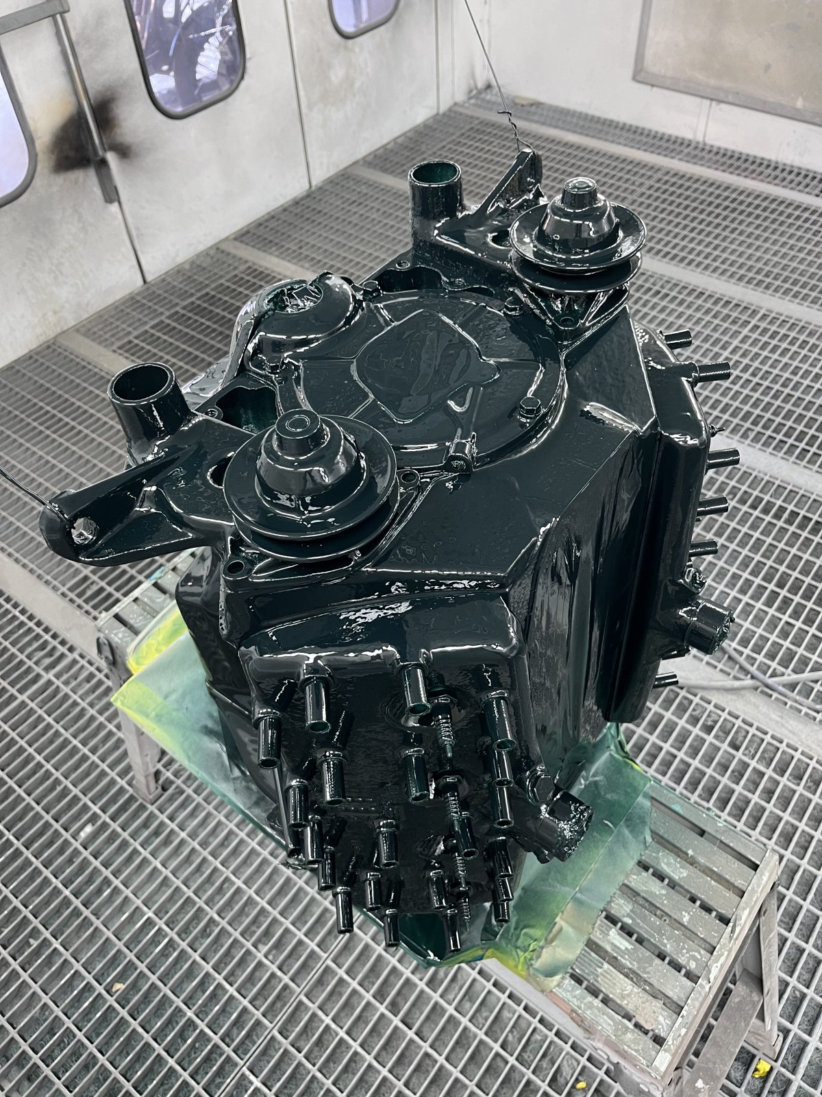

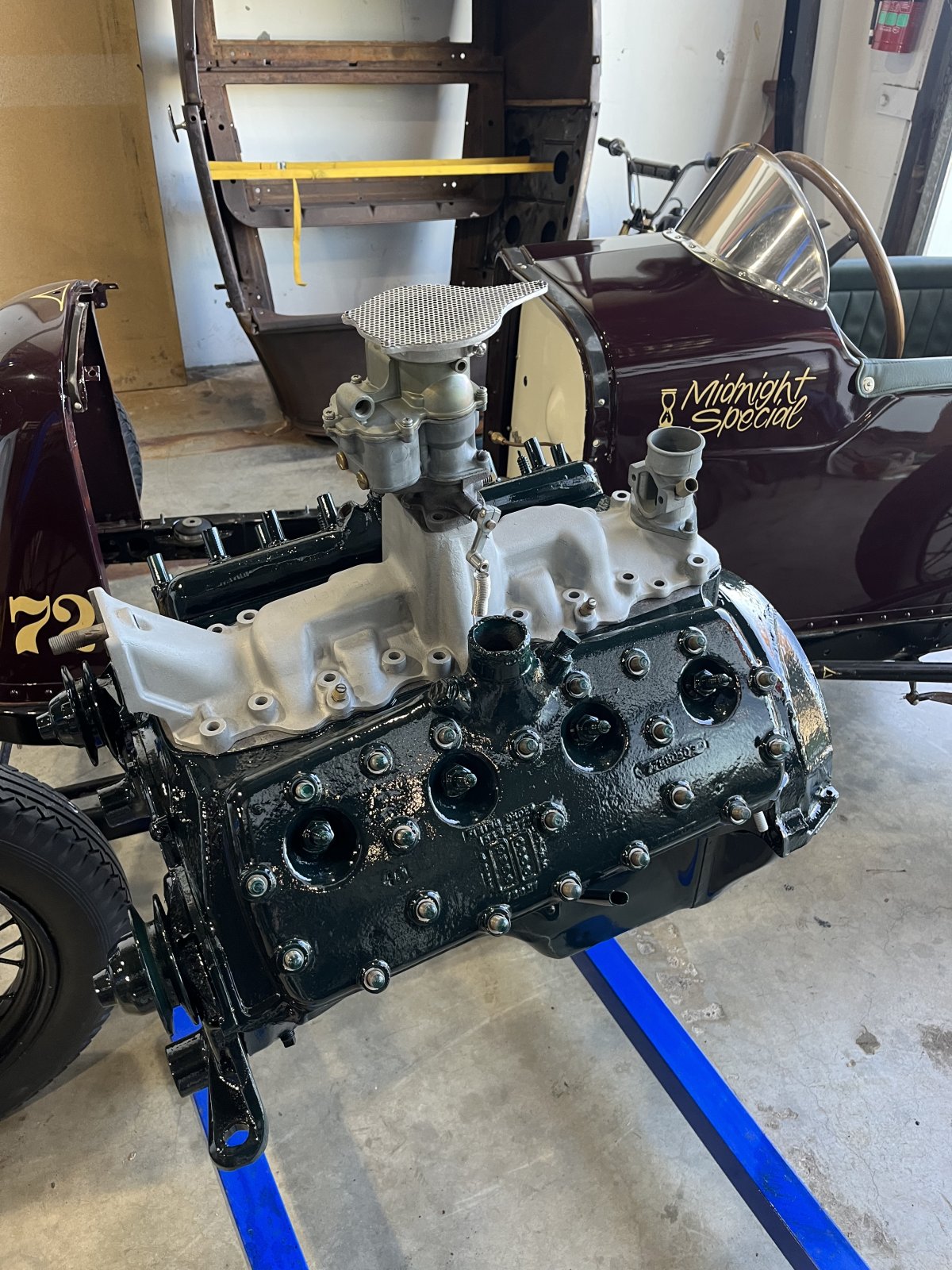

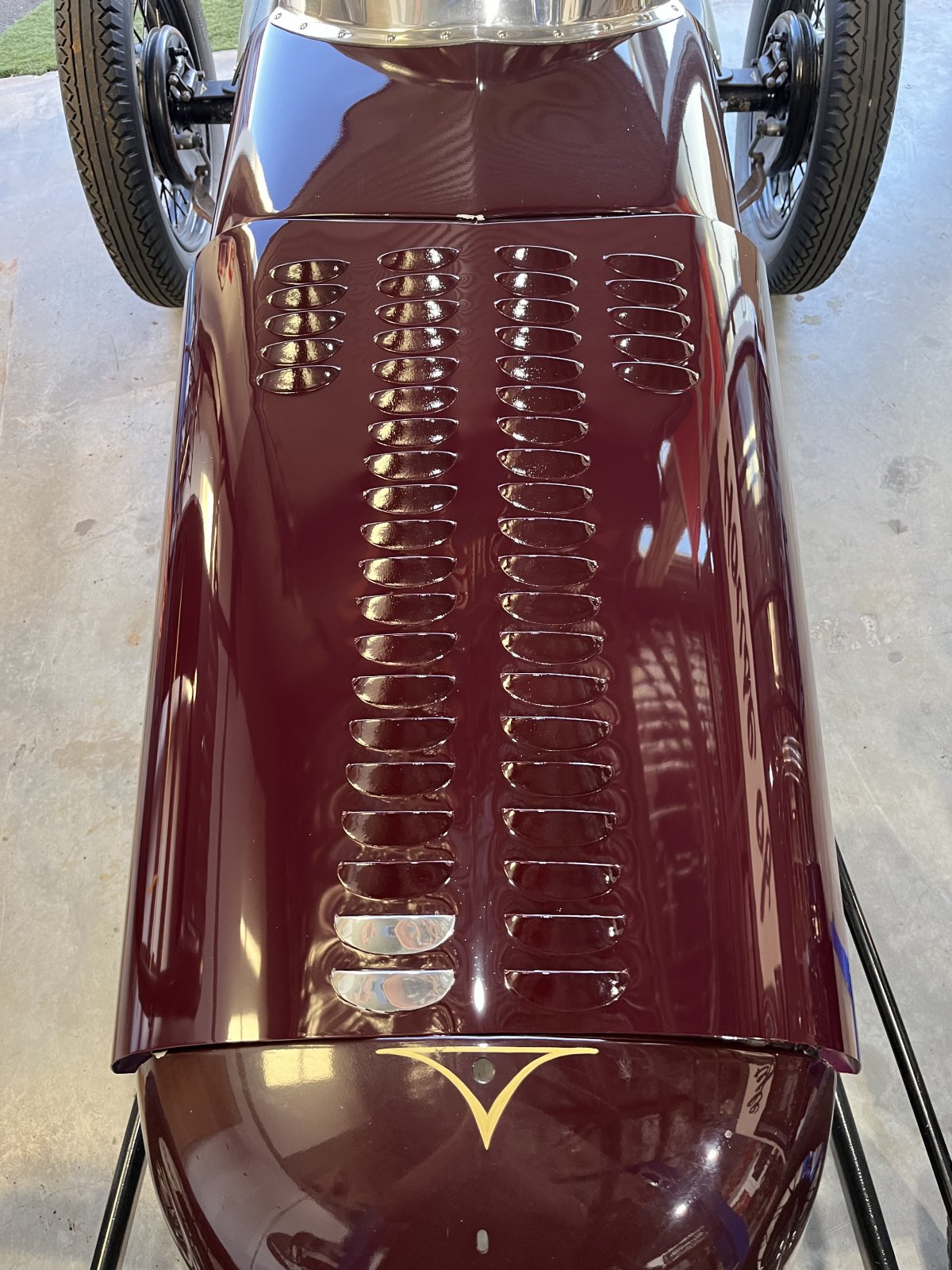

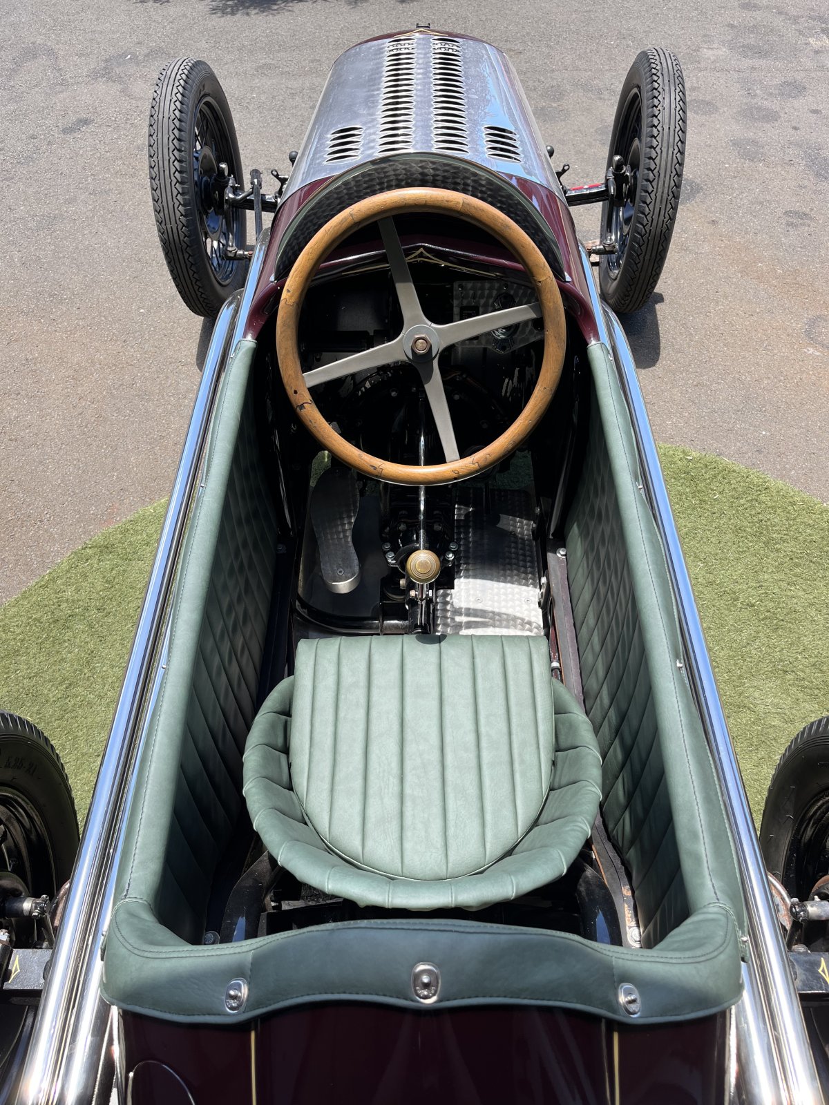

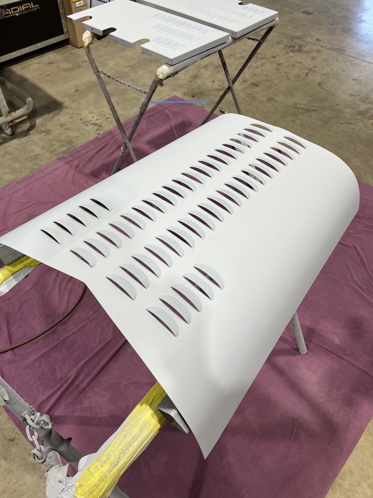

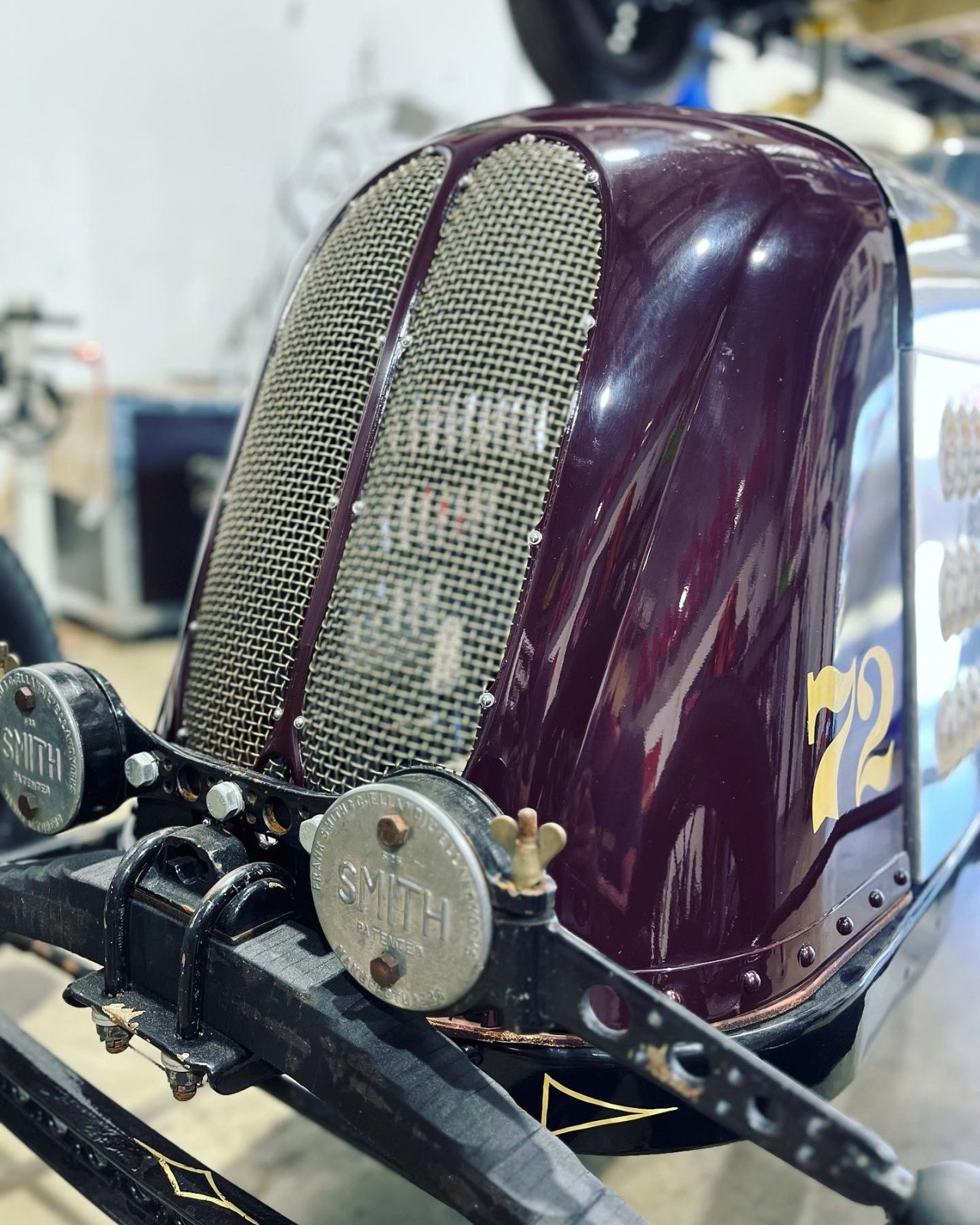

  23. Update:
    Motor is about to go back in- crank grind, new bearings, new pistons/rings and whole new gasket kit. Pair of water pumps.

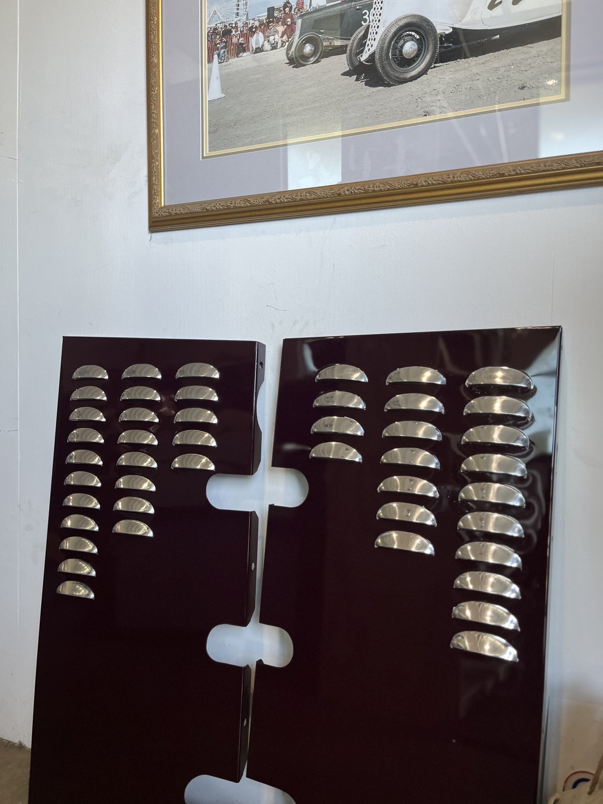

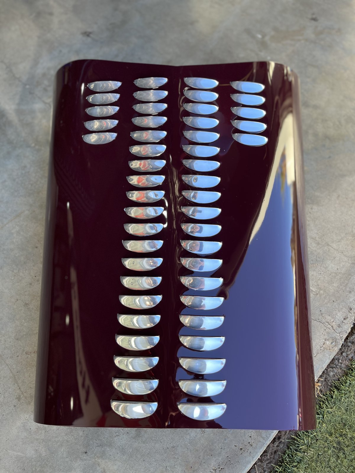

    I painted the block and heads. Made my own colour up. Something a bit different. I felt ambitious and polished all the louvers to them mask off and paint the hood and sides. Making it look a whole lot better. Once the belly pan is done it should look a lot better.

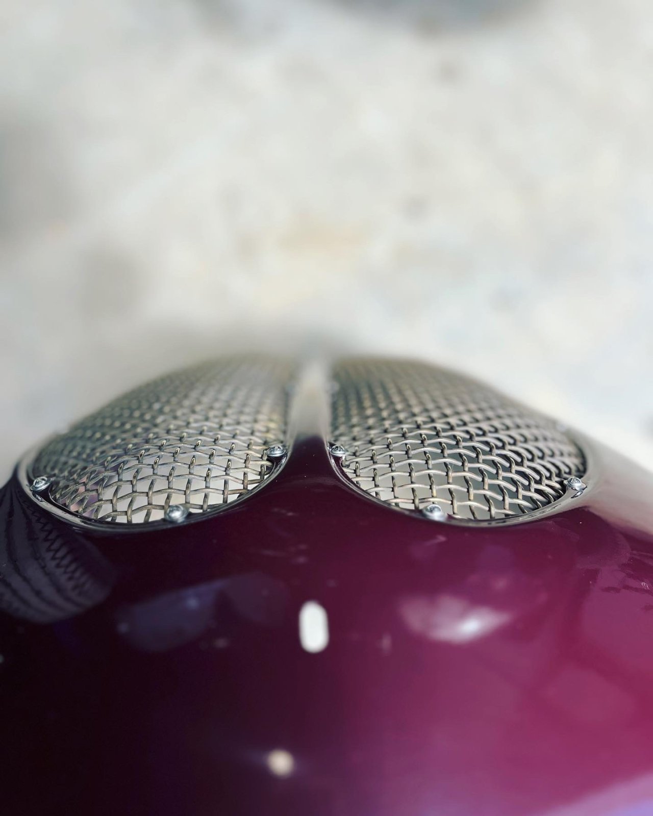

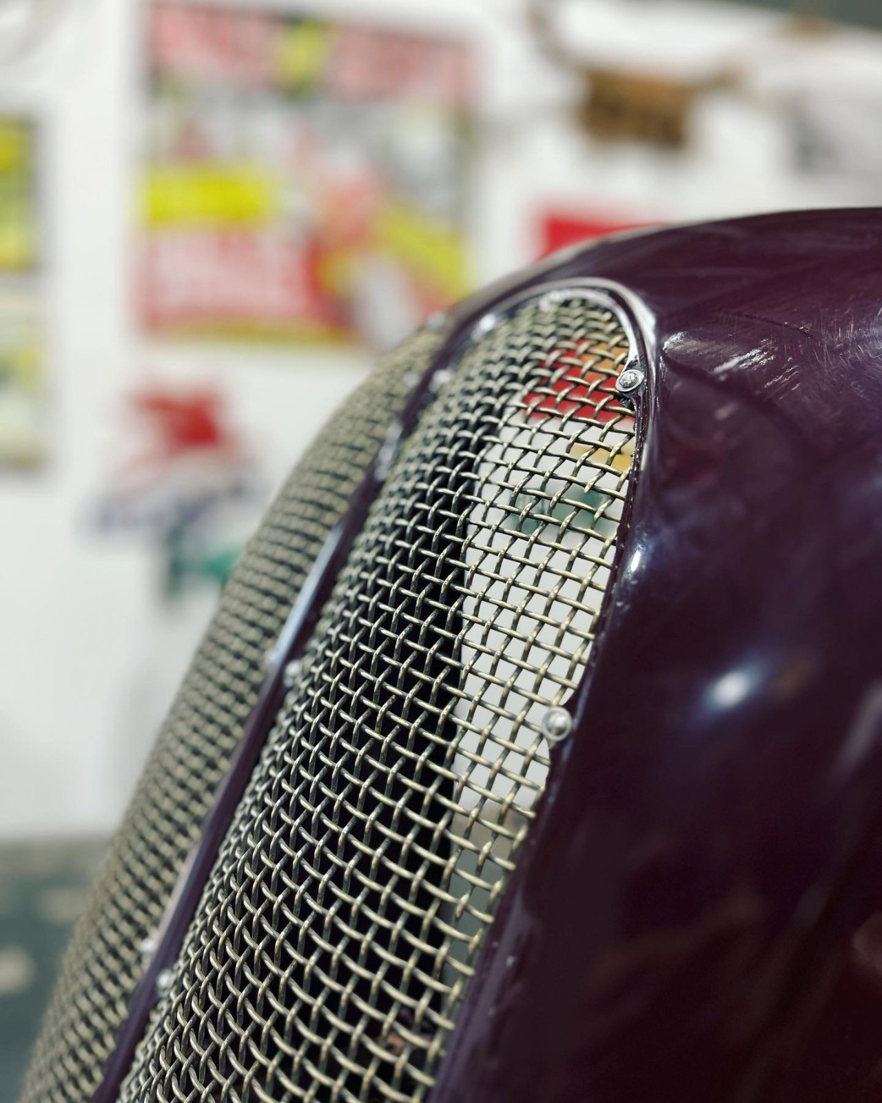

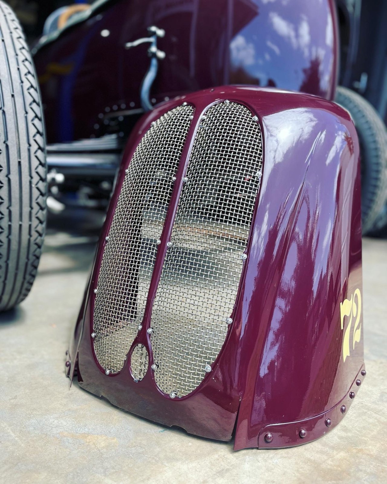

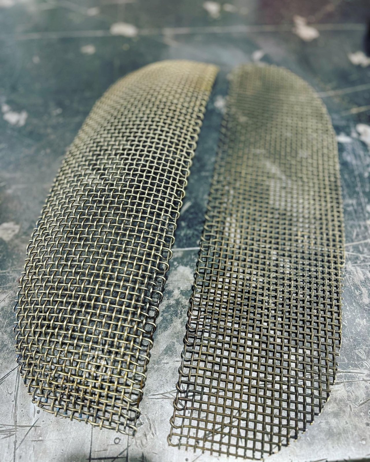

    A scored son very early br*** mesh from what was used as security mesh in the Fremantle prison many many moons ago. Formed them each with the bag and hammer and fitted them. Karl made a really nice br*** reverse curved panel to replace the aluminum wind deflector I created a while back and man does it look better!! More to come than advertised for sale.
    6263450A-E92F-47BF-A756-9BCD5283BA72.jpeg BA9AC331-7C36-4FD8-9A99-B8E655AD4E9F.jpeg E09021B7-076A-4CAB-BF6D-49968484CE1C.jpeg B353ECB1-5E47-4741-A191-C85CC5FD51E0.jpeg 5466CAF9-2172-4FD7-B78A-FD0A8C152CCA.jpeg D6FAB73F-0090-4603-8C1D-057F60ACAF8D.jpeg 014F0DDC-F3B8-48AC-9492-D79E0E4AAAB3.jpeg 5A2A85C5-9383-4B17-A6DB-0DB76396F1D3.jpeg E78A79B5-9CB9-4A65-89AC-B16737AB984A.jpeg D8111591-F434-47E0-867D-80BB65AAF6B6.jpeg 49396E5B-7FA8-4A18-AC22-A38940BEF4E0.jpeg

    Most impressive results, from your more than unique, skill's and technique, on all of the metal that you touch, and fabricate.
    The paint and the colors are very well thought out!
