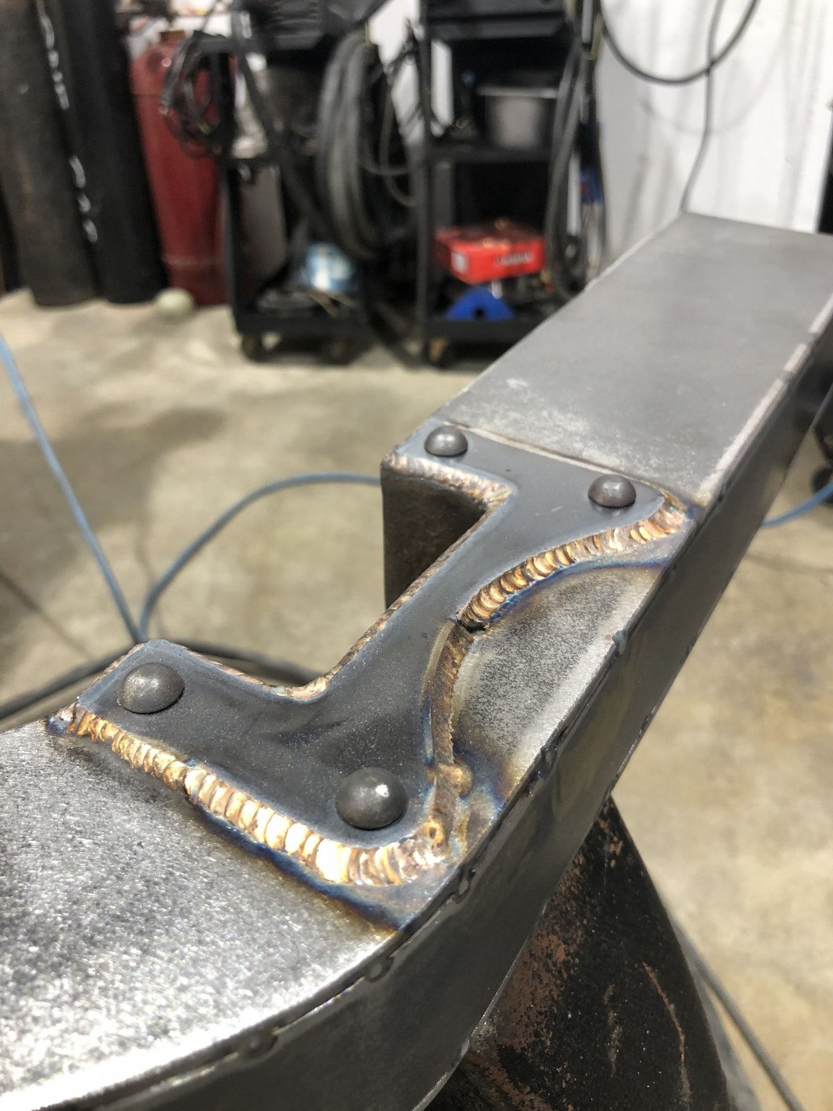

  1. Funny enough these ones are fake. I’ve done many properly in the past, but these are only just for looks to ad an appearance that they could be factory.

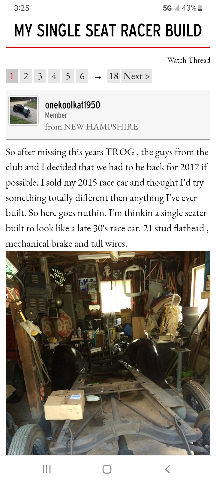

  16. wheeldog57
    Joined: Dec 6, 2013
    Posts: 3,851
    wheeldog57
    Ahhhhh. . . . The Defender! What a neat car @onekoolkat1950 built. We had a great time that year in NJ!!
    loudbang and Stogy like this.
  17. wheeldog57
    Joined: Dec 6, 2013
    Posts: 3,851
    wheeldog57
    This is Ray's build thread for the Defender. Not phone savvy but you should be able to find it with this; Screenshot_20220307-152514_Chrome.jpg
    sko_ford, loudbang and Stogy like this.
  18. Stogy
    Joined: Feb 10, 2007
    Posts: 27,207
    Stogy
    The link to Koolkats build is in Post #38 and Post #43...;)
    Outback and loudbang like this.

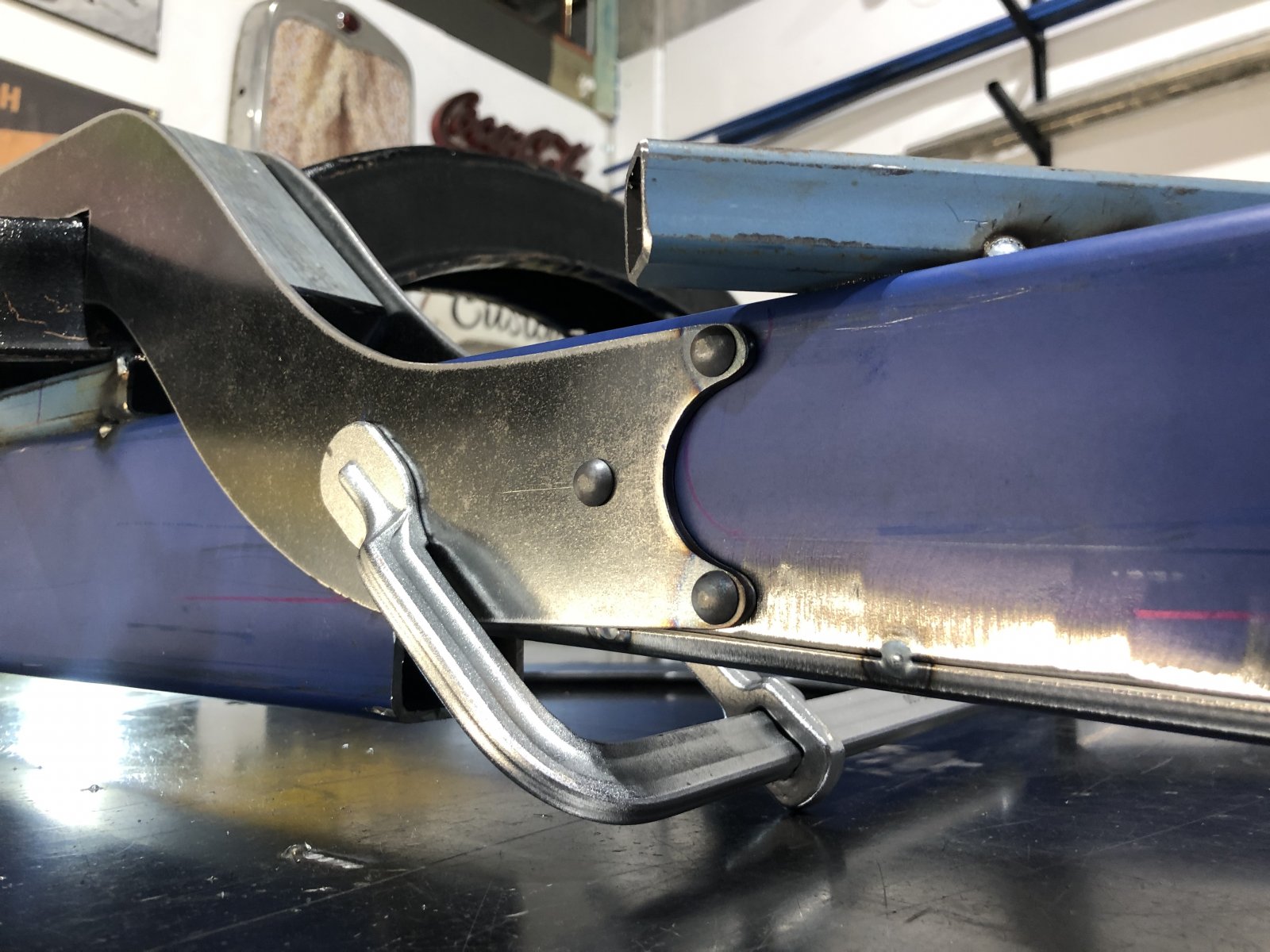

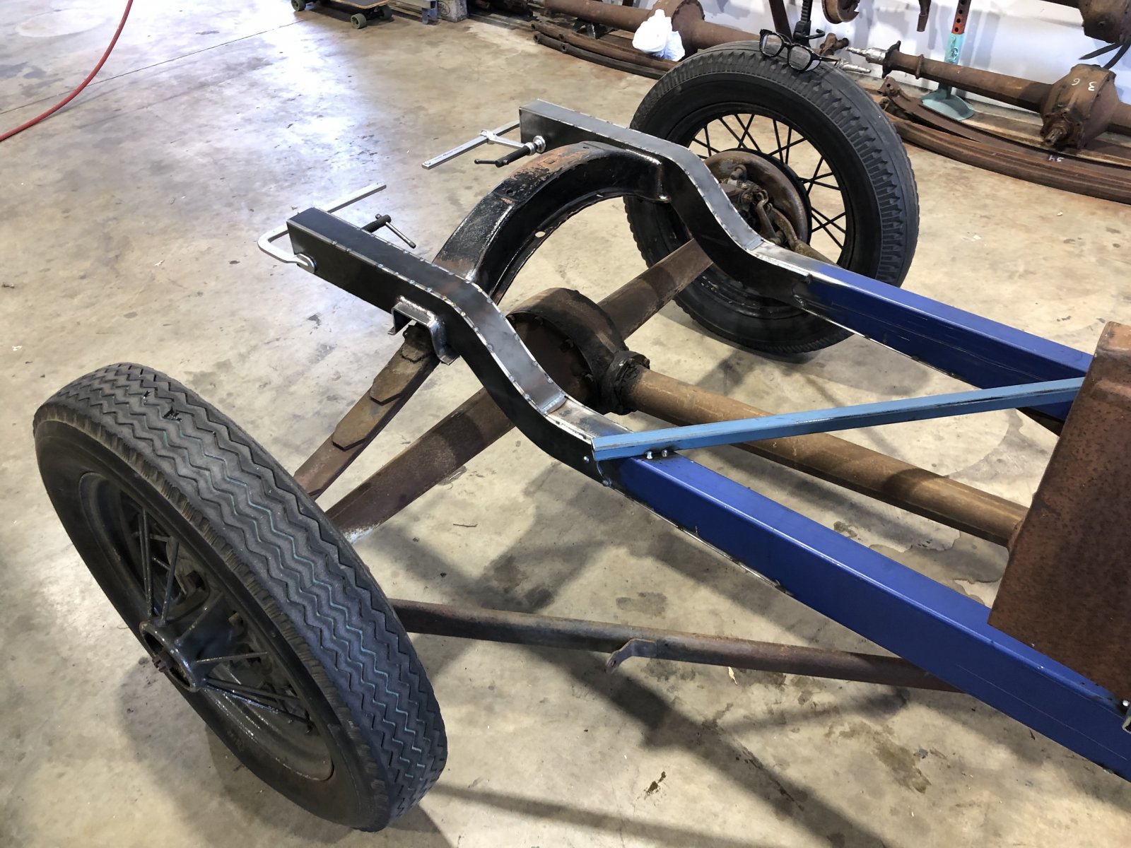

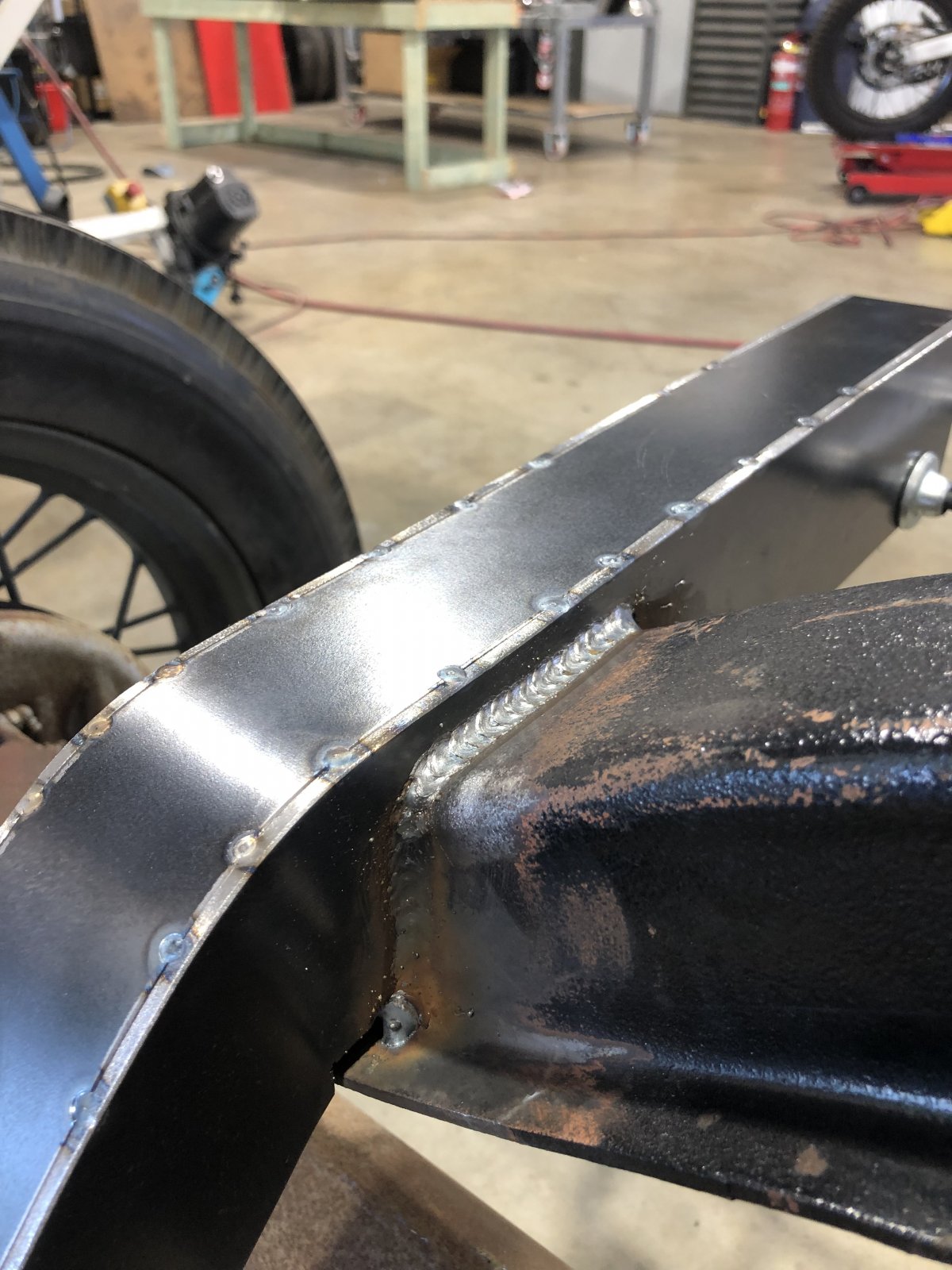

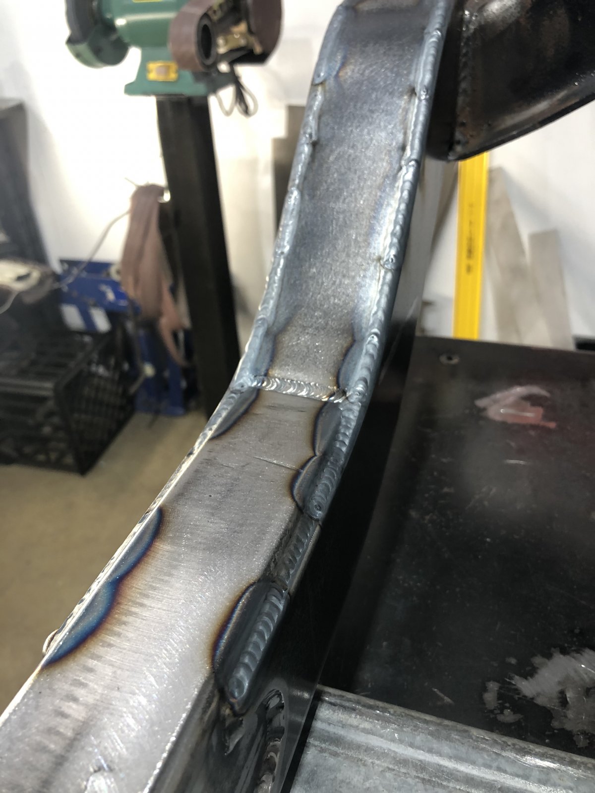

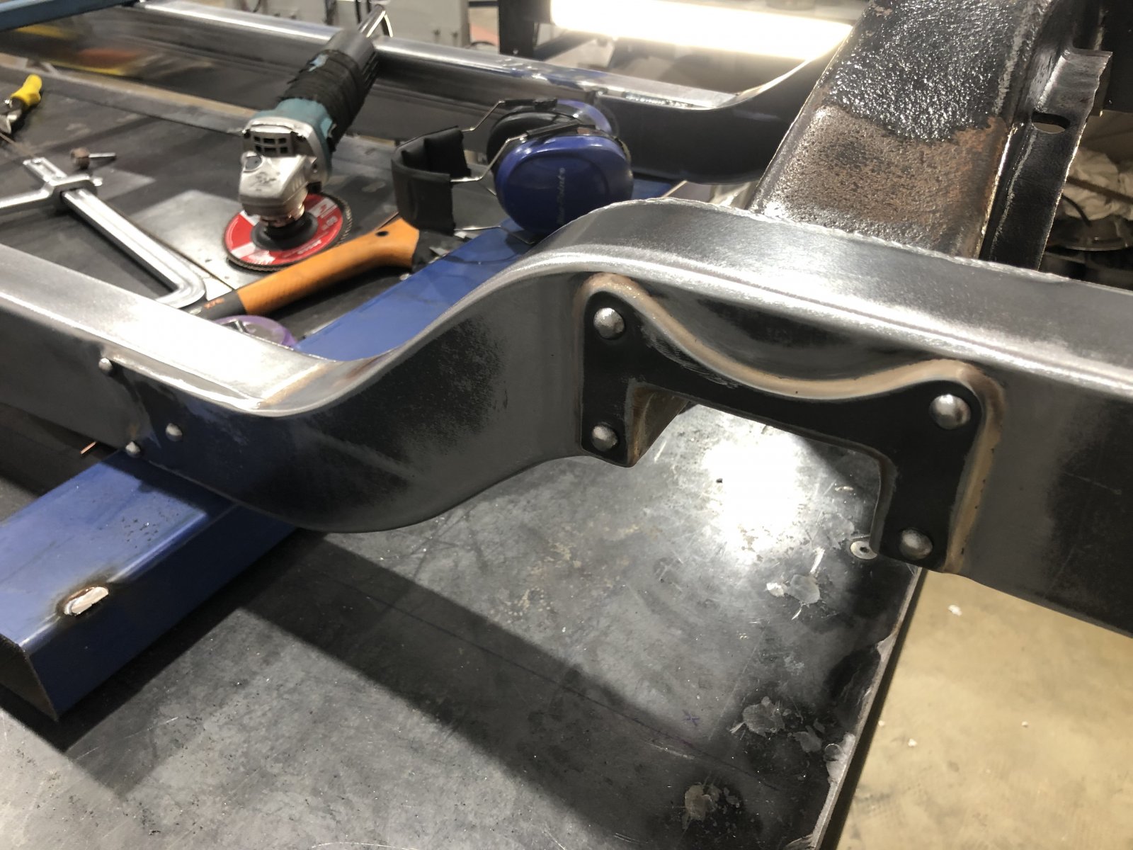

  23. Finishing up some welding on the pinch, horse shoe and rear sections.
    I’ll go into more detail on blending tomorrow. 1DCAE23B-0501-4AF9-B194-5B85775CB00B.jpeg DE8D202E-329B-4A6F-A929-0E18CCEB9552.jpeg 500E7B8D-03B3-496B-97C2-EC2EE80563CD.jpeg 4A0BC9D2-19D5-4697-B88E-B36ACAA5052B.jpeg 45BEDAD8-43B5-4278-9EB4-298792B98BCF.jpeg C038AD7F-DCE4-47A4-BA48-6E349D55AFA6.jpeg

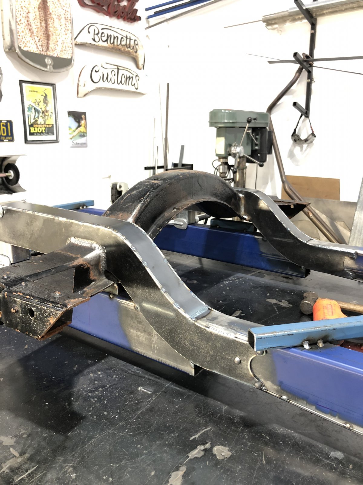

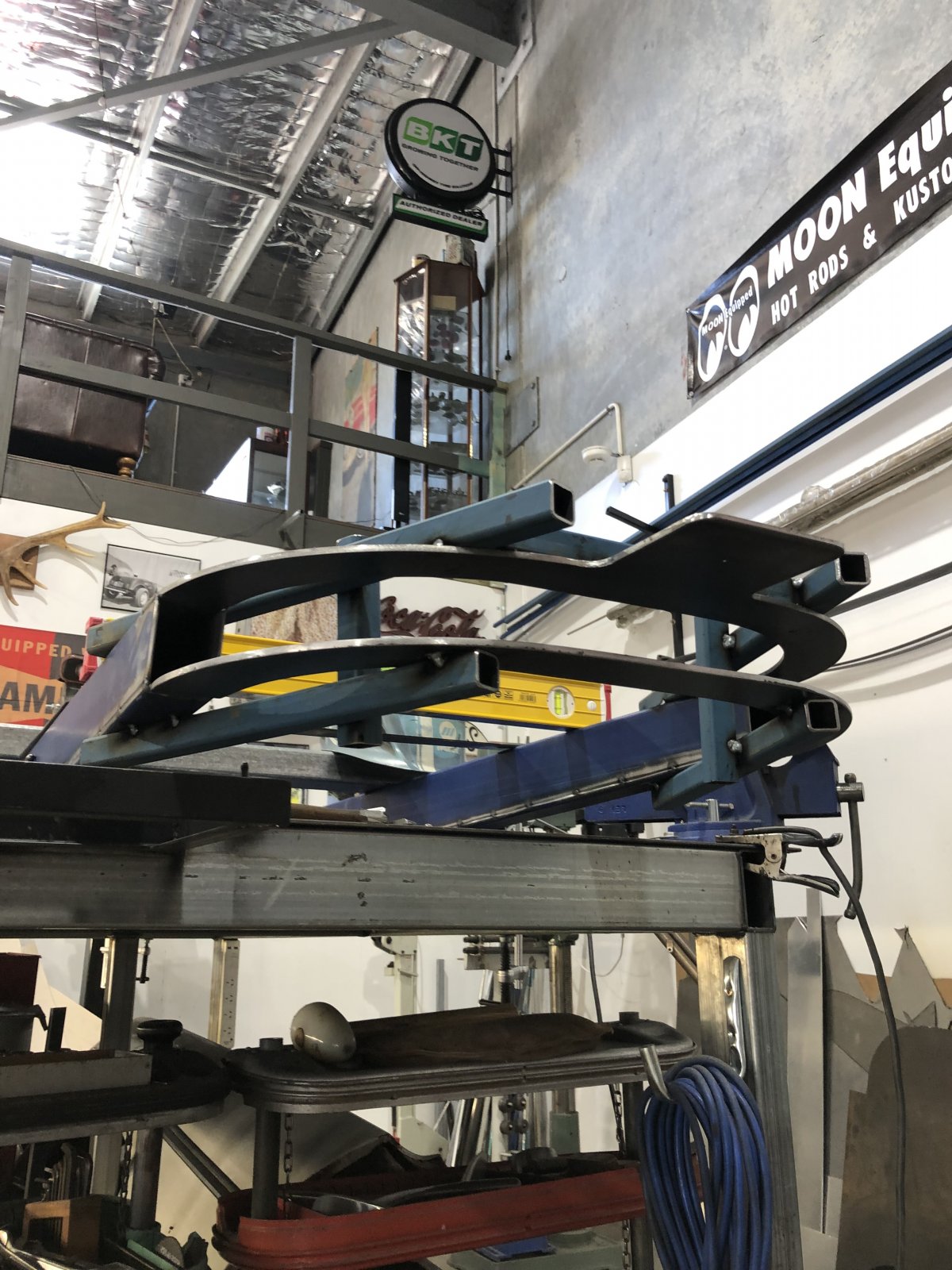

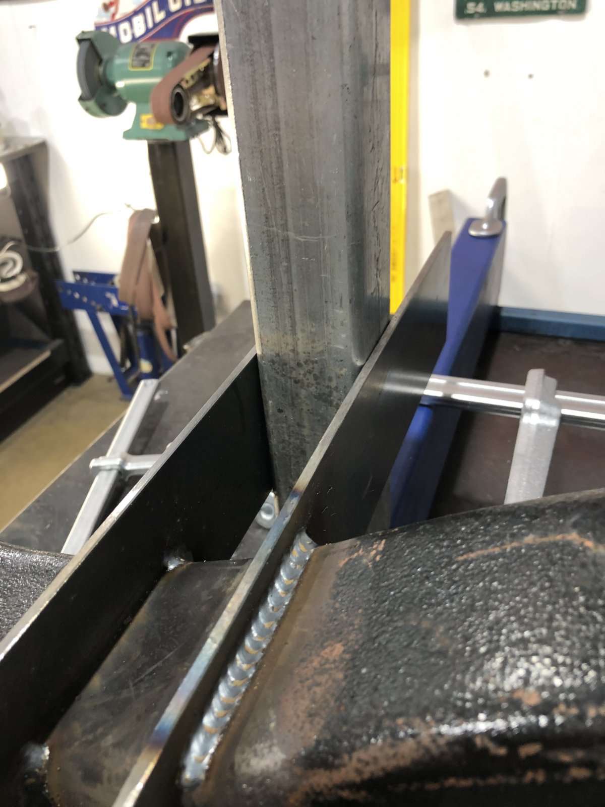

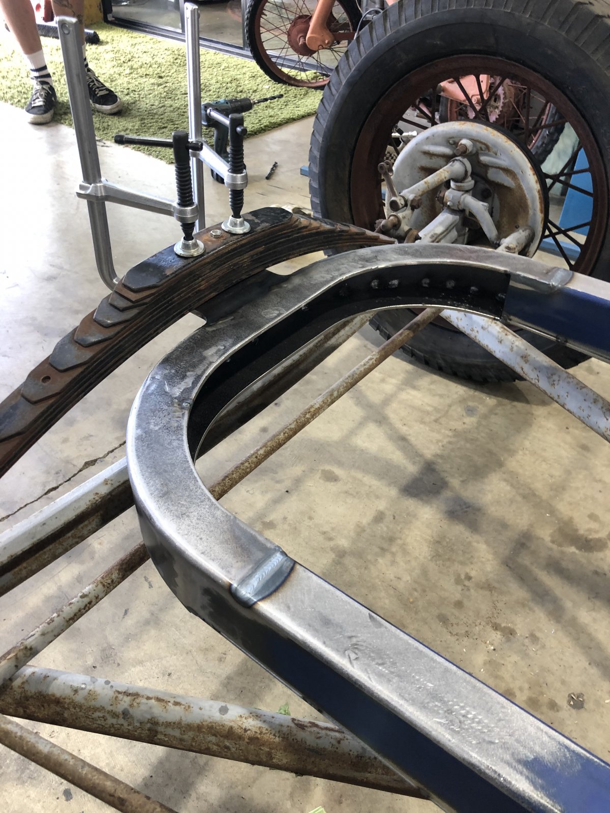

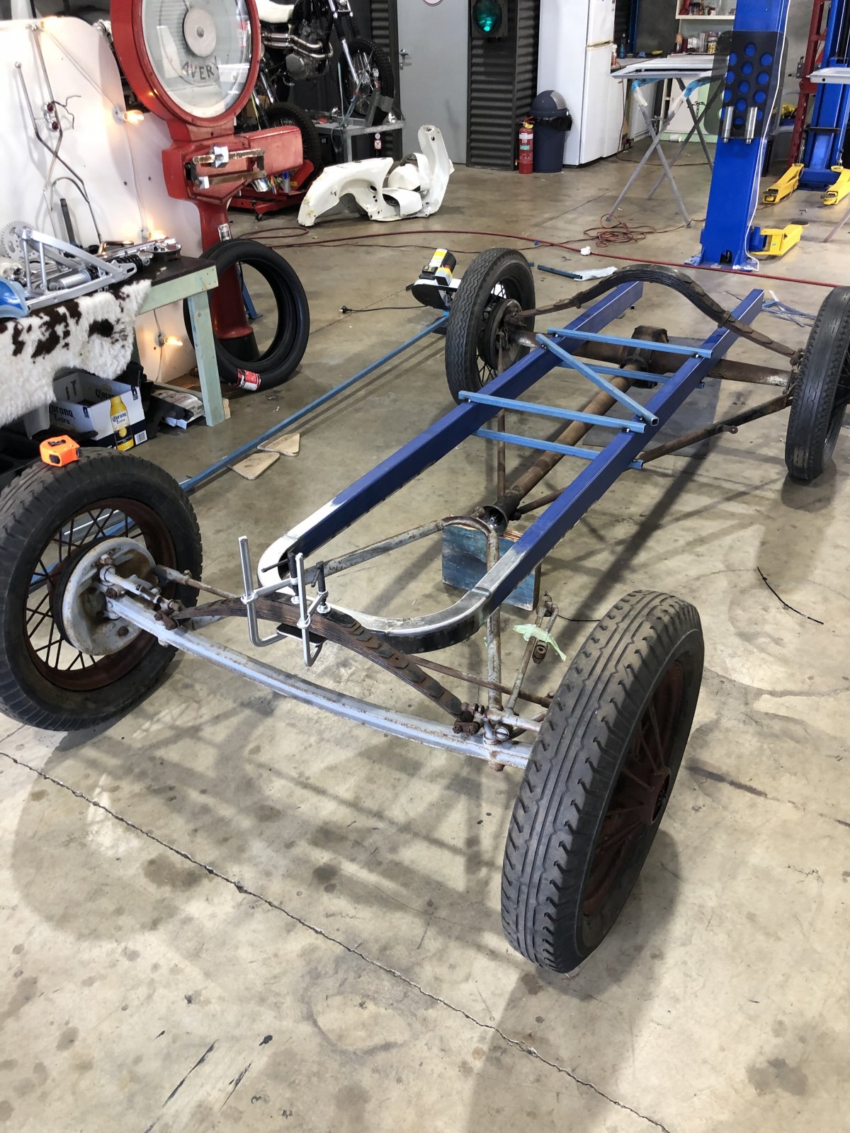

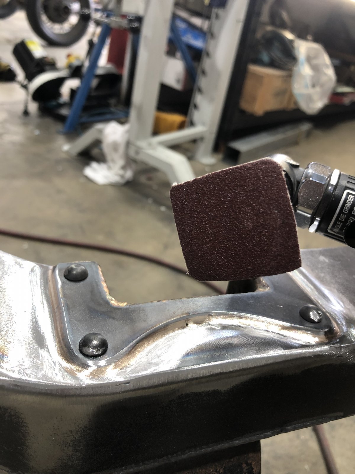

  25. Finished off all the welding and blending on the frame today- the tapers in the frame, the kick ips for the rear ( the back frame horns will stay until I decide what to do with them and the rear portion of the body, I few asked about the blending technique with silicone bronze. These plates on the rear are not really structural hence using the bronze. I cut those Roloc wheels into squares so only the corner portion is hitting the area making it rounded and blends perfectly- then a USED red scotch brote pad on the wheel to help finish it off, tomorrow it’s split wish bones and motor mounts.
    one thing I do need to know to fitting a model a rear torque tube to 39 box? The pieces needed for this. I will have to shorten this a fair bit prior.

    Could you discuss the procedure for doing the silicone bronze tig? I.e. what prep, rod gas if different, etc. I've seen the results, but have never tried it.
