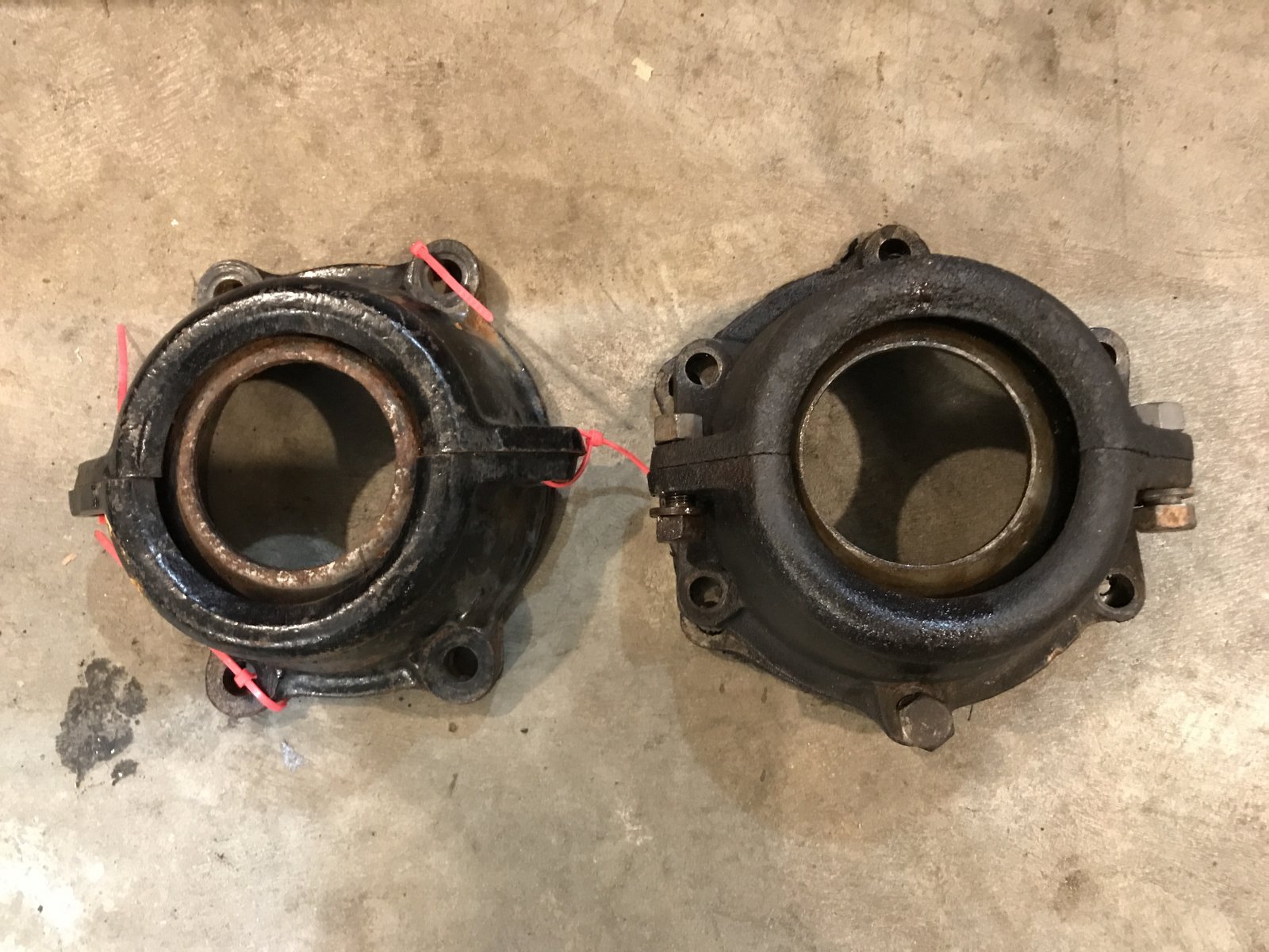

    You'll need a V8 clamshell to couple the torque tube to back of '39 trans. V8 clamshell has 4 perimeter bolts, Model A has 6. Here's a ****py pic, V8 clamshell is on left:
    Oh, and as a speedster guy, I love your project.
