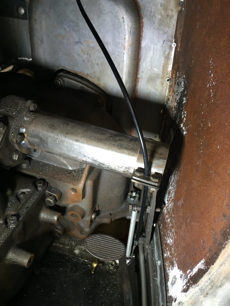

  5. 282doorUK
    Joined: Mar 6, 2015
    Posts: 524
    282doorUK

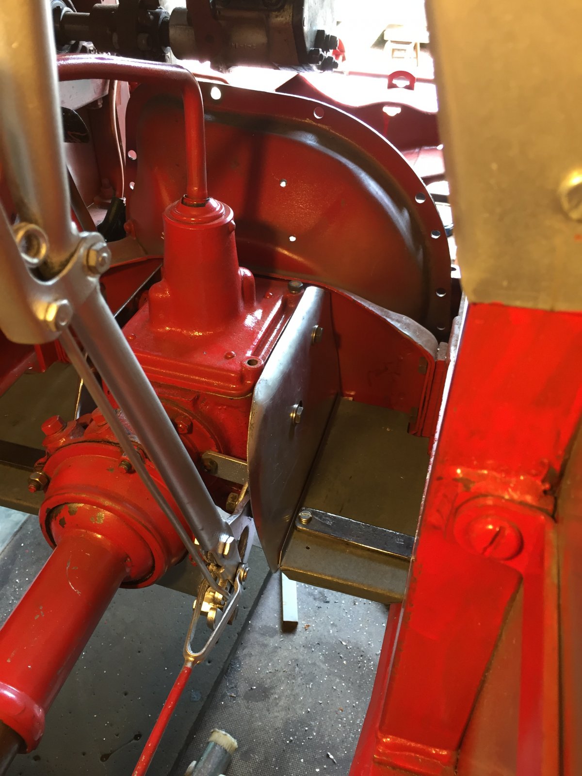

    For the avoidance of crispy fried ankle bones I installed heat shields in mine.
    Lift my foot for the shortened clutch which is just about usable to start and stop, only use 2nd and 3rd which I can slip shift when moving.

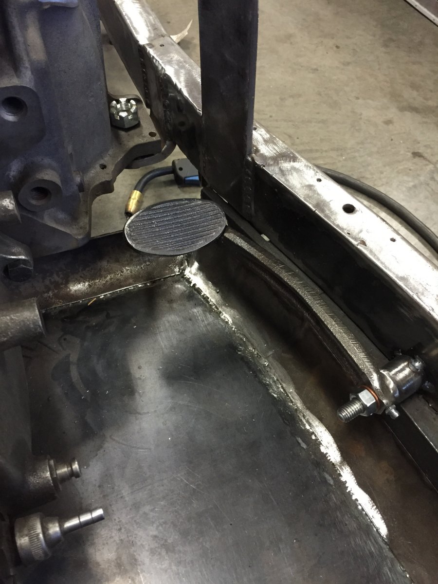

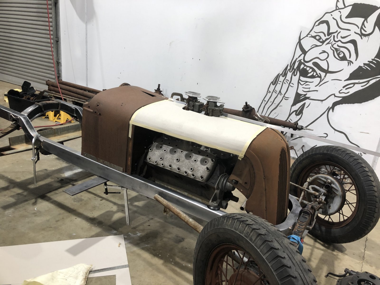

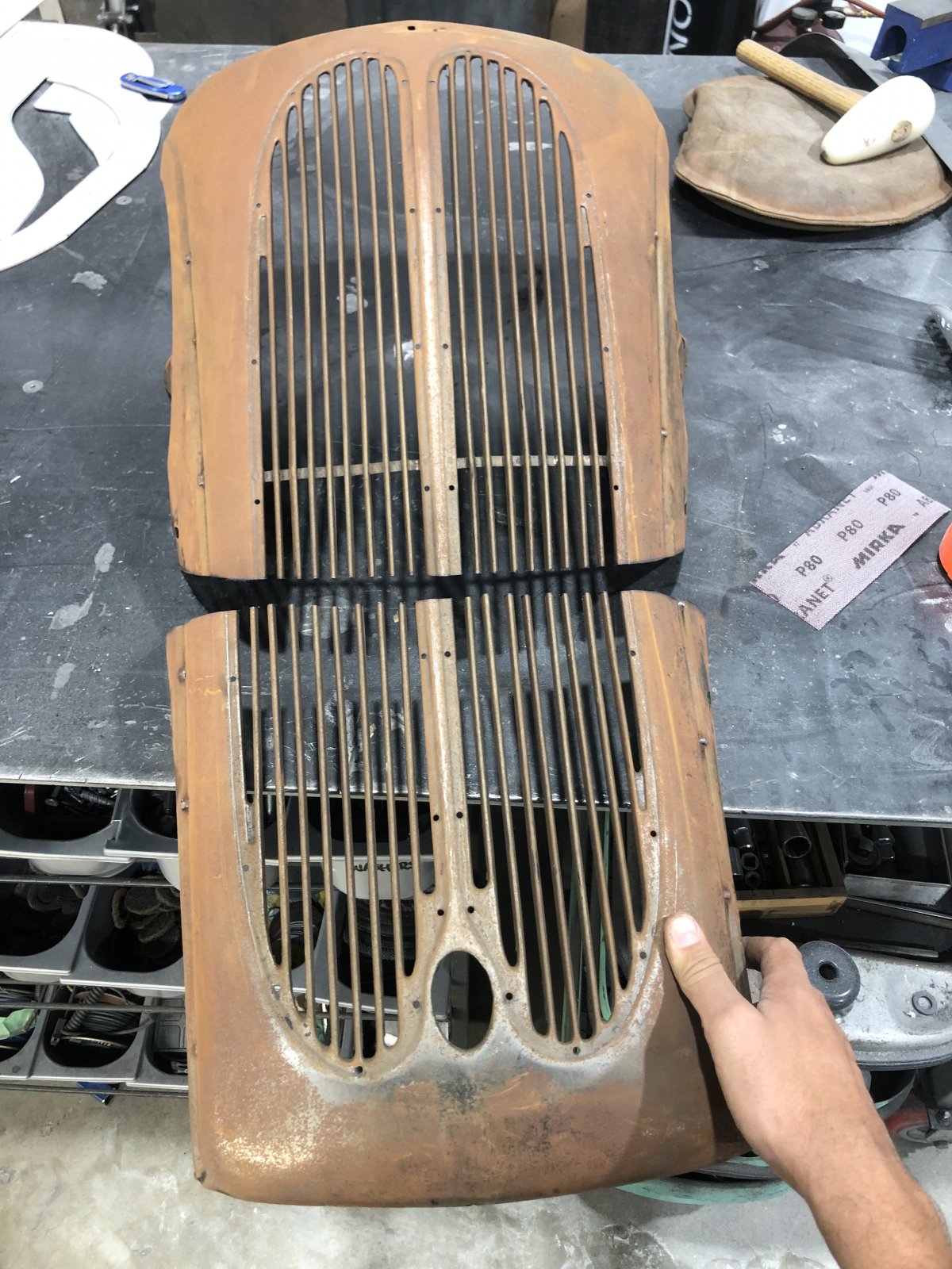

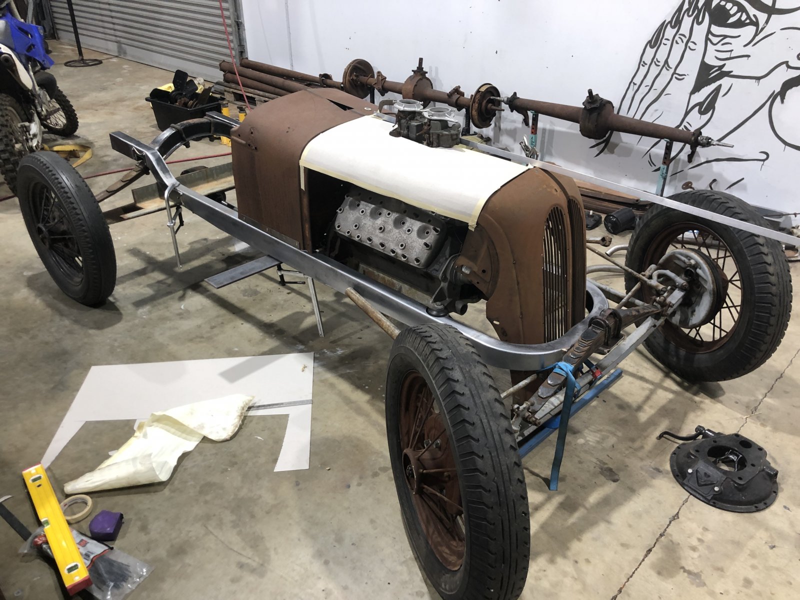

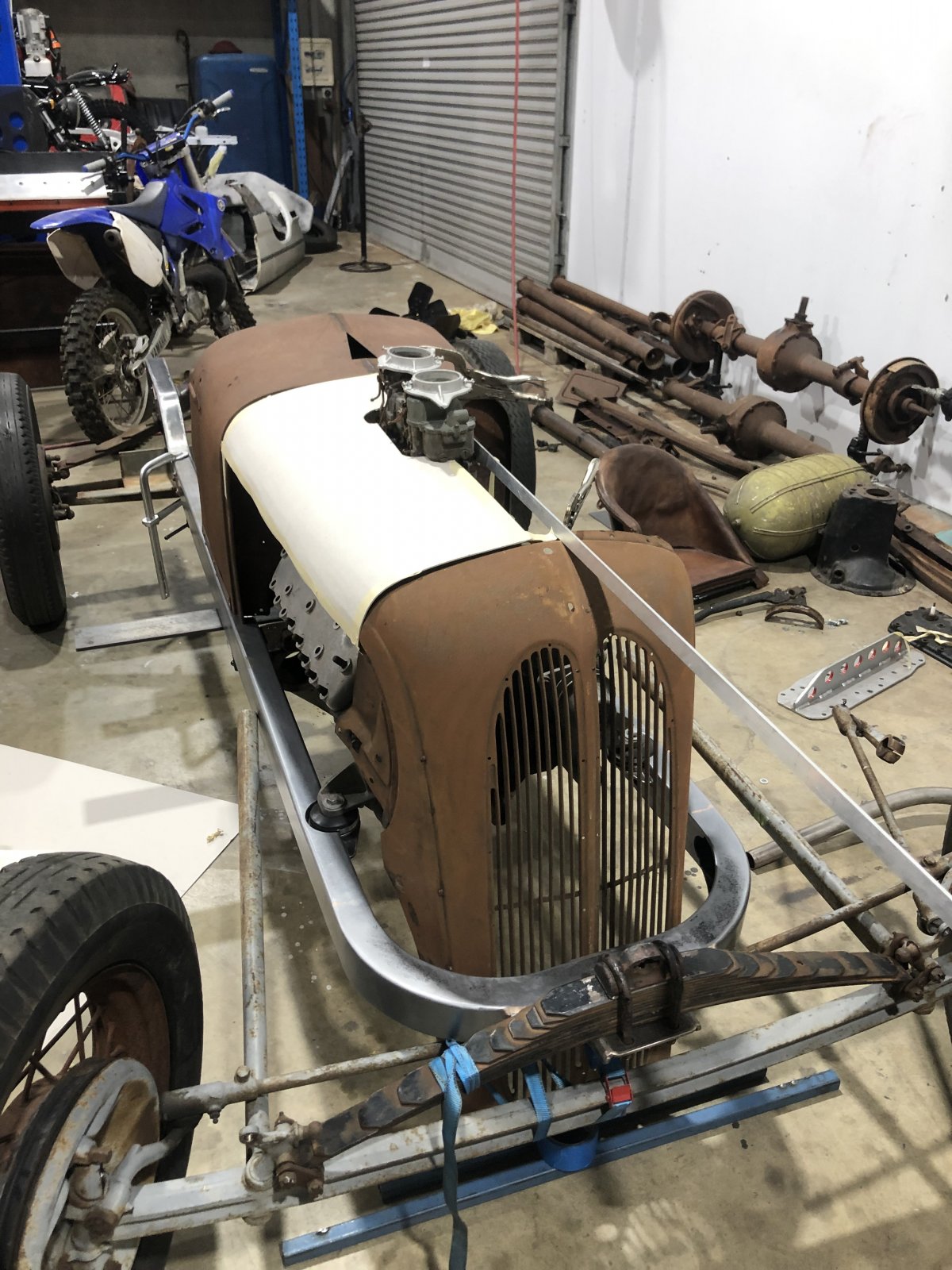

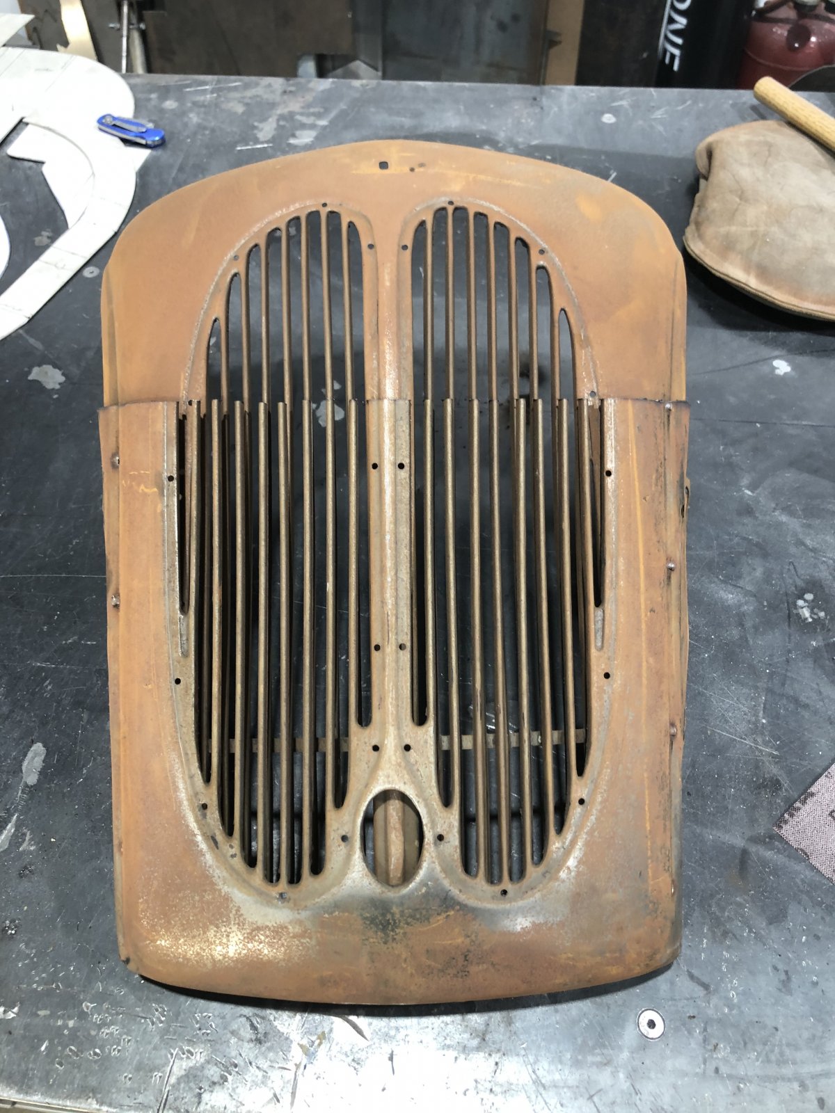

  6. Yeah I think I might have to think a bit more about my mounting on the trans and see some other options. On a better note I did a wee mock up with some arts and crafts I will section the grill tomorrow and see what it looks like mounted.. D84FE95B-A23C-4DCD-B375-97598B8E9A42.jpeg 41FC4E48-B4D6-4CE1-B4E7-57D0D6F61D6F.jpeg 5769376C-8C05-4901-AD29-506D3512203E.jpeg
  7. Anyone mounted off the bottom or mid plate? Saving all this room?

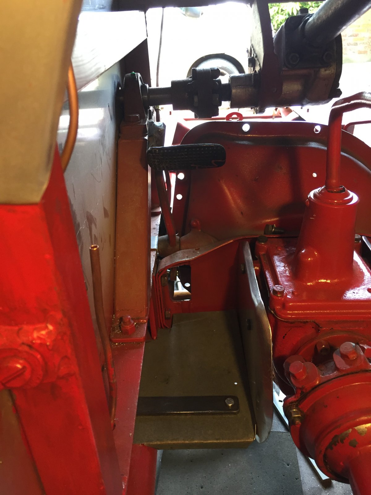

  10. rusty rocket
    Joined: Oct 30, 2011
    Posts: 5,262
    rusty rocket

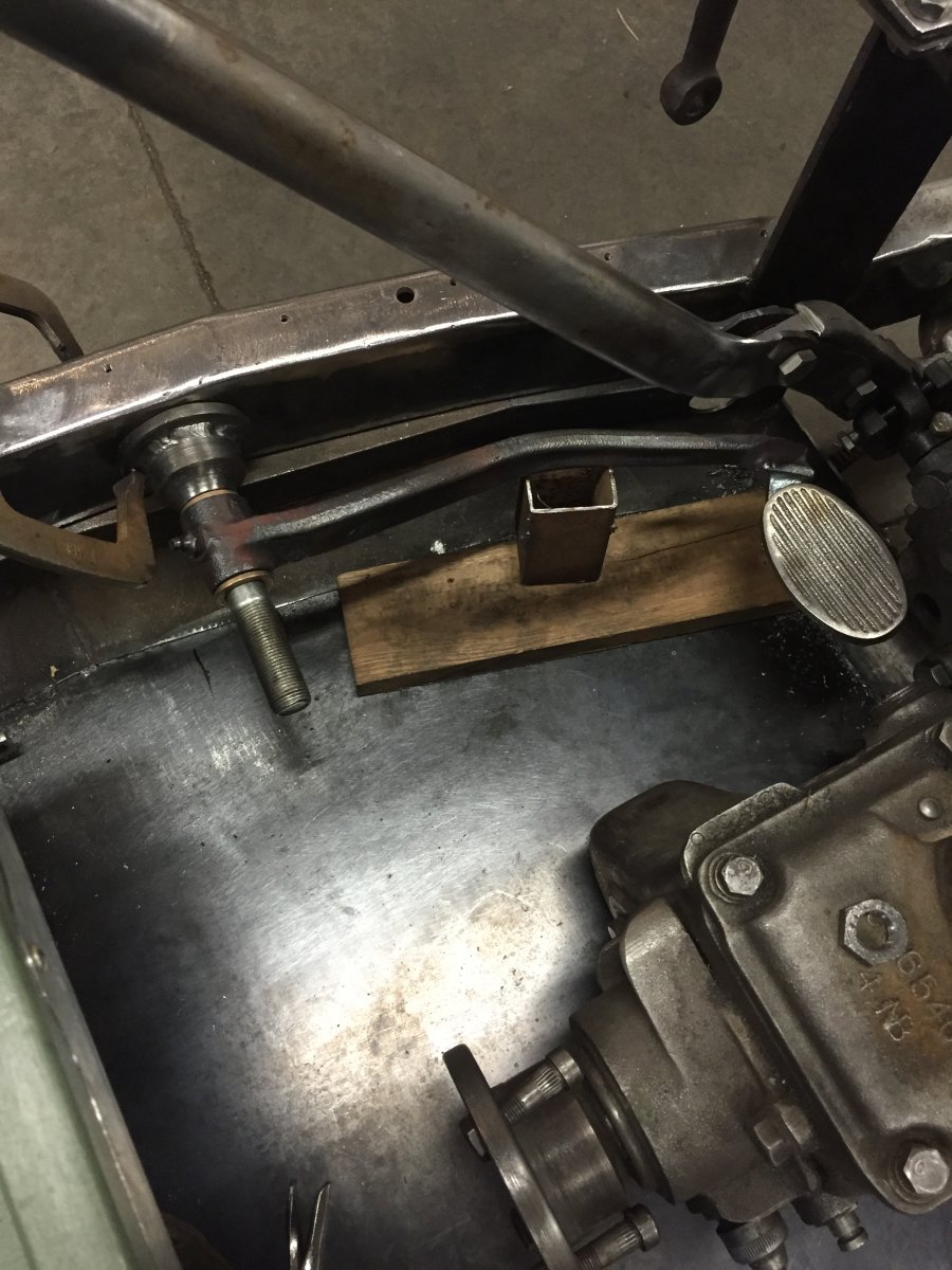

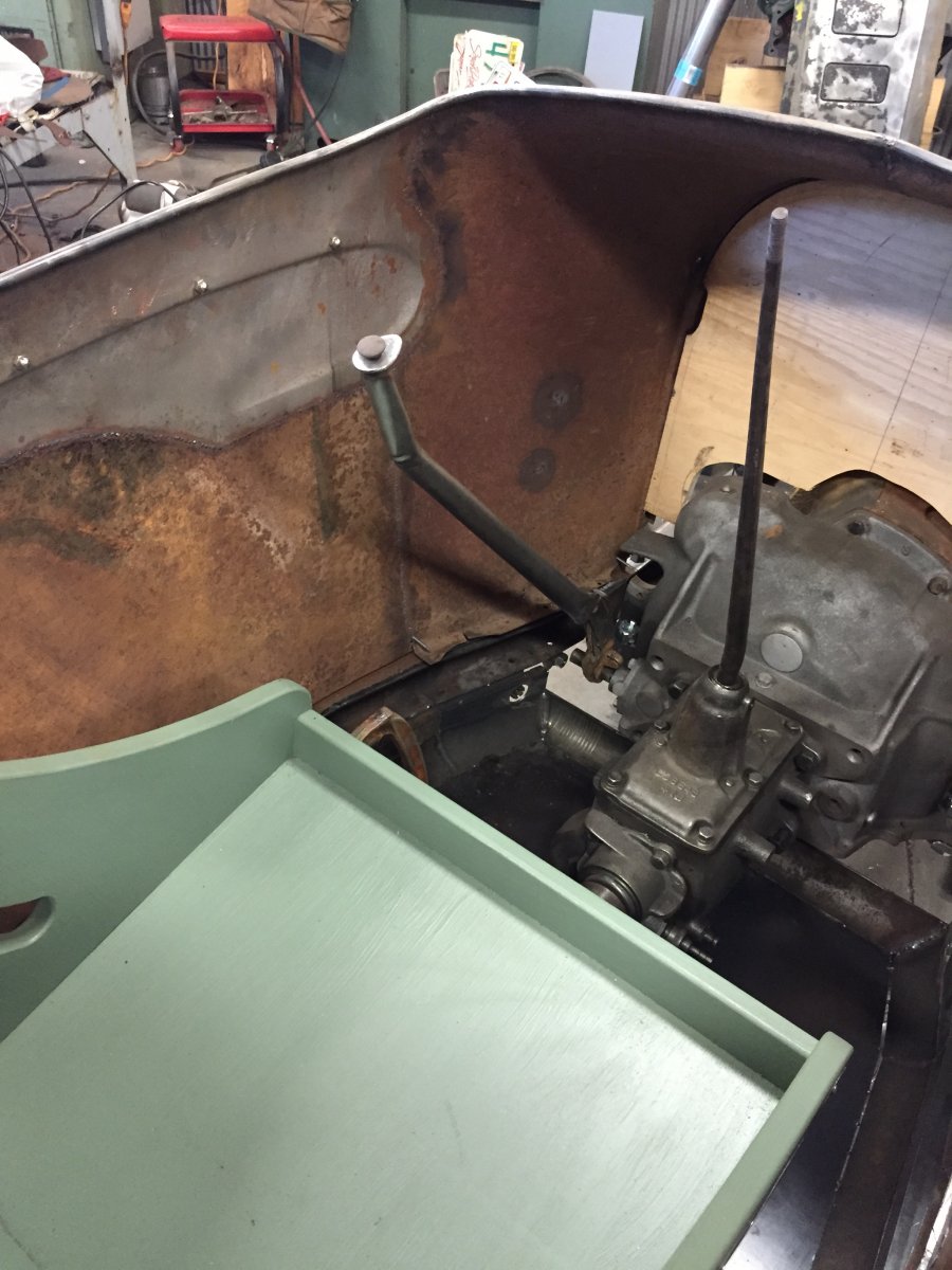

    This is what I did on my single seater. It a flathead dodge powered car with a dodge pickup three speed some what like the ford trans in the clutch pivot shaft are very similar. I used ford pedal arms for the brake and accelerator but welded the dodge pickup pads to them. I used the dodge pickup emergency brake handle for the hand clutch. 3AF12468-3687-408E-A002-8E07BA86F62F.jpeg 529BAC07-B1FF-44FB-A2B6-CB4C524558E5.jpeg B02E7630-7F58-41E6-995C-897ACD5BB2AE.jpeg C7C29292-82AE-4E32-8F5B-BF38A89C69C3.jpeg

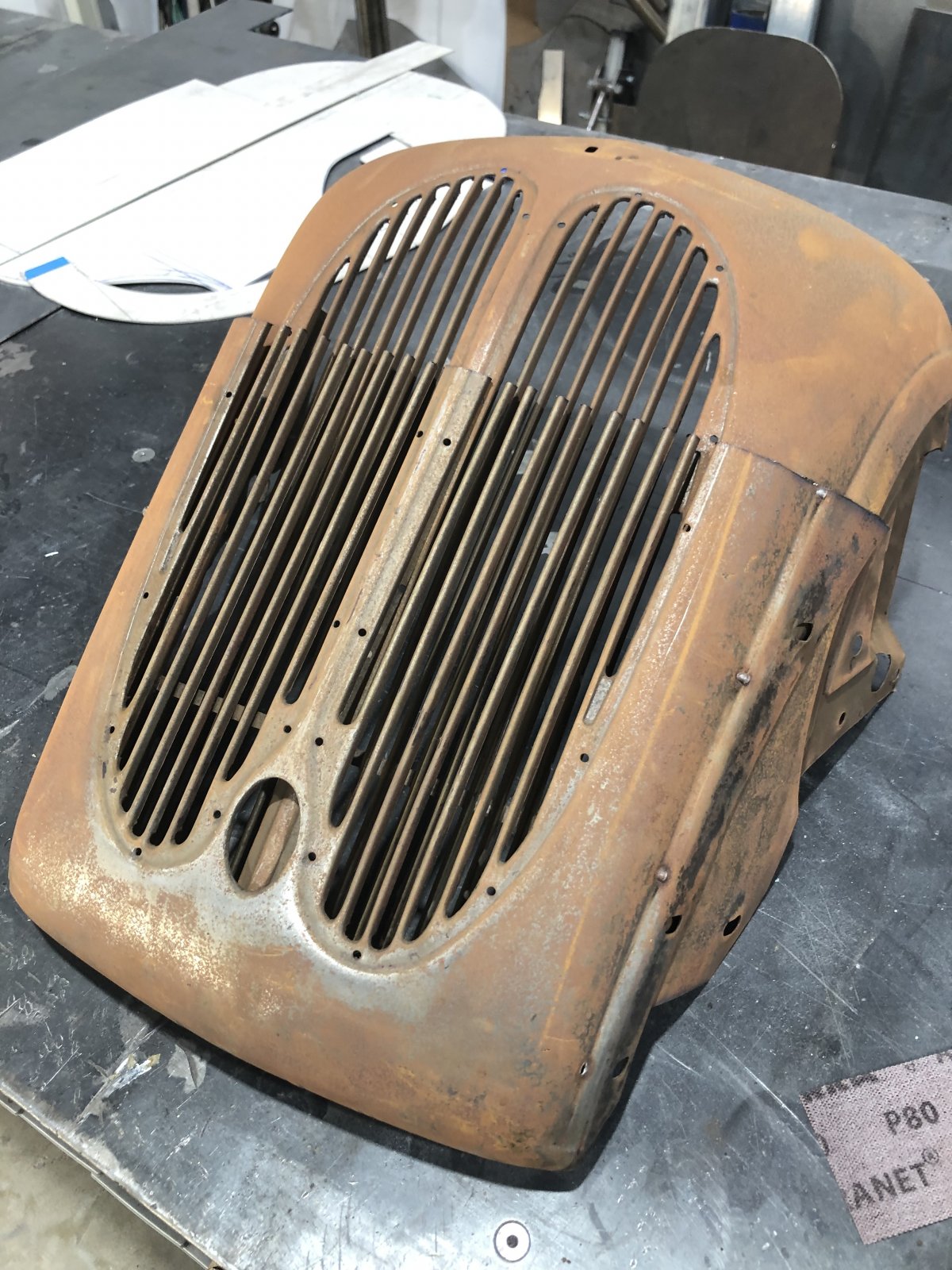

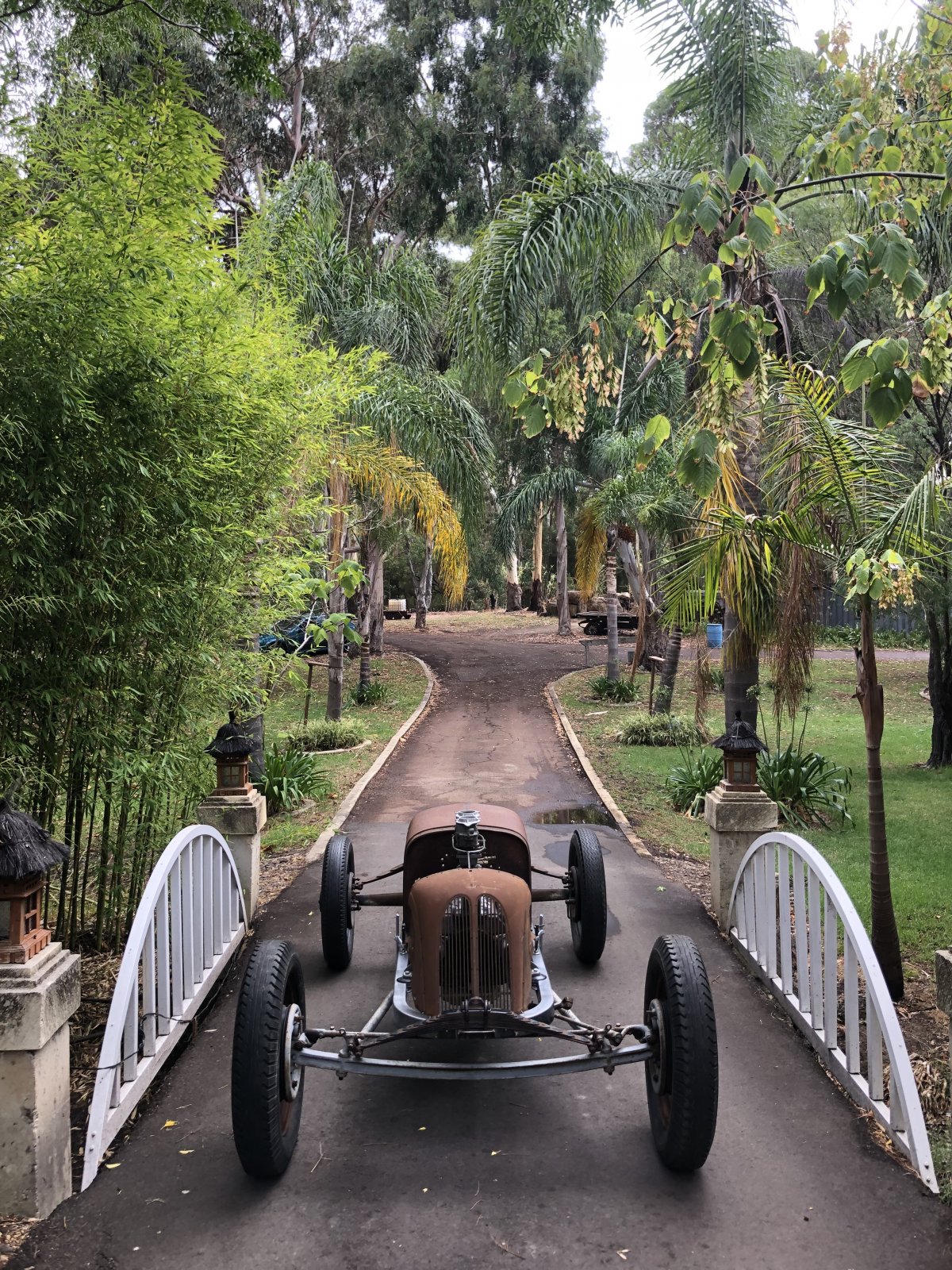

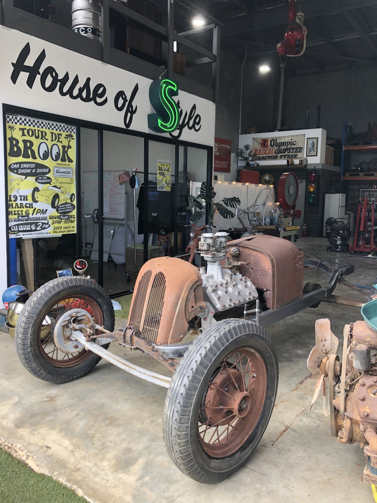

  12. Yup that’s a good set up, it might be back to the drawing board for me for sure! Got it outside today for an event we have Saturday, I’ll take some pictures.
    oh yeah I cut that perfect grill, getting some ideas…
    CAF23715-7A3F-4CFD-96EC-1A10343C8D77.jpeg 67866DEB-1E87-4425-92B2-803F99920DE4.jpeg 7BC54A9F-26A1-4280-ACD1-4C7C5A7C840D.jpeg 3AA7BAFA-8096-470E-A140-790EB9D85F03.jpeg DAE2CA0B-8B78-4881-8CDA-441EF77989FB.jpeg A3AB2671-8272-4888-A5A9-835794BB2DF1.jpeg 2B202DC7-E50B-40C0-9C09-F1361AE0EBC7.jpeg
  13. 282doorUK
    Joined: Mar 6, 2015
    Posts: 524
    282doorUK
    Grill looks just right from here!

    What's happening Saturday? We'll be down Busso
  15. Tour De Brook! Saturday! I’ll message you

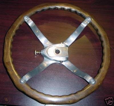

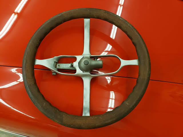

  24. Anyone ever done a nice looking quick disconnect steering wheel?

  27. One of these Fatman steering wheels would be the go and era perfect Jordan. 091A3F02-CE16-452E-9B95-FE3A8C01C9CE.jpeg 9C2FF7CF-308B-4533-97A2-ACB75B6FDFDD.jpeg

  29. They come up in the US every now and then, they were an accessory for the larger bellied drivers. I saw one at the Lone star roundup a few years ago but didn’t buy it, kicking myself but hindsight is a wonderful thing.
