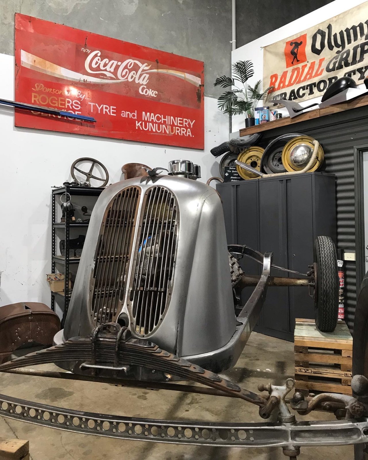

  2. Chopped the frame up and replaced the box tubing with model a rails as per the regulations for the race.. happy with how it turned out. Also chopped the drums off the front brakes and have the axle loosely mocked up. The frame rails are boxed and the motor is back into place. I wasn’t happy with the original trans mount due to the make of room I had for my feet. I cut the original ears off and fabricated a mount and crossmember setup using a stock generic Chevy trans mount. Lots to come. 04397960-038A-492C-97EF-E6A85384AA89.jpeg 2885B729-4112-4D6A-A85F-753C5431C1CB.jpeg 207417B3-5CCB-436A-84BC-D7D884B59E29.jpeg 3219B13E-68E9-4D4B-93C9-72433577E4EC.jpeg 240754E0-691A-4070-91CC-EC89836AE1D1.jpeg 3D72D8E7-9C20-4E90-BA24-67E4127E92F5.jpeg CF70657E-29BF-458D-8A72-28C265B2E1B1.jpeg 564FB2E9-0857-491C-BEFB-AE4B6CE5D42F.jpeg 998A5B91-97A4-4E75-8D84-0ACDFF89EFEC.jpeg 959F23D2-D155-4B70-A679-3D1B5844BF9B.jpeg C1631B48-5247-4D60-A6F1-1AD6051DE0CF.jpeg E6F6071B-1038-4749-97B3-ADA623602250.jpeg

  4. Front motor mounts didn’t change luckily. Only the rear trans mount I completely changed and for the better! Now I can tuck my legs and feet in somewhere haha. We just released one yesterday and another one tomorrow. Lots more next week. It’s guns blazing on this now

    “Back across the pond, started more work on the race car, got the front end dis***embled and the front axle straightened out- and tackled many many holes.”
    - As a machinist I appreciate your workmanship and dedication to creating metal magic.
    The amount of time that it takes to simply lay out the hole drilling pattern can take a couple of hours. The initial drilling process takes a lot of time due to the arc of the axle and having to shift the axle for each location (if your using a drill press). If you are using a milling machine you still have to shift the table time after time to relocate each position then re-setup the drill or hole saw. I’ve found that the older axles can have hard spots in them that kill drill bits.
    The impression is a H.A.M.B. user see’s a few pics from start to finish. The project appears fairly simple. But to understand just how much work and effort it takes to create the finished product make’s me appreciate your effort all the more. It’s surprising to consider how much time can be spent simply deburring holes
    As I watched your video approach with the grill sectioning a person can kind of understand the planning, initial steps, dilemma’s that crop up that force a re***essment and change in direction and how you addressed the challenges.
    Nice Job!
    I’m curious, maybe I missed it as I was reading through. I thought that you were preparing for a race that was taking place this summer or this year sometime? It seemed like a ton of work to preform to get it ready with a hard date to have to meet…
    Once again, you are a heck of a craftsman

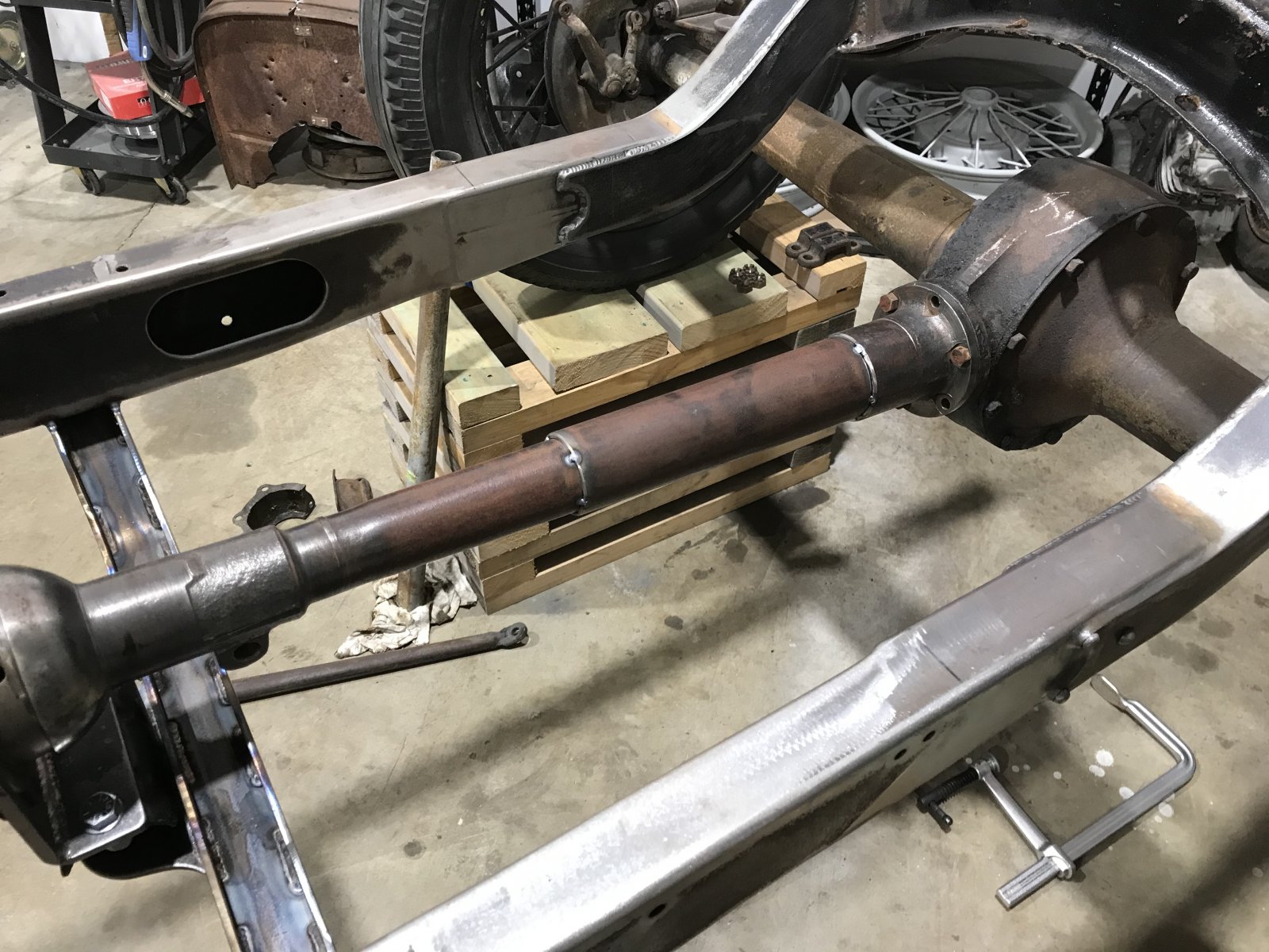

  9. Today I got the car up on the stands, rear torque tube cut and fitted. ( driveshaft next)
    Front spring removed, sanded and new bushings pressed. Lots more to come 894F83D8-6AF4-48D2-89B8-89B15CEAA10C.jpeg C9E5967B-A8B7-4311-AD50-F96EC2B0D940.jpeg 15AD8807-B5AF-4F11-8391-8DD89E9109BD.jpeg CA250783-8972-4B77-9CFC-998DD19FEB11.jpeg 96F6CD57-C719-455A-B9A6-236ACC41214B.jpeg 0A148886-53A1-43D5-8D7B-D958B3783217.jpeg 5165F037-8C30-4BF7-B8A4-8722EC5497C5.jpeg 4CB0C34F-A4AD-4E08-BA7B-5C142B0CA226.jpeg 1D656679-16A9-4F62-9D90-54E1D8EF8737.jpeg

  12. Today I got the from led spring cleaned, sanded and radious each end, now for the split wish bones on the front. Question is if I do the rear will it bind or fight against it self using the torque tube. 852A0F2E-63C2-4E3A-BD18-199883ABA427.jpeg 27D06F82-5C85-4127-A1A2-661262D51282.jpeg E26FCF76-379A-4F89-B732-57B3F93B1ED9.jpeg 216D6C4B-7550-44B2-A7B7-04C851141698.jpeg E57BC5F1-911D-4A2F-9A9C-76A2A58C6DDC.jpeg 4B0173AA-FE36-4B46-BD08-543144097D10.jpeg BBA6F78D-7891-4050-94AE-628B88A1C678.jpeg 3AE7FABF-F54C-4DC2-B7DB-0B0122351942.jpeg
  13. ratreo
    Joined: Jan 24, 2010
    Posts: 76
    ratreo
    5449937[/ATTACH]
    Morning,
    But of course you are on the other side of the planet so it must be late afternoon there.
    It is my understanding and experience that the rear radius rods (with a torque tube driveline) need to be as close to the centerline of the ch***is as possible. The rear end in a twisting articulation with one wheel potentially rising and the other tire staying in flat contact will potentially “load” the attachment point on the framerail eventually causing it to fail.
    In your intended application you are pretty much spending all of your time going straight so it may be a condition that you can accept the compromise with.
    There is a H.A.M.B. member (in England as I remember) that addressed this about 4 to 5 months ago. He is/was building a bellytank to run at Pendine (sorry if I got the spelling wrong)
    Also hopefully Pete Eastwood is watching your progress and will chime in. He is a wealth of information as are so many of the folks on this site
    Go safe, Go Fast
    Outback likes this.
  14. As your diff travels up and down even slightly the distance between the diff and the gearbox will increase then decrease off their centreline which a slip yoke usually allows for.
    Unless your r/rod mounts are inline with the centre of your uni joint within the cupped housing in both planes something will have to give. IMHO. The torsional loads are another thing all together.
    Happy to be corrected.

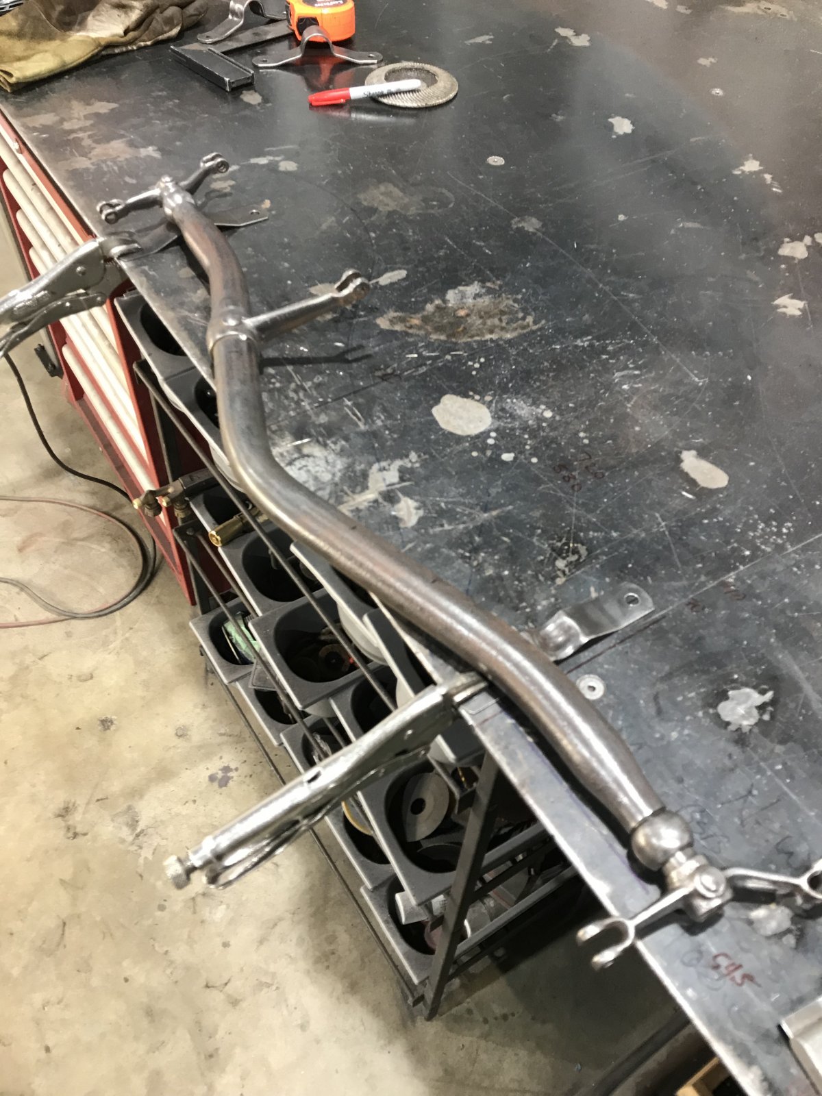

  15. Managed to get the front wishbones done and mounted. I used model a ends and used 32 truck bones. Cut and grafted them in. The top the the bones sit level with the frame, they were larger than the model a ends and added a filled and blended everything. It’s sitting at 7 degrees caster at the moment. (In the photo you will see one welded. I Tig welded them but
    mig welded one side to show you can use both)
    I used a small amount of silicone bronze to blended after everything has been welded.

  16. I used the original brake cross over bad and narrowed it 140mm to work with my narrowed frame, I will figure out where the hand brake will go and the orientation of the brake arms and rods.
    Trying to keep it simple.

    Very nice work as usual, are you having a foot brake? I'm sure you know, but putting the brake lever outside the frame gives more ****pit room, and you can position it so your hand drops right on it. Makes it much easier to find when you need it in a hurry, don't ask!

  18. Yes definitely planning on it otherwise on the inside near the trans- going to play with a few places to see what’s comfortable
