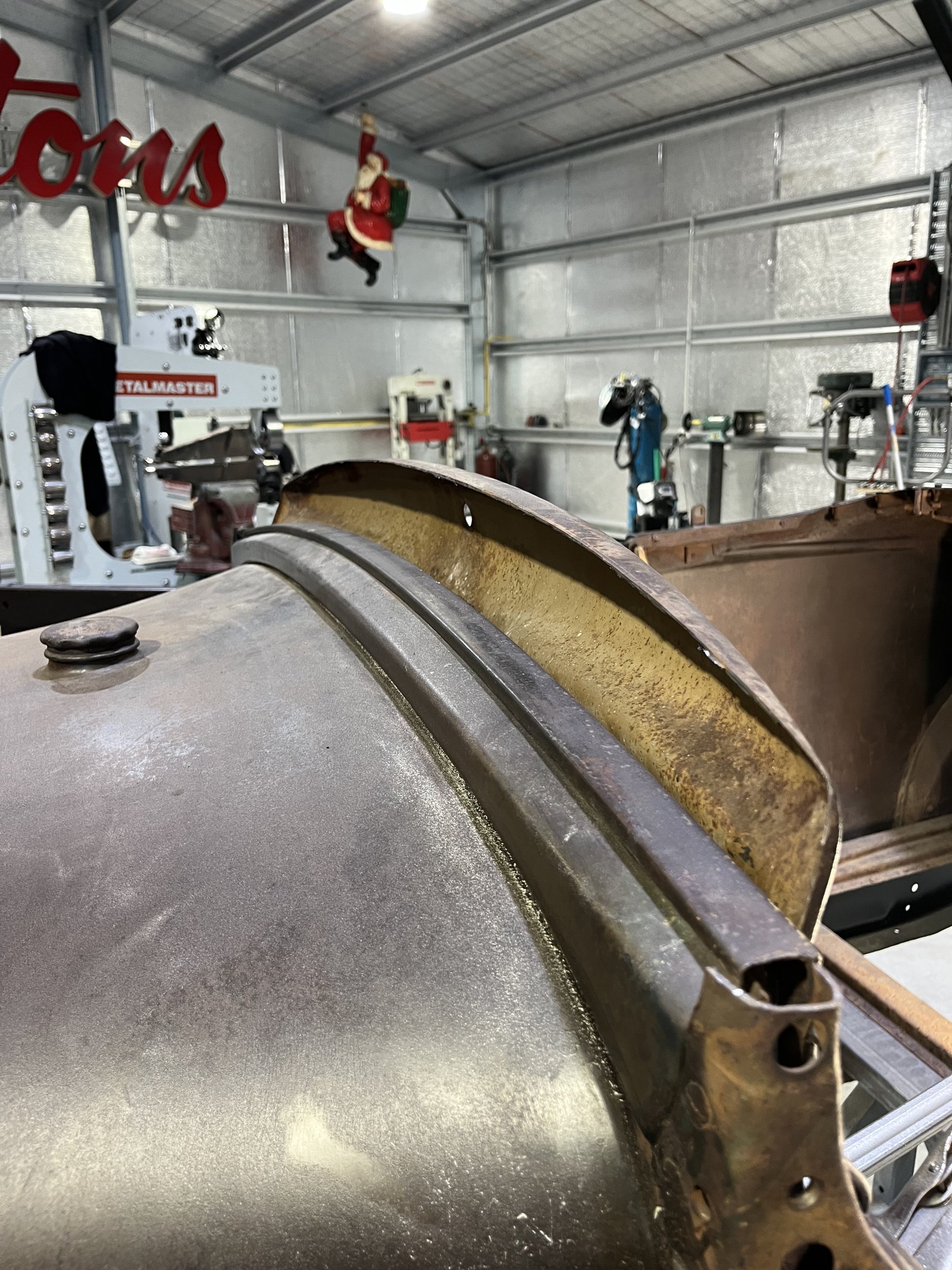

  1. Bit more of a play around with the dash trying to figure out how to get it sitting in the right spot, right angle, and at the right height. I’m trying to utilize the top dash rail piece to the windshield will still seal at the bottom. I’ll be scratching my head with the corners.

  3. Still stumped of the dash. It sits low, and my knee are high. I want to section the top and get rid of the bulge. I’ll sleep on it and come back fresh in the morning… IMG_3317.jpeg
  4. dirt car

    Deeper inset to clear your knees if the fuel tank is trimmed out ?

    Shorten up your legs.... then you don't have to raise all the equipment in your shop you sasquatch!
  6. I never looked at this way! Seems easier! Hahaha
  7. I’m trying to use the factory tank! If I can

    Difficult to tell by the photos for sure, & shameful to cut that dash but there appears to be 2" or so between the bulge area & the so-called glove box area on either side of the center cluster that could be trimmed & moved up with the glove box still functional yet providing the kneeeed room ! At first glance the modification may even be unnoticed & could save a good percentage of the patina if so inclined, just a fleeting thought.

  9. I actually tapped this out to see. About an 1 1/2” id get- probably worth it!

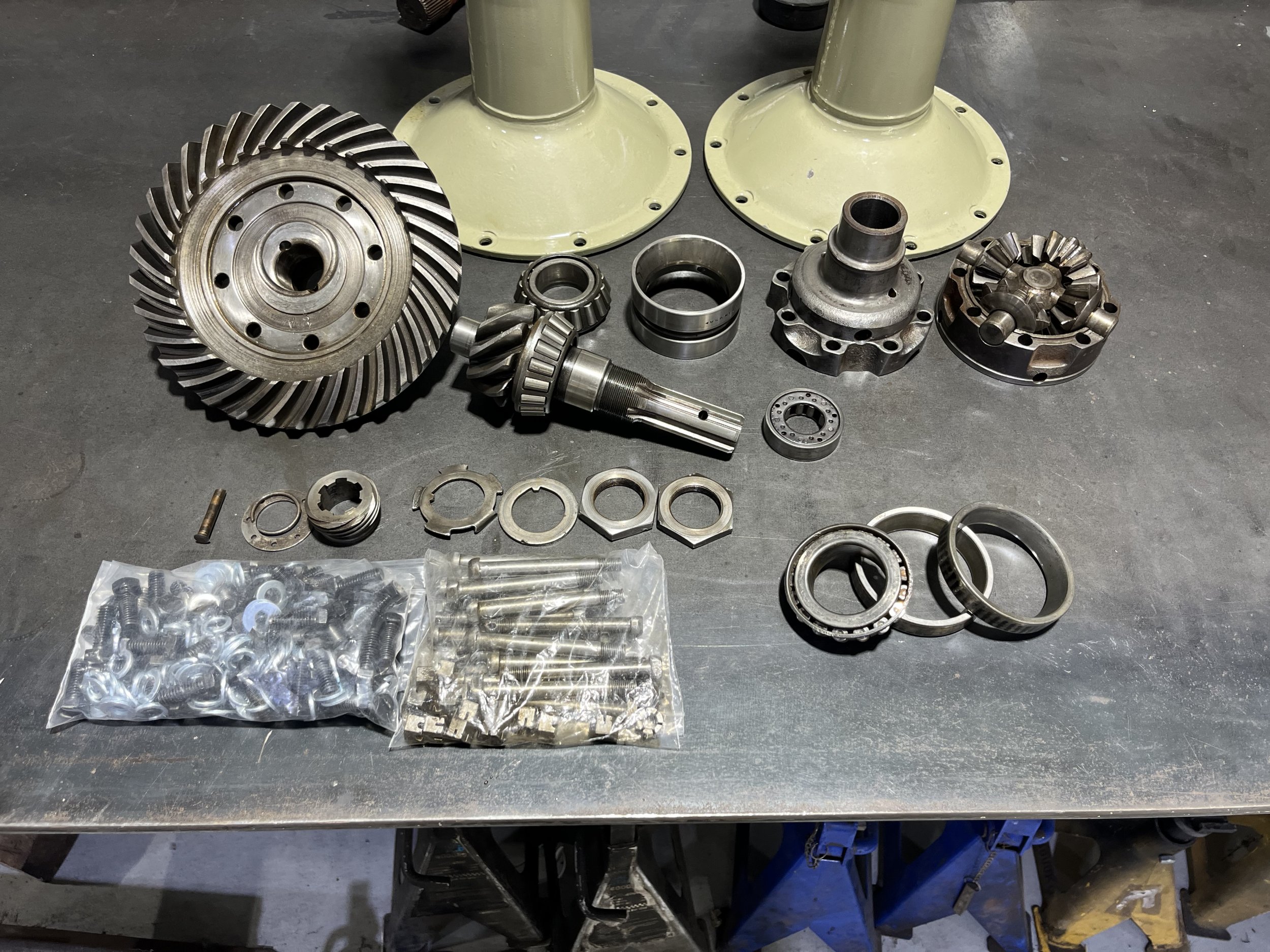

  19. Planning on getting the other side of the dash finished off and fitted. I pulled my rear end pieces out and will start that process so I can get the rear crossmember setup for clearance for the quick change. Big shout out to Pacific Quick Change too! Very excited to get this under the car.

  20. Getting all the rear bits and pieces ready to setup the rear end with the QC. I want to put this together then mock up to get a gauge of heights before I modify the rear crossmember for the QC clearance. Bell ends will be painted black. IMG_5114.jpeg IMG_5116.jpeg IMG_5127.jpeg IMG_5124.jpeg IMG_5126.jpeg
