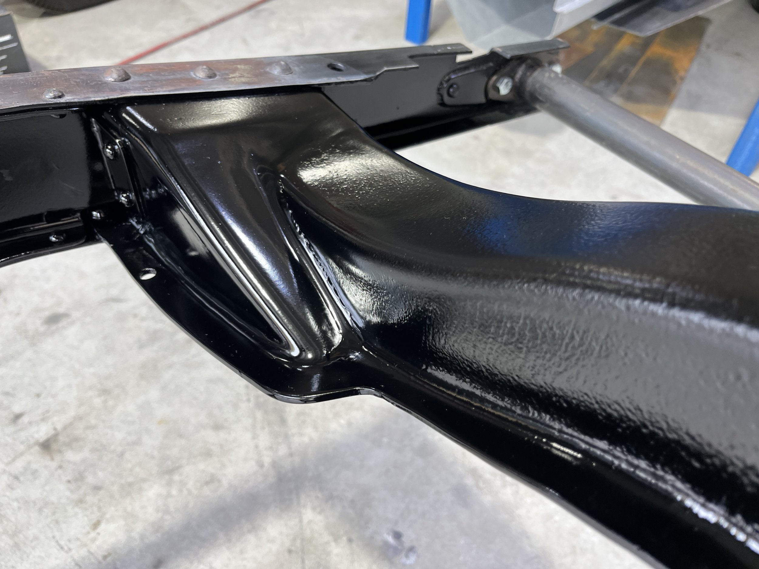

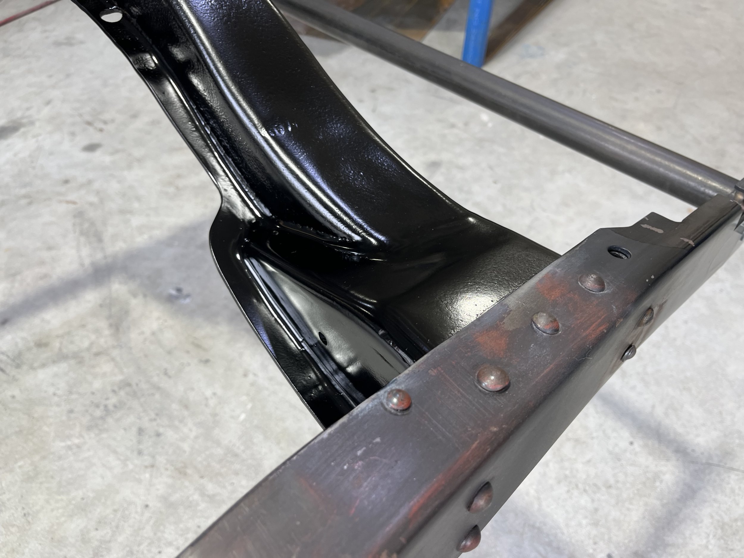

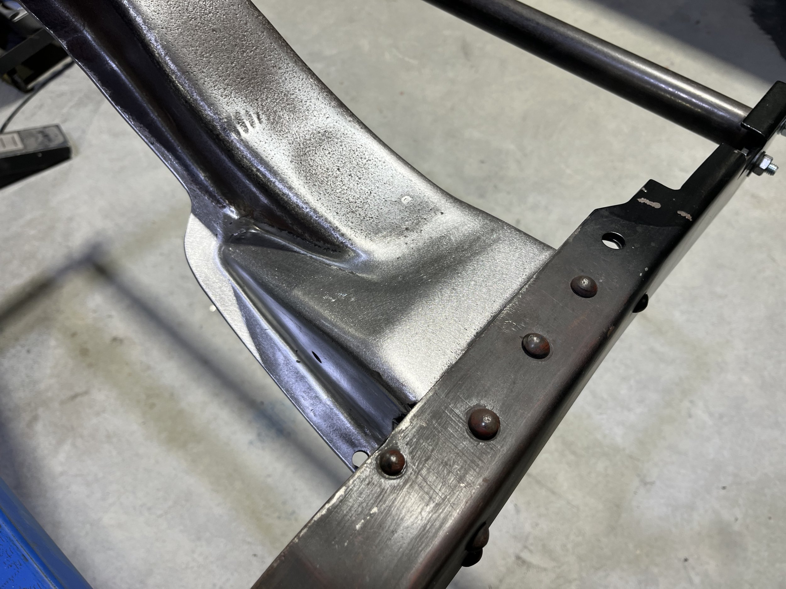

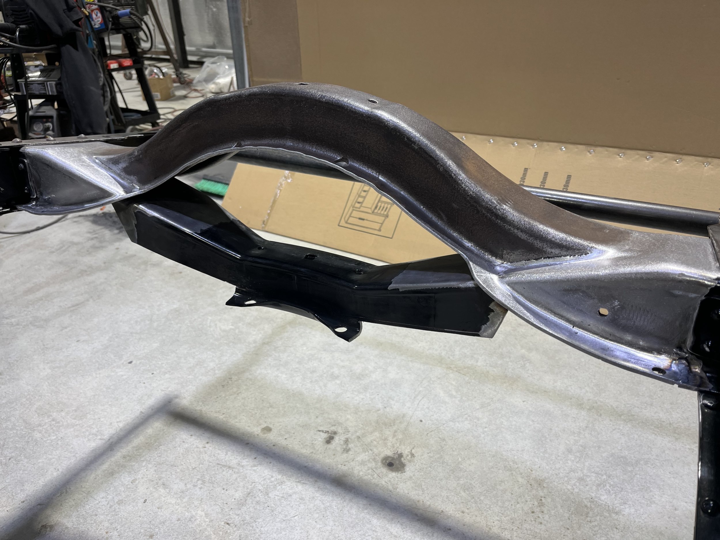

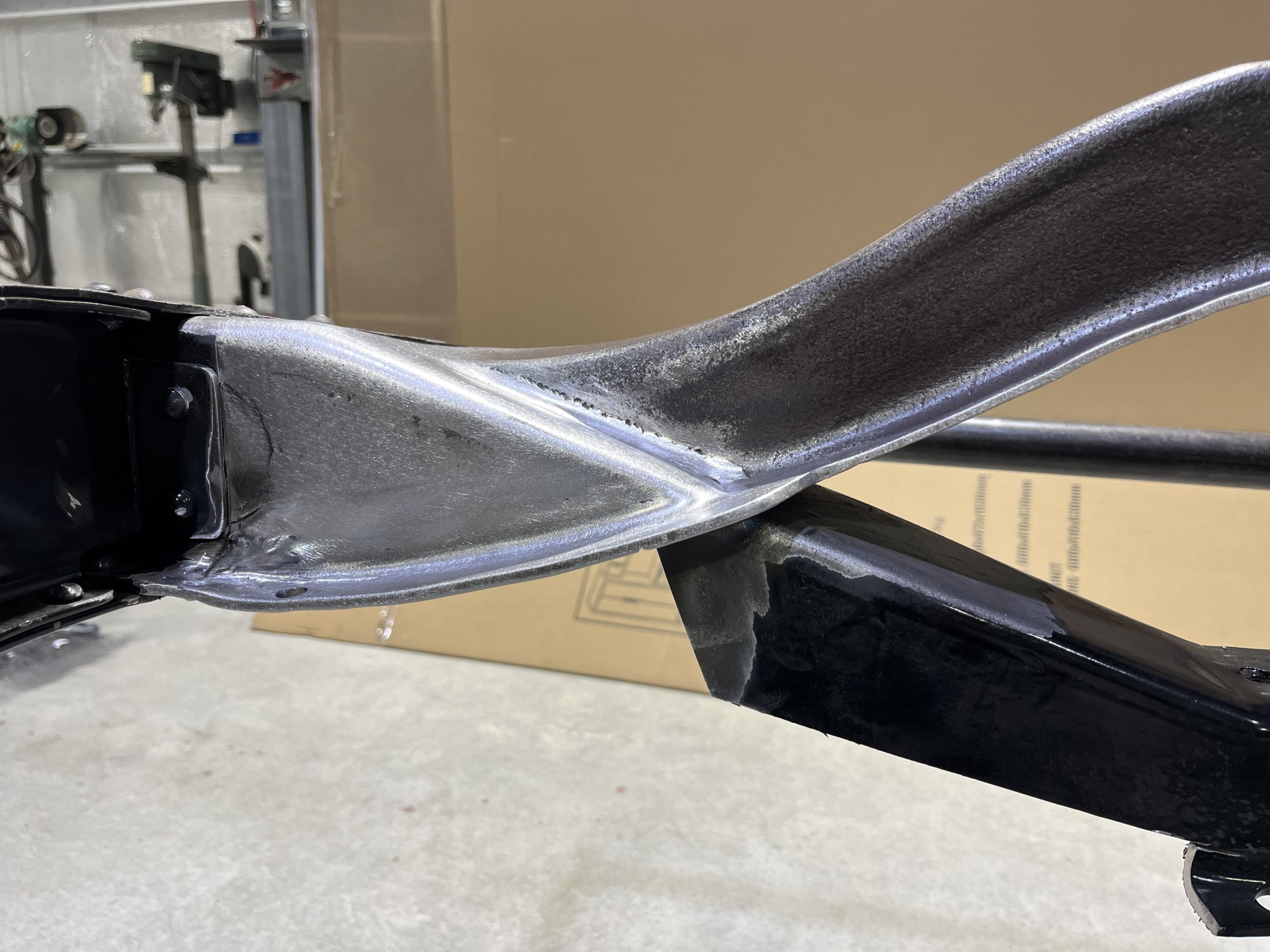

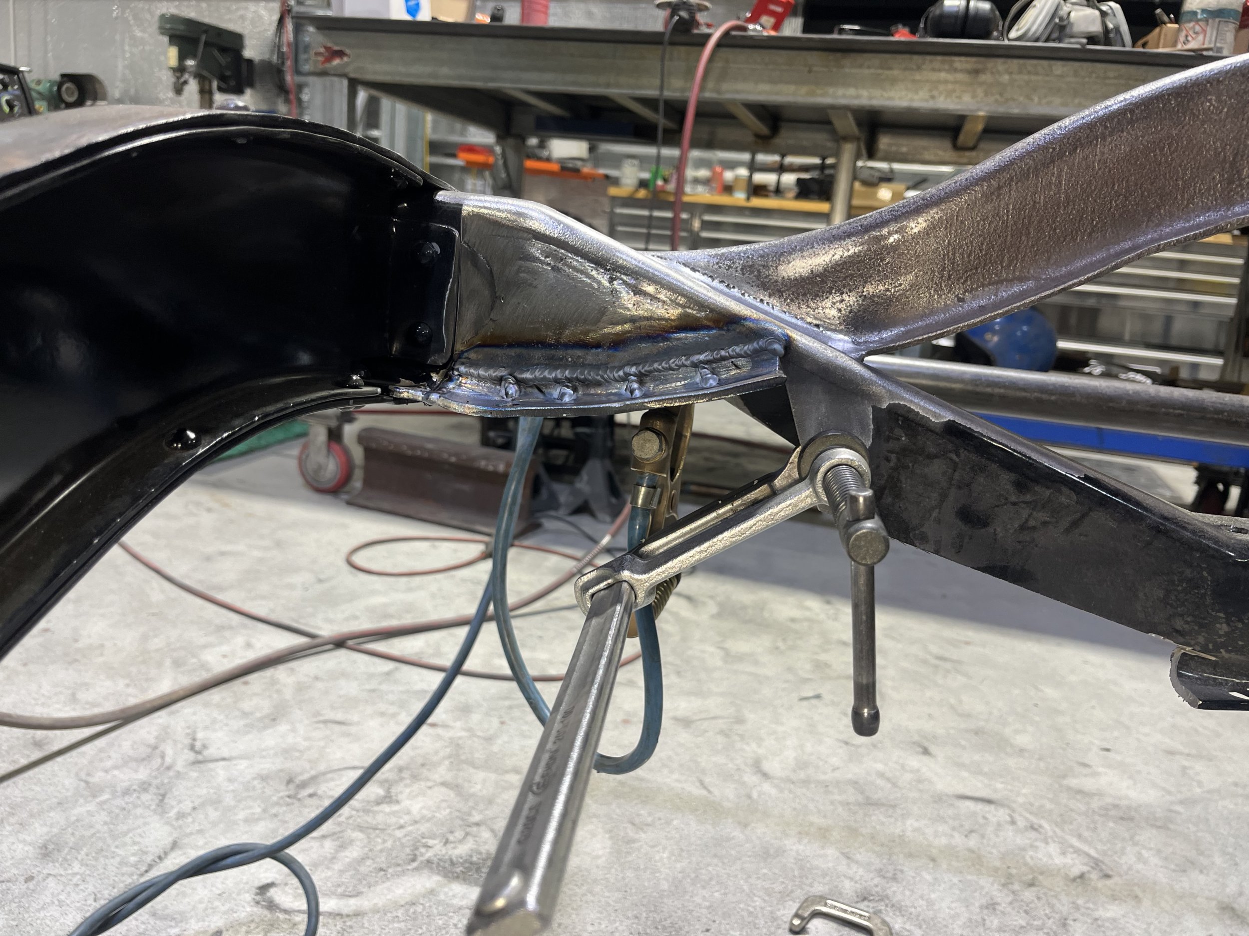

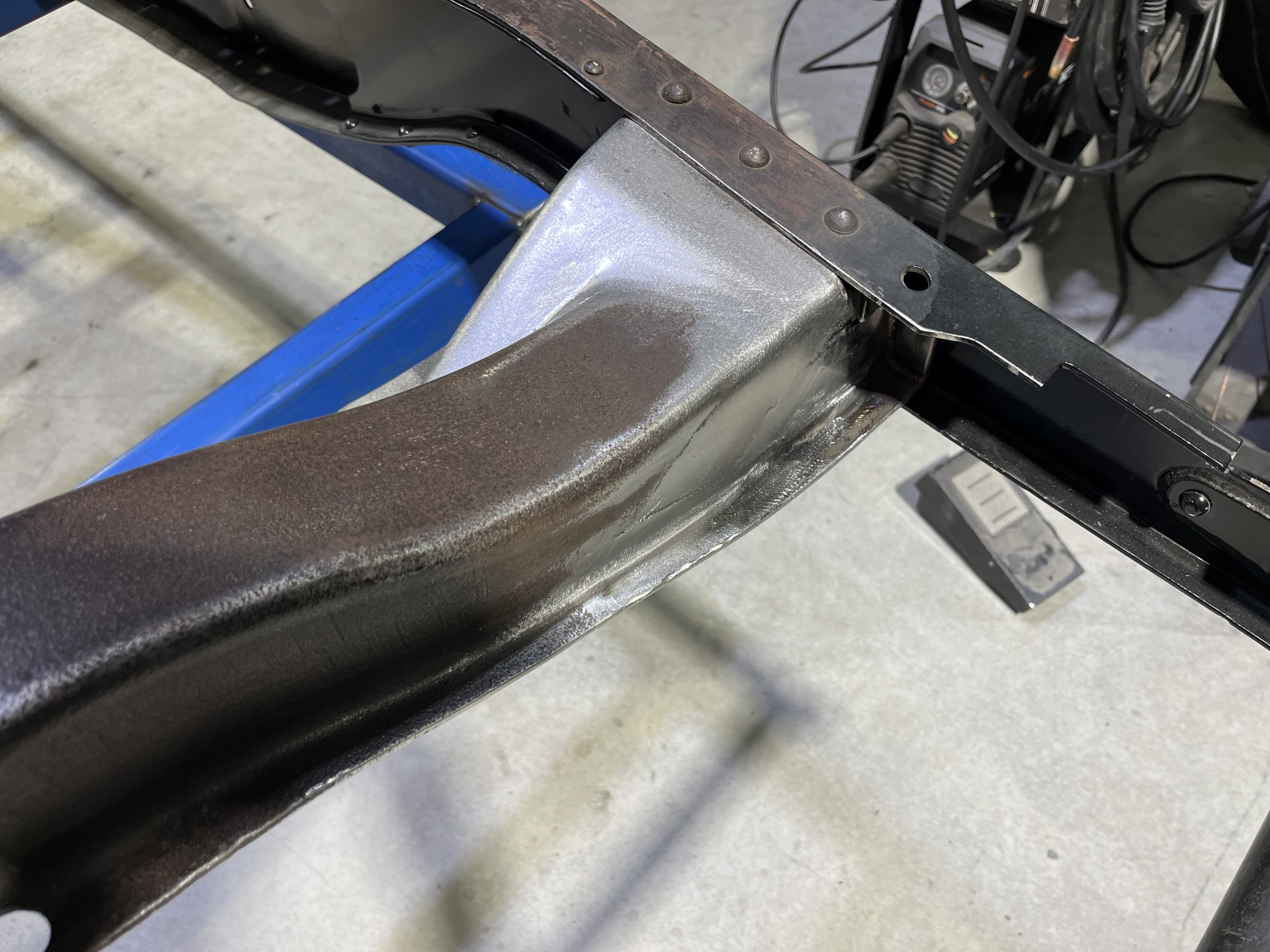

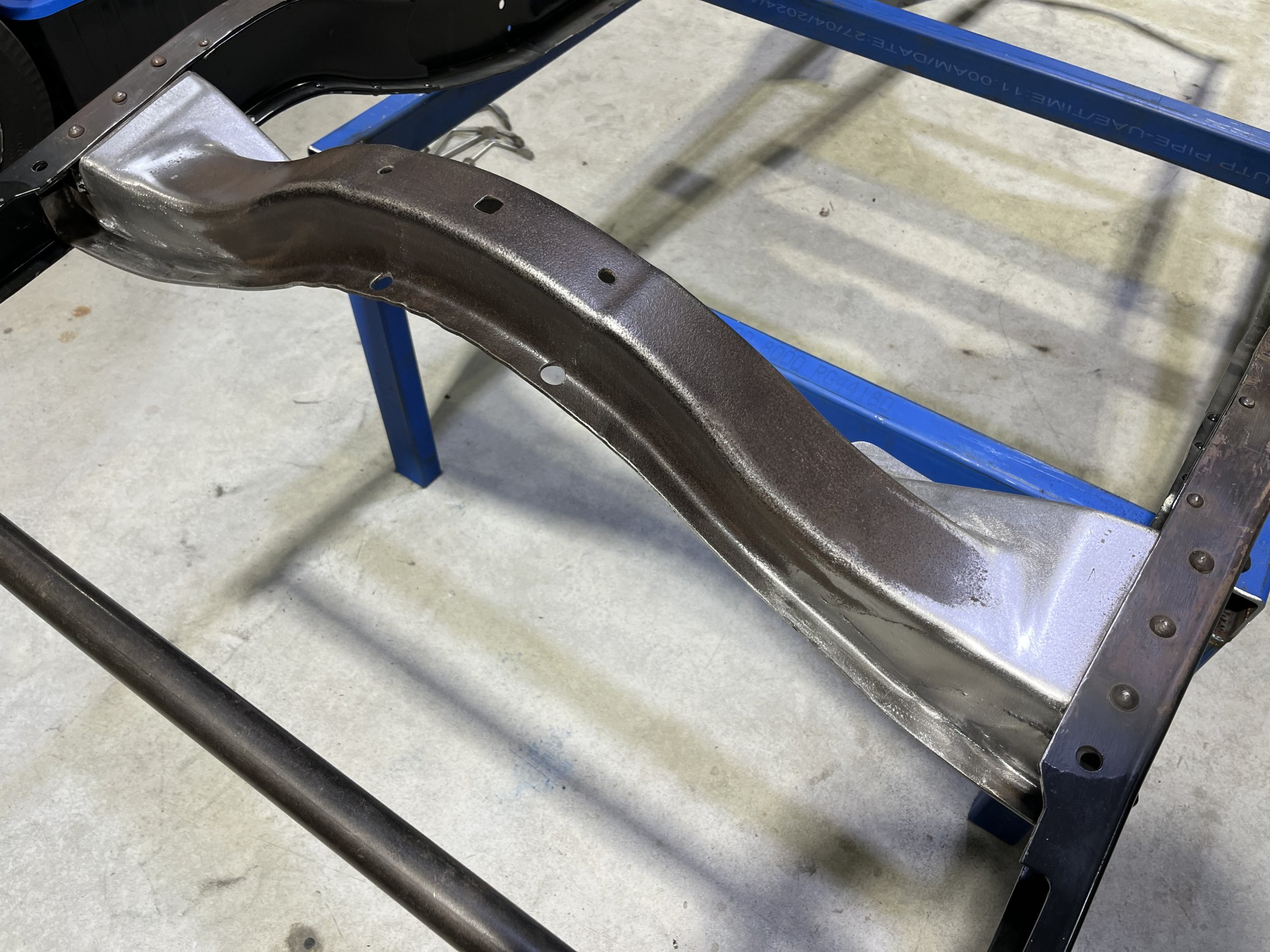

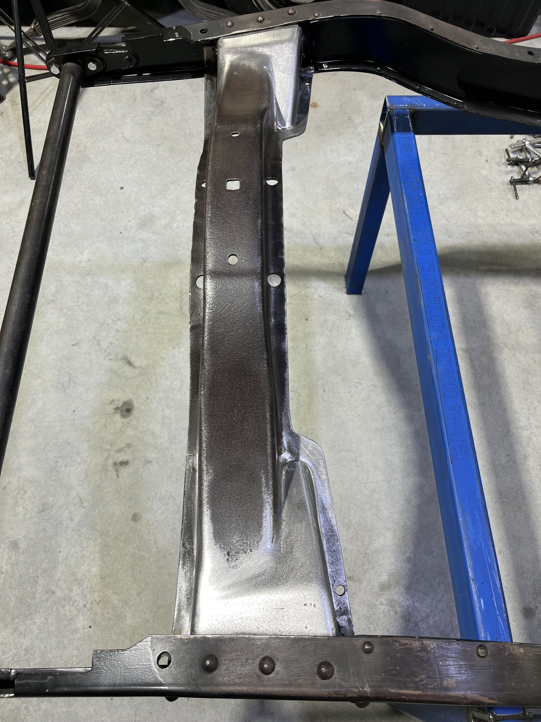

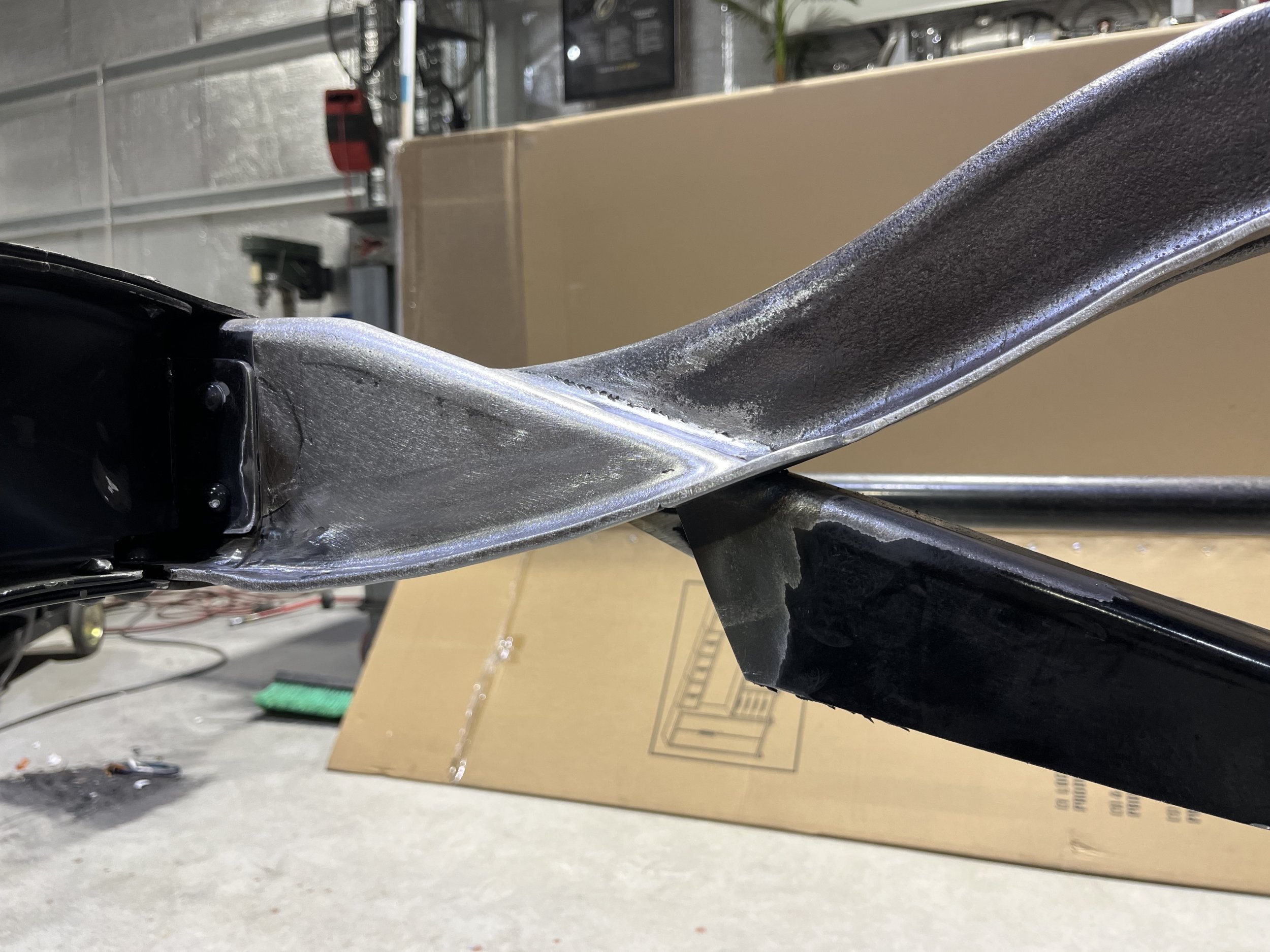

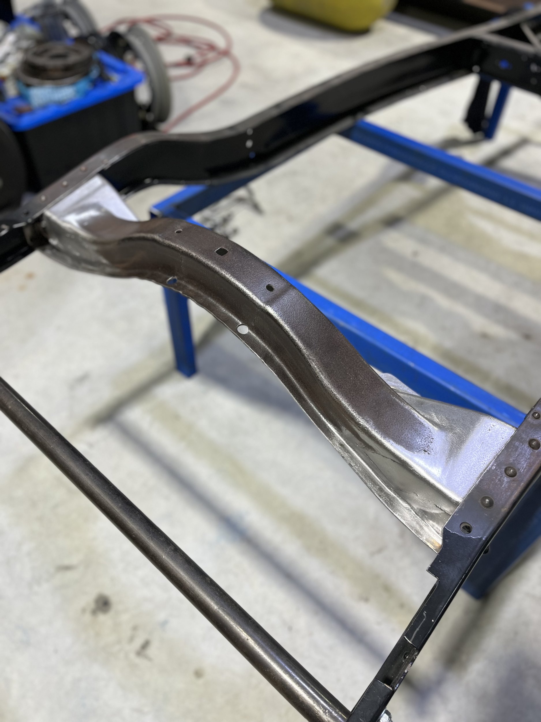

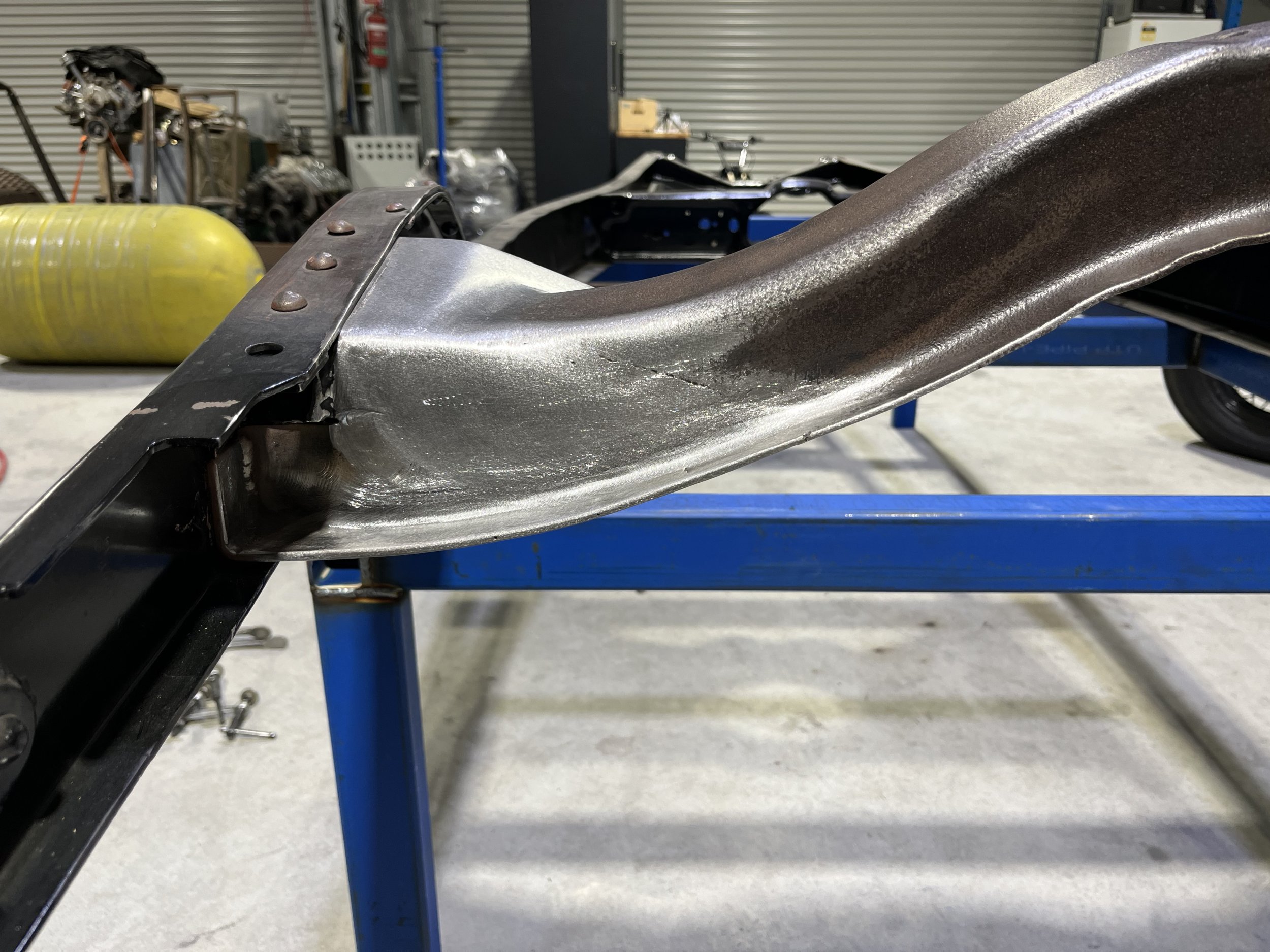

  12. Put a few hours into the rear cross member- definitely a lot of work! Would have been easier to remove the whole thing and fix in a complete model a crossmember. Happy with the result though- some t******* underneath and some hot rivets and I’ll call it done. I plan on painting the inside the the frame rails and crossmembers again.
    Will prep and primer wheels and get those done in gloss black in order to get the tires fitted! Another step closer to getting this rolling!

    I know it's something that will rarely (ever?) get seen after the body goes on, but I LOVE how you molded the Model A to the 32 crossmember. Flows nicely and just gives a different feel.

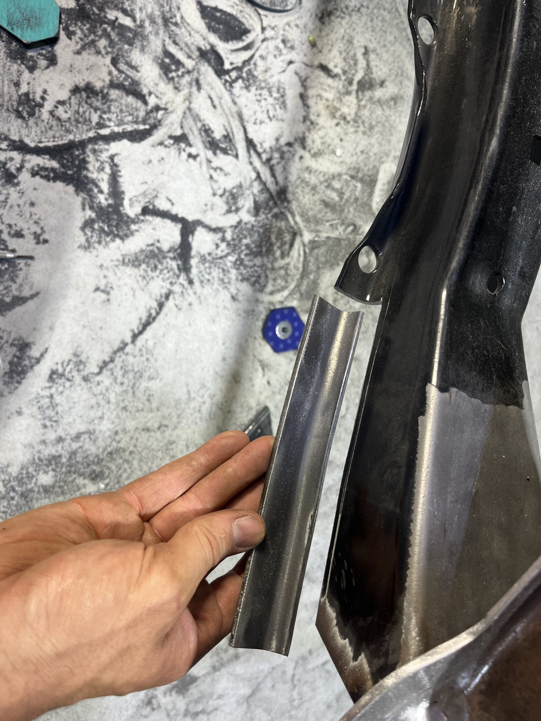

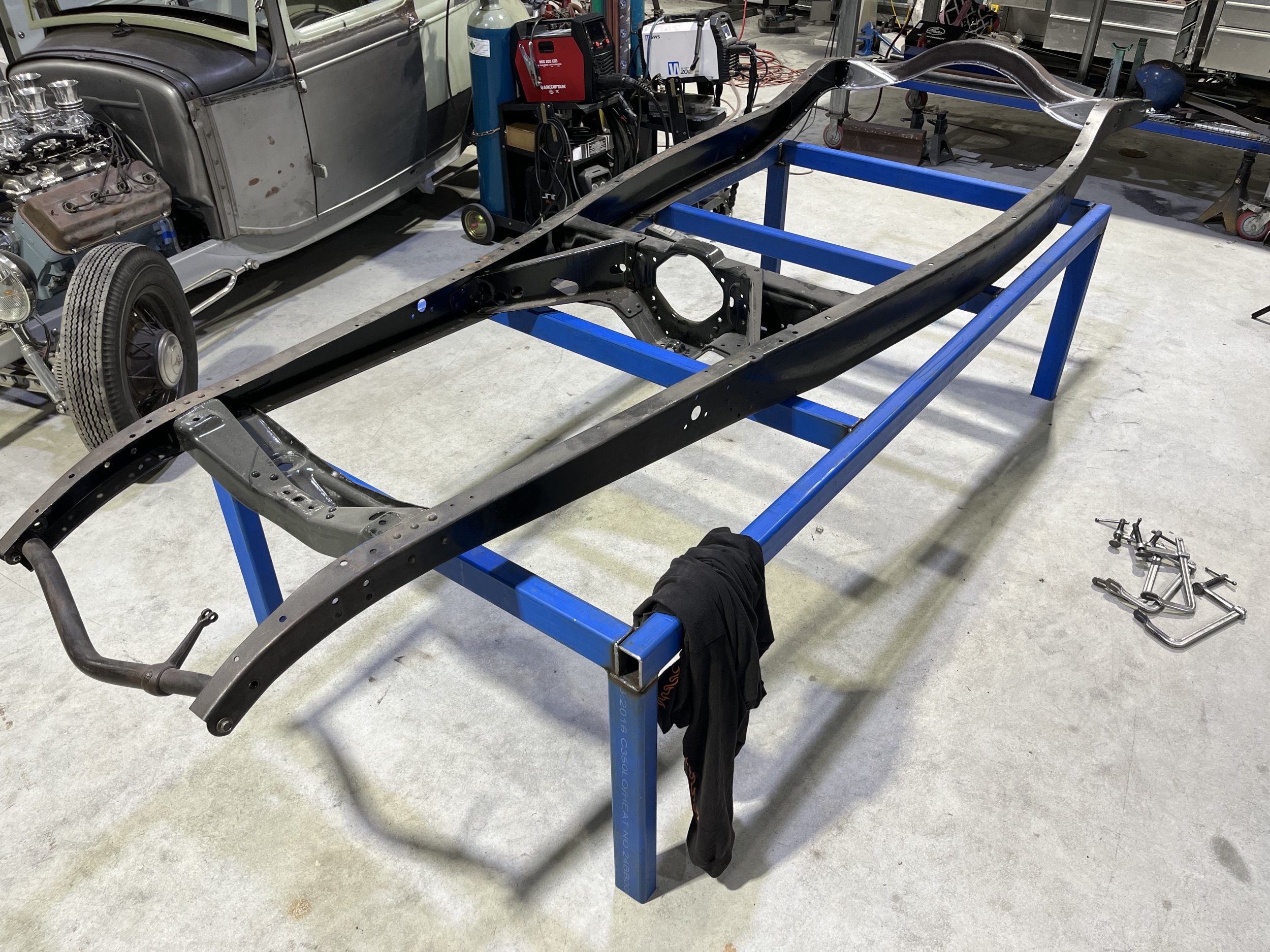

  17. Frames flipped over, sections of the old 32 crossmember are removed and will finalize the welding and blending. Got excited to see what the Model T spring sat like.. might be a bit too low!

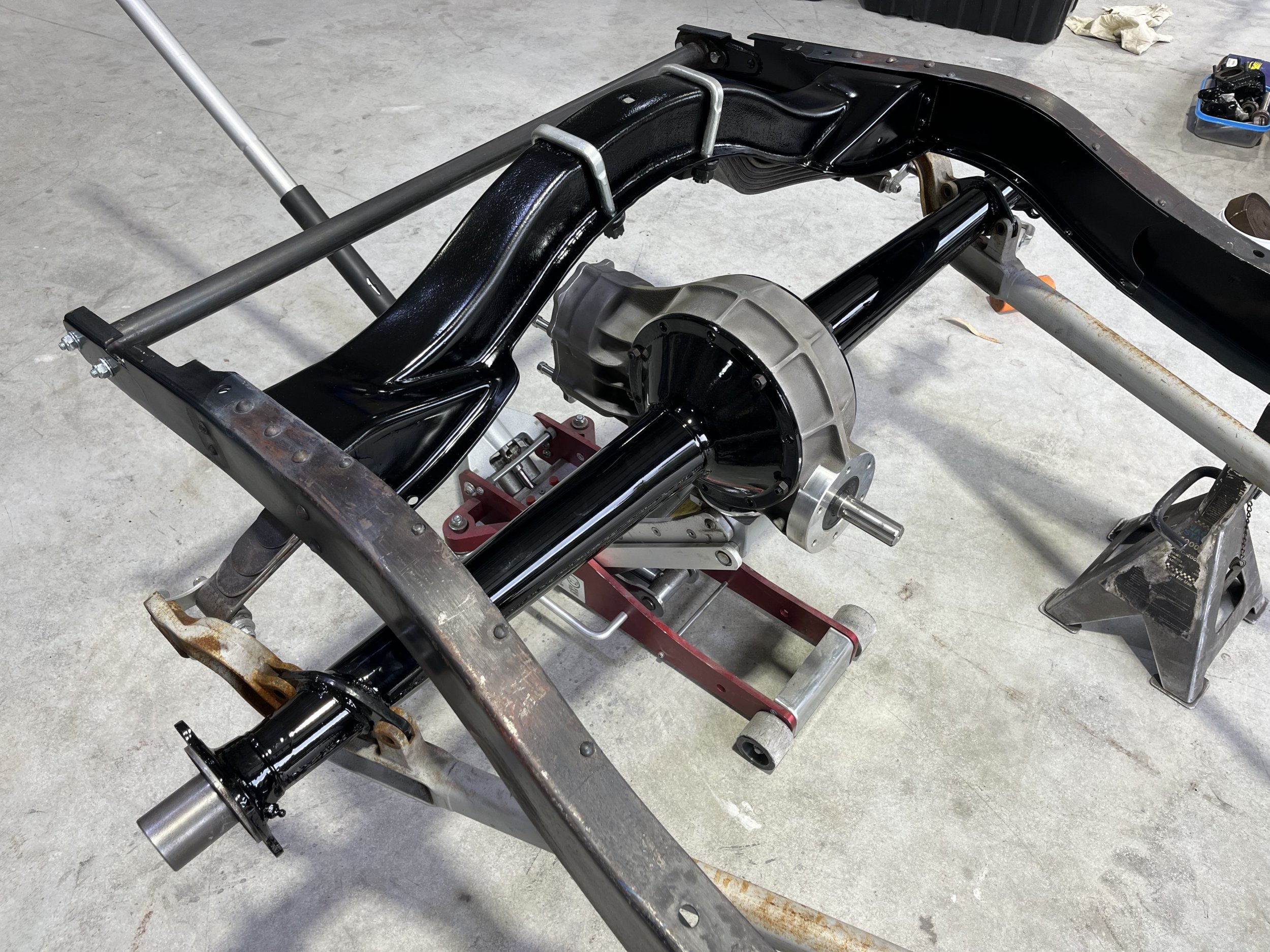

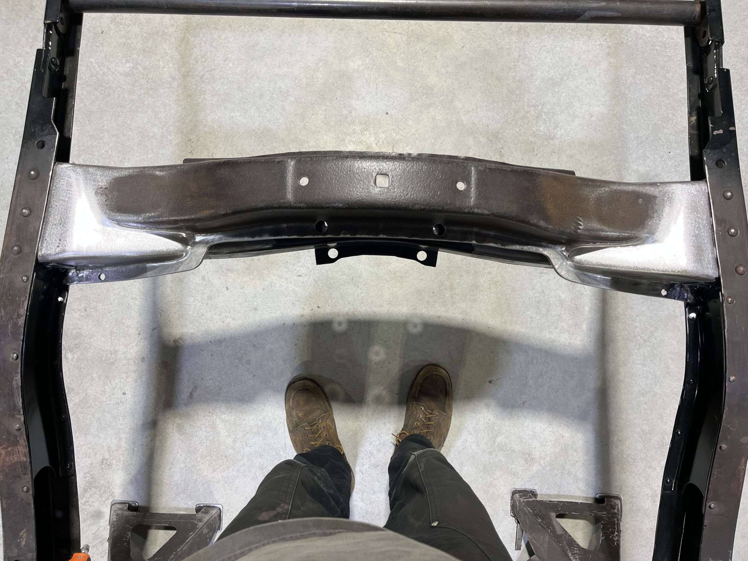

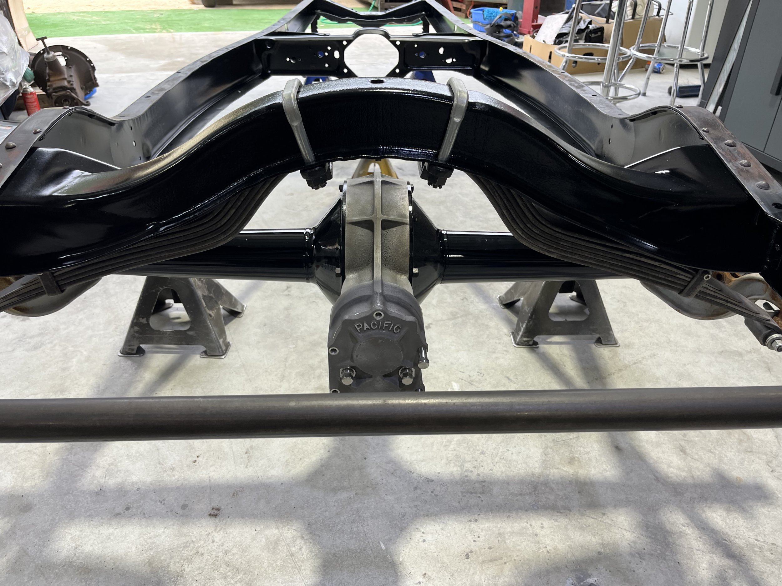

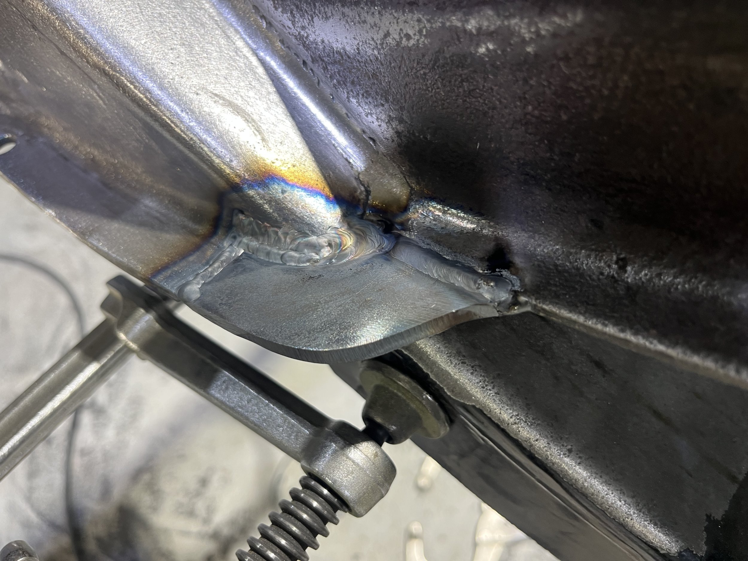

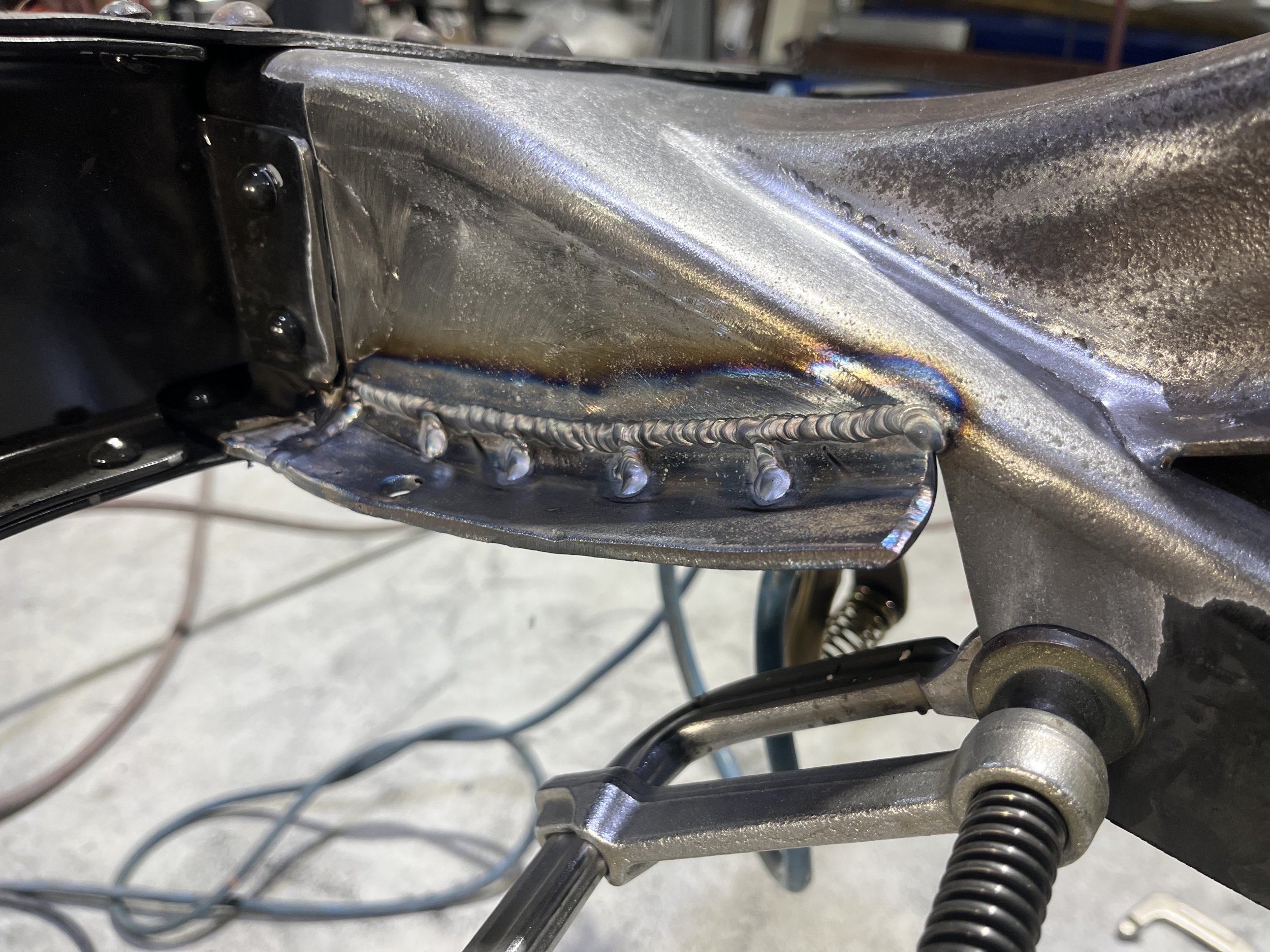

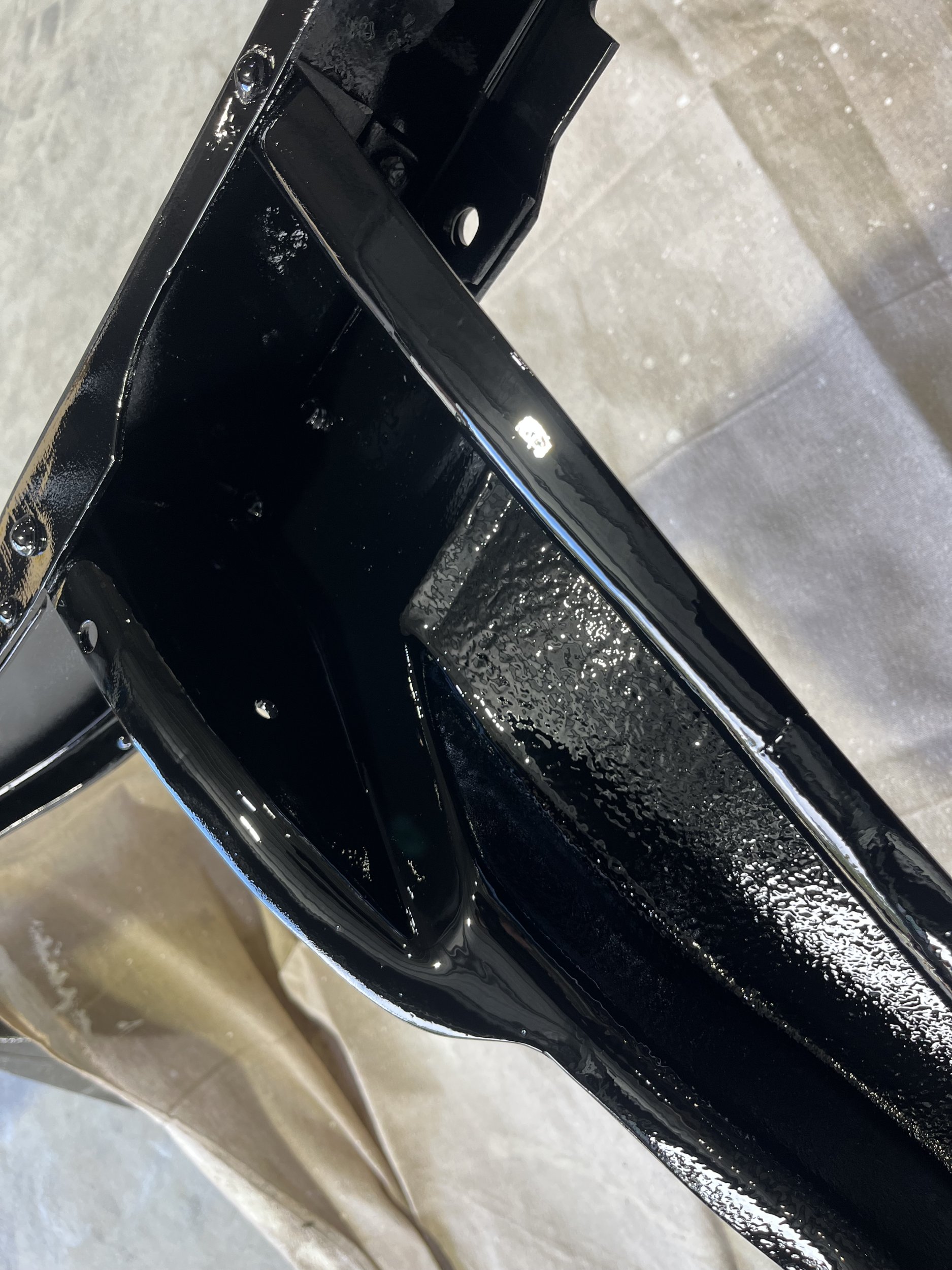

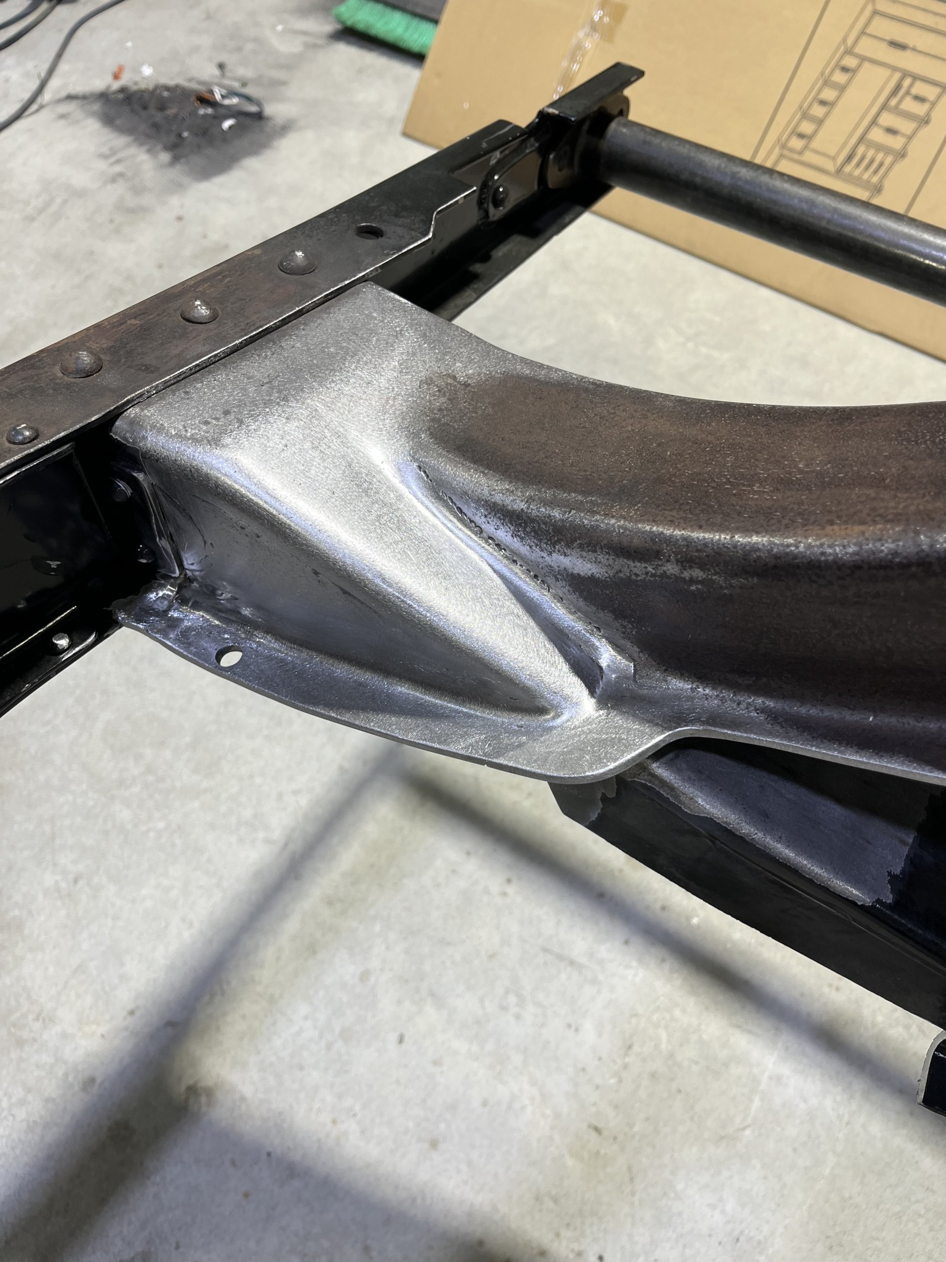

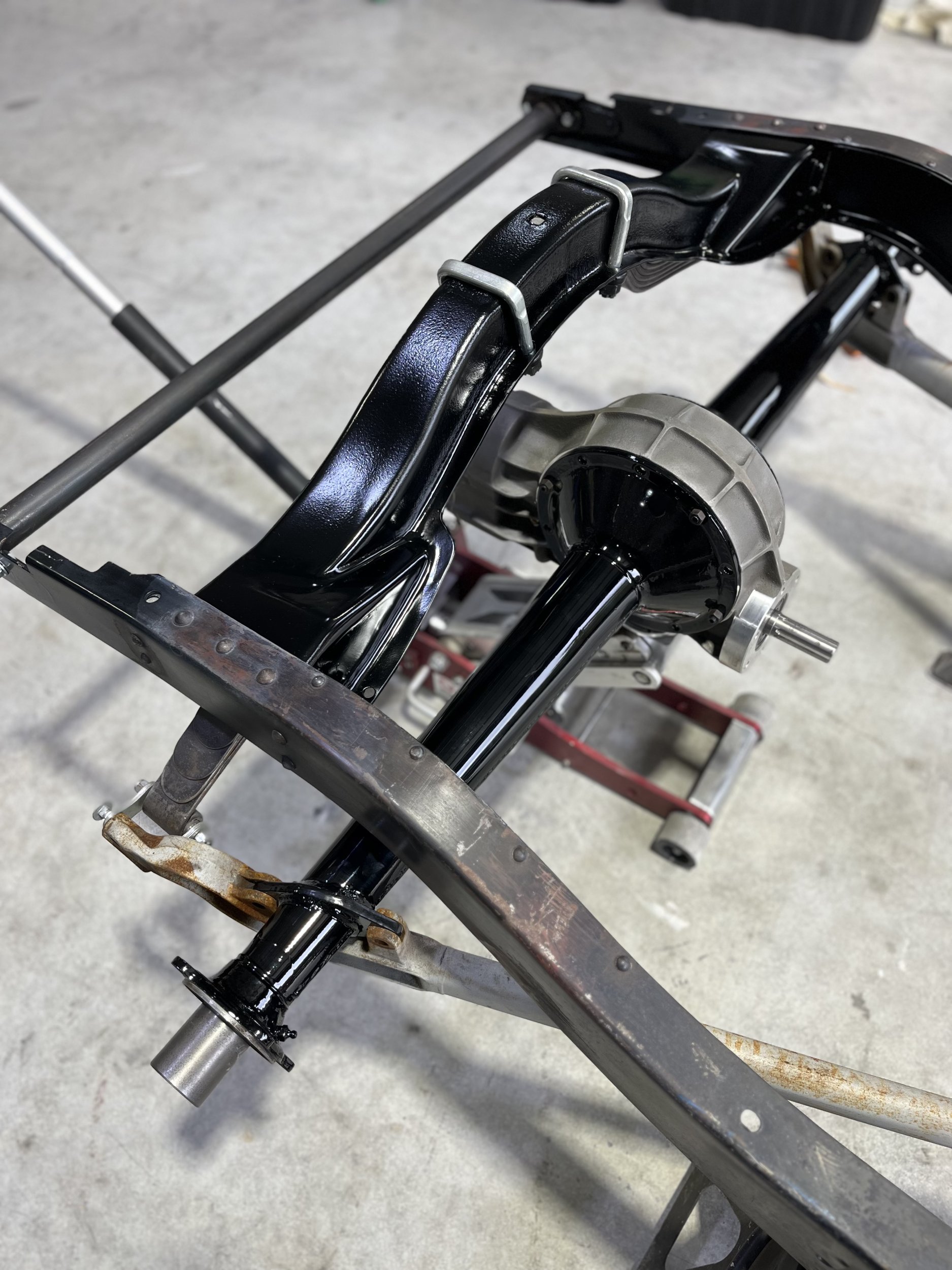

  20. Rear crossmember is officially finished.
    Welded inside and out, blended, hot riveted, primed and painted.
    I then loosely mocked up the rear axle using the QC and ‘36 radious rods. Little worried about the model T spring but can run a Model A spring if needed. Excited to get the rear axle built in order to get it all bolted up for the last time.
    Also might need to run different shackles as when the u bolt plates are right side up they does catch the threads IMG_5672.jpeg IMG_5689.jpeg IMG_5693.jpeg IMG_5688.jpeg IMG_5685.jpeg IMG_5686.jpeg IMG_5698.jpeg IMG_5699.jpeg IMG_5716.jpeg IMG_5715.jpeg IMG_5714.jpeg IMG_5712.jpeg IMG_5720.jpeg IMG_5722.jpeg IMG_5723.jpeg IMG_5725.jpeg IMG_5728.jpeg IMG_5727.jpeg IMG_5727.jpeg

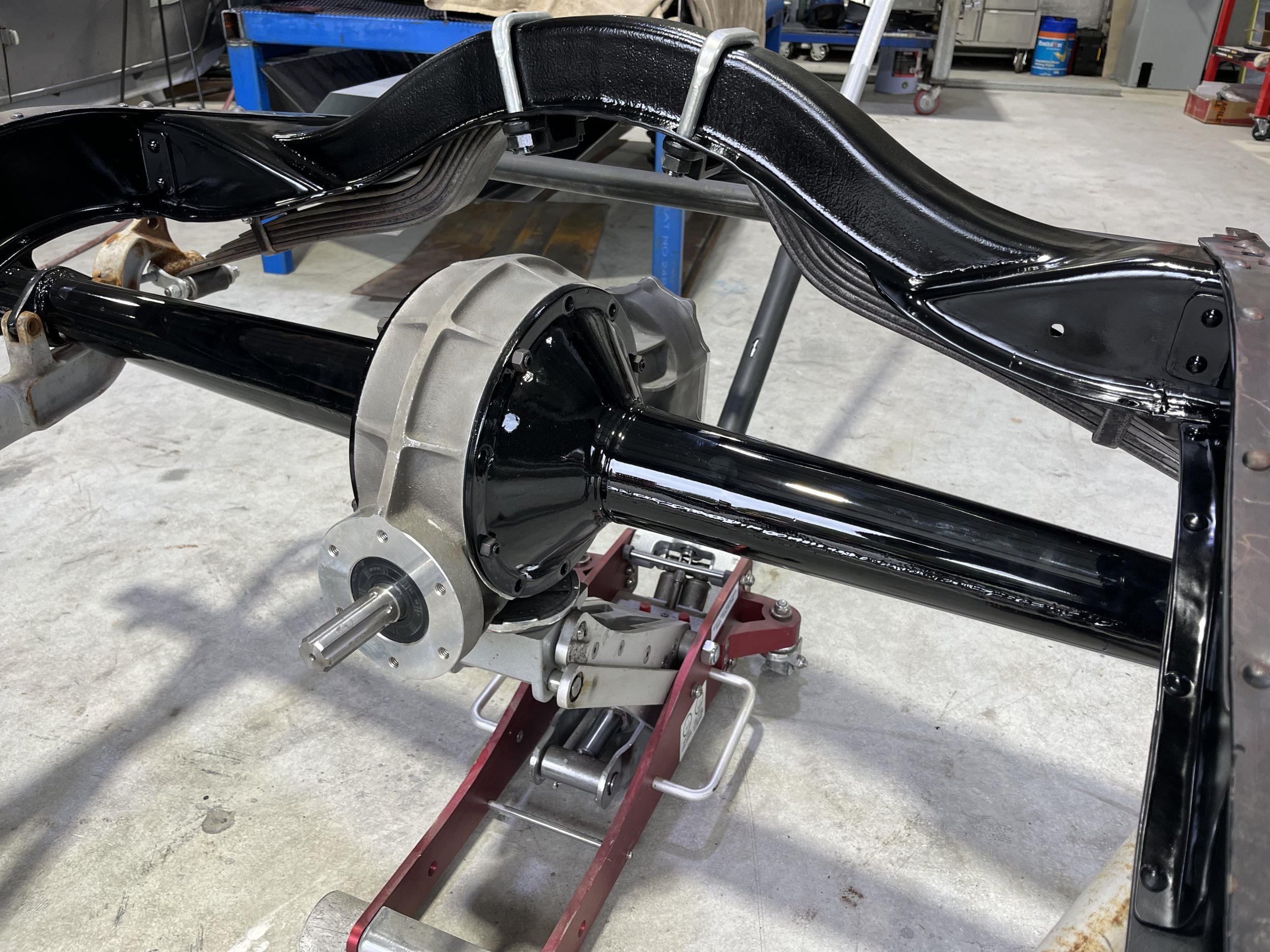

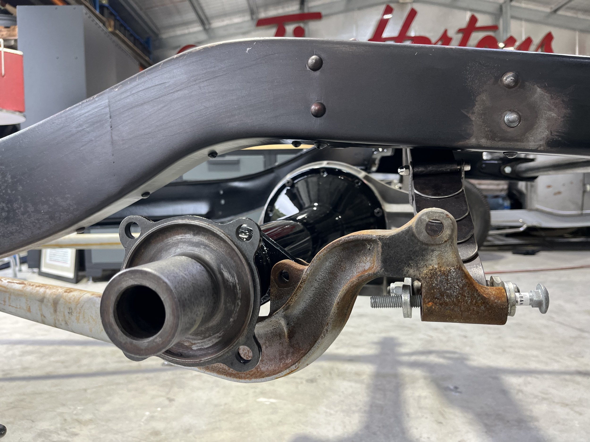

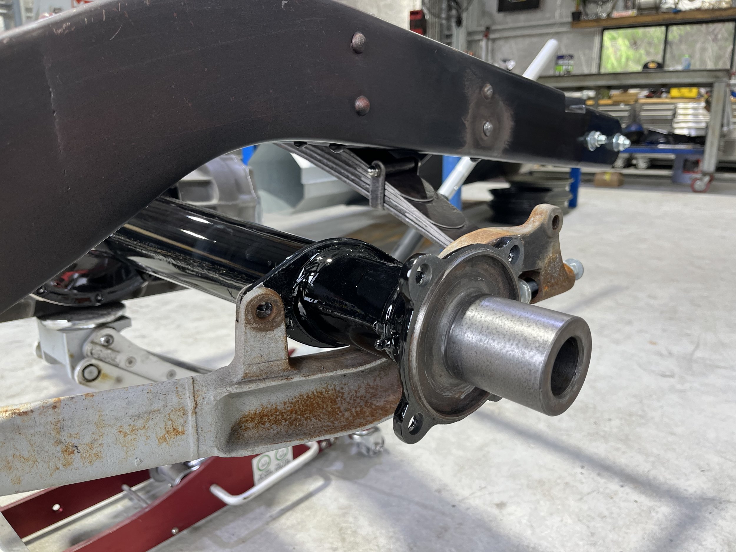

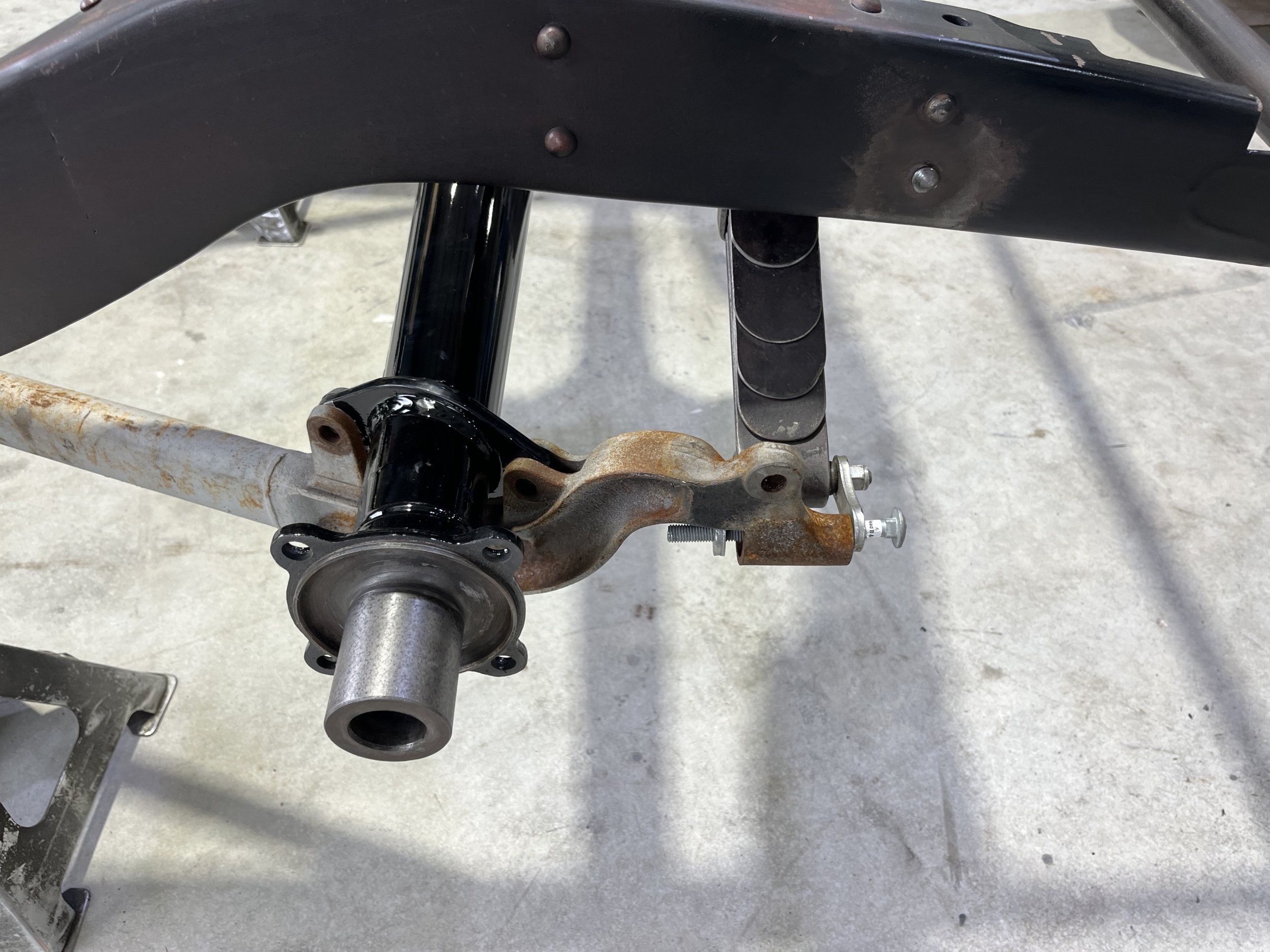

  22. Due to the drive shaft relocation nearly 3” lower than the factory ‘36 center I needed to head and bend the radious rods to fit properly.
    Also the distance of the pinion flange was a 1/4” shorter on the Quick Change so I needed to make a spacer plate.
    Where the leaf spring mounts was really worn so I popped some br*** inside and tig welded it back up and hit it with the scaler.
    Now to get this Rear end built and installed.

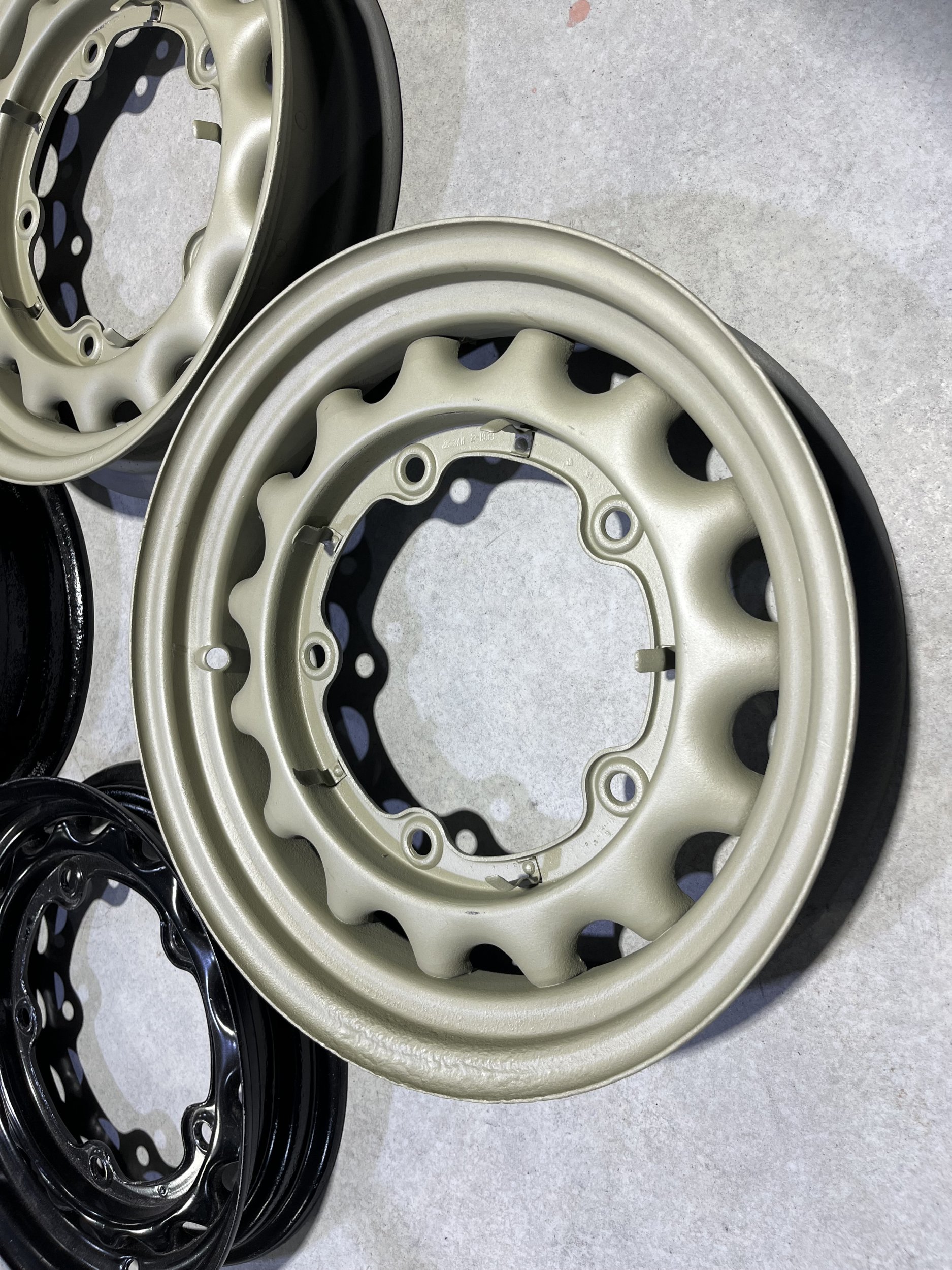

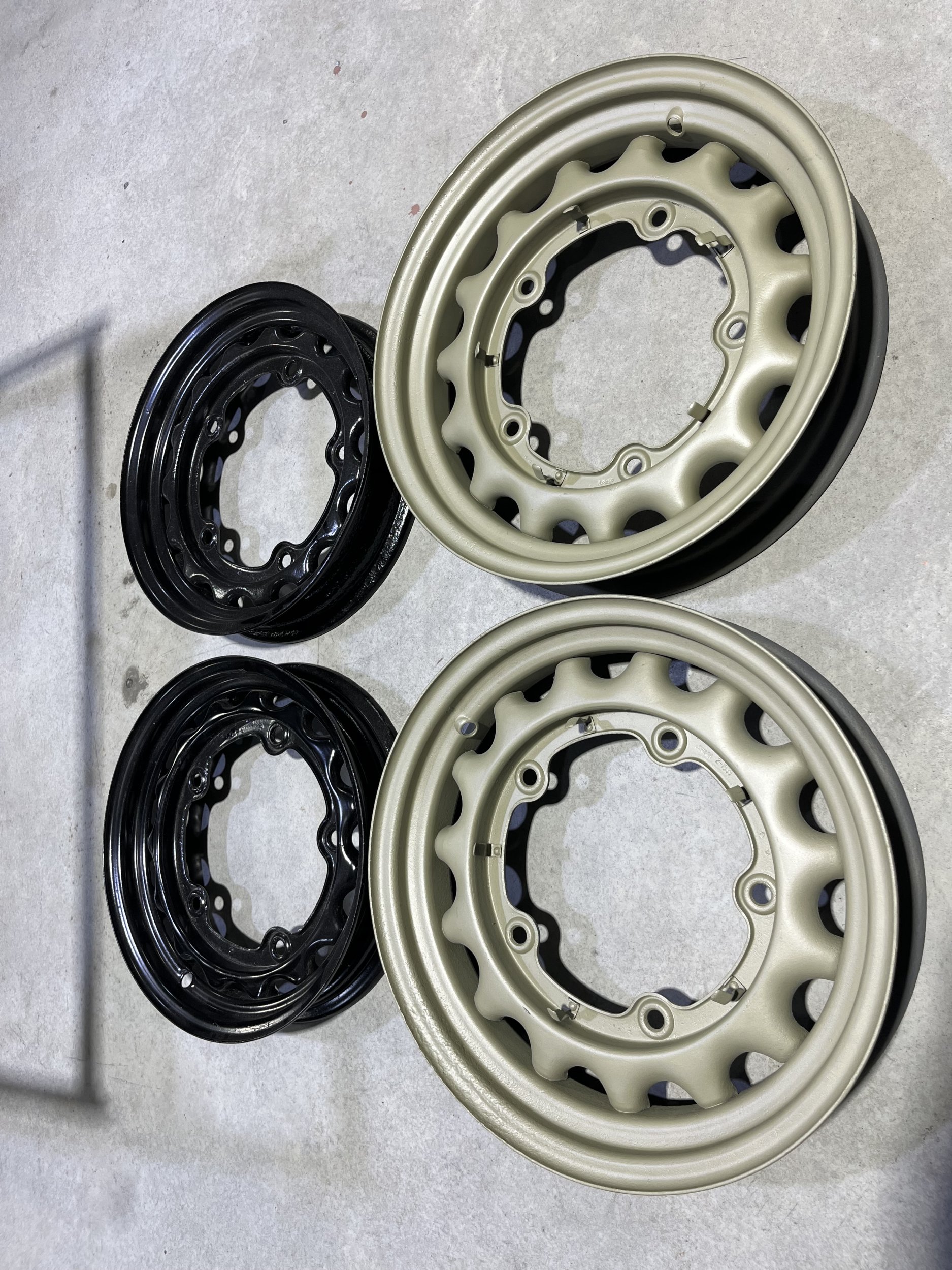

  24. While still awaiting the carrier bearings for the rear end to build I decided to clean up and paint the wheels. fronts are 16” narrow V860 rims and rear are 18” Kelsey Hayes. I didn’t high build or try and make them perfect. I bit of 2k gloss and some character is what I was after.
    Tires tomorrow!
