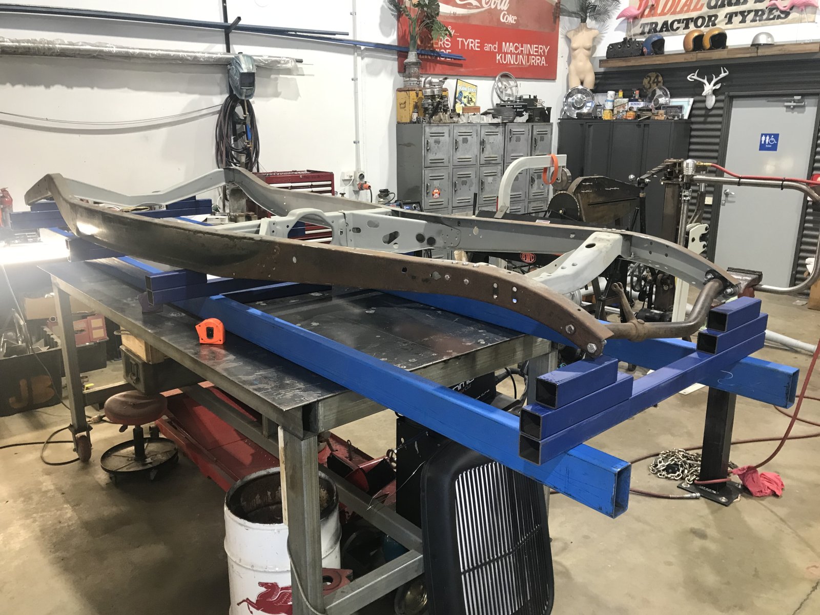

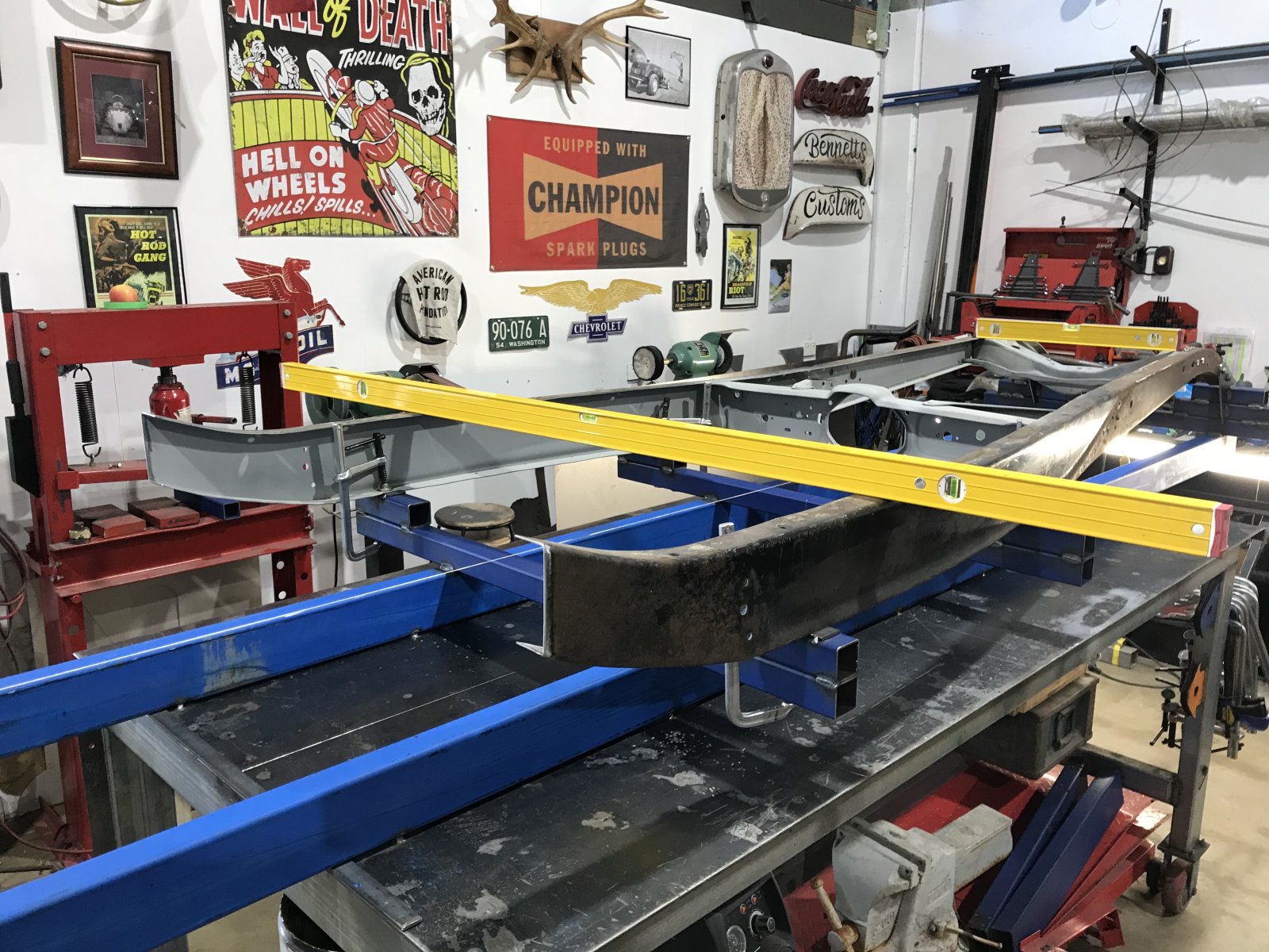

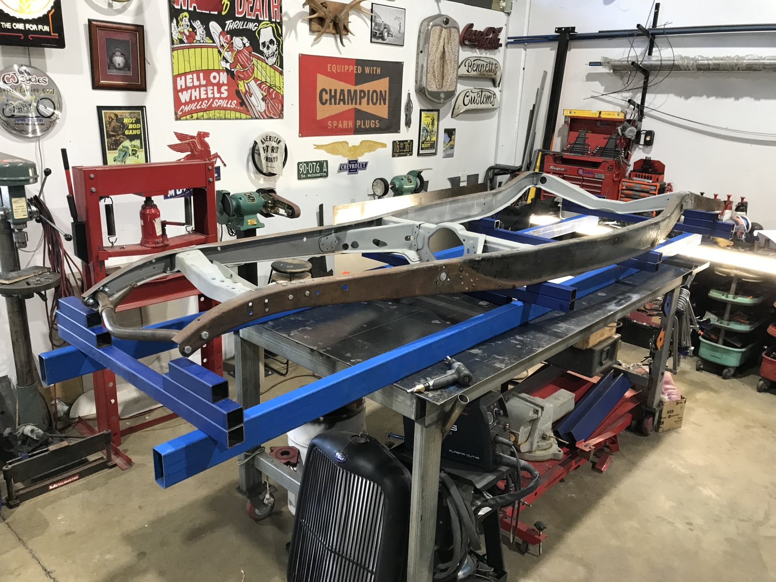

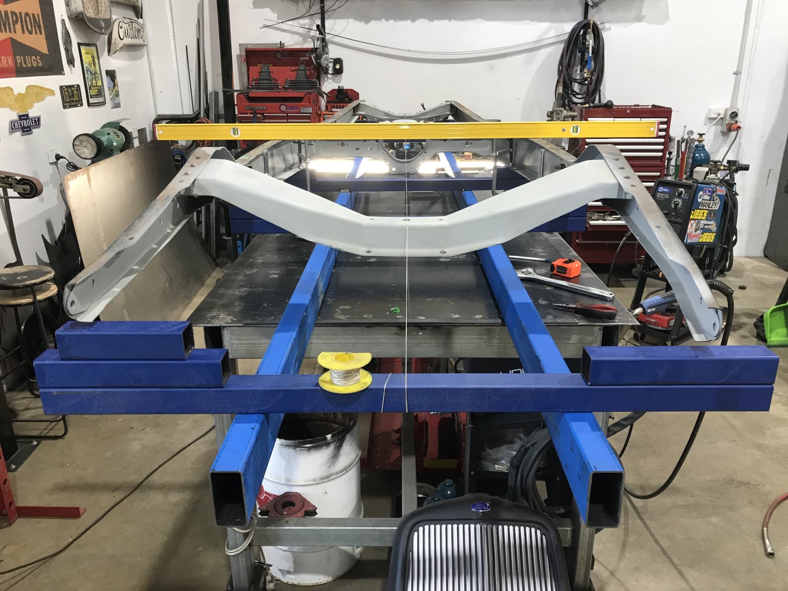

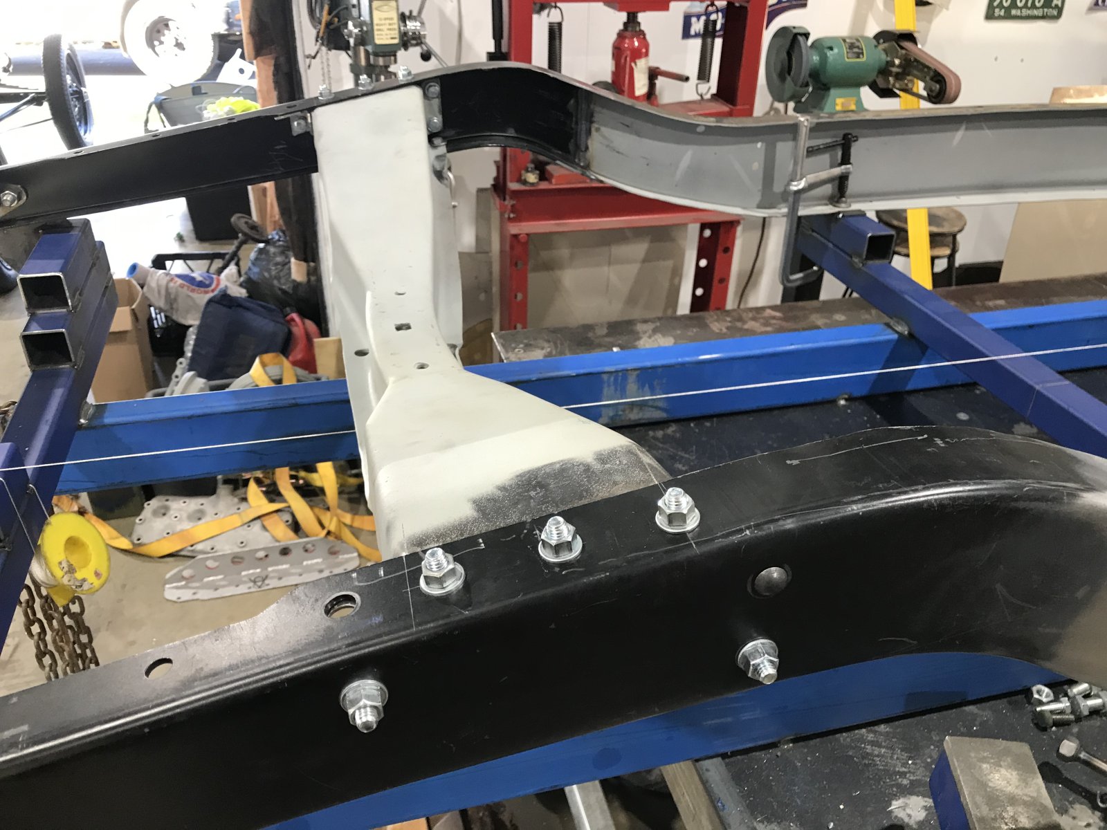

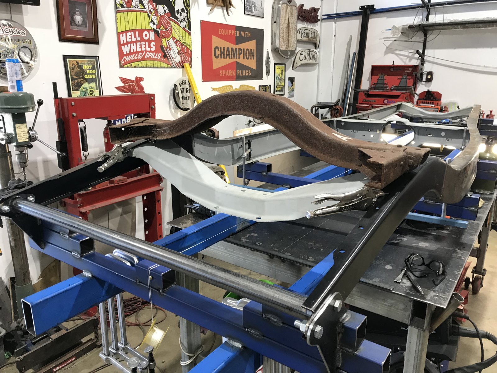

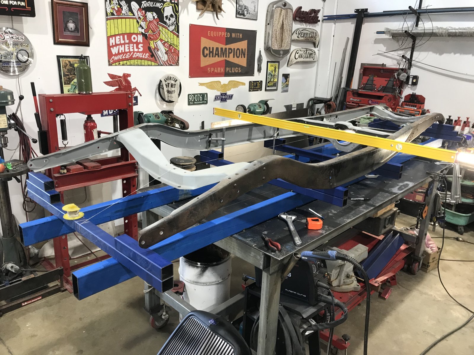

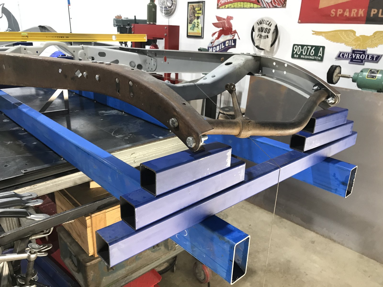

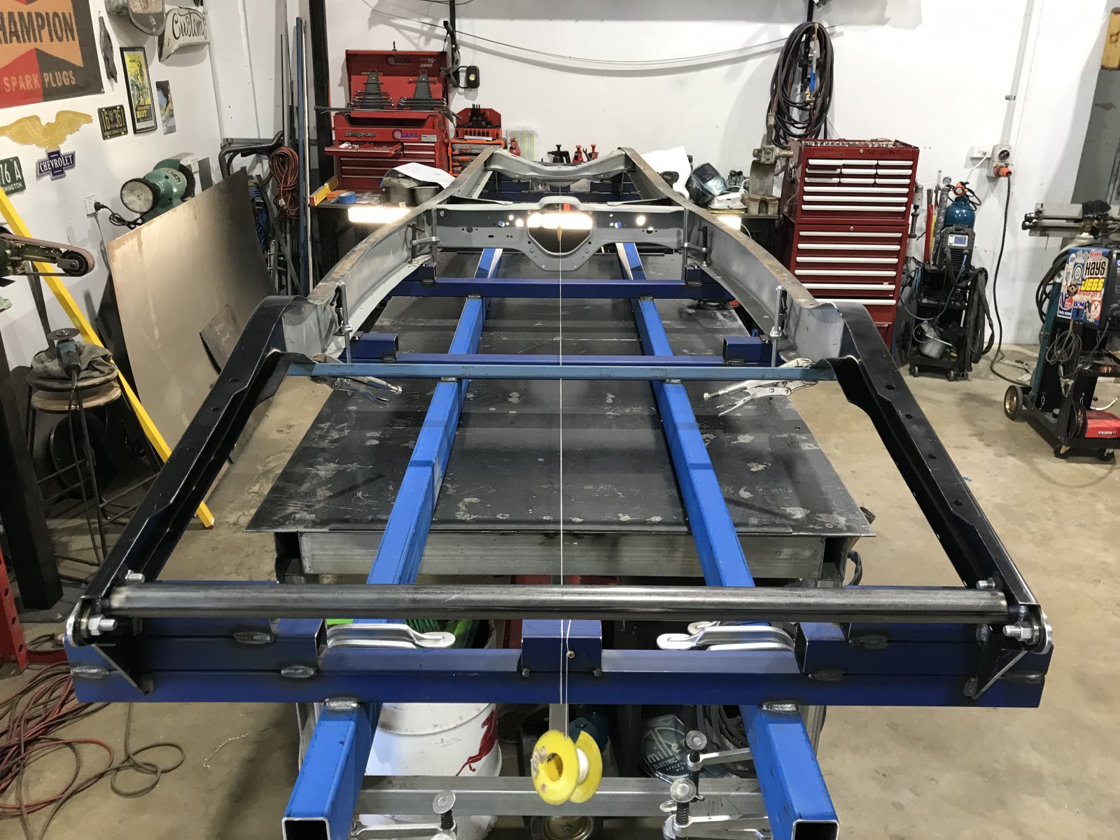

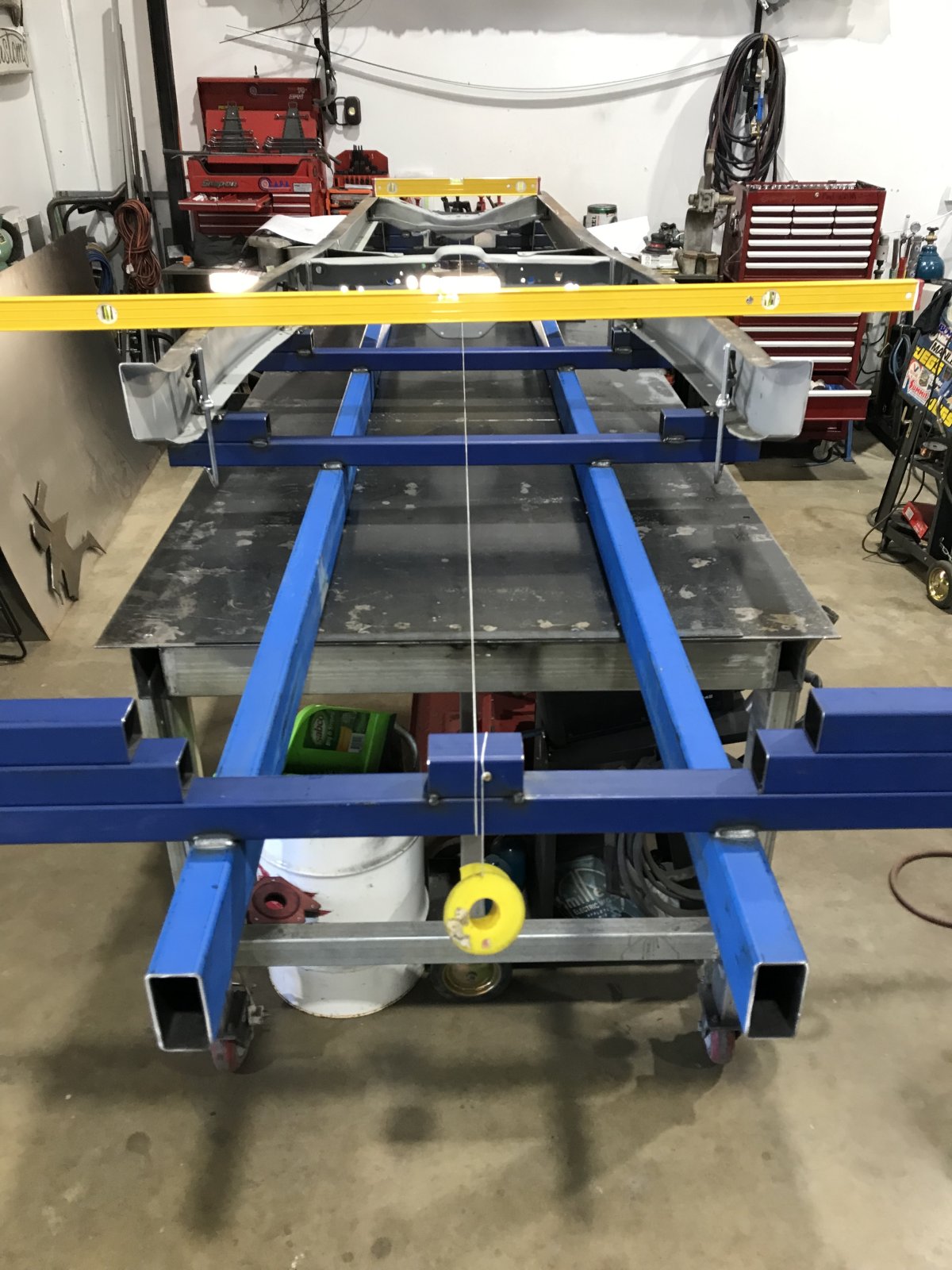

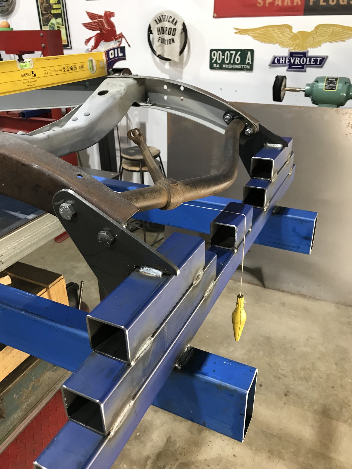

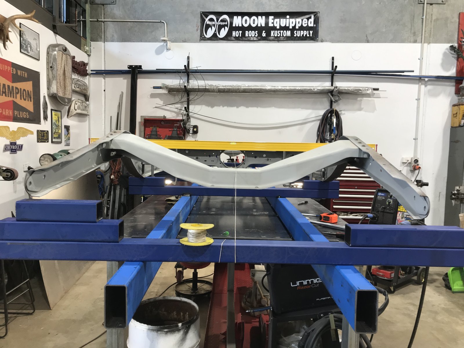

  5. Jig prep, simple but hope it works when finished. Time to get the frame repaired 14323F2A-2E2F-48DE-8E4F-F83B23C9D309.jpeg 2537B686-51F6-411F-80D9-AF006904270C.jpeg 8AF59E6A-BA21-49FB-BB54-071D57C6F1BD.jpeg

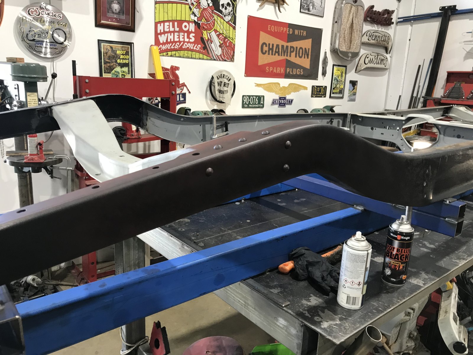

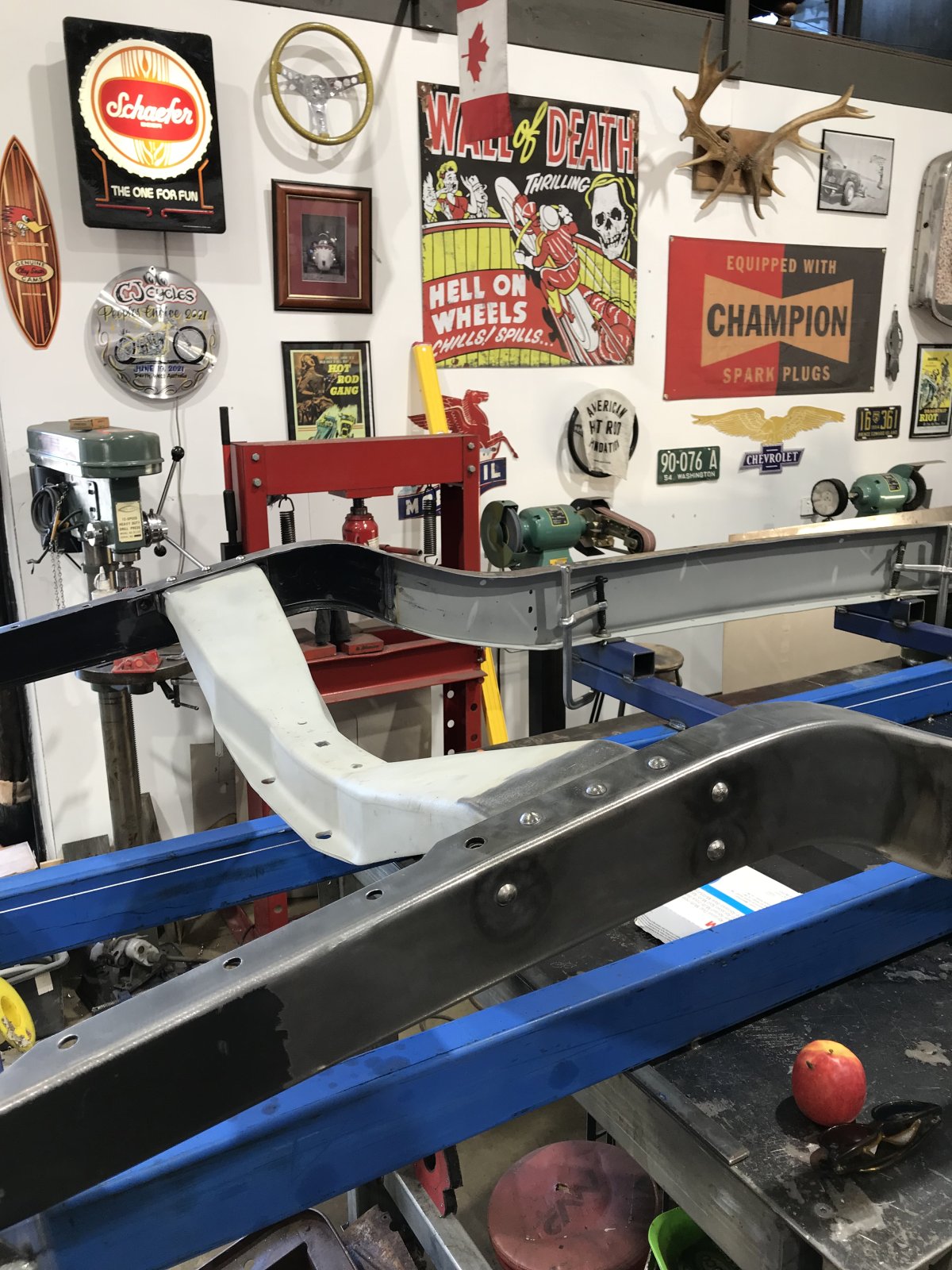

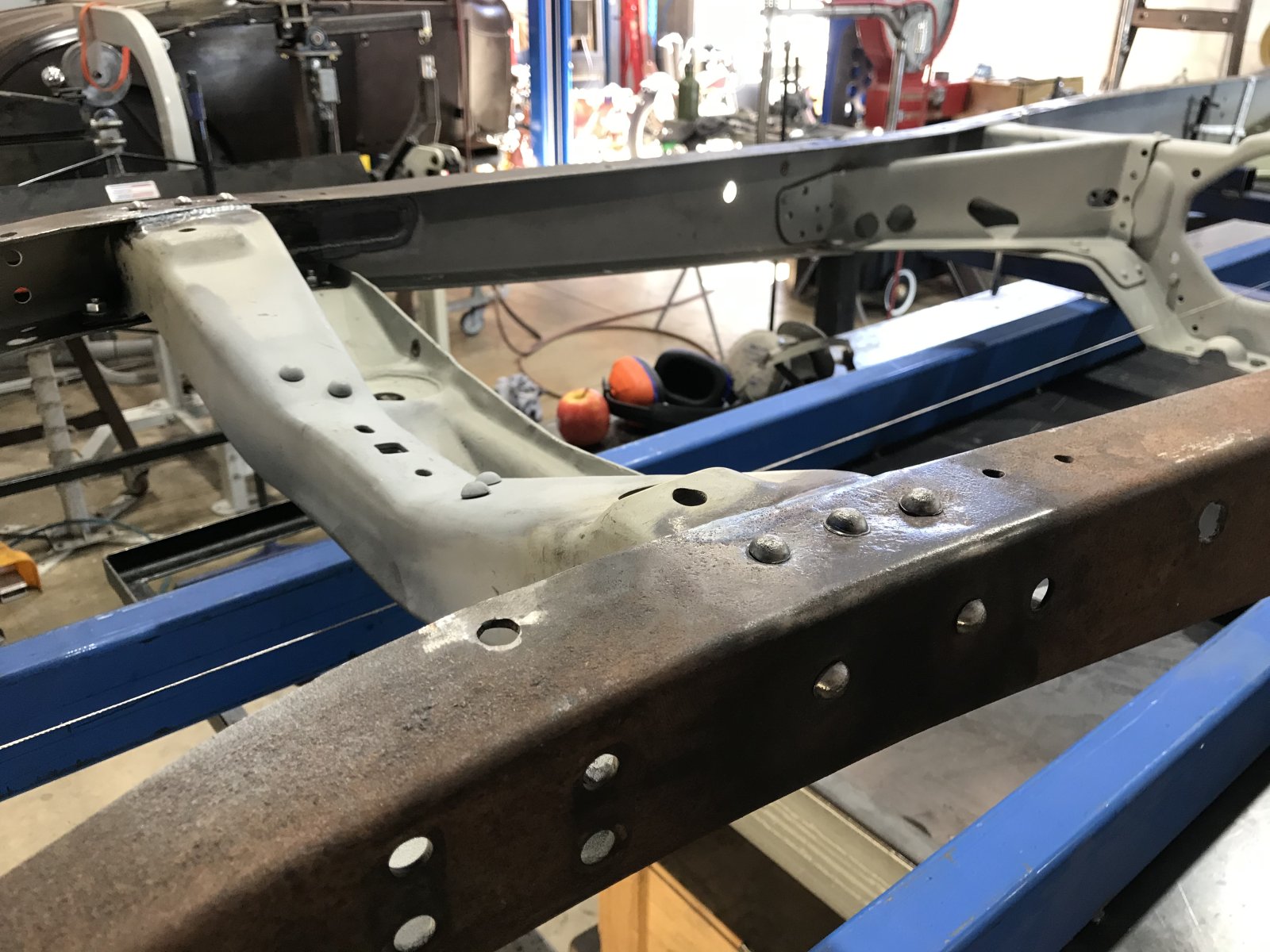

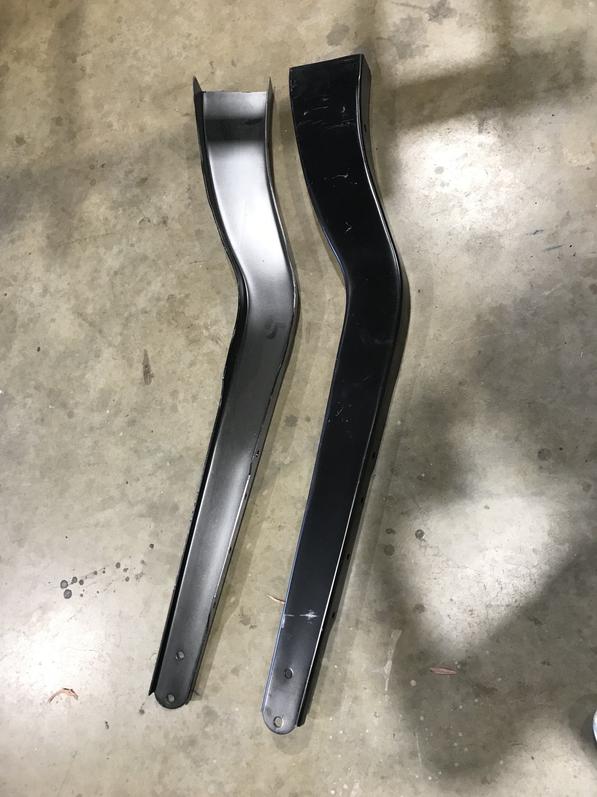

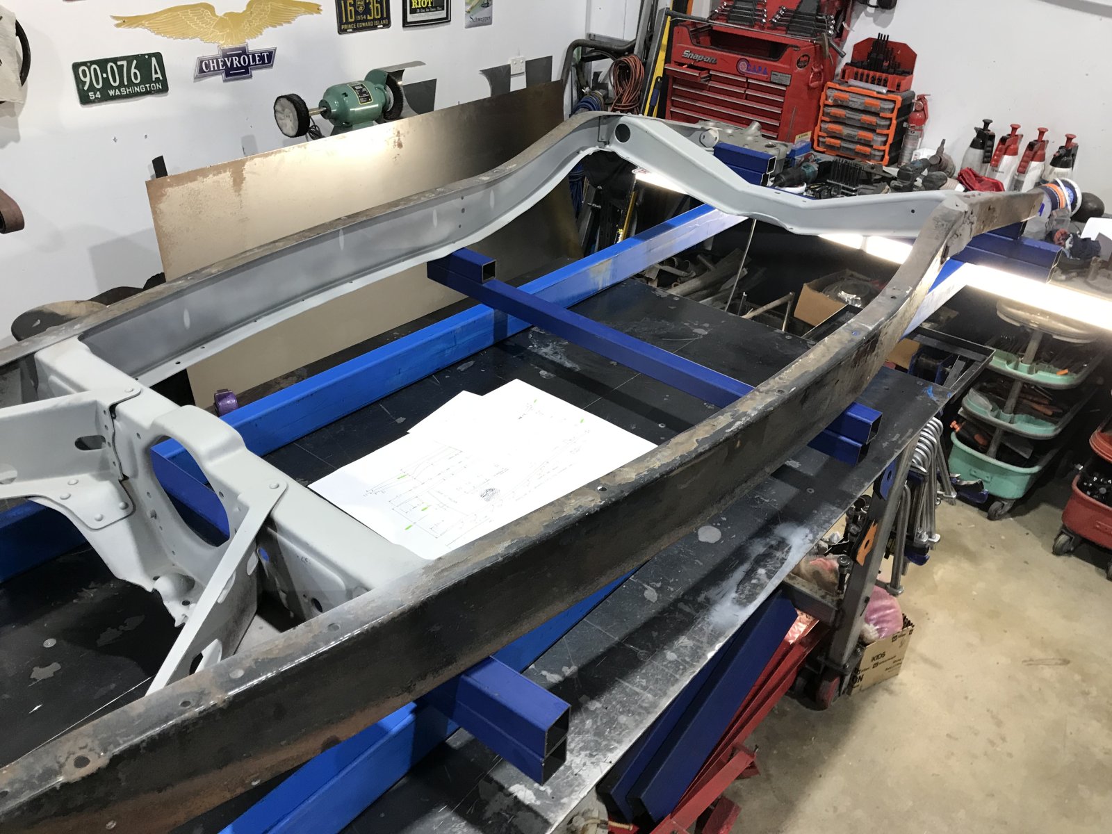

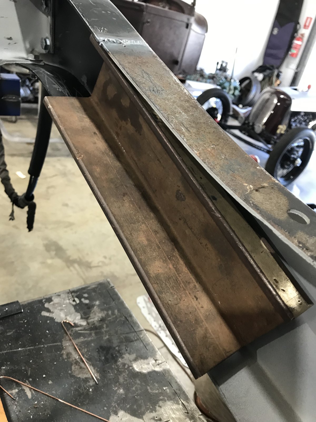

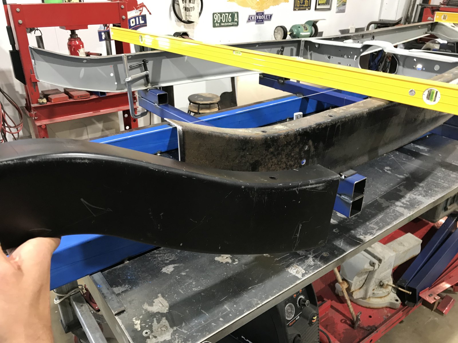

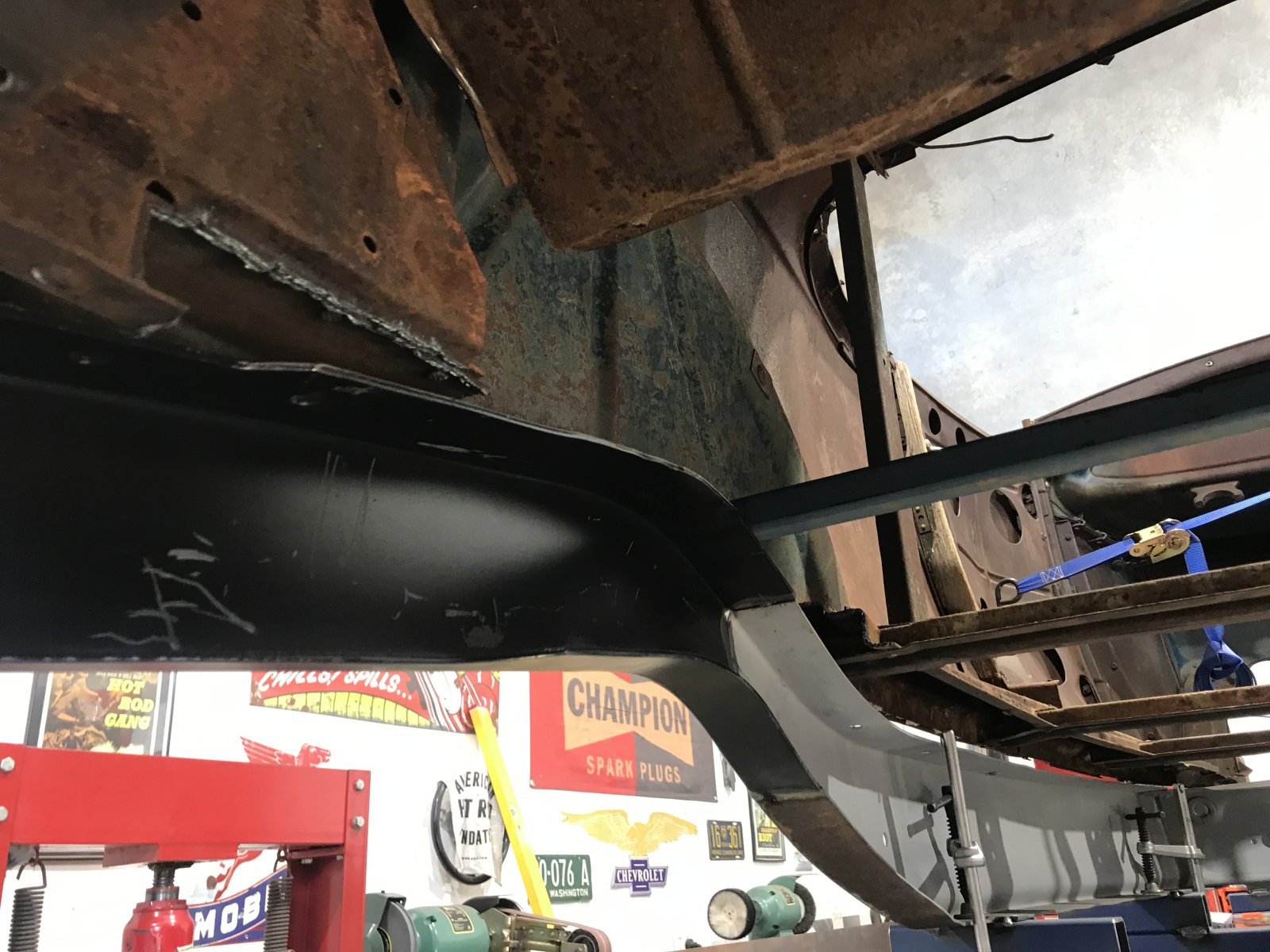

  7. Little bit more progress, the rear kick ups are pretty bent. The left side is the worst, I do have these repop rear sections I could use. Also was thinking about maybe running a model a rear crossmember so I could possibly run the quick change in the future 5B6F2A7E-4475-42B0-9DF3-26FFD44324CB.jpeg 78A987BC-CACB-49EE-BEC5-661050EB183A.jpeg 3850DBBA-4E16-4317-9C20-ECCFF5F0B152.jpeg D41D8896-34E2-4AC7-B721-8132D0D88509.jpeg 8E8F2AB2-5080-46AA-87D6-FD5DAA04F586.jpeg 1D70F687-B917-44F2-B8C7-7F6861D860FB.jpeg
    ct1932ford, Okie Pete, Tman and 6 others like this.
  8. Fronts fixed. Rears are cut getting there. Also found this in my pile, I might use it so I don’t have to grind the springs to fit the 32 one. Guessing it’s 33-34 ?

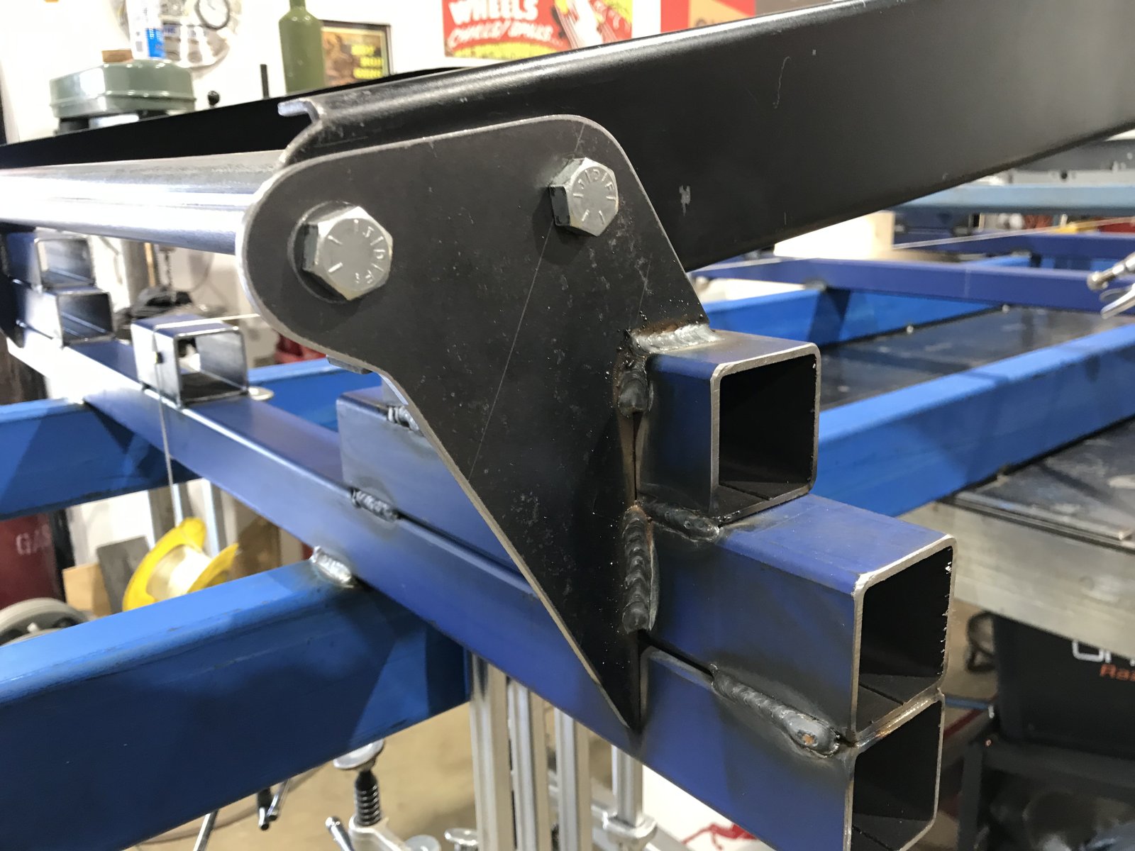

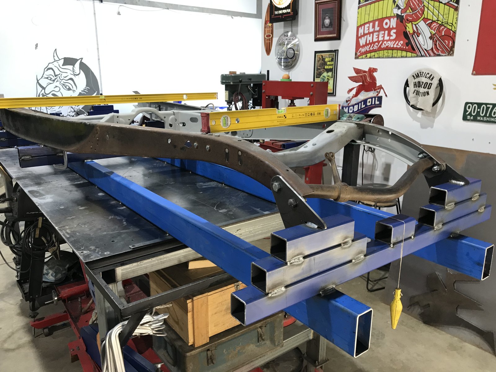

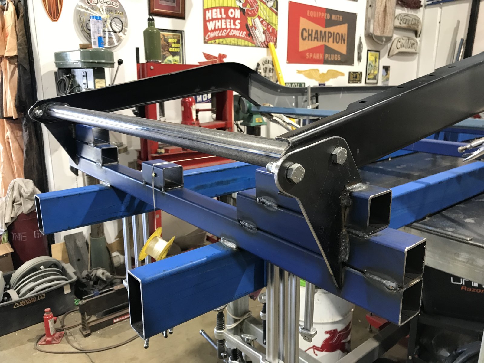

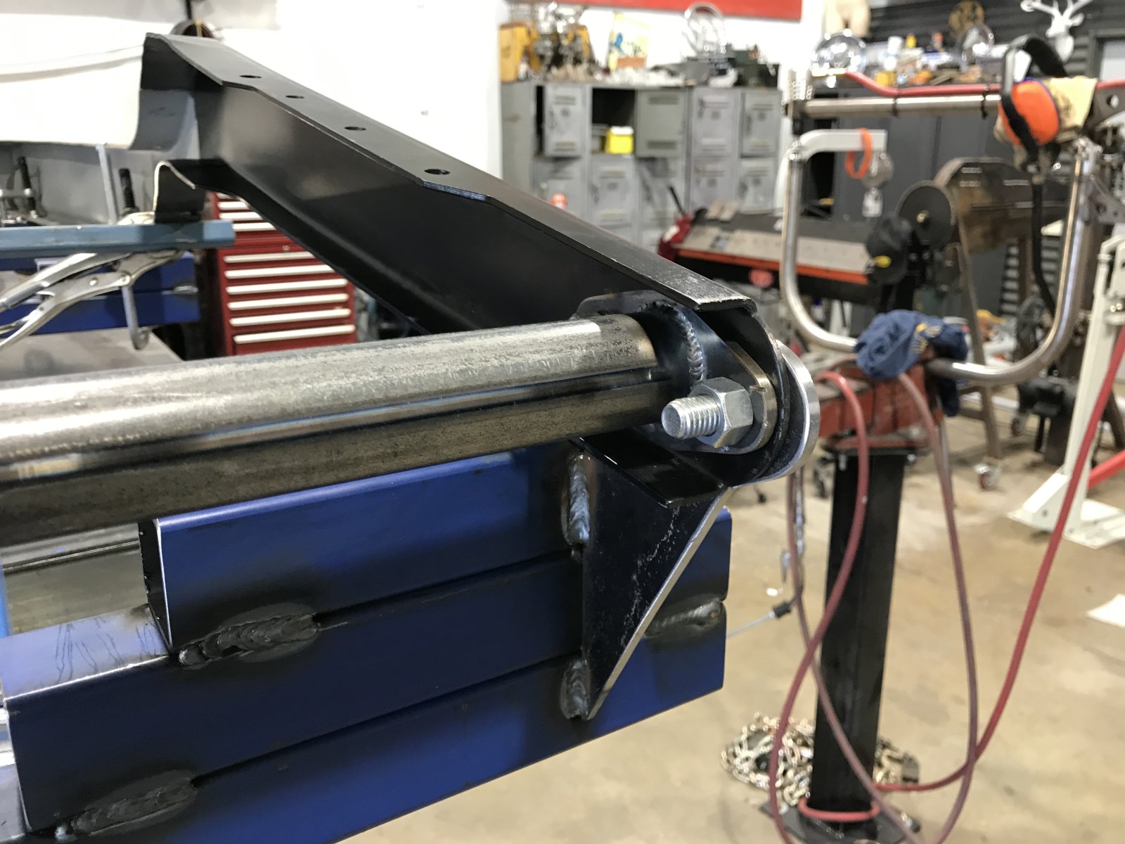

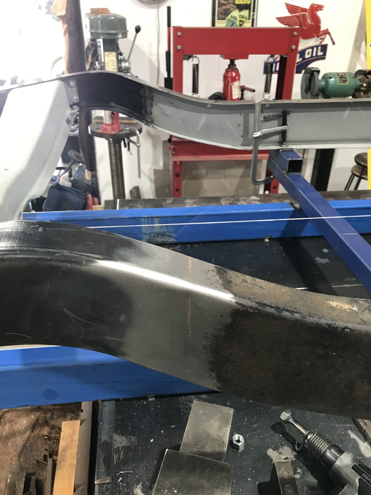

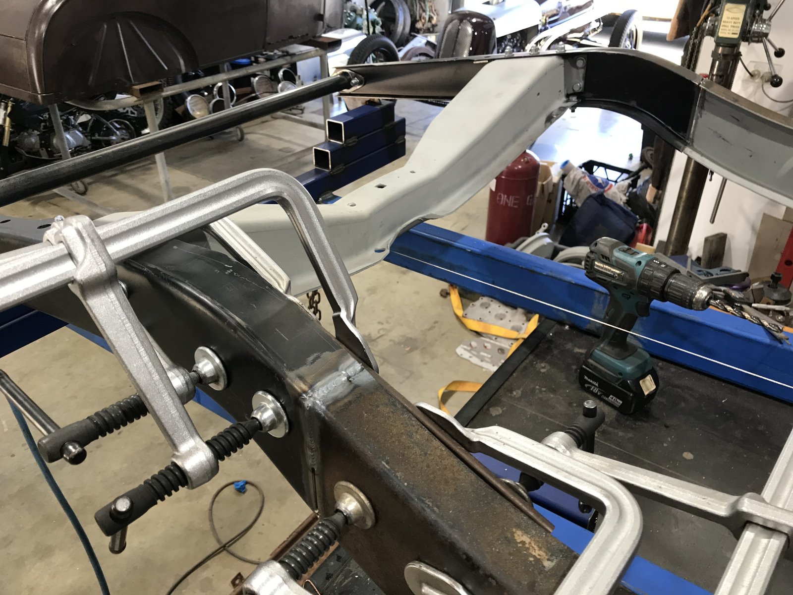

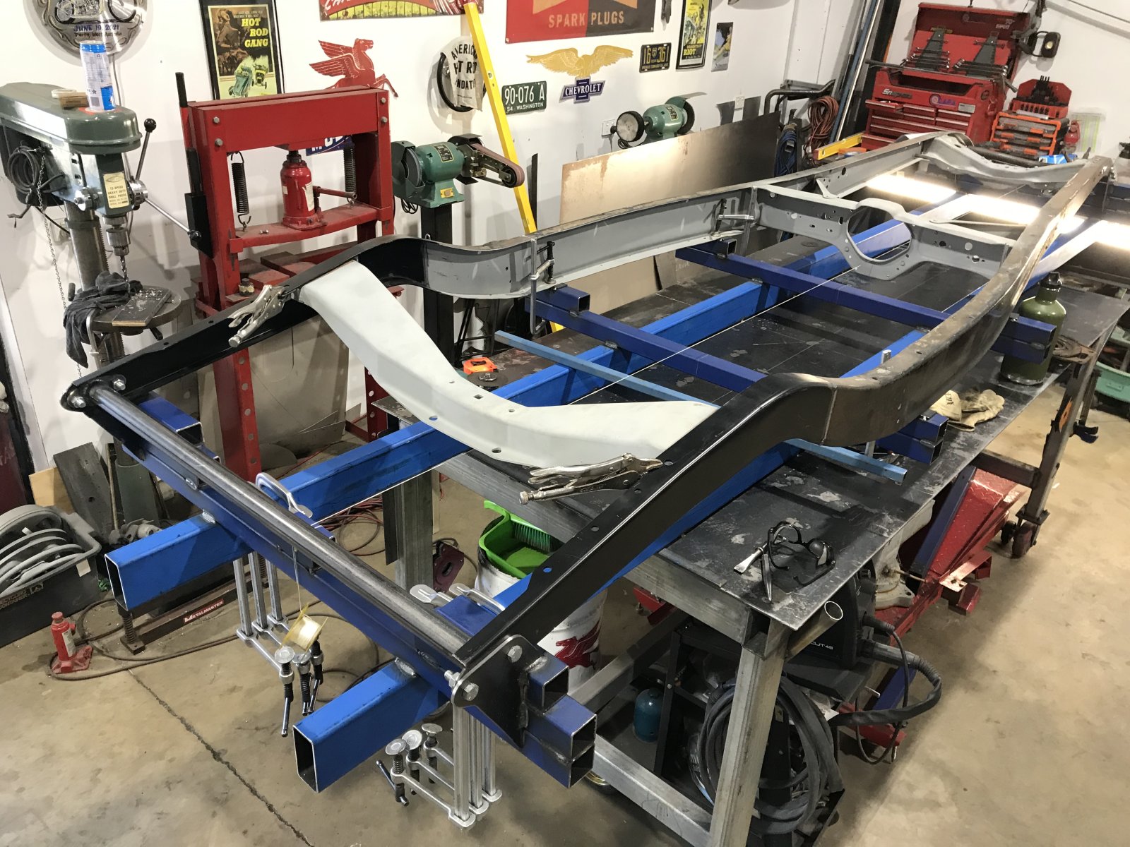

  9. Rear frame horns tacked in, rear jig welded in with fabricated spreader bar to sandwich the frame horns, next on the list, for original rear crossmember or ‘40 rear or model a… hmm.

    Really like how you jigged that up thanks for sharing!

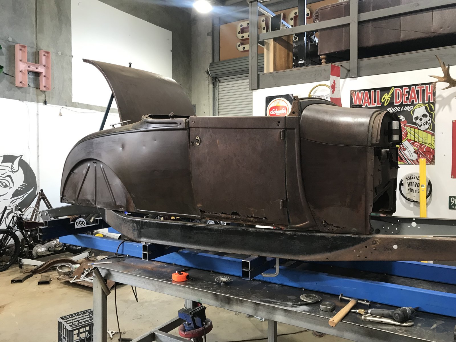

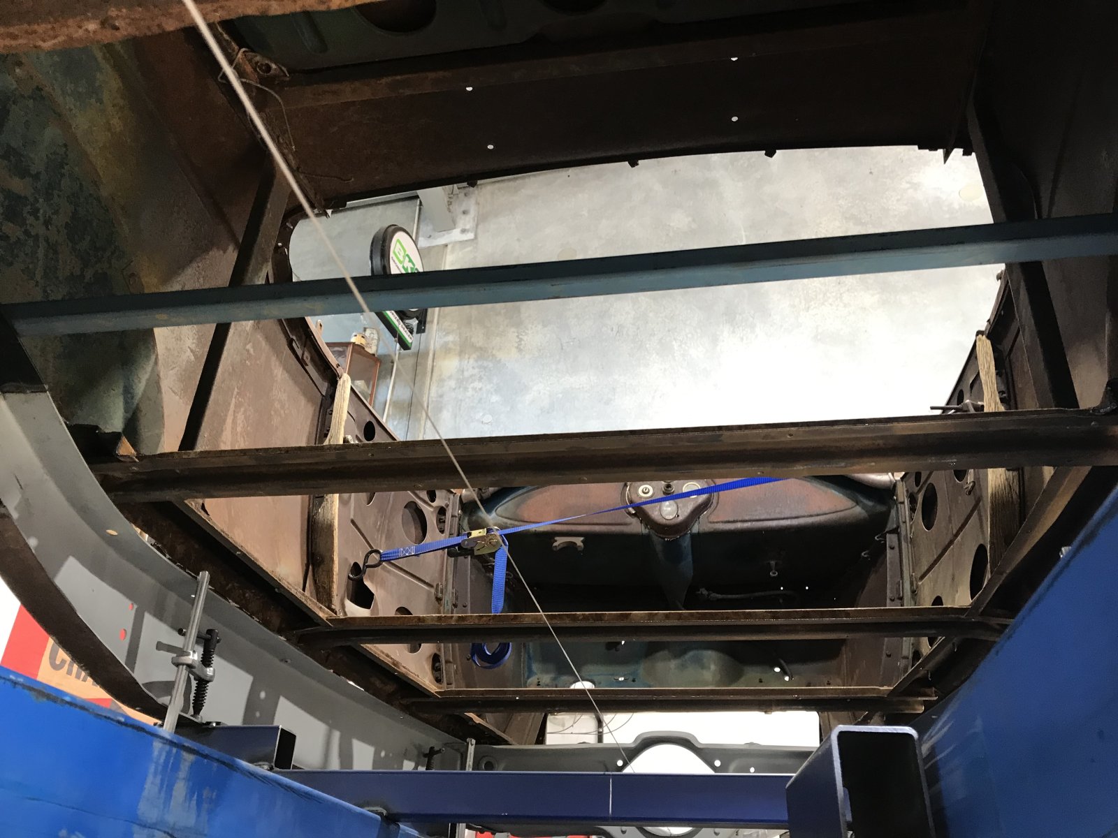

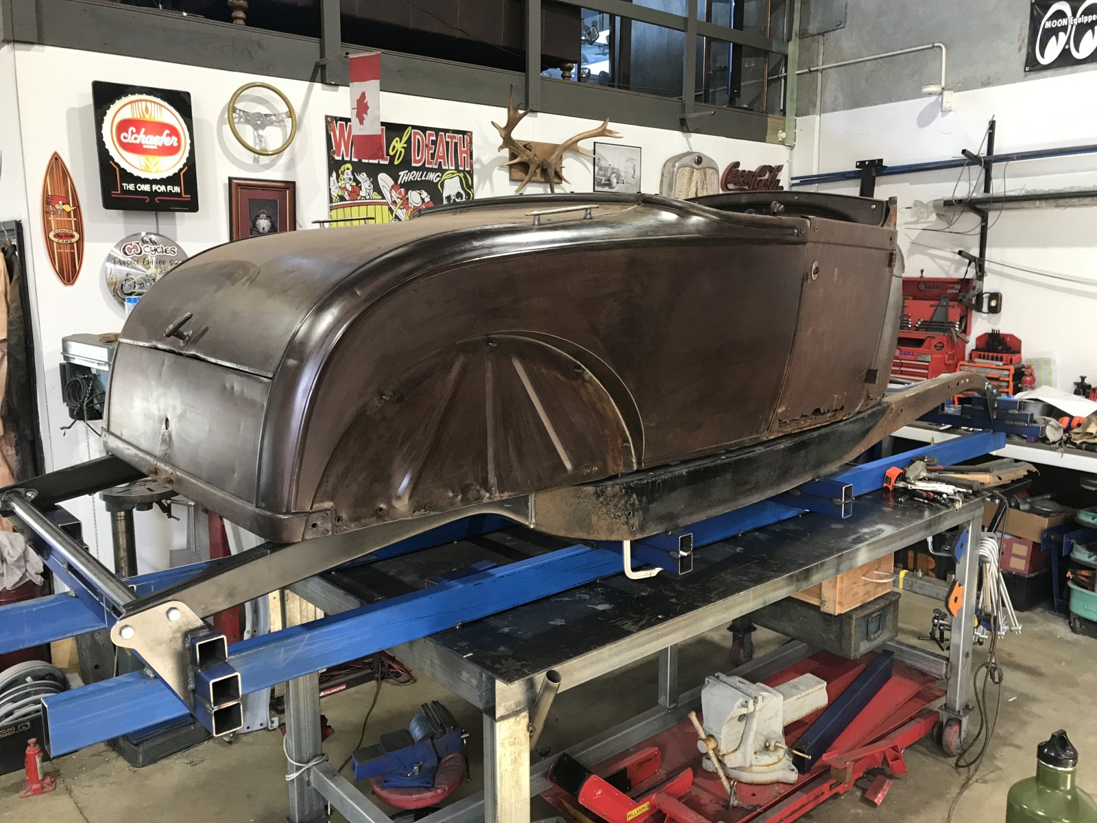

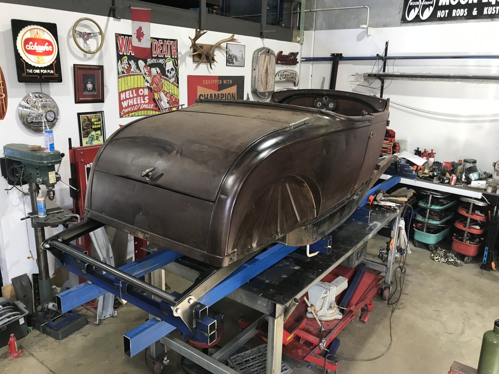

  11. Loosely mocking up body on frame, removed the floor as I will be fabricating a drop floor section for my **** to lower my body down the the car, I plan on running a heavy chopped screen and top so I want to sit very low. 169DEE5E-67F8-4FB4-A4E0-5ED5E758E8CF.jpeg 73000EBB-7F26-481F-83C9-7F8A7E870D56.jpeg 87AEA581-15EE-44AF-AC81-90FED79CF12A.jpeg 79025CDB-E1DA-4ECA-BDDA-DFBF47A6BC03.jpeg 358318D0-3E27-4446-A6EB-3371BED37B92.jpeg 99538B16-F5A9-48ED-900D-1F47A5EE88F9.jpeg

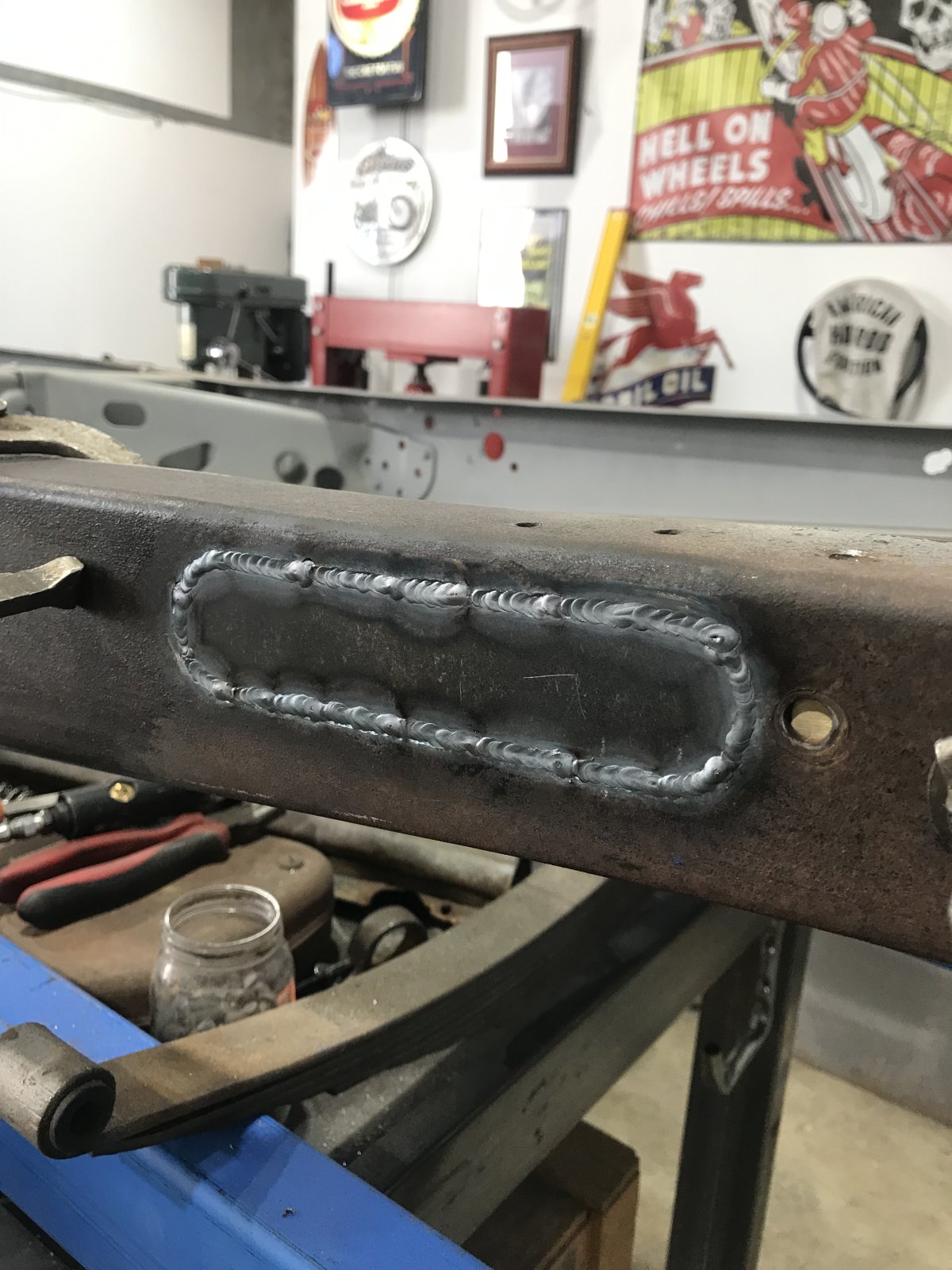

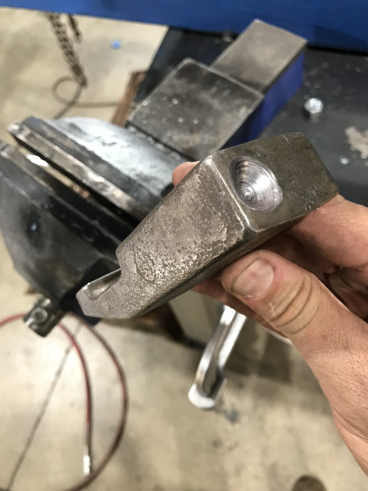

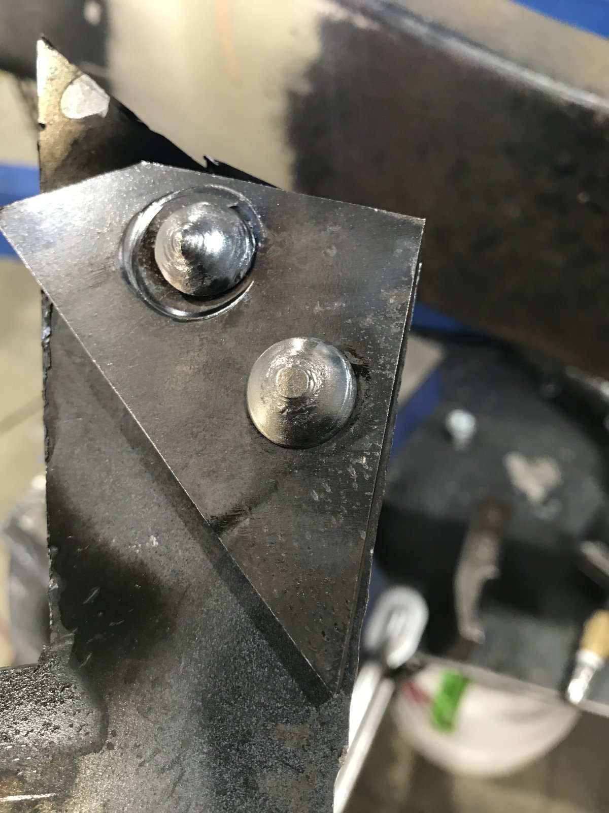

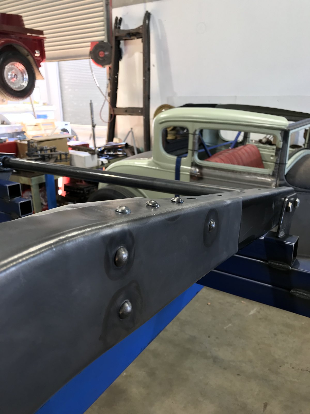

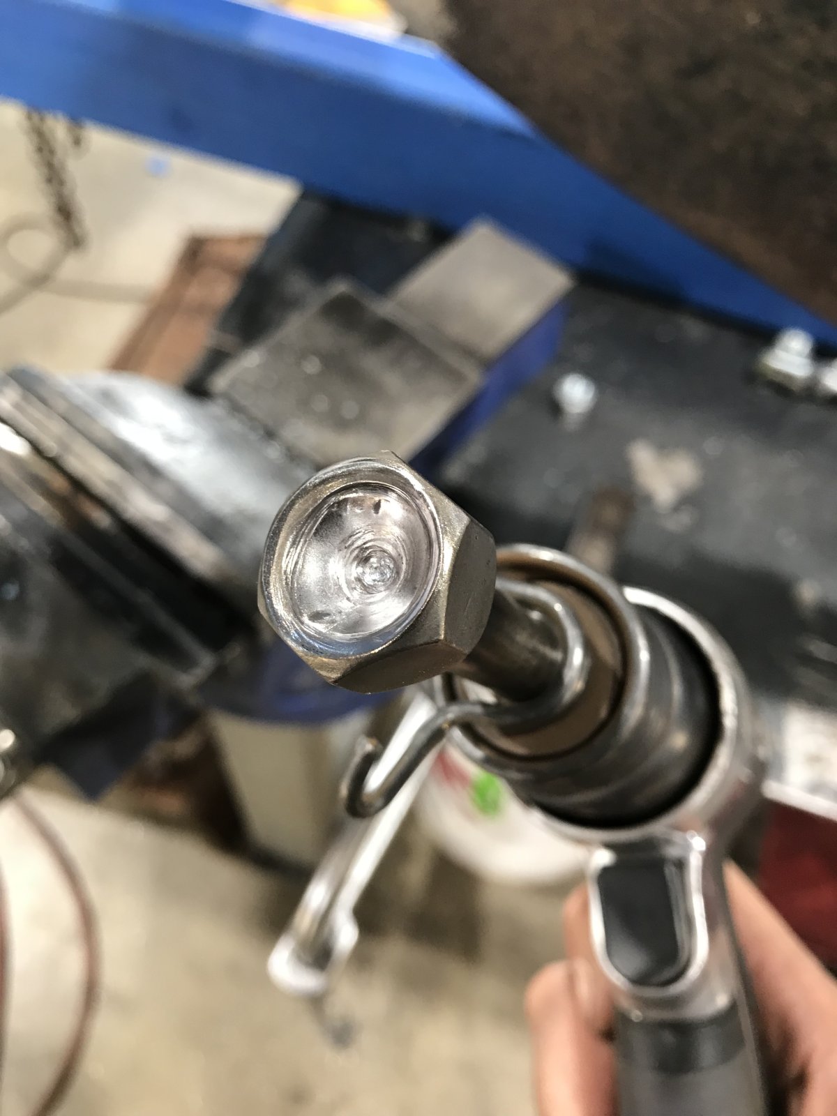

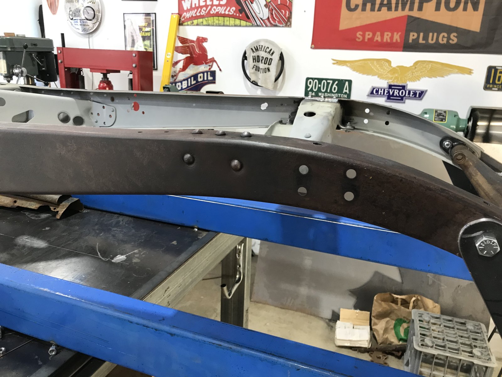

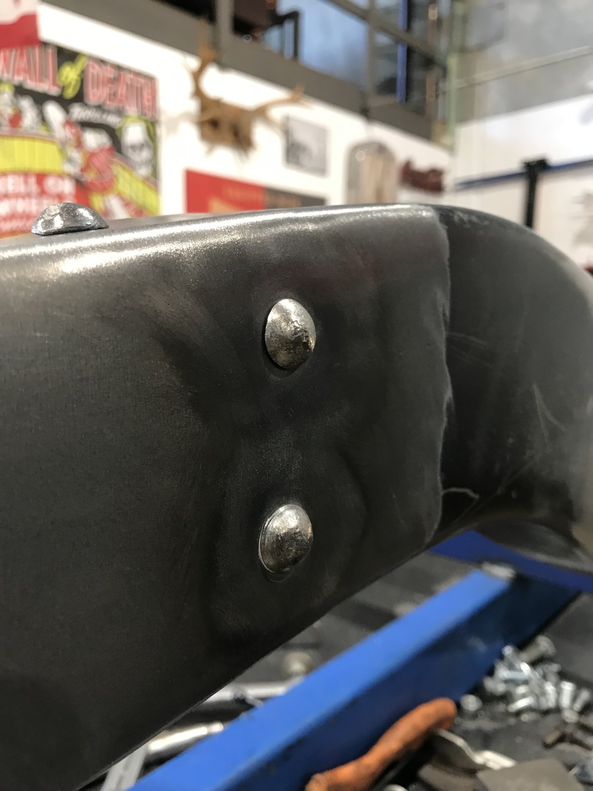

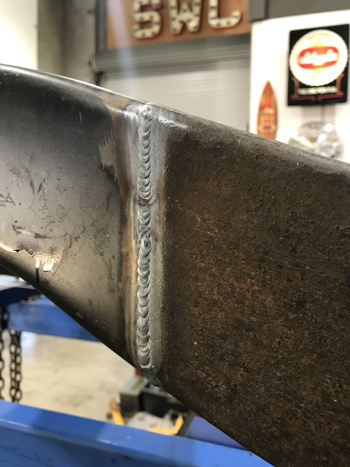

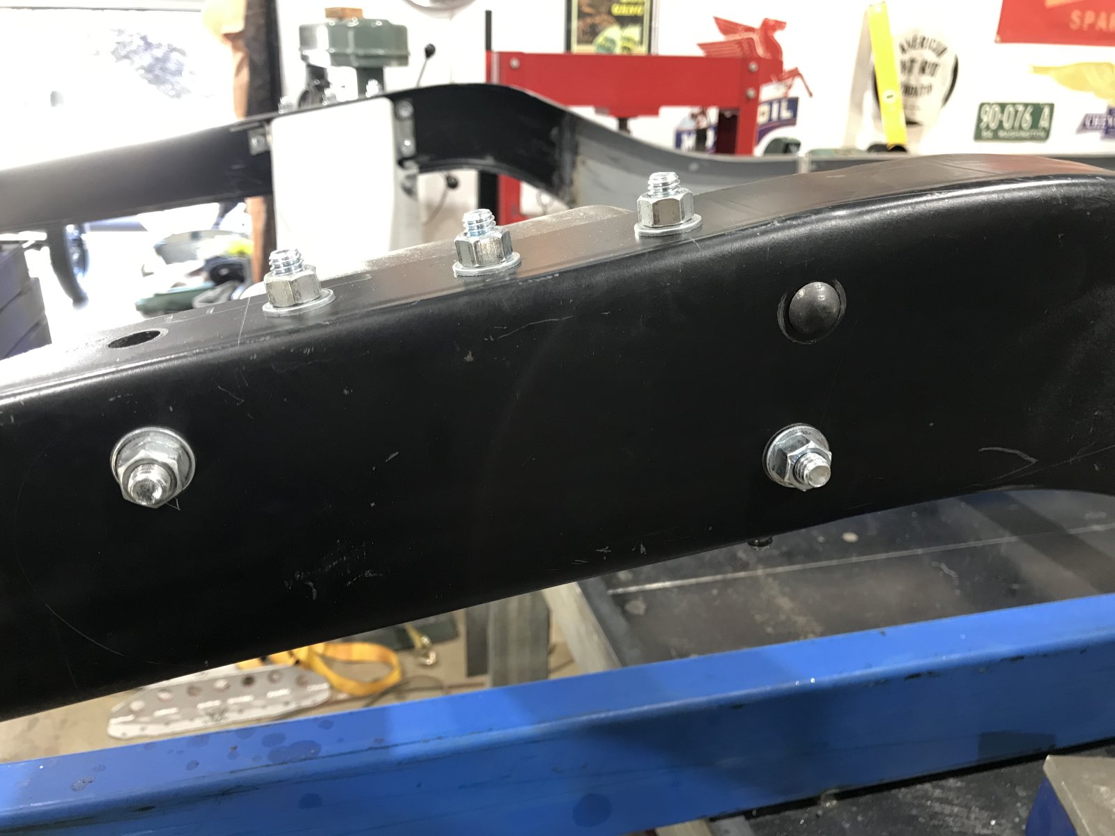

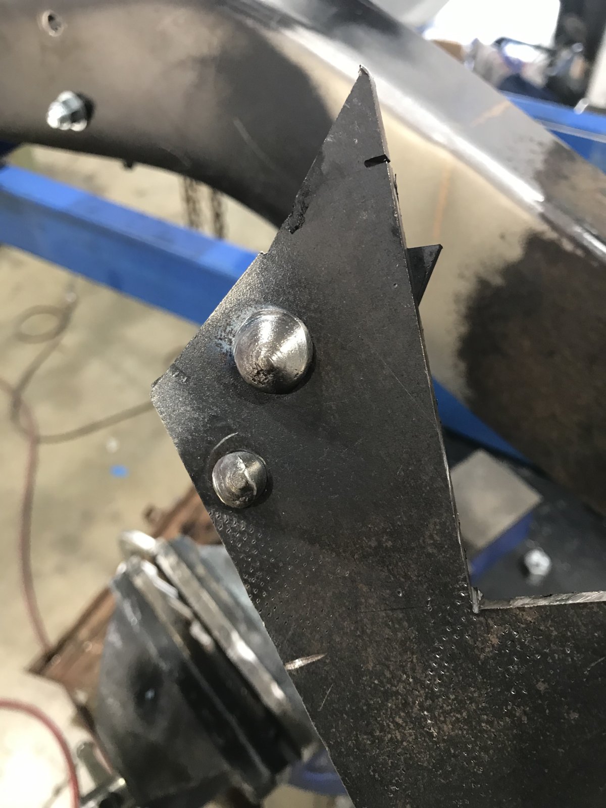

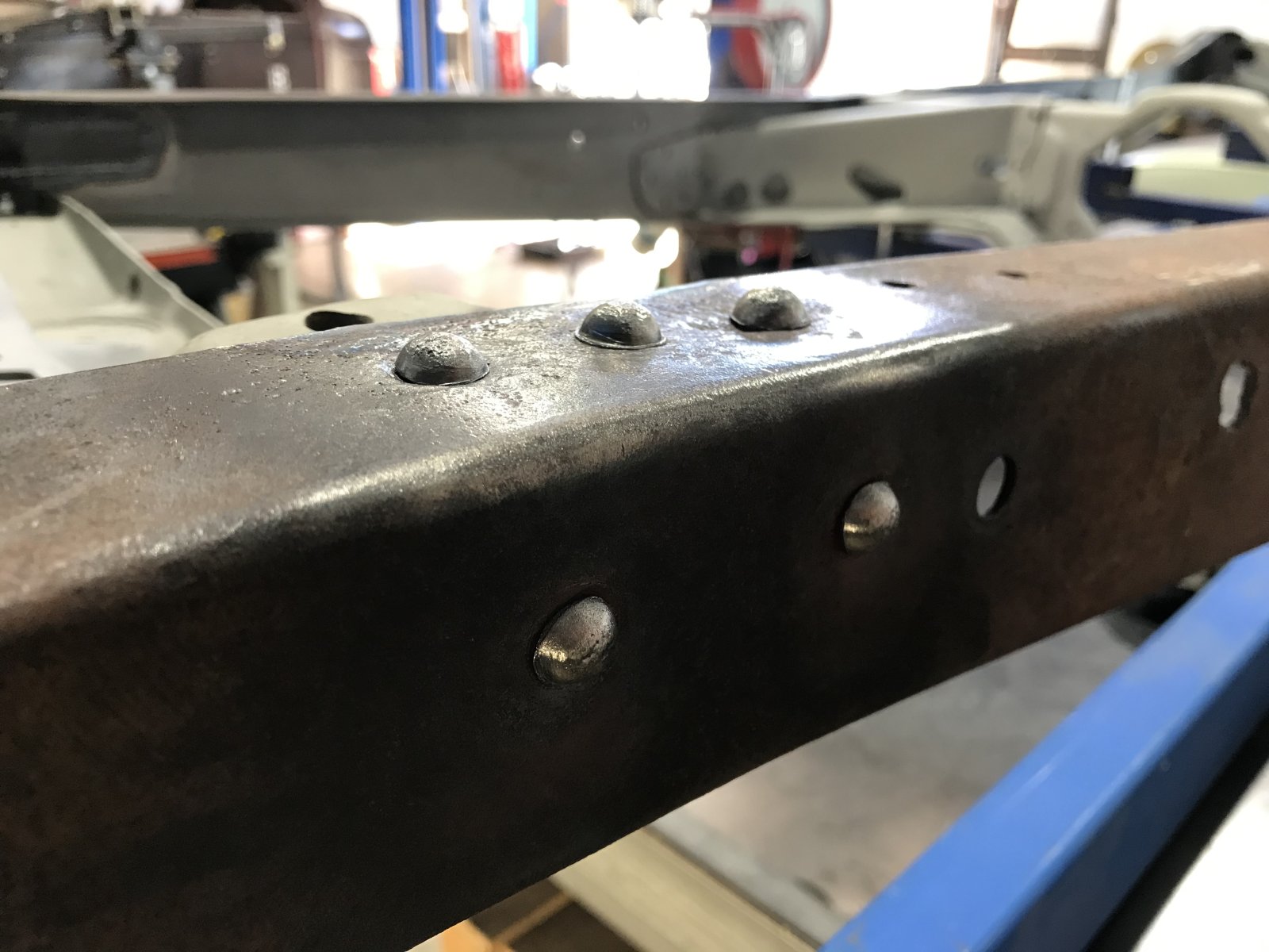

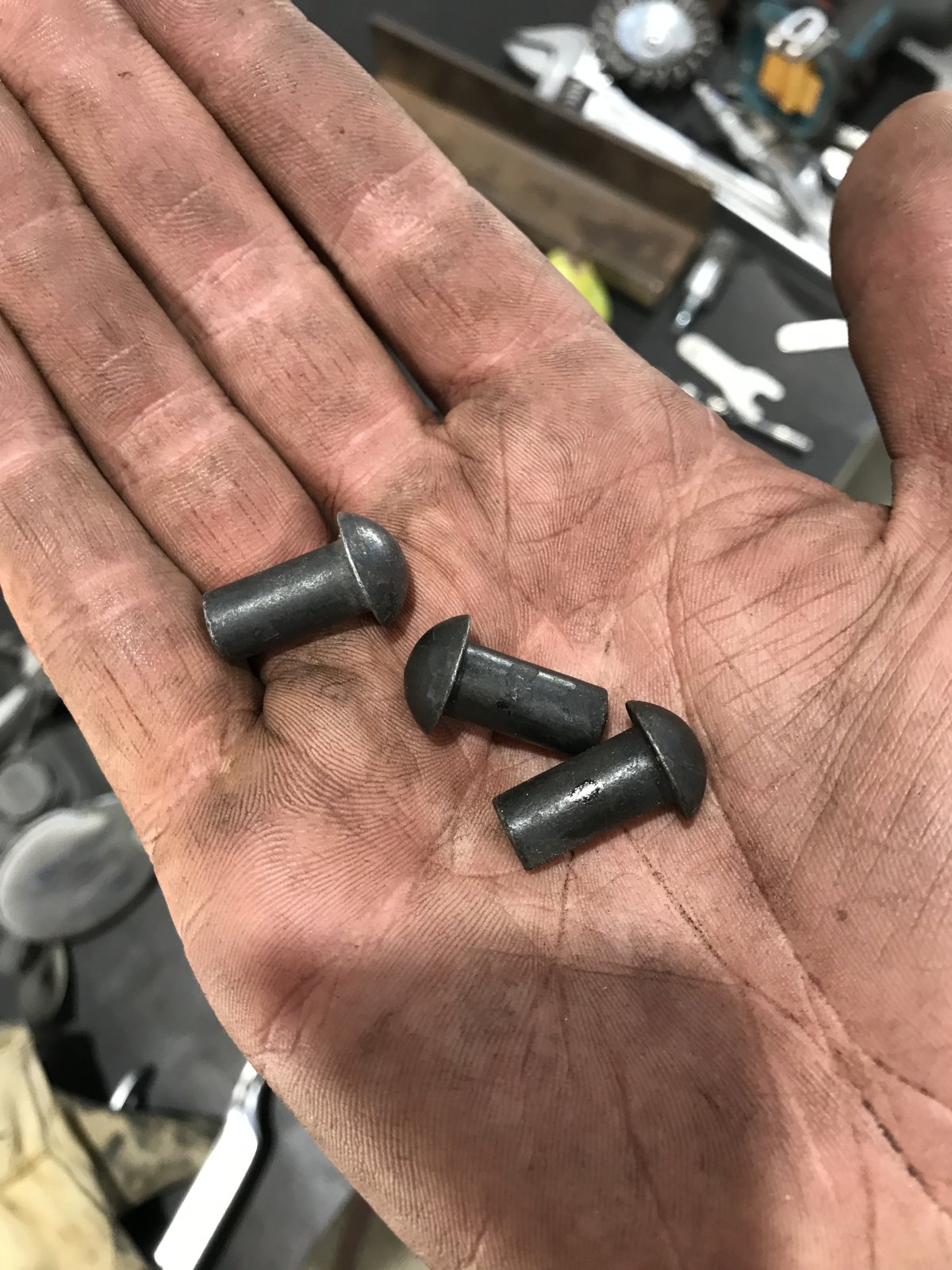

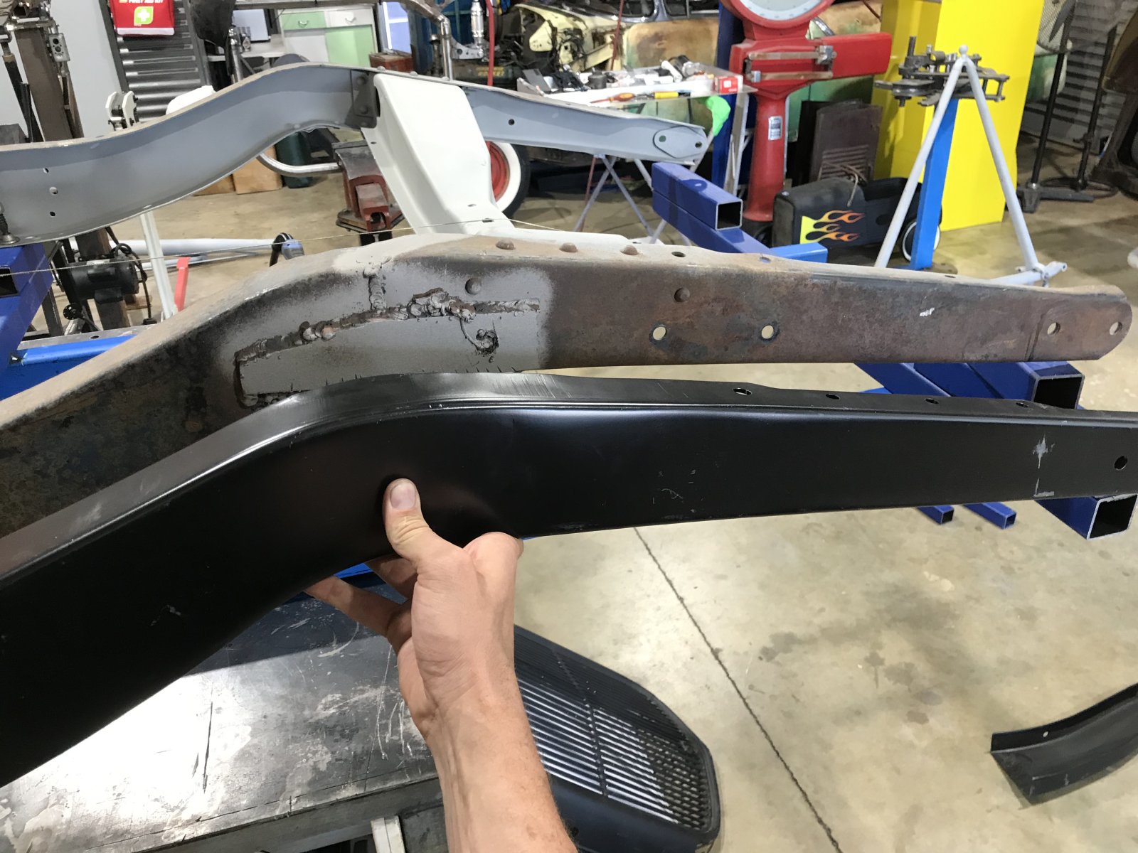

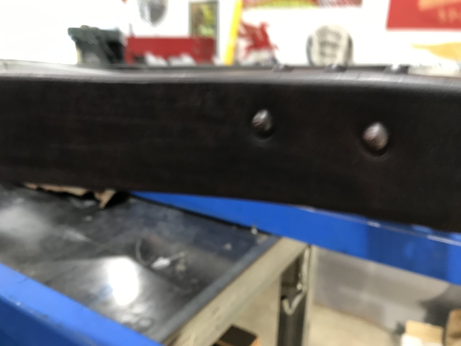

  16. Today I managed to get the rear kick ups Tig welded in and blended on the out side. After bolting in the rear crossmember in the original location. I’ve began to start testing out the hot rivets and trying to get my home made end dialed in, bit of work to go to get them looking clean and uniform. Any tip and tricks with this are greatly appreciated! Even tools you’ve made for the rivets? CAE2EAD9-ADF1-4B33-ACC4-968454CC4F47.jpeg 6ECADF60-1664-46DA-8EA9-13A47CB356CC.jpeg 07D12741-3C38-4EFF-A6F5-B985A5C5C972.jpeg 95A3AF17-C156-4FDC-B407-93FDEF5BAD60.jpeg 26DE6669-6B65-4190-9442-1365B4A4F7D2.jpeg E807B4BD-76CD-4A67-8B18-F7155D2023FB.jpeg 83E513B2-8C5D-4530-9082-0D63D54CAED6.jpeg C6688581-2BC9-44DC-89F5-53EB54C6DAEB.jpeg 3E39BDEB-F73C-4844-AA13-AD08CC81E7D9.jpeg 72D585DF-7280-4FFB-BAC0-786AD5FBC21E.jpeg 46F998FB-F51F-4826-BC4E-700C18817BB6.jpeg 8B8BE3E8-4D8D-4130-9E45-5753637DB005.jpeg BF774C1E-1FB0-41CE-A432-AE8A51BA92B3.jpeg 7BFF3E3A-1EB0-4E7B-8403-95DC3E4E5301.jpeg

  17. The37Kid
    Joined: Apr 30, 2004
    Posts: 32,518
    The37Kid
    BIG FLATS RIVET CO, they have a website, They sell rivets and every tool you need. Bob

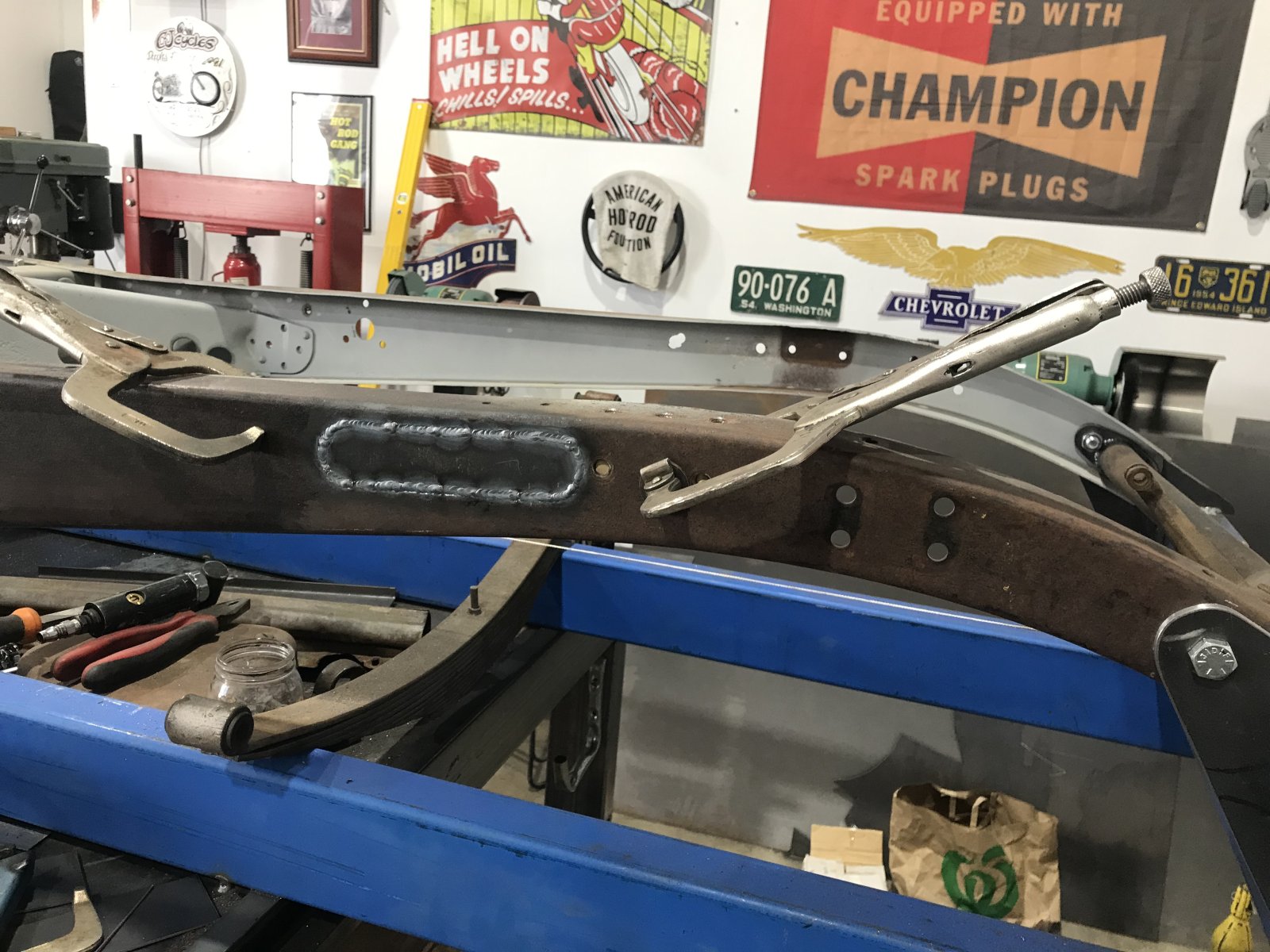

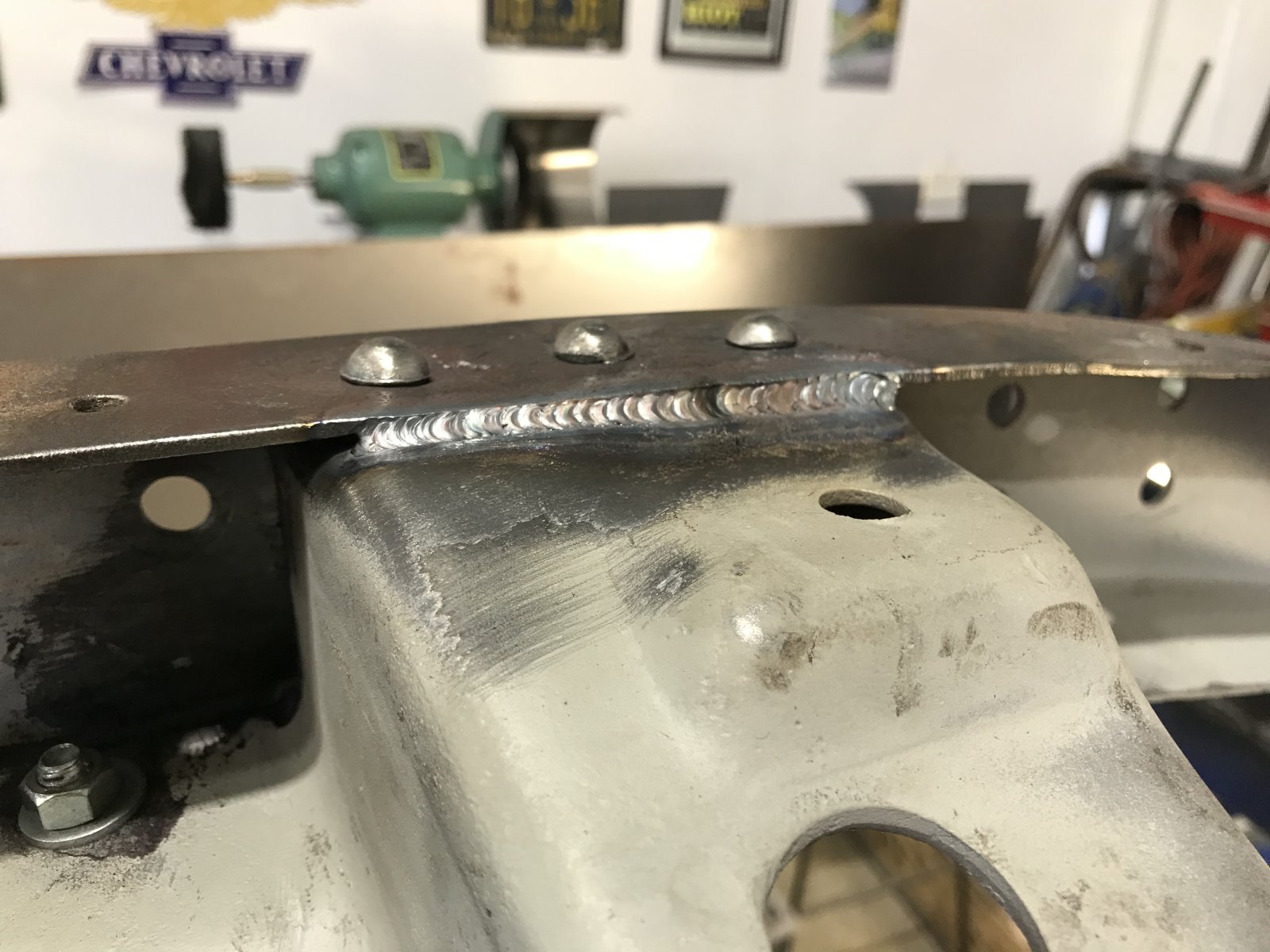

  18. Tim
    Joined: Mar 2, 2001
    Posts: 20,318
    Tim
    from KCMO
    Really enjoying your videos.

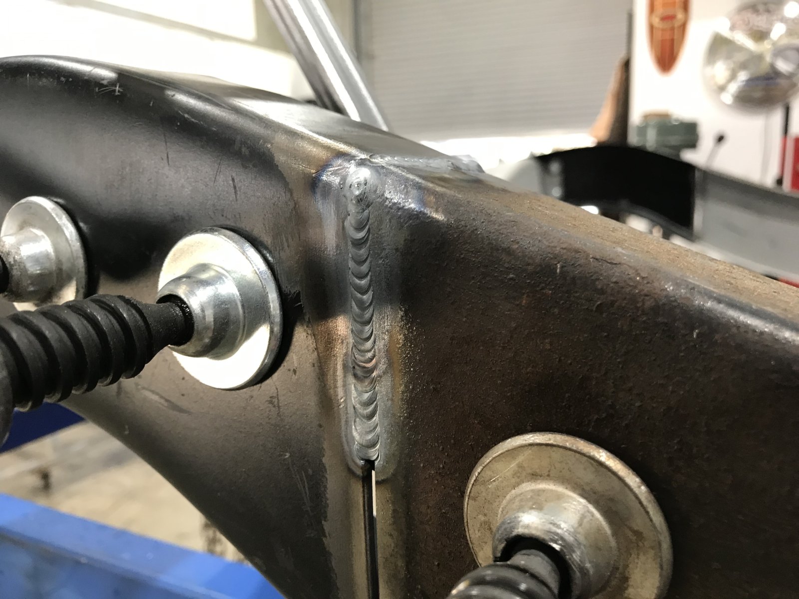

    Any particular reason for such a large gap where you’re welding the frame together? Typically with tig I see very tight fitment. For thicker material I would have expected to see a tight fit with a bevel on one side?
    - to be crystal clear I’m asking because I honestly don’t know and your stuff has been pretty informational so figured you’d have a good answer

  19. Yeah I went but unfortunately I believe he’s fallen ill and doesn’t have the website up anymore

  20. you’re right, when Tig welding I’d have them tight with a bevel. I had originally planned on mig welding these and usually like to leave a 1mm gap for that.
    Im sure there’s guys that do it completely different. Im no expert haha

  22. Tim
    Joined: Mar 2, 2001
    Posts: 20,318
    Tim
    from KCMO
    Ah that makes since :) are you going to use a fishplate on the joint?
    sorry I’m the guy who’s always got a million questions

  26. Yes I will box a small section and tie it into the rear crossmember but done so to rivet and make look like it’s suppose to be there

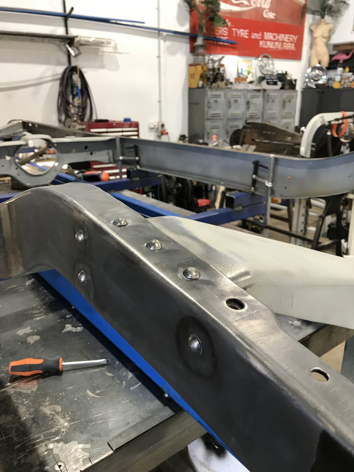

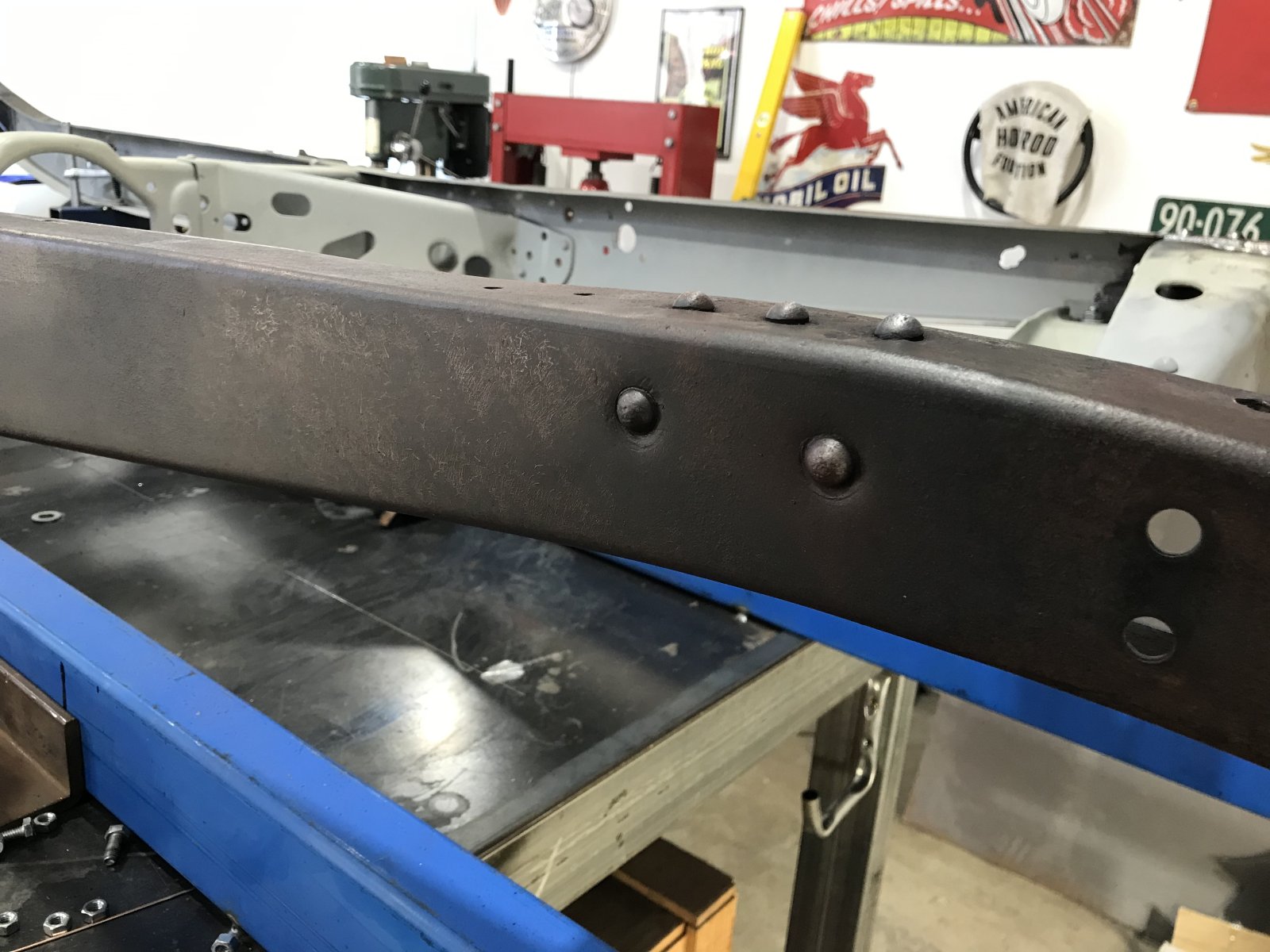

  27. Had a crack and has success with the rivets, a bigger buck would be good but they are pressed well and look the part. Slightly bigger than stock but I’m okay with it.
    Next is the front crossmember, repairs to front section where shocks are mounted and rear boxing plates to strengthen where I’ve welded the rear section.

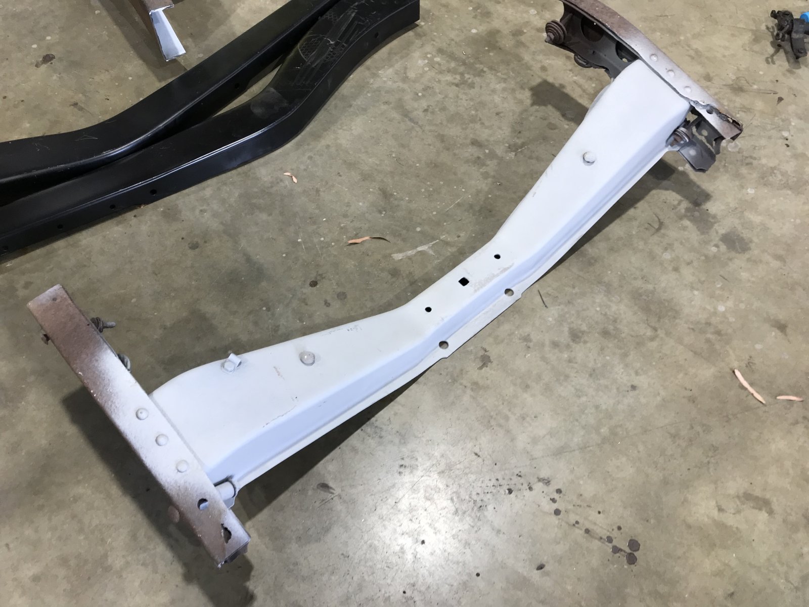

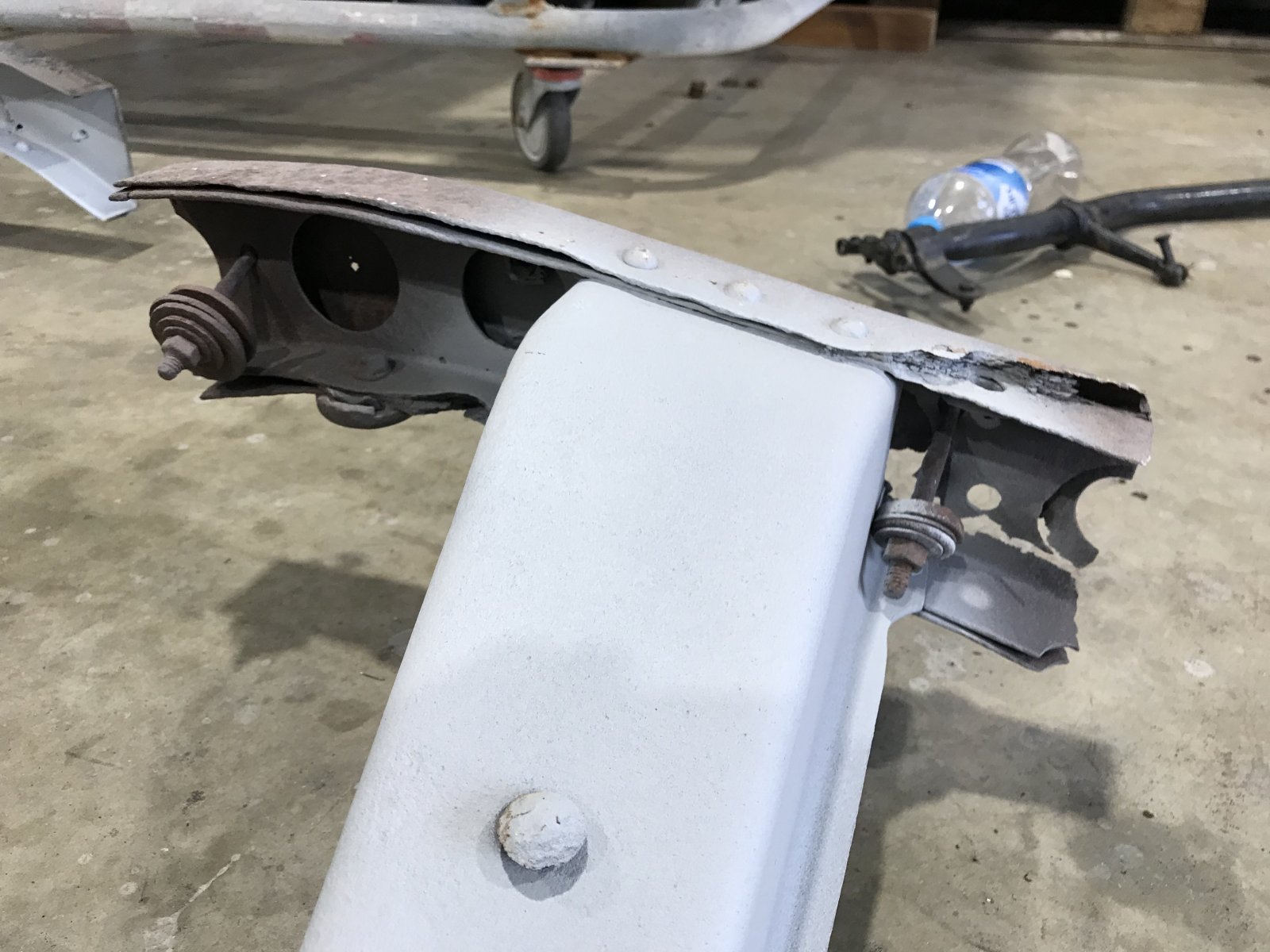

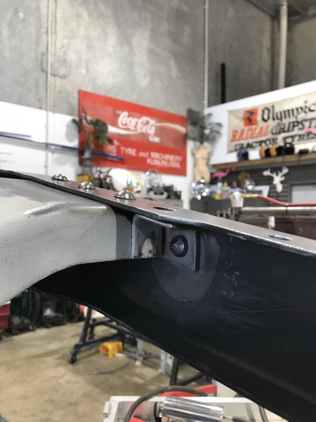

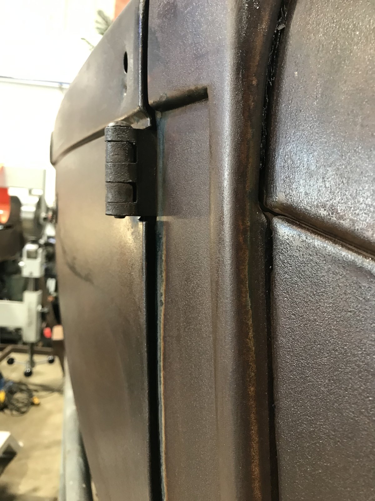

  30. Got the front crossmember reverted in, this one was tricky and took me a couple times to get right with the limited amount of space I g
    Had to get a buck in behind the river on the inside. I know the ones on top of the frame and usually flat to clear the front fender but I’ll leave them for now. I also did a p*** on each side of the crossmember and welded it, might not be necessary but it’s easy to remove if needed. Repaired the right side where the shock mount mounted and blended it in and played with a few cans of paint to match the original patina. Not usually a fan of making things ‘look old’ with paint but it’s getting close to looking like it wasn’t done. Hiding those couple hours of work hahah.
    Prepping the body with ‘galmet’ rust convertor and sealer, it’s a bit shinny for my liking at the moment but will play around with it, gives a lot of depth and detail. F5D3B1C1-5D24-466A-A78A-DF4381EC6265.jpeg 5A6EDE37-B973-4336-B88D-1BC6D7FD877A.jpeg 7EC888BA-F9A3-4453-9F55-9B732C470259.jpeg 583F92E9-E0EB-4A7D-8F85-72BA0DFAB173.jpeg 49D95925-02EB-410D-B41E-F0F0820DB0F6.jpeg 0CCCC304-7221-4031-B3D2-D6DCC0DD1DF2.jpeg 92C16716-71FC-4FA8-A921-65A511A1EFA9.jpeg 8D365AC6-B5B6-4684-9216-925840BCF408.jpeg 56F603C0-94B7-48EA-B246-D8D5F7C4070C.jpeg 8D230BCA-9DDF-4863-98F1-77ED506FAD0A.jpeg
