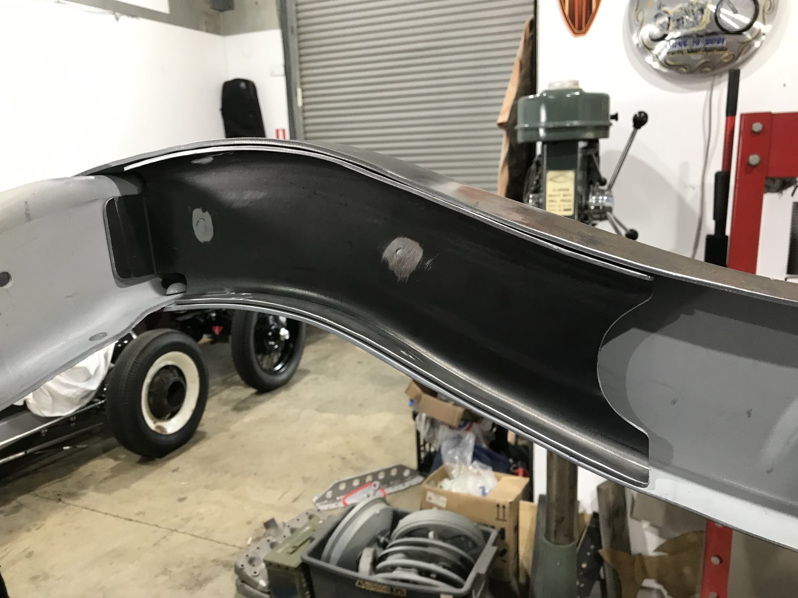

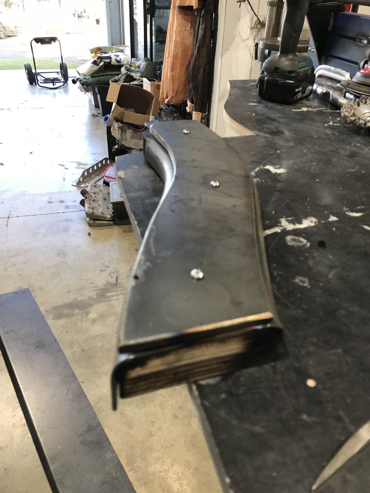

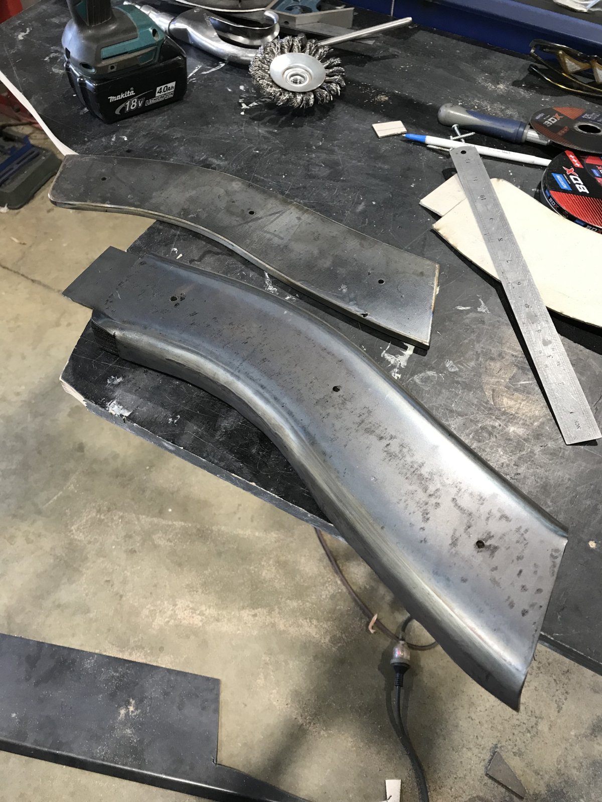

  1. Made a wood buck (expected it to burn) next time I’ll make a steel one but roughly got the section made for the rear kick up area that I replaced. It will be hot riveted in and pickup part of the crossmember aswell. Holding to make it simple and look like it should be there.

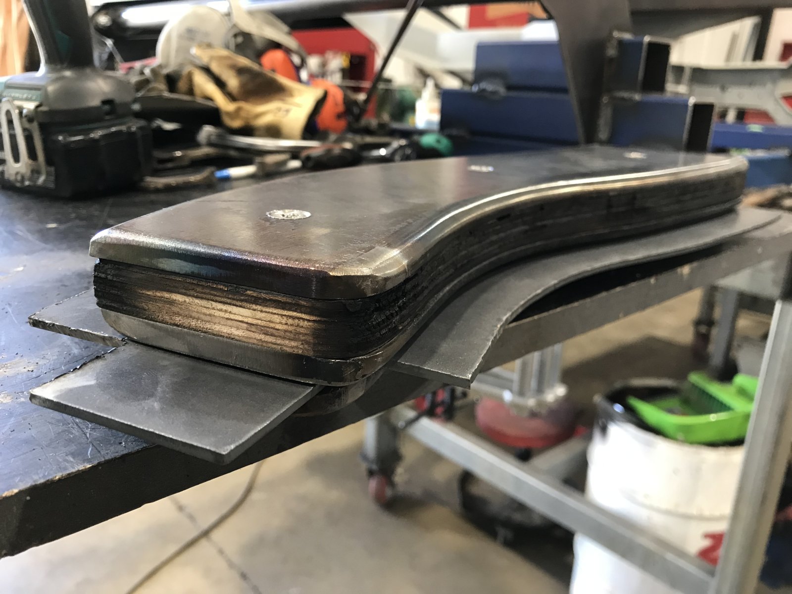

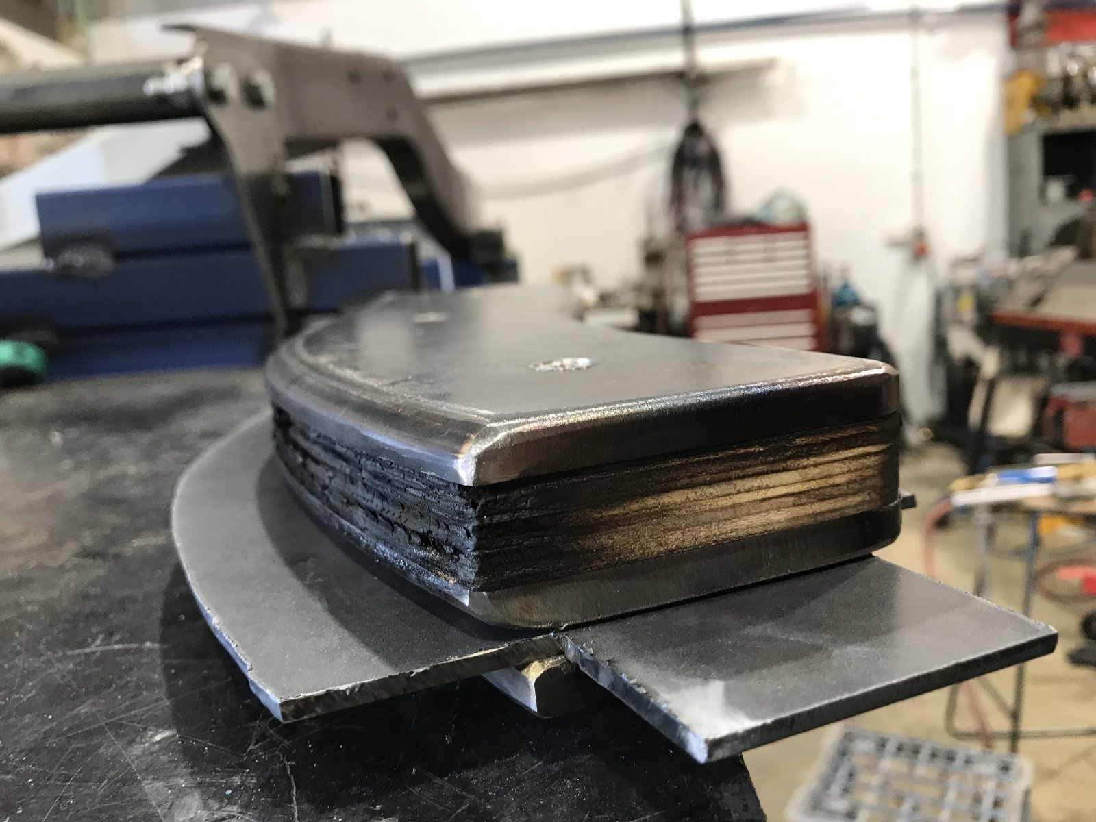

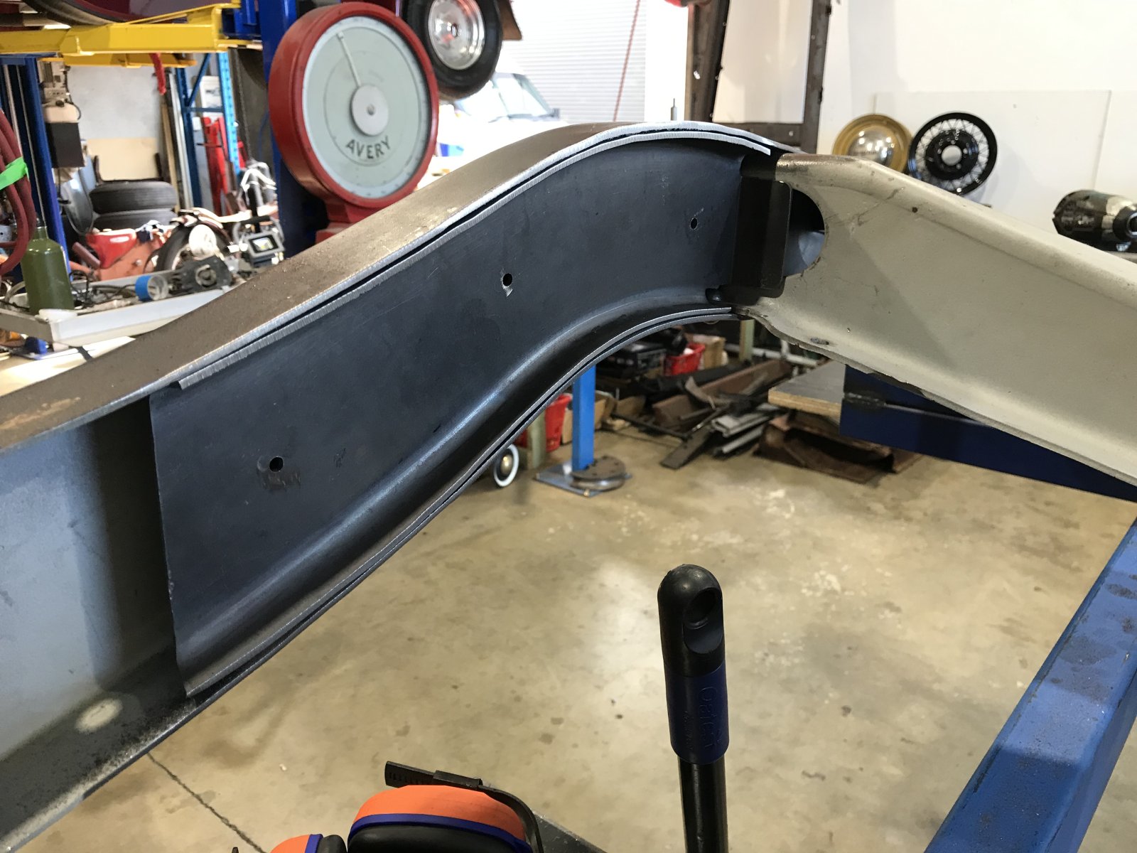

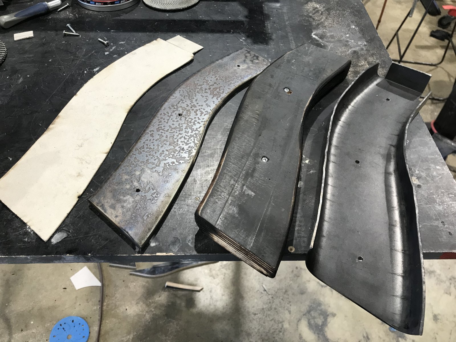

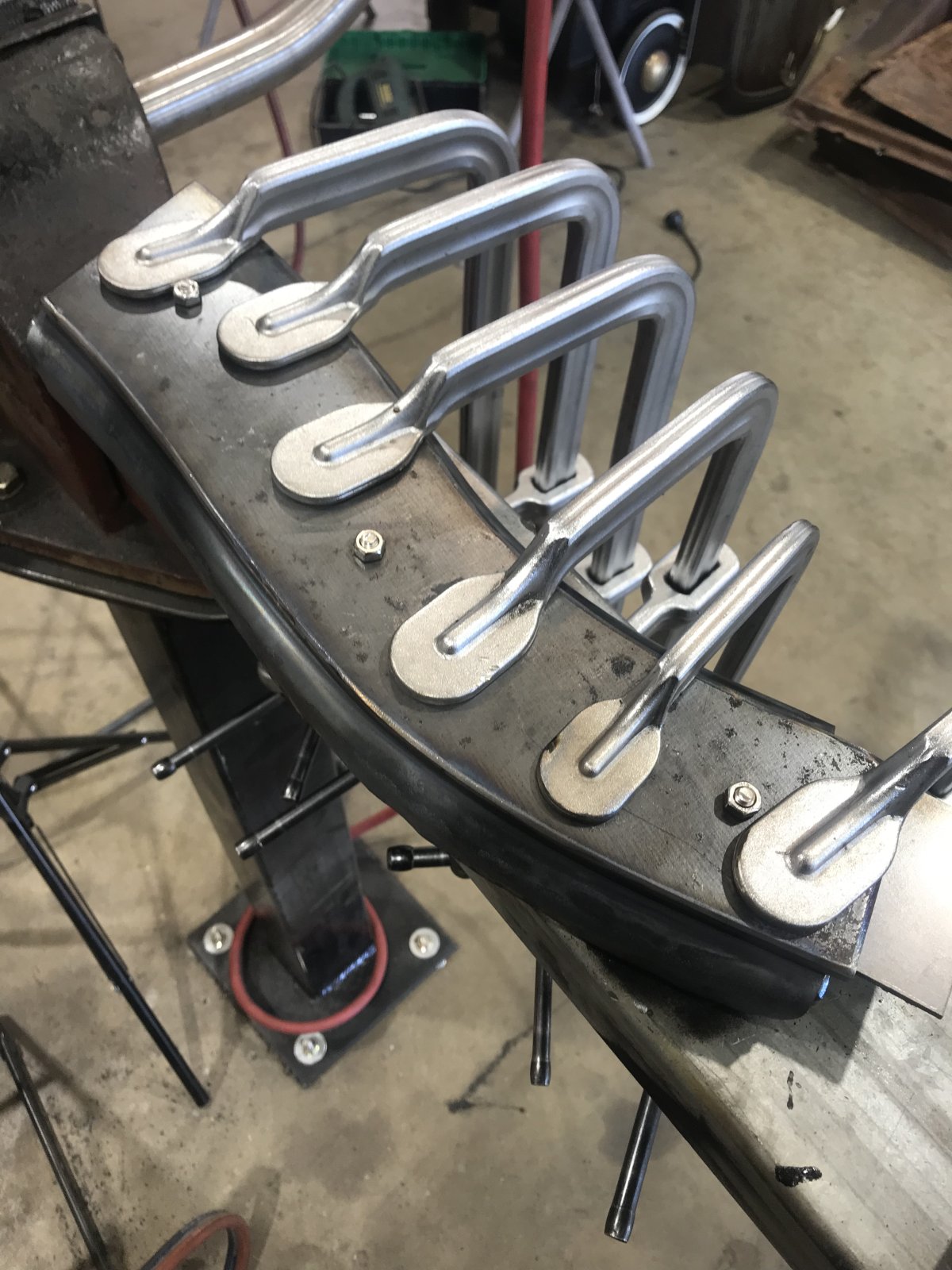

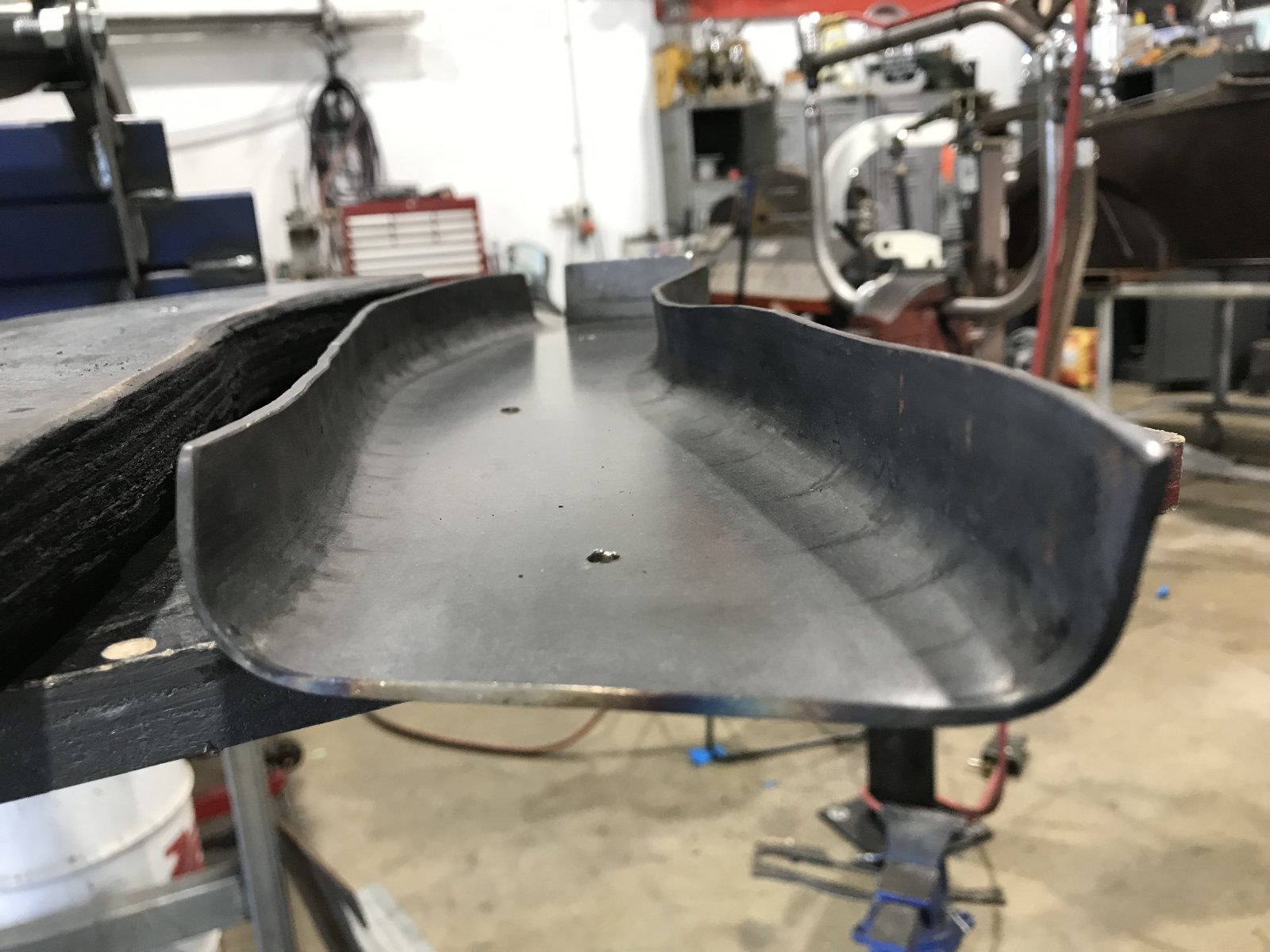

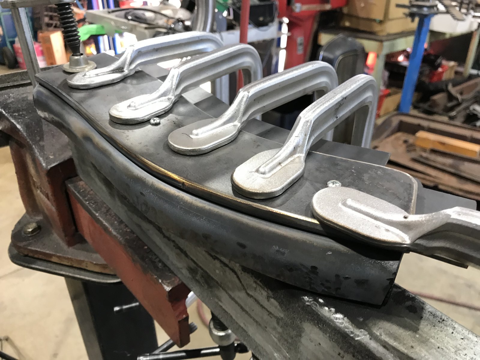

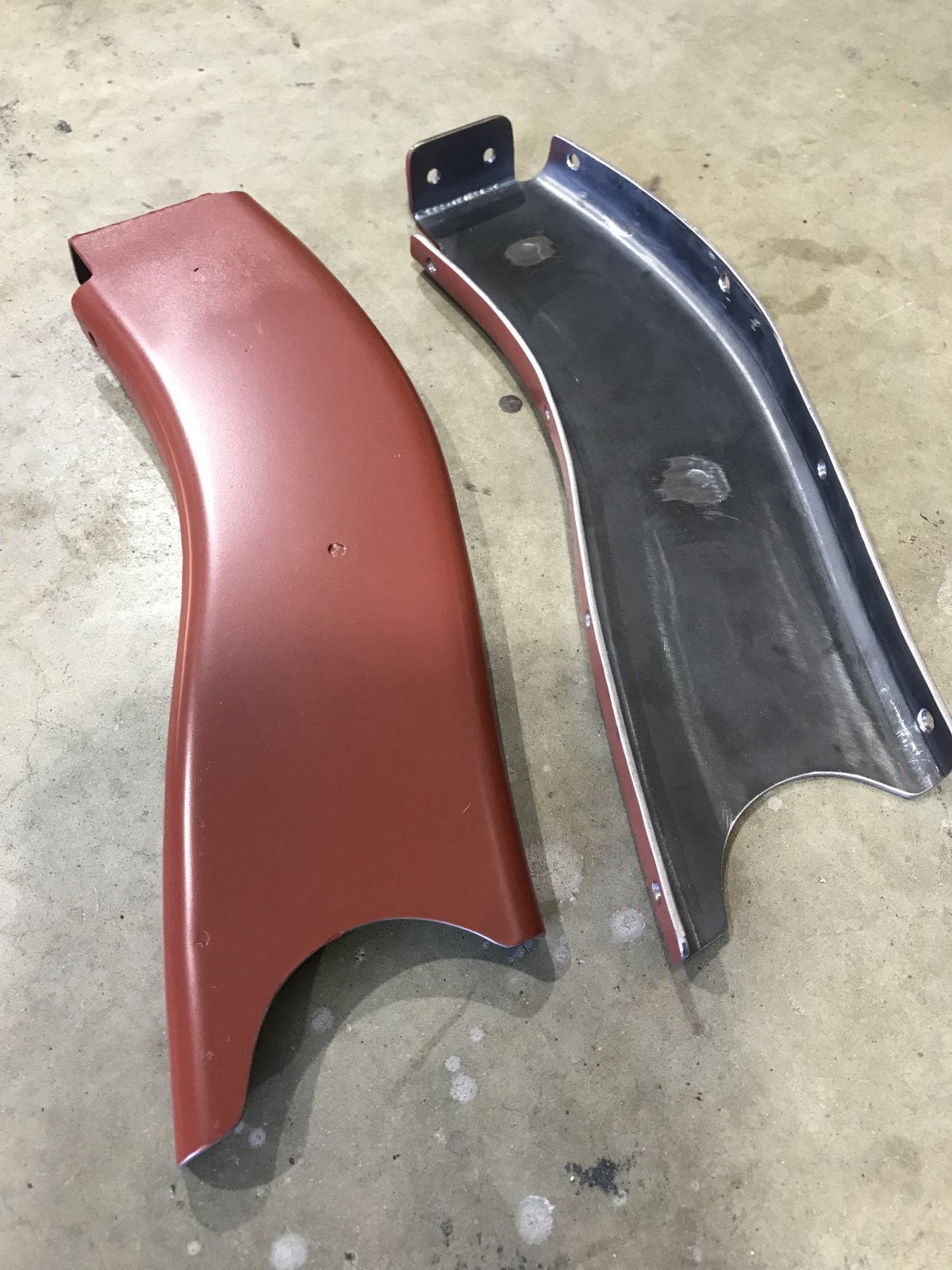

  2. Wasn’t happy with the first inner plate for the frame rail so I fabricated a new die using more steel and less wood, gave it a crack and it looks a lot better already. Bit more to go then I can rivet these in. Sure was close to just welding them in!

    Looks great!, much better fit up

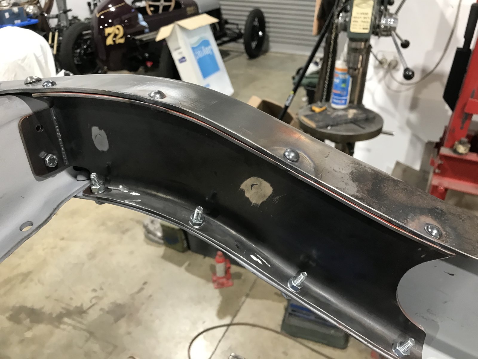

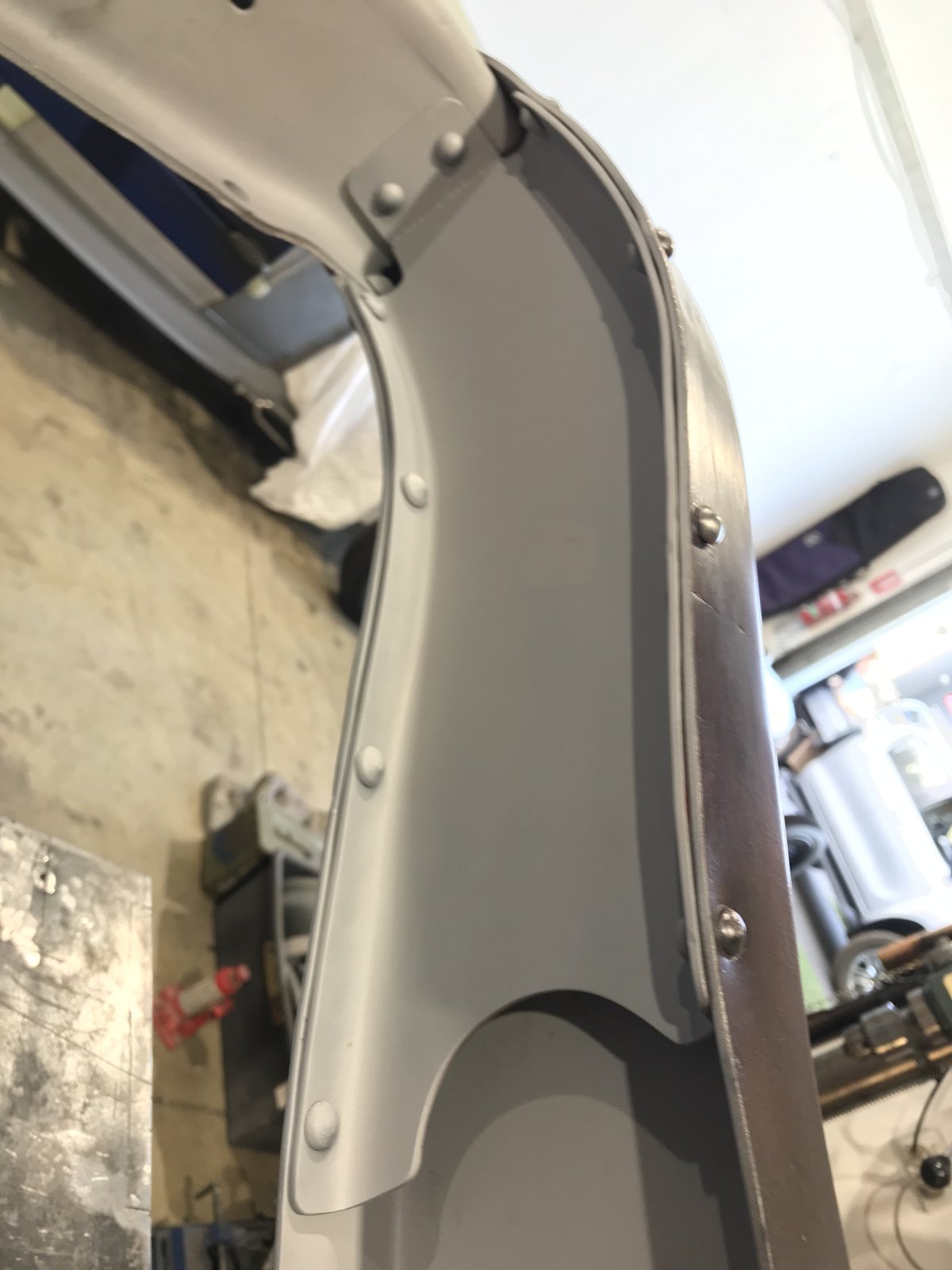

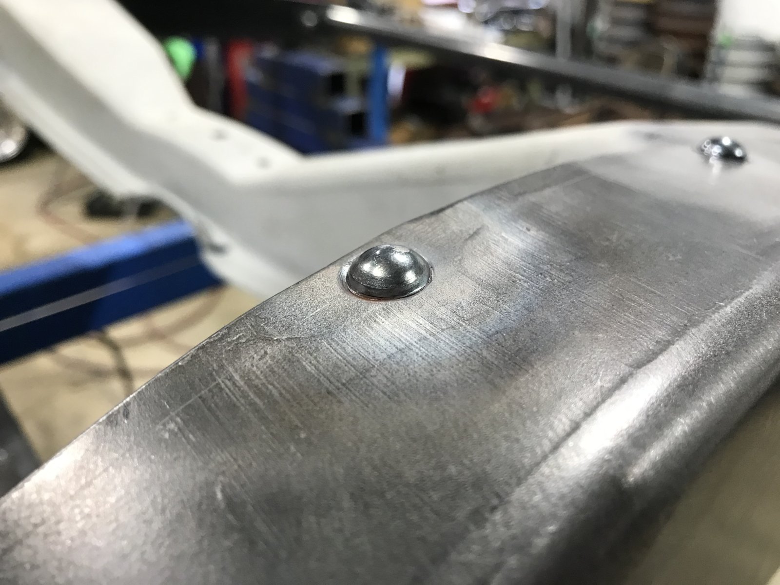

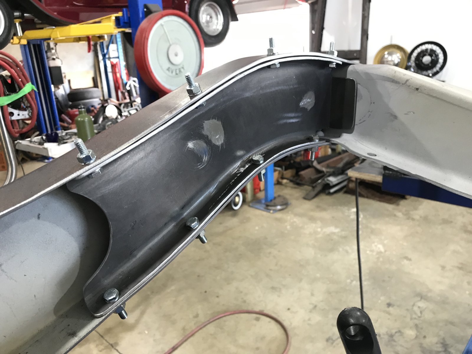

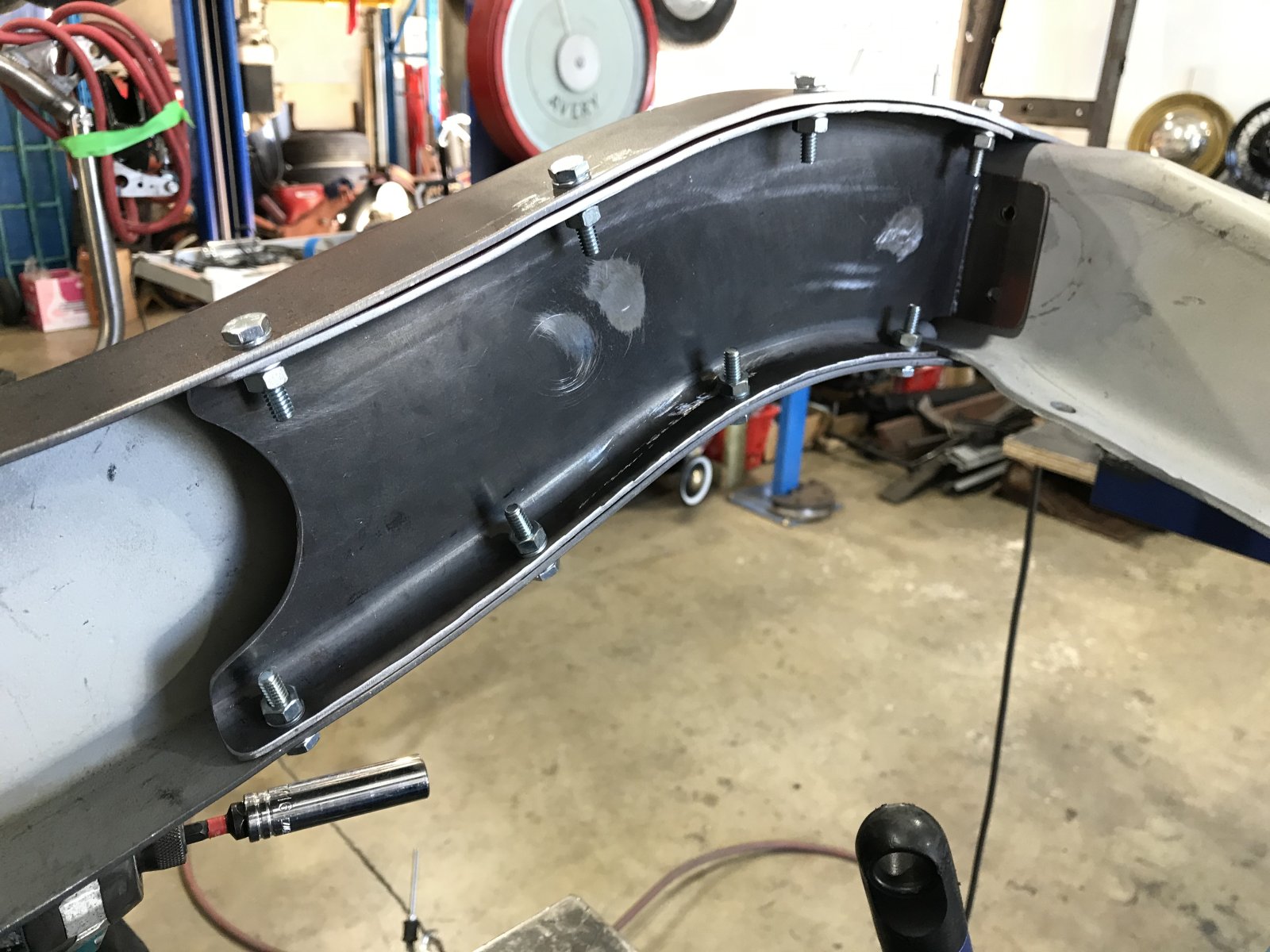

  4. Well got them cleaned primed and bolted it, tried 4 top rivets on one side with my new buck and seemed to work really well. More pictures tomorrow.
    B6FC59C3-F698-4D27-A18A-B08A22172F45.jpeg 5DDBBBA6-DBAB-4324-86EE-FBC4B7105E69.jpeg 6F82855C-5FB7-4C0C-9EFF-1A33068389B0.jpeg 48F7F206-9544-4943-864A-4342641073A8.jpeg CCA4E5E9-87FE-4EB1-932D-5F0C7DFF45DE.jpeg 321BA683-8D0E-43D3-BF65-79A4FBD1B9E1.jpeg 0EC771EA-9AB6-4D03-93C0-08AC1A1817B8.jpeg

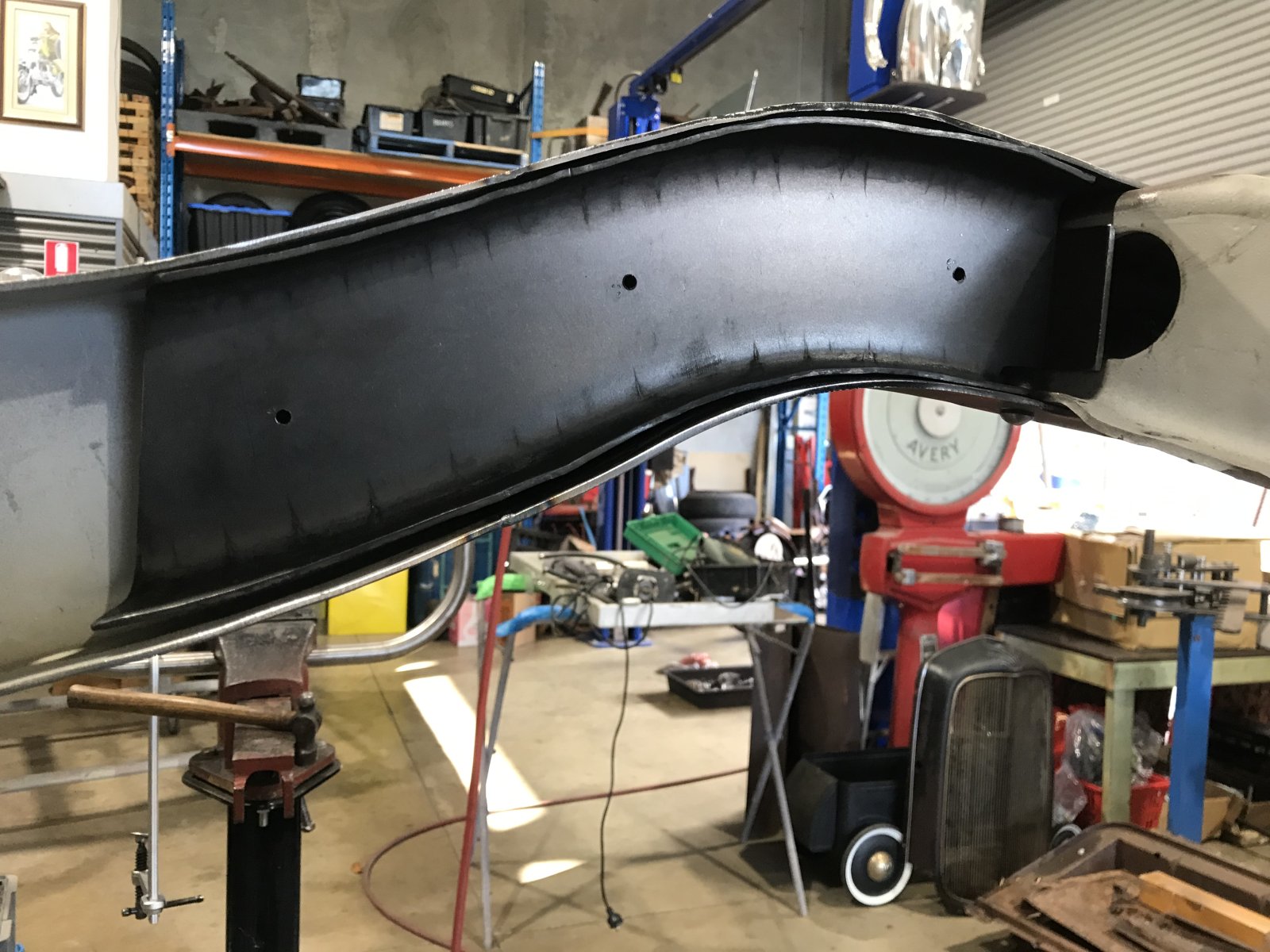

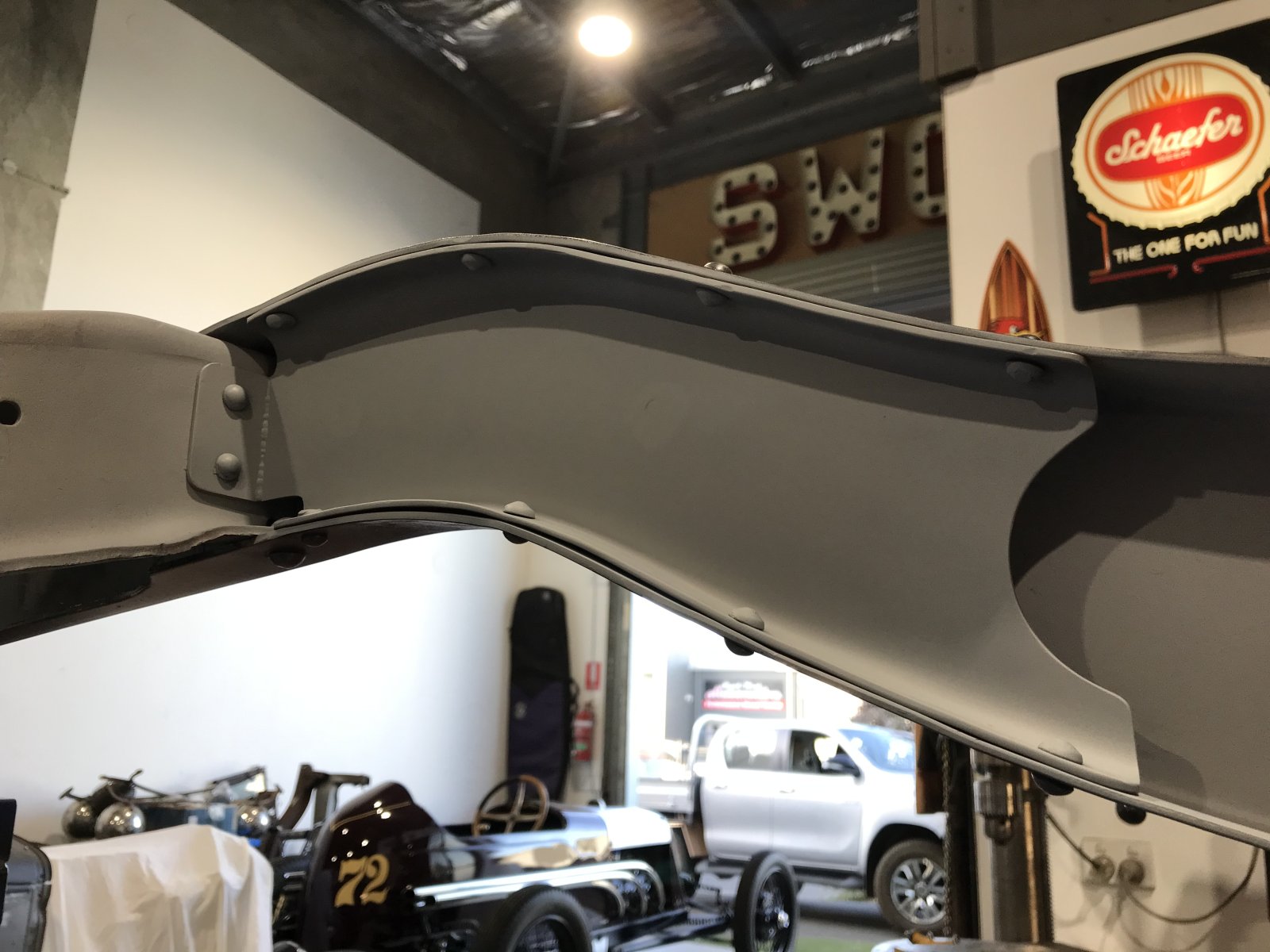

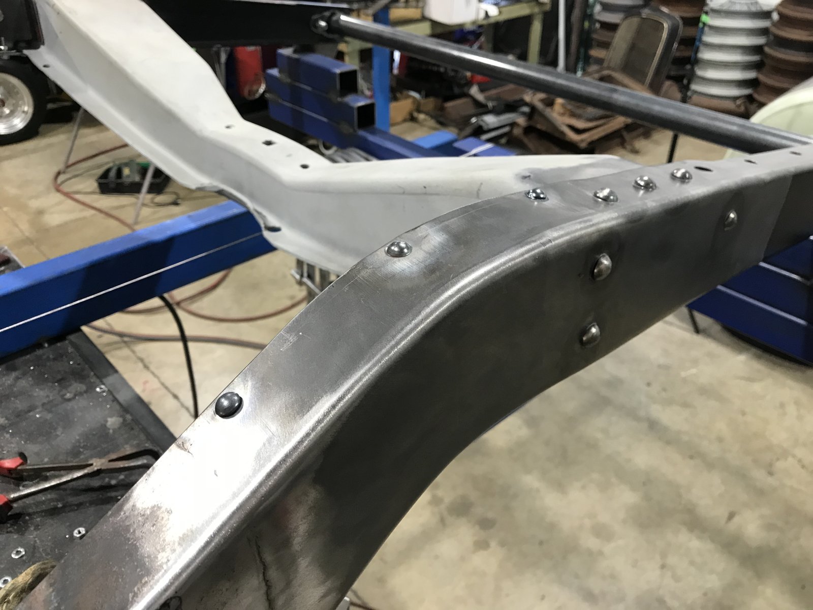

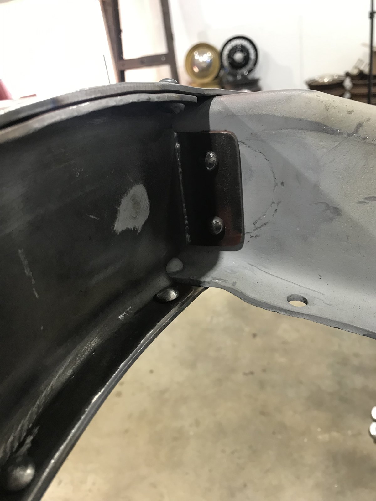

  5. Got the boxing plates riveted into place, having a heavy buck and three blokes to help it went very well and they pulled tight and even.
    Ch***is is ready to come out of the jig and start to get the rear end, motor and trans mocked up.
    7E7500AE-DCD5-4236-895B-7CB99935B4D6.jpeg 0C194A07-5547-4A0E-8B30-030059EC6BC9.jpeg

    Nice job on those inner boxing plates!

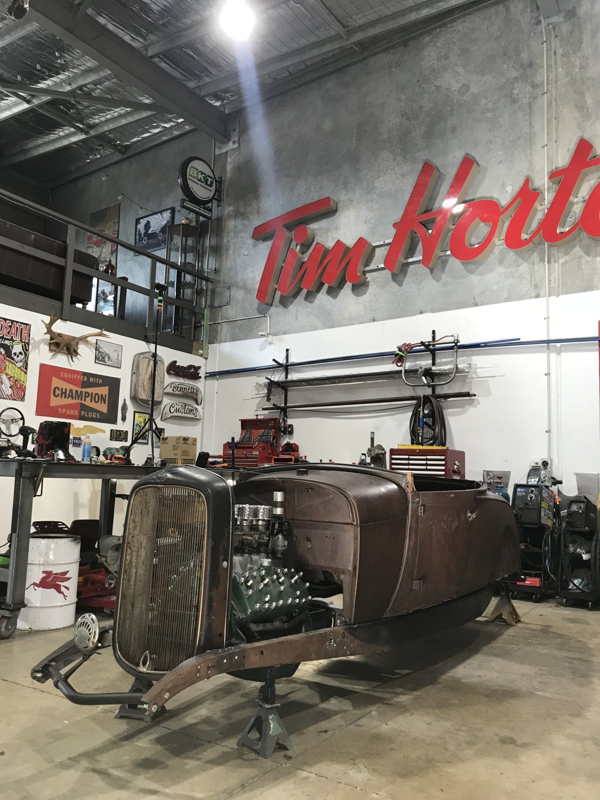

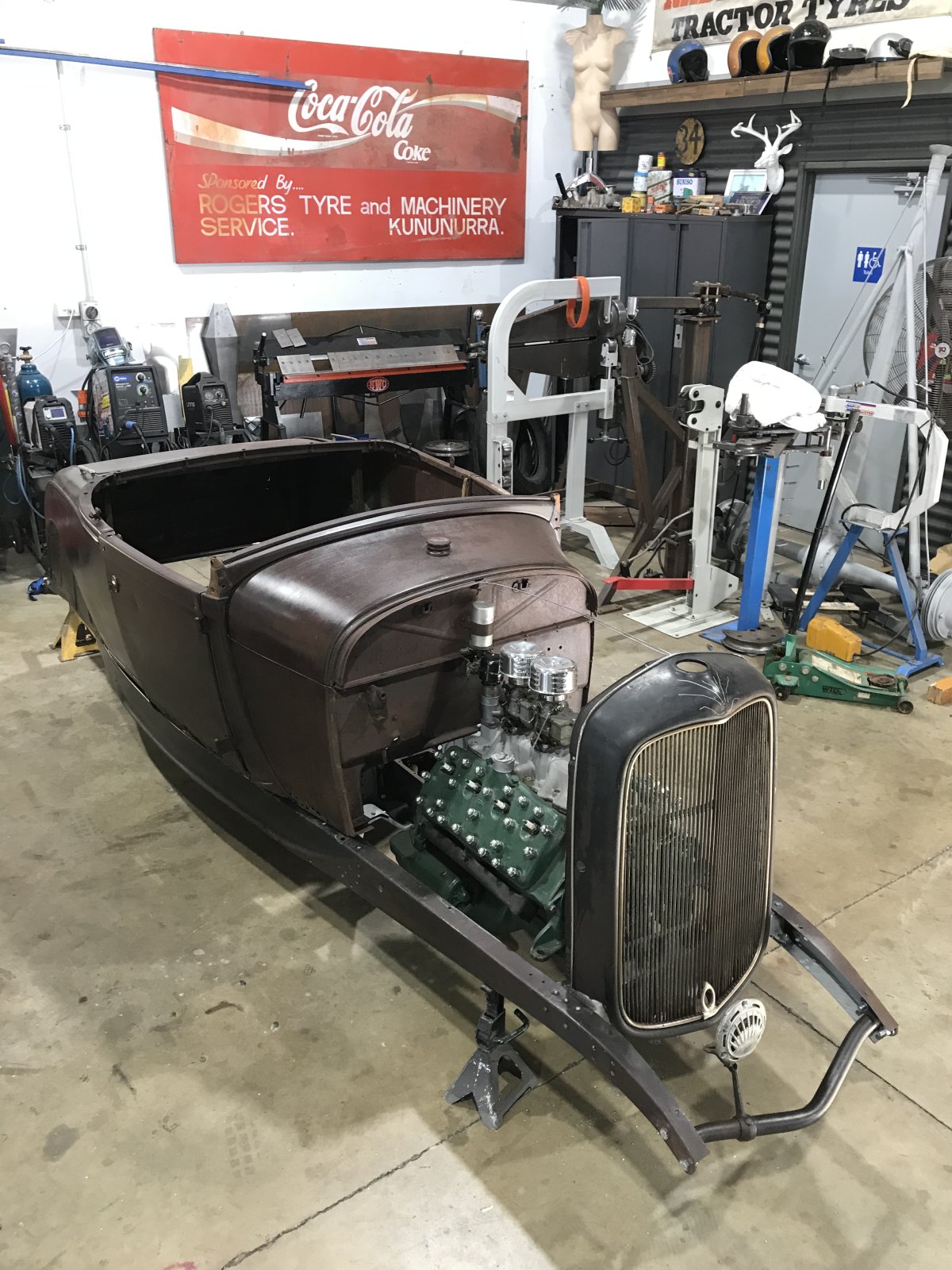

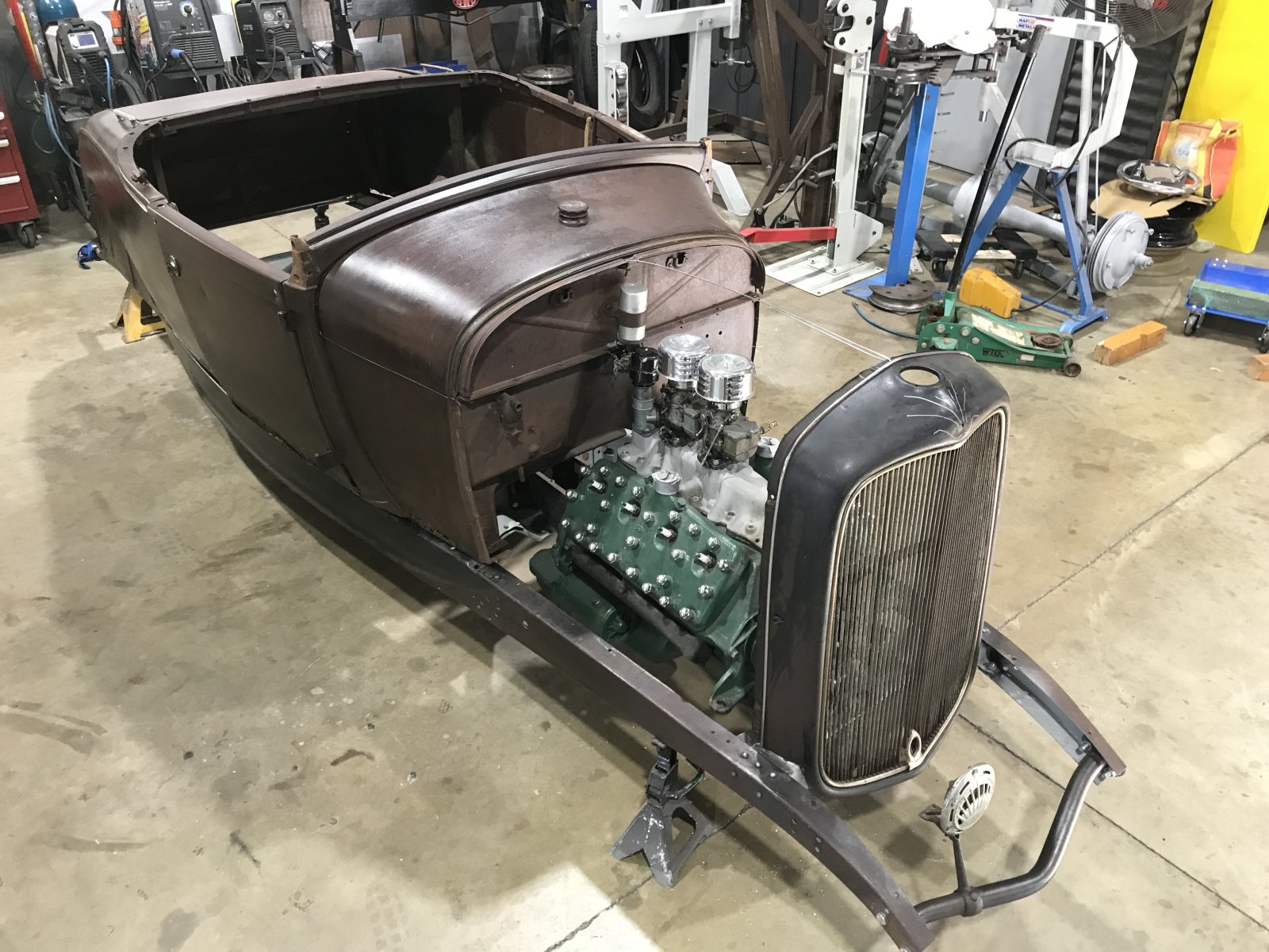

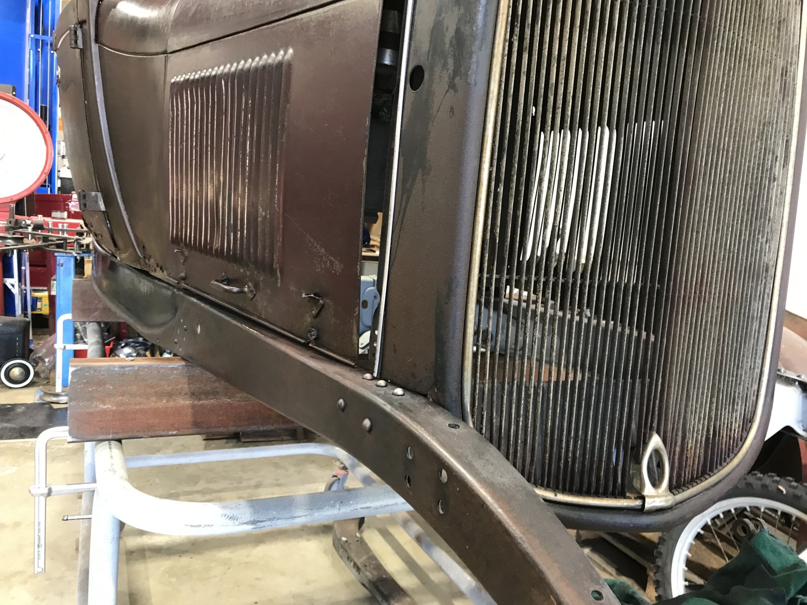

  11. Rolled it out side, had a look, still needs the rear frame horns cut so the body sits better, sneak peak with 32 grill. Huddy seems to like it! 293EB9AC-9985-4ED5-A58C-9F3343FD06C1.jpeg E91E4405-CA90-4604-B59E-F5AC7EE30F58.jpeg 2C3107A1-054D-4C55-8B4A-8F8B08CE5321.jpeg B4B01DDC-BD9E-438F-BF0B-829EE84E59F9.jpeg

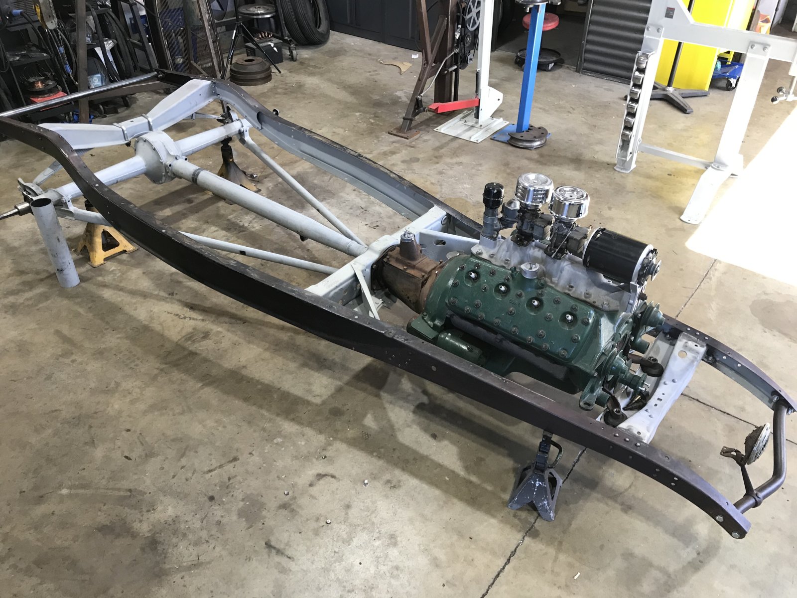

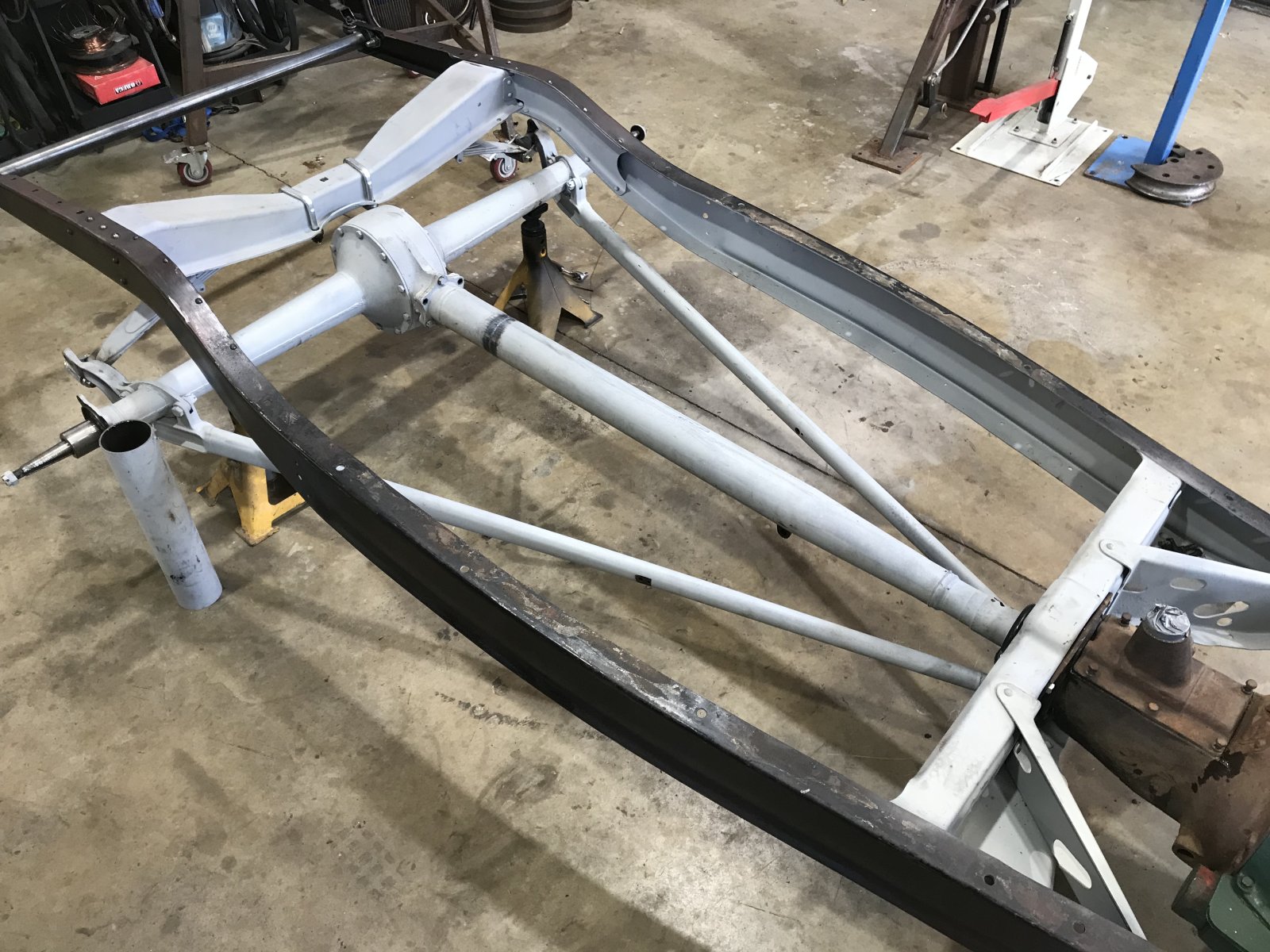

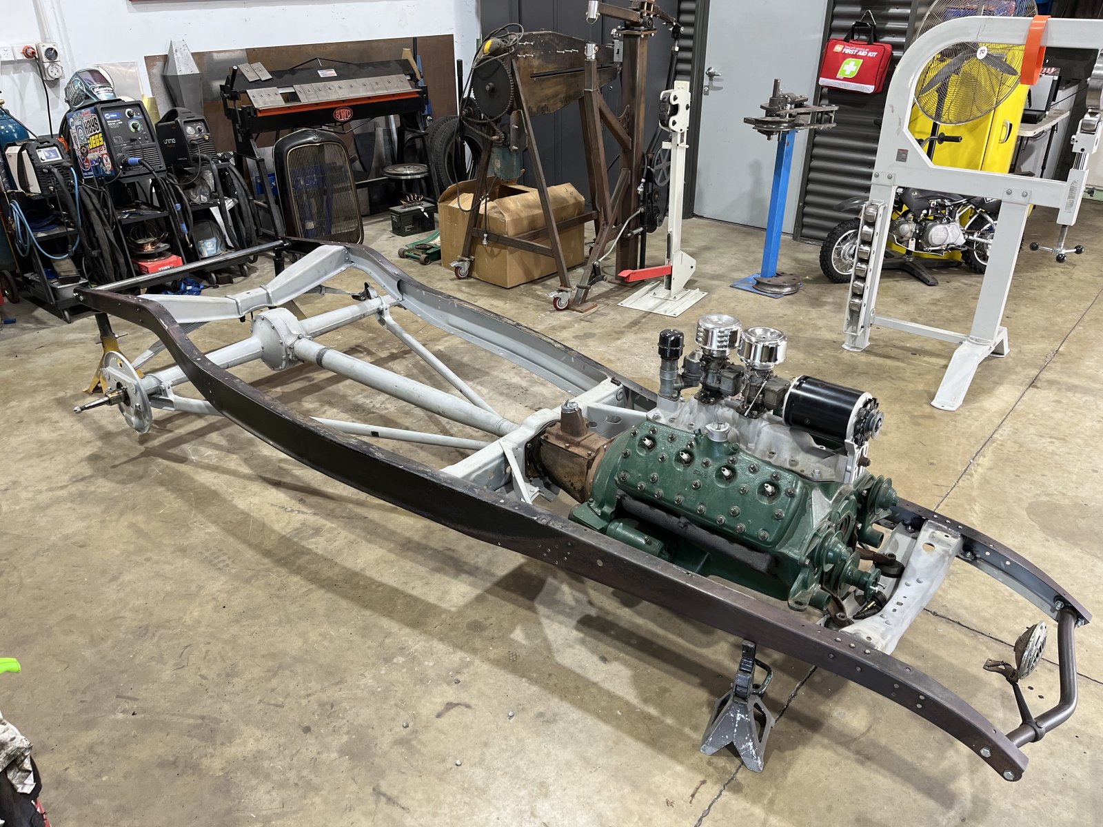

  12. Frames on stands, motor and trans are in mock up in order to get the 36 rear end fitted. I will be modifying the leaf spring to fit and shortening the torque tube. BDA6D413-0813-49CB-A839-DC25A18ECB31.jpeg CD82C9D7-6410-494E-9958-388AF8886CE5.jpeg 5D7F579E-7245-48FF-BBB1-ED0681841054.jpeg BFB14B17-D643-4F14-8633-6FB4DB69DE5F.jpeg E963A53B-C063-4A9C-94D3-016147BF84D0.jpeg

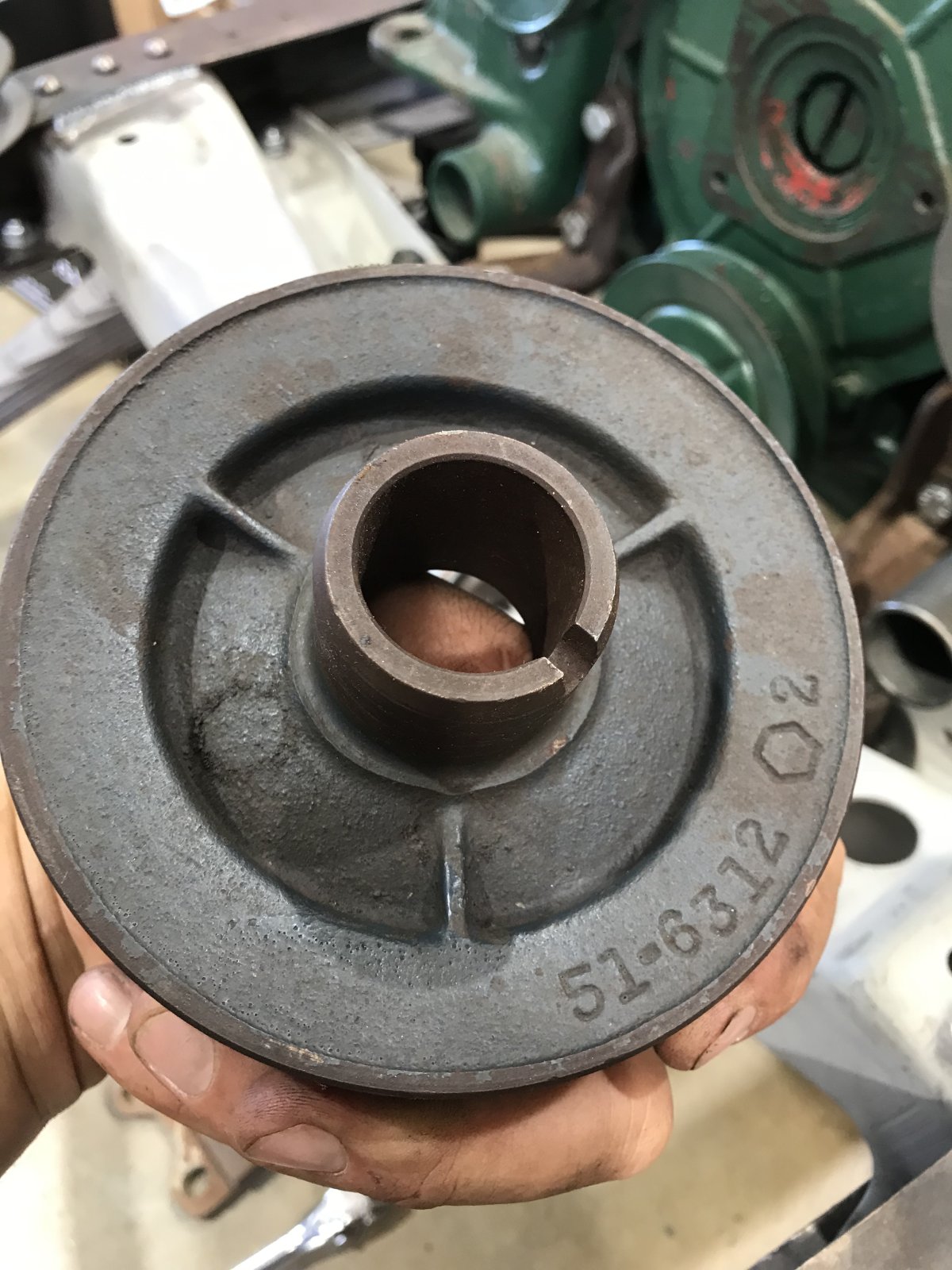

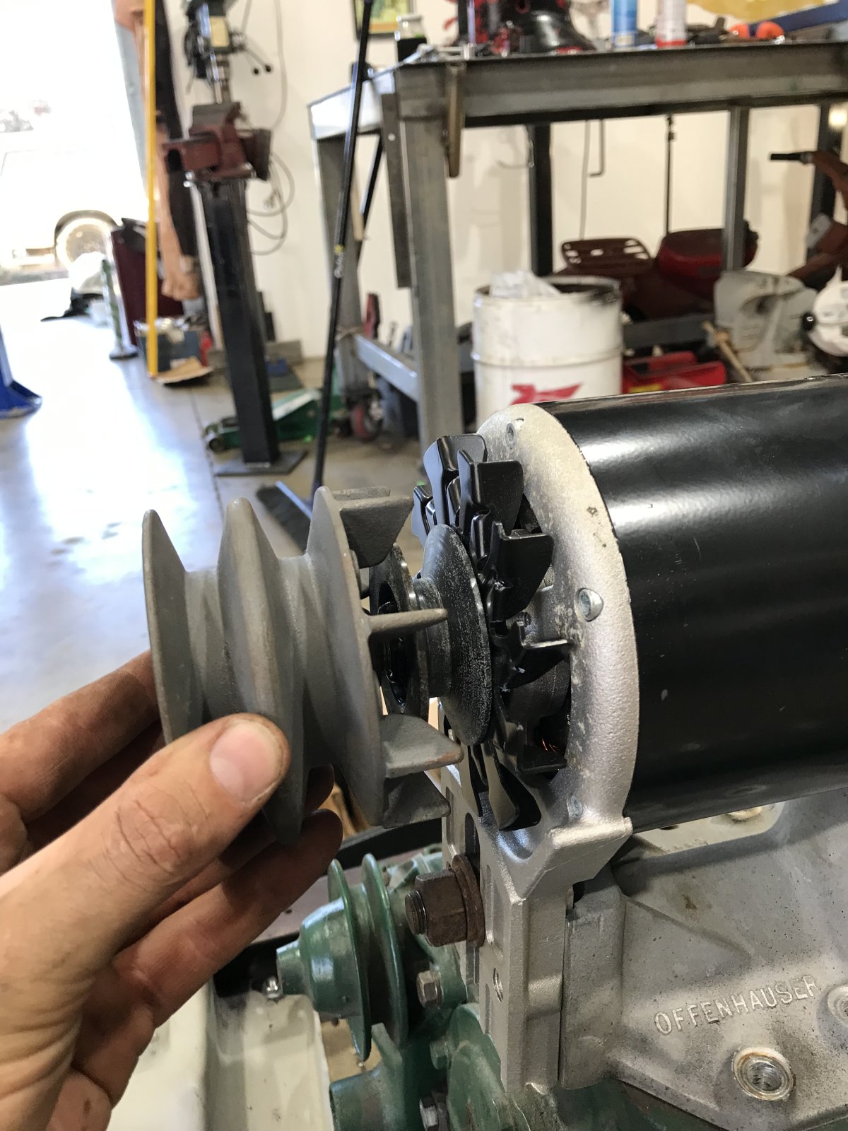

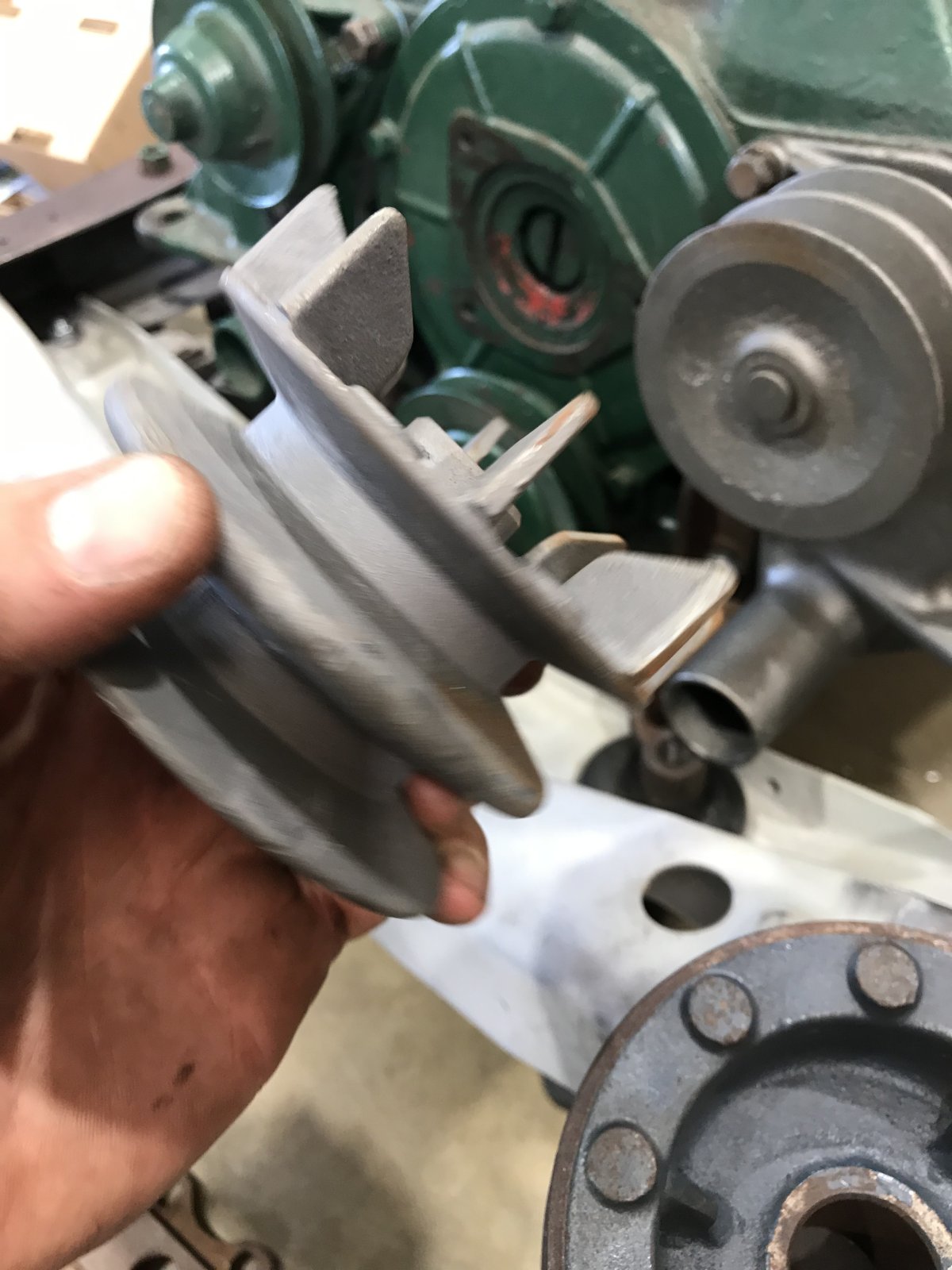

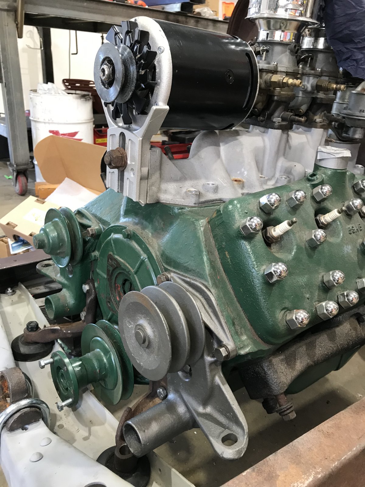

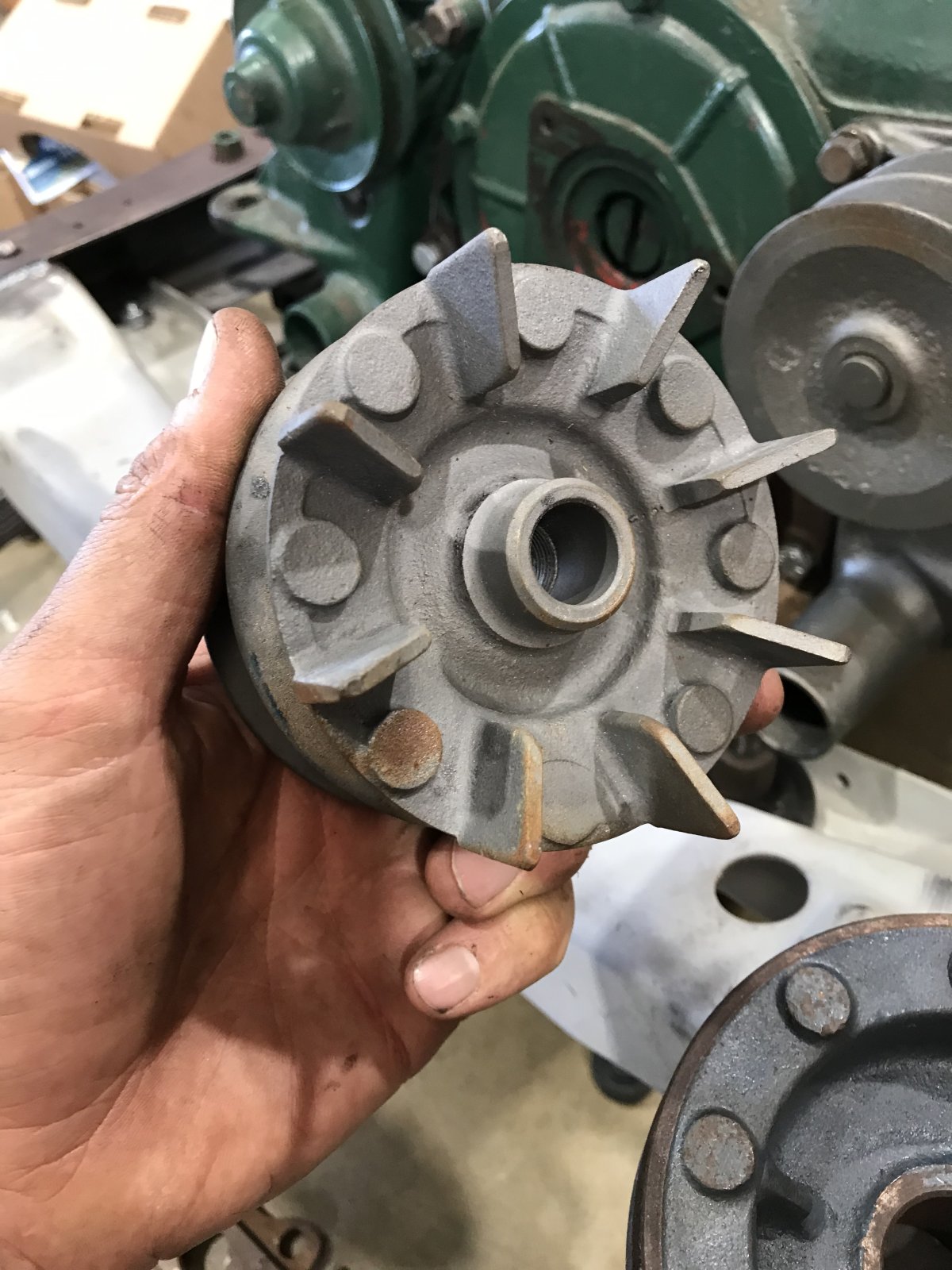

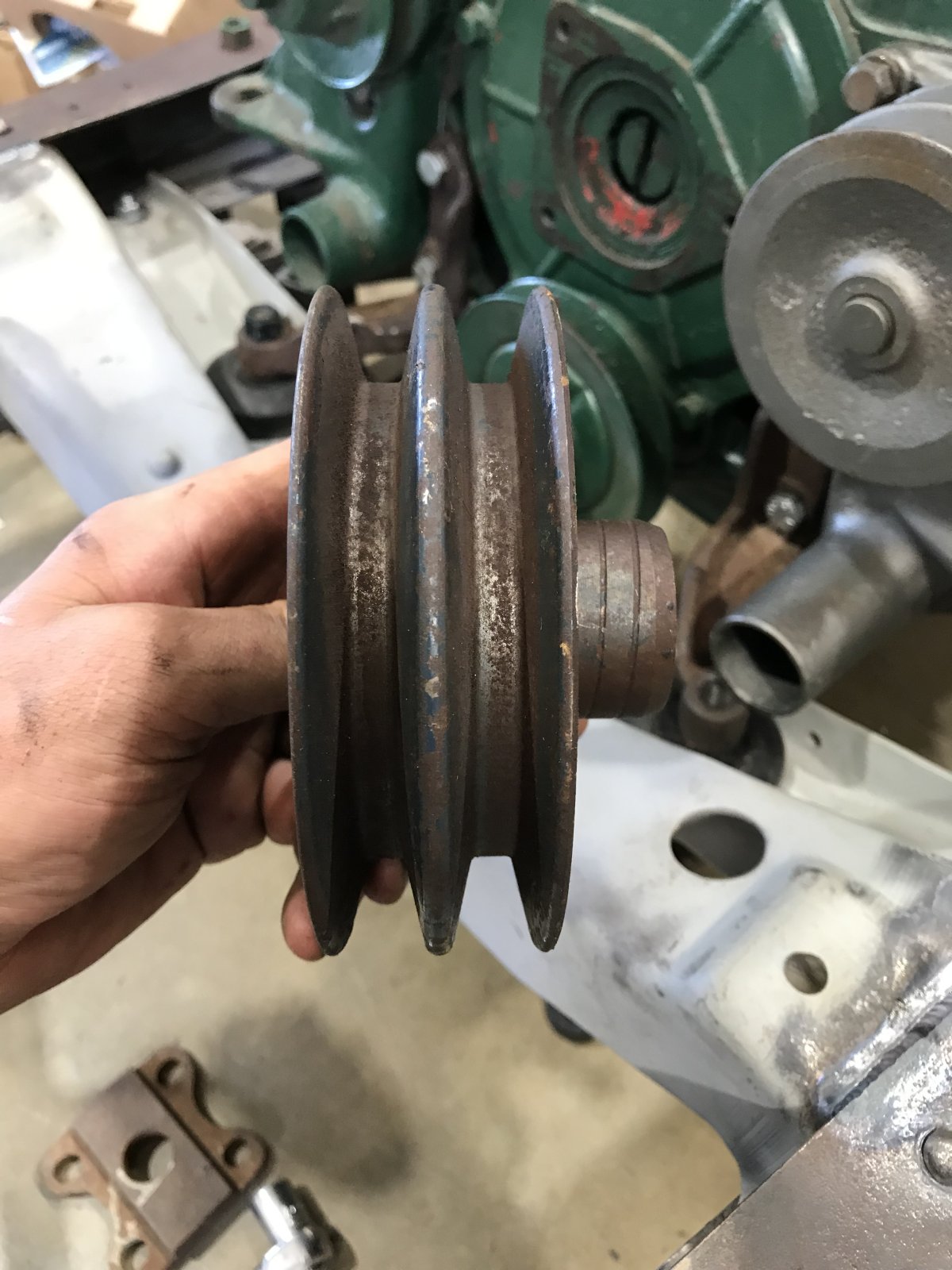

  13. Was thinking about running a set of twin pulley pumps, there would have to be some modifications but like the look anyone familiar with this?

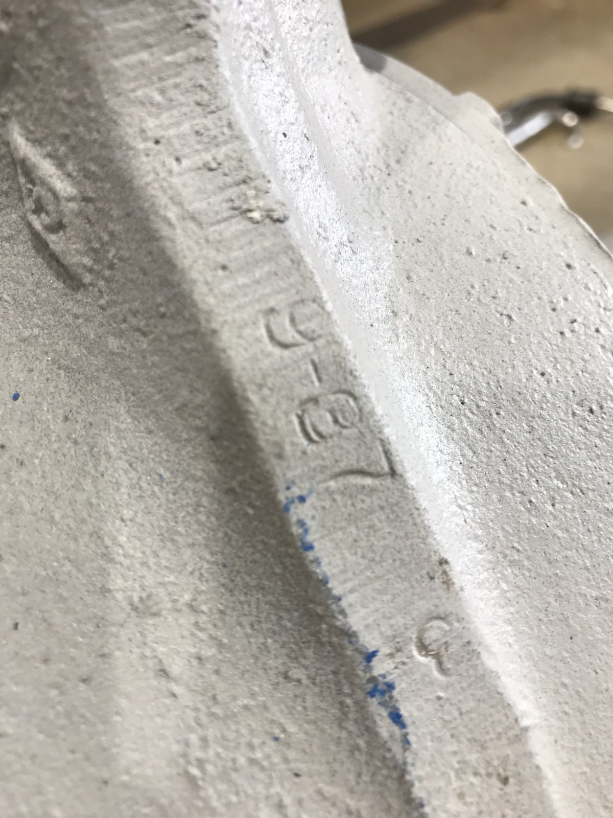

    Also pulled a head off and realized it’s factory relieved? 6B87C280-C147-4F55-94C8-D01409407778.jpeg 4EC92C26-515F-41AF-9E55-2CB318854AEB.jpeg 87874DFC-CE78-4A6C-849D-3E1F68ECD1B2.jpeg 0399290F-FE04-43DF-80B2-81B5AFD67E8E.jpeg 4C84FE2B-B5EB-435E-8316-2788C63231A7.jpeg CB26343B-1A16-47AF-A93E-A9D7B25AD1F7.jpeg 67AC2340-3806-4D6D-BAC3-95FA39261698.jpeg DD7642AE-E89E-4C40-B482-D4EDE11A8222.jpeg

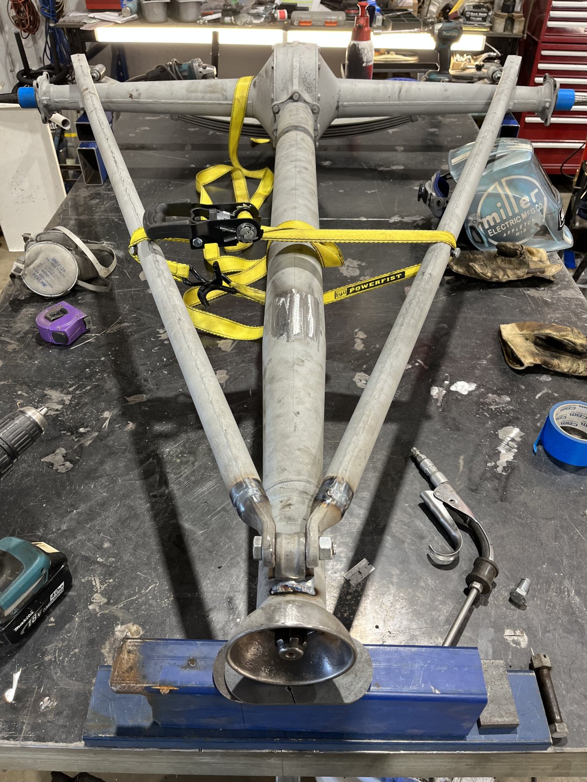

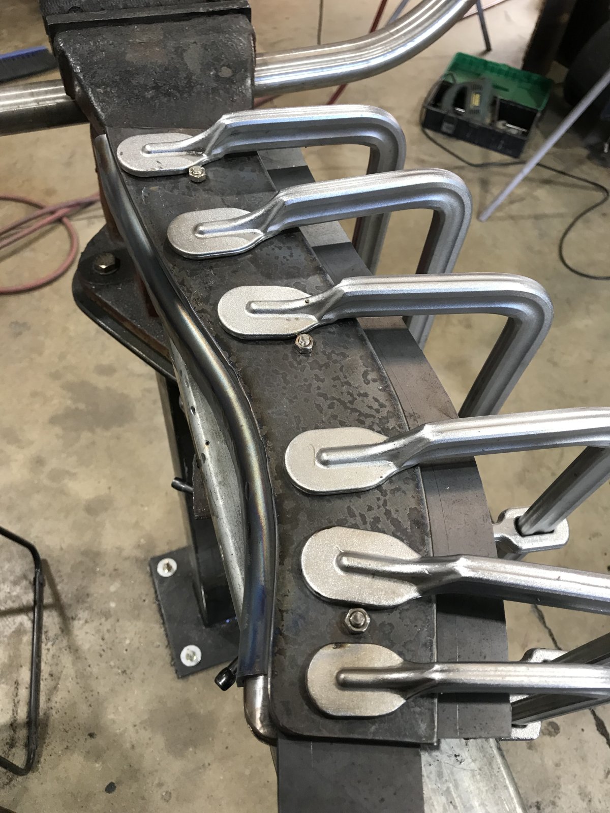

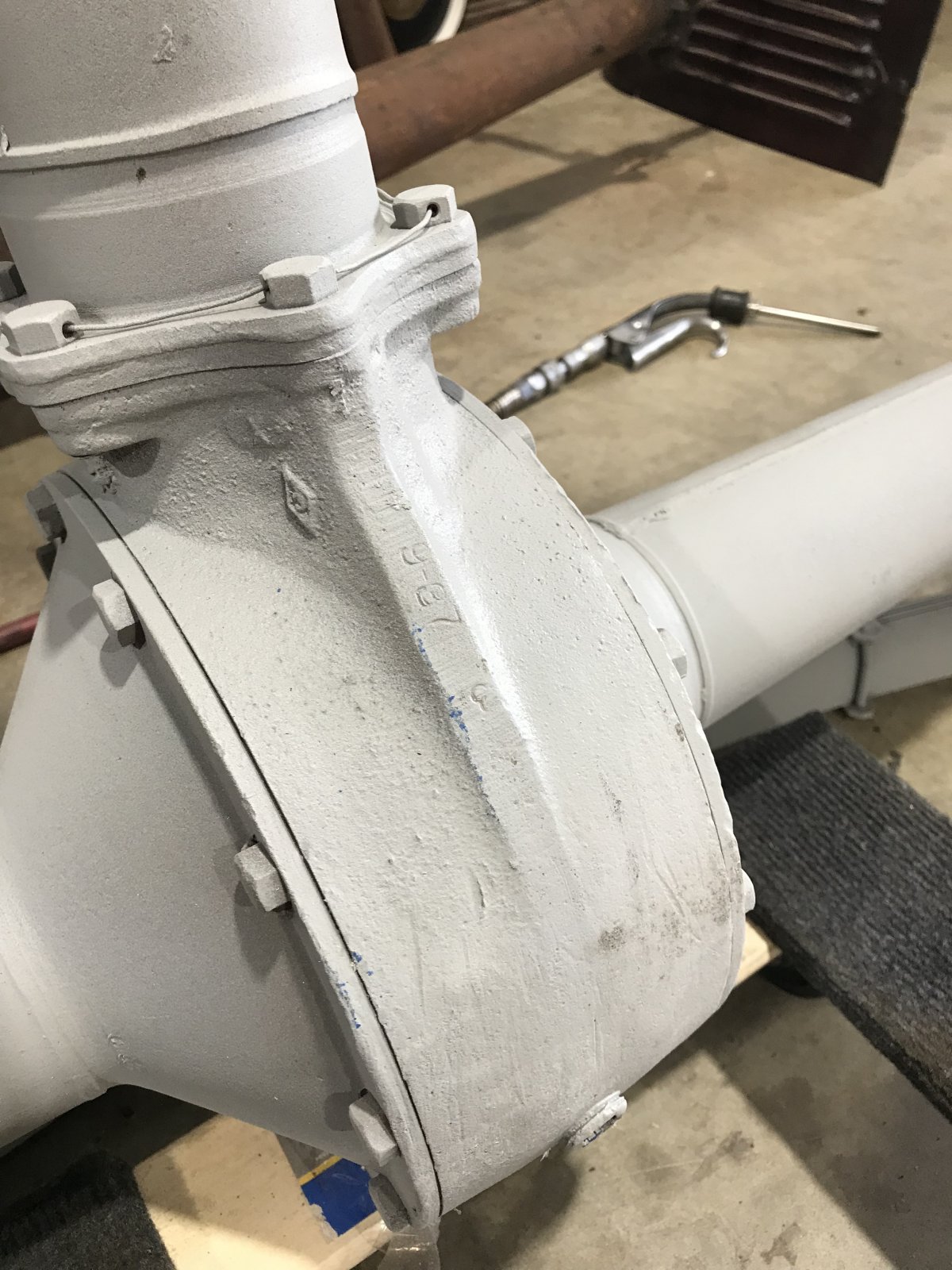

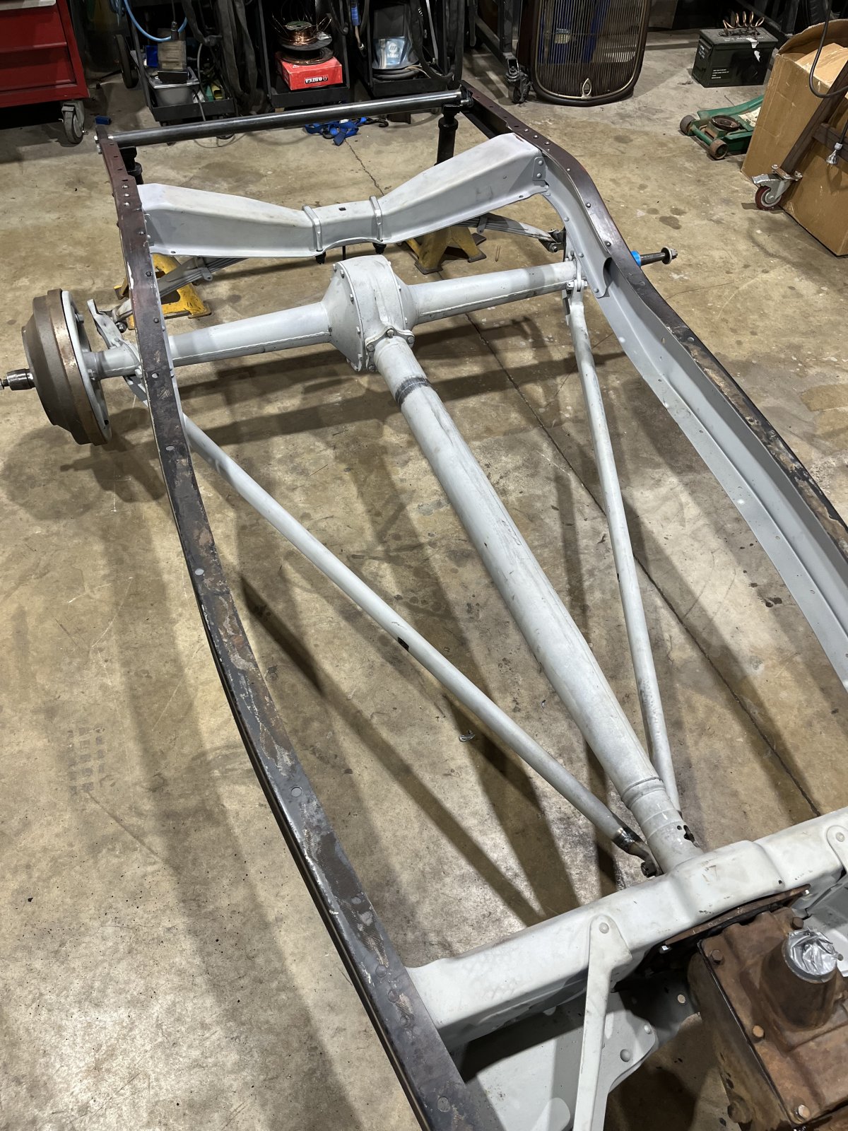

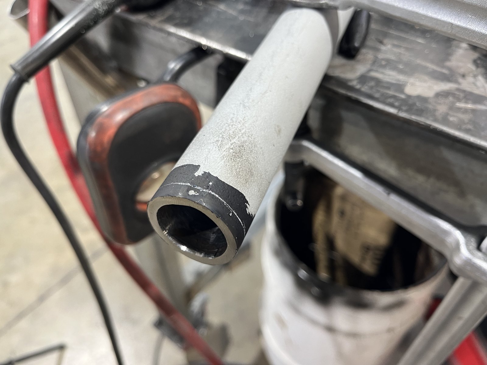

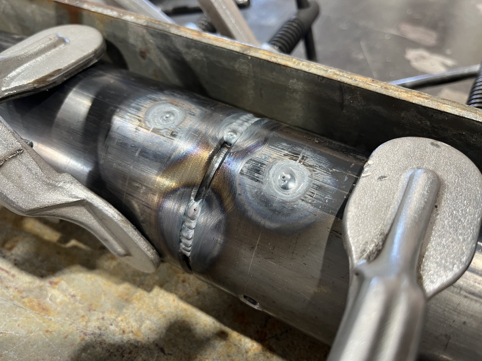

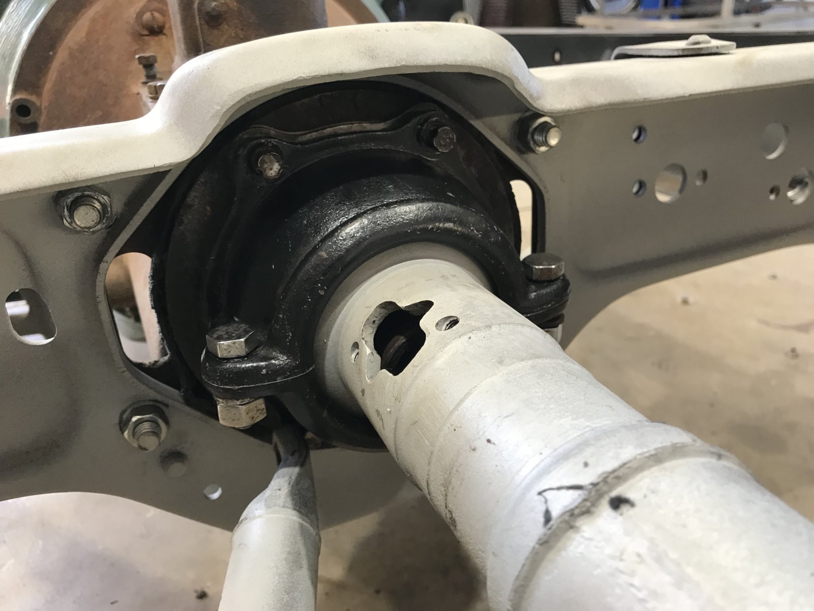

  16. ‘36 leaf spring relieved for the crossmember. Torque tube shortened and fitted, next is radious rods and drive shaft. Baking plates drums etc.

    Watched the vid yesterday, didn't you get a spring spreader with all that stuff from Brendan?
    Looking good!
    Stogy likes this.
  18. Probably the one thing he kept hahah
    Stogy and mgermca like this.

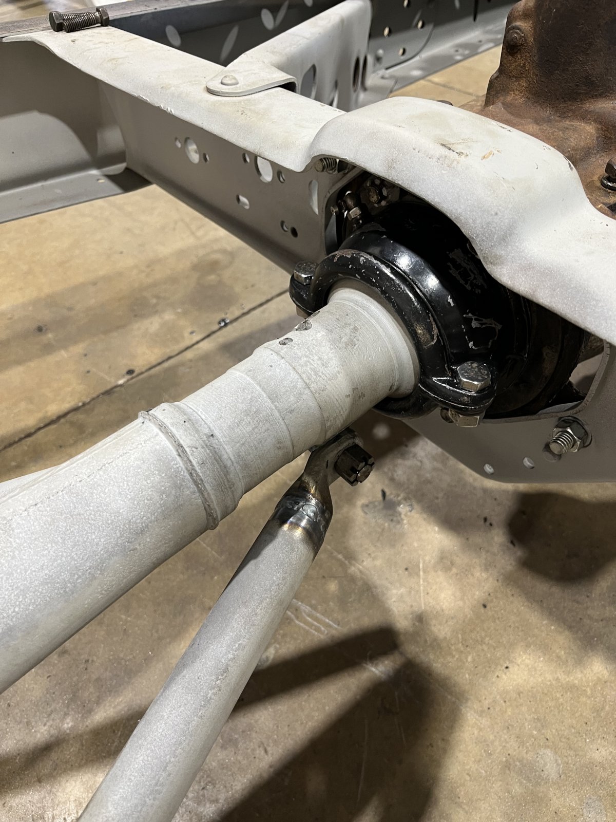

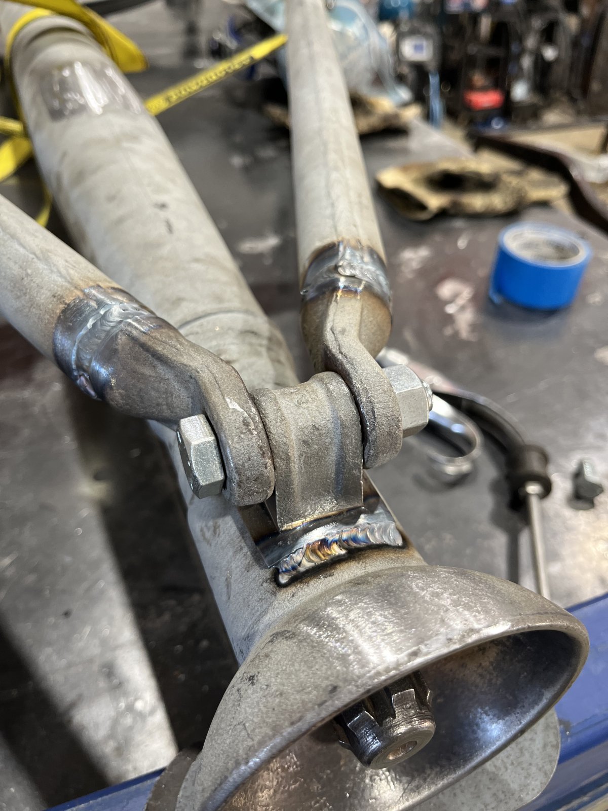

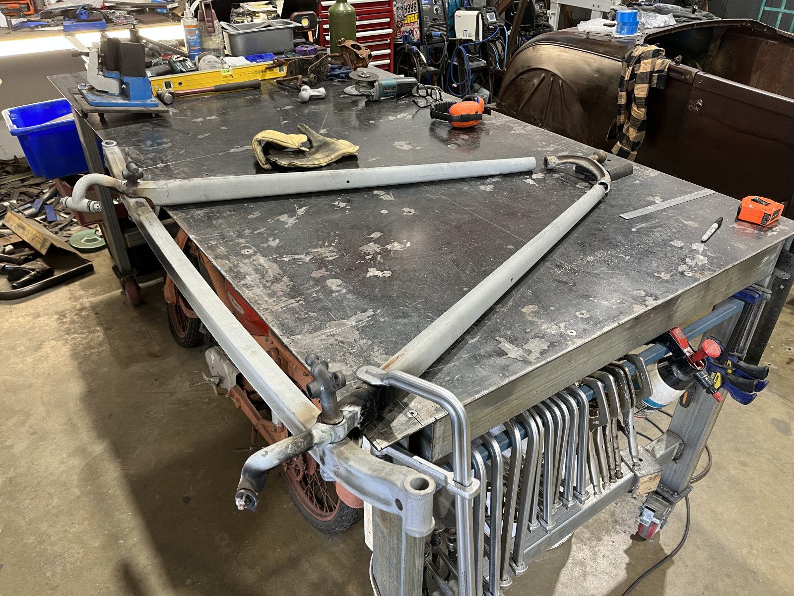

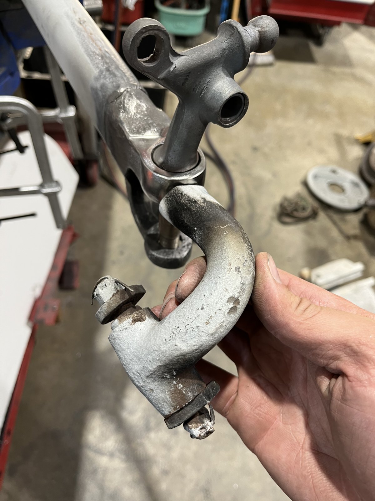

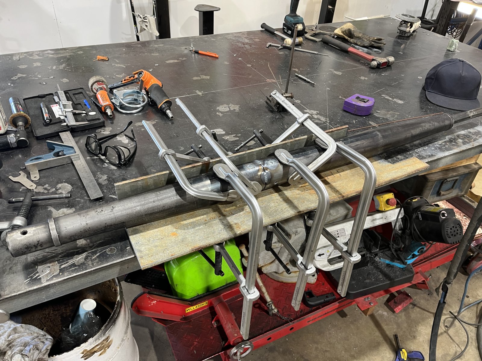

  19. Managed to get the drive shaft shortened and relocated the radius rod mount and shortened the rods to suit. Will it all work? Who knows haha 9E3704E0-A646-4E1E-ACFB-680CE945DC8D.jpeg A9E2491D-D412-429C-9FEB-D97125162296.jpeg 75399F86-DF71-4473-AB07-FC5878A77F2F.jpeg 7C70F7CF-49F8-4C05-8F74-0A76847EBF31.jpeg 6DBF85E4-479D-4645-A76D-64565AEEE4A2.jpeg CB454B0C-38F8-4A3D-934C-8221732857F5.jpeg AB0A7823-522E-4BE4-A3C2-48B1A8C5AA5B.jpeg

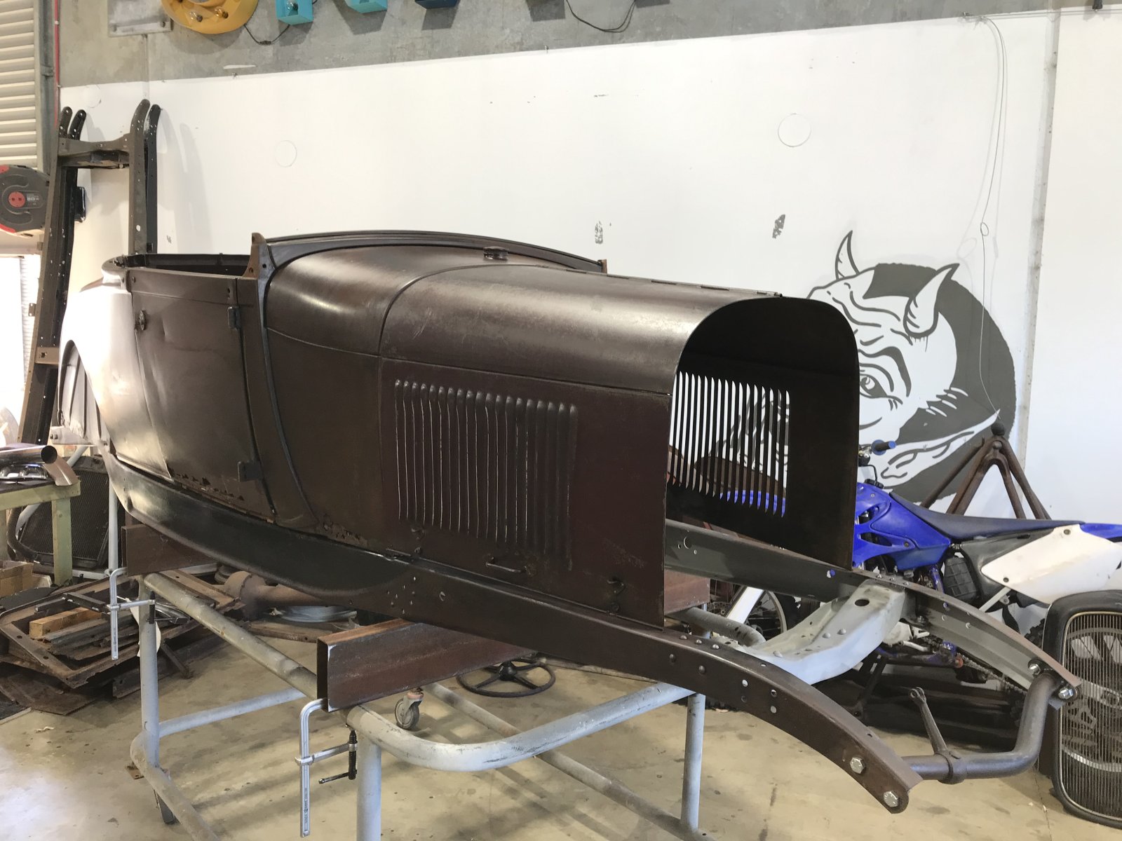

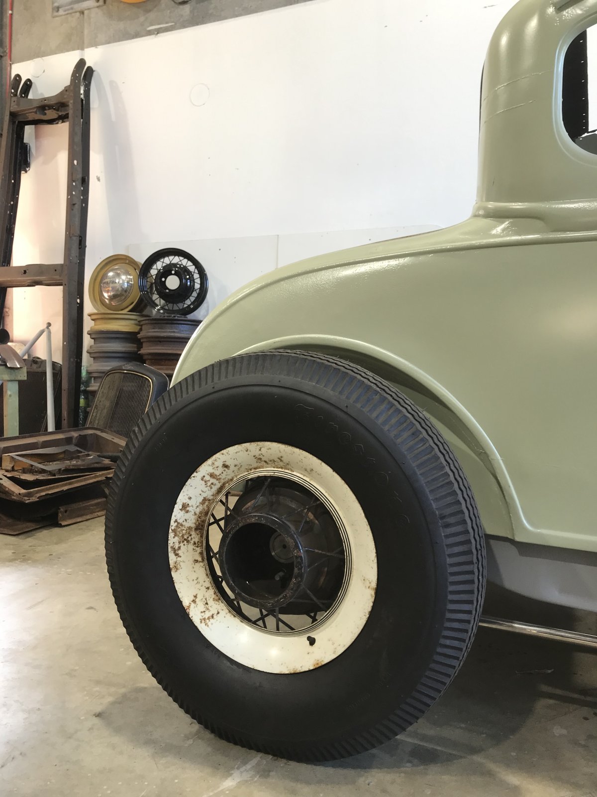

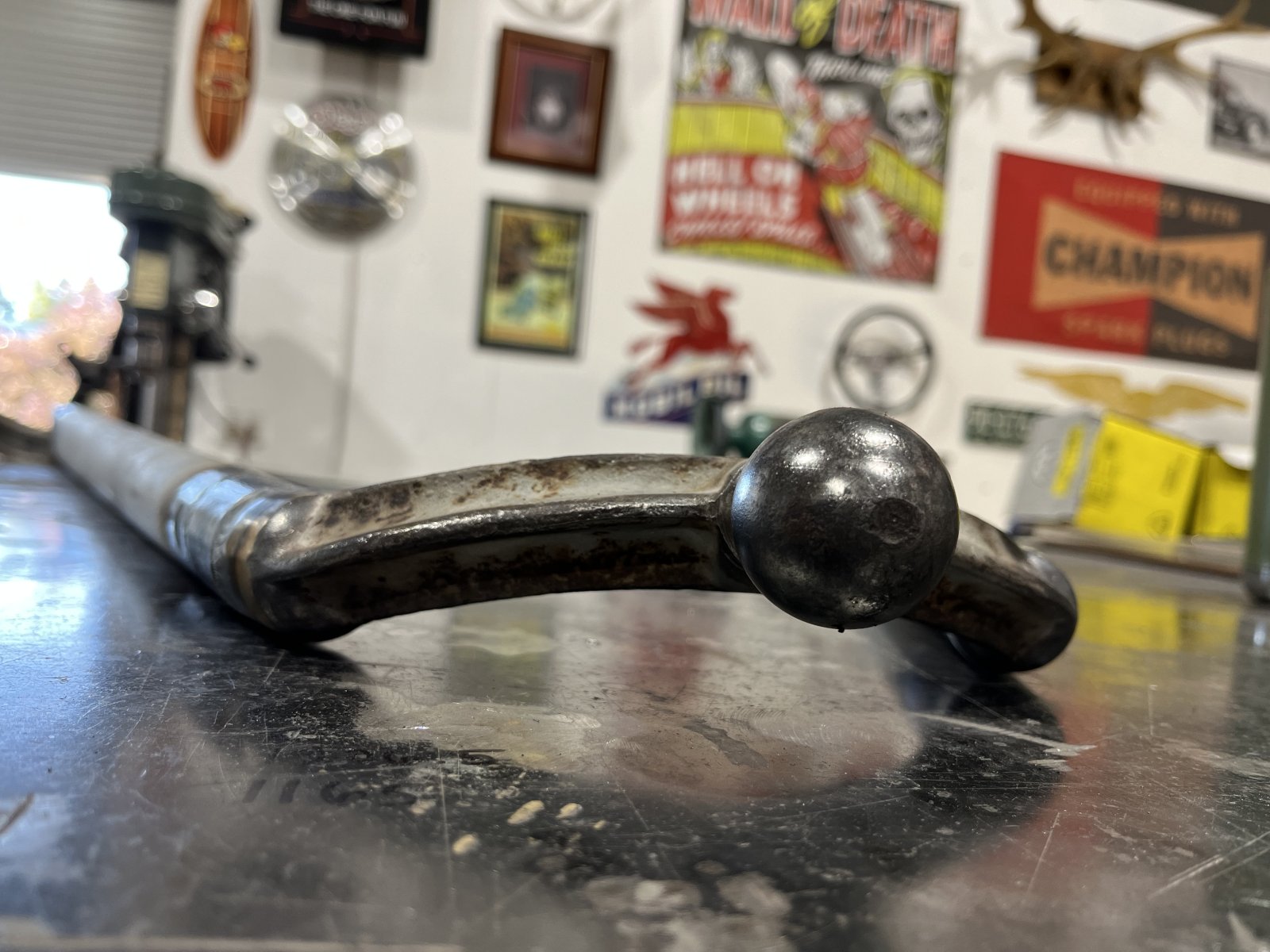

  21. Rear end is under and body on for mock up.

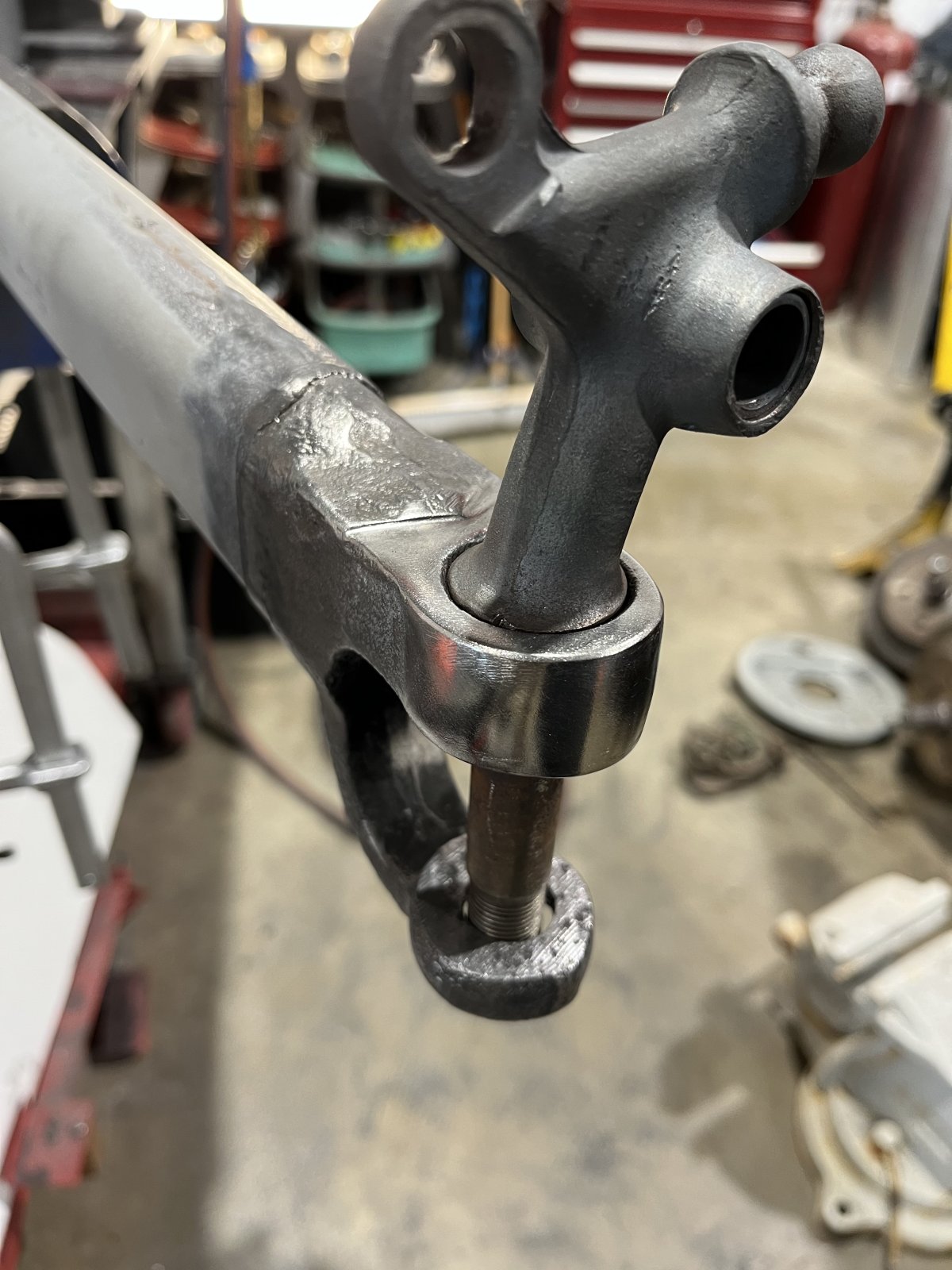

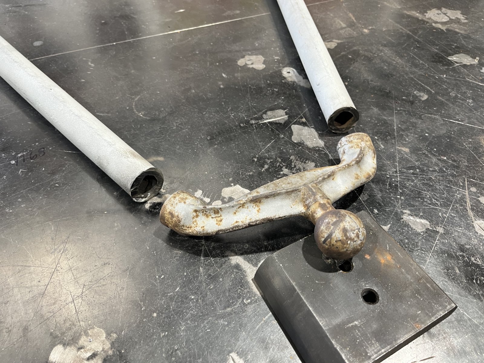

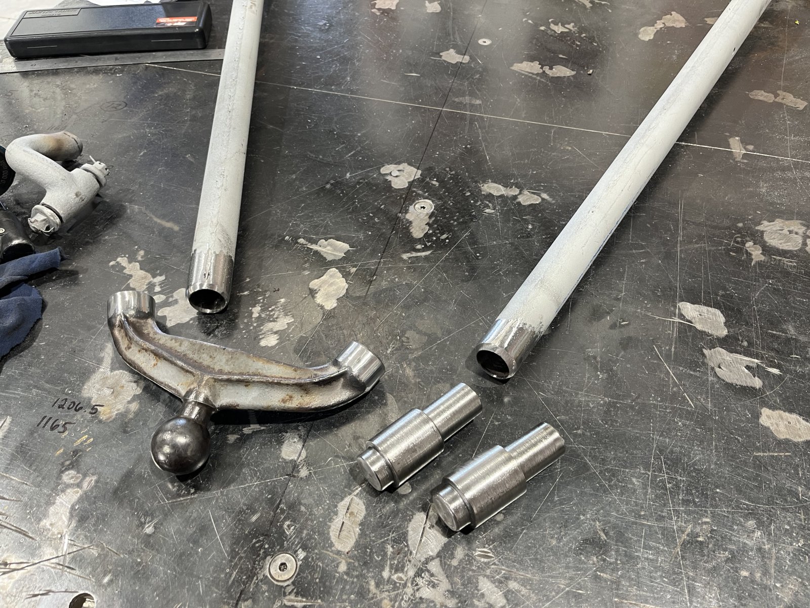

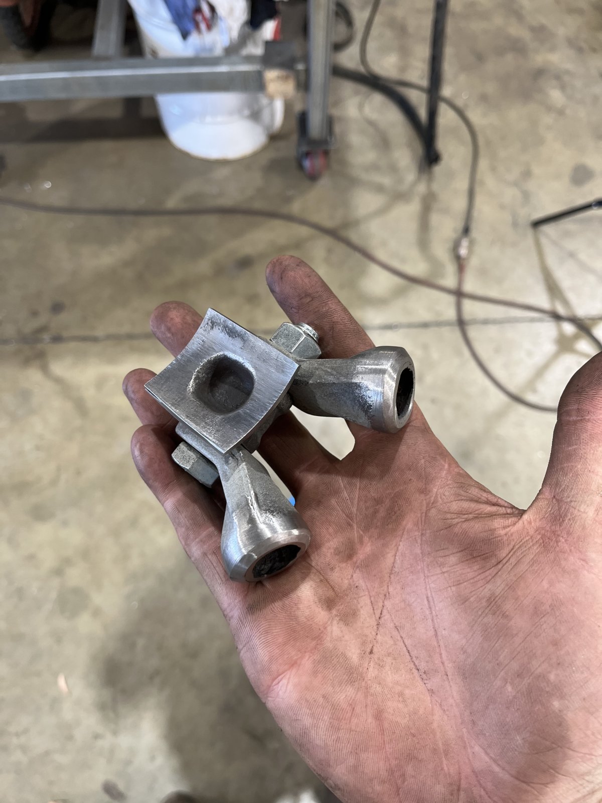

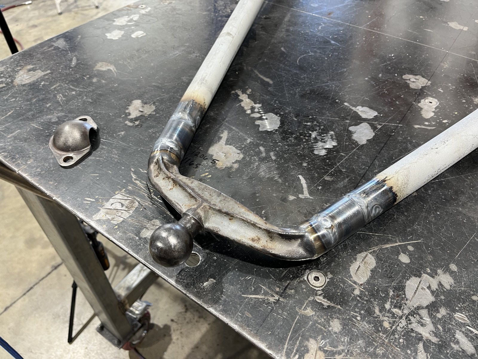

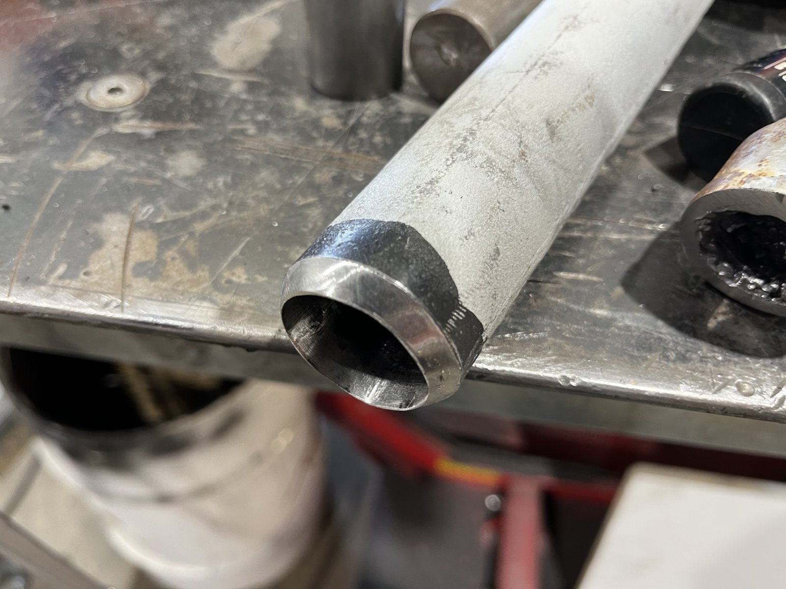

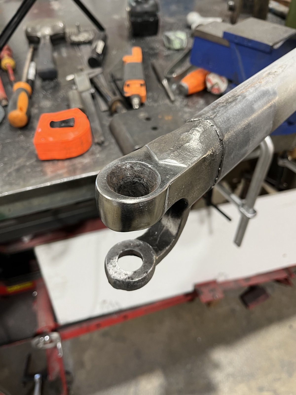

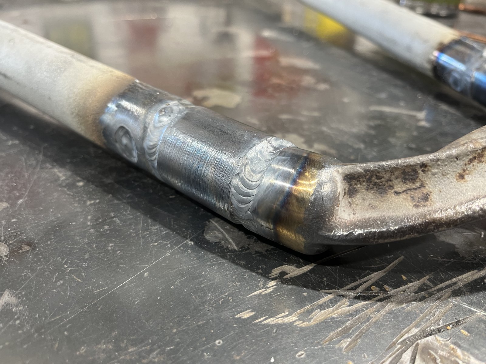

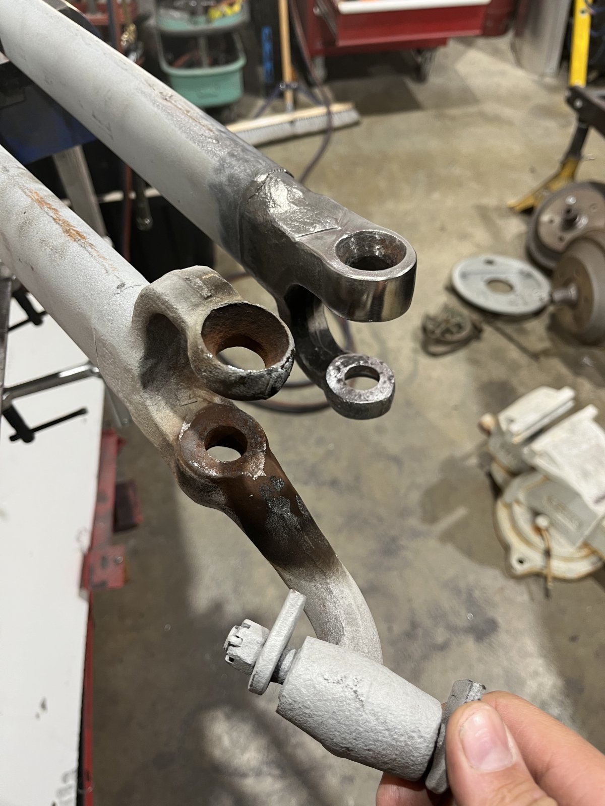

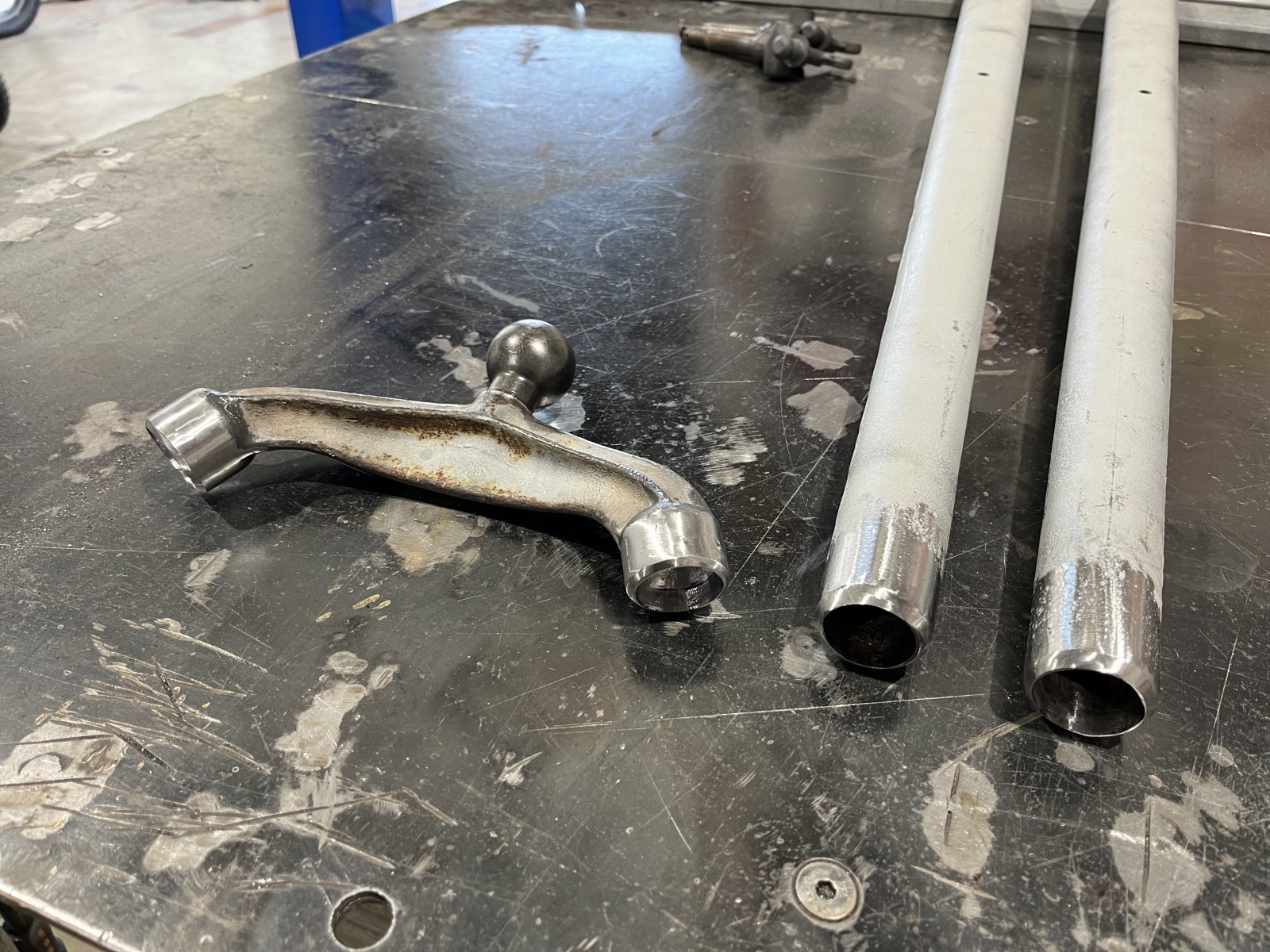

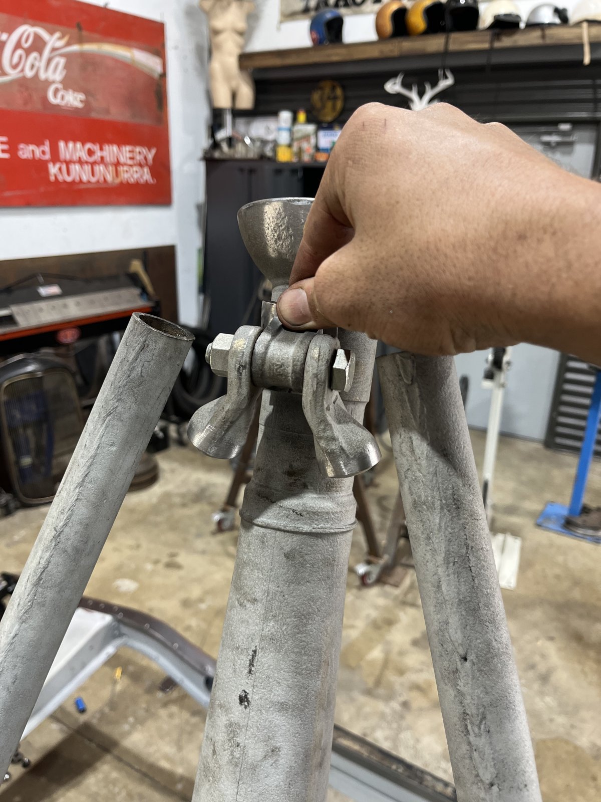

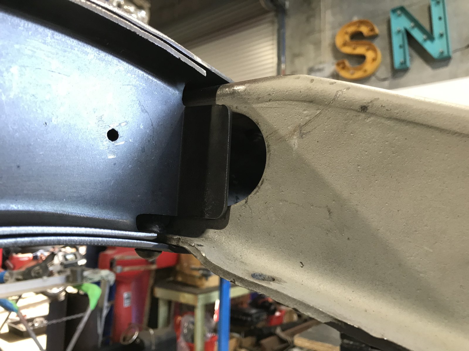

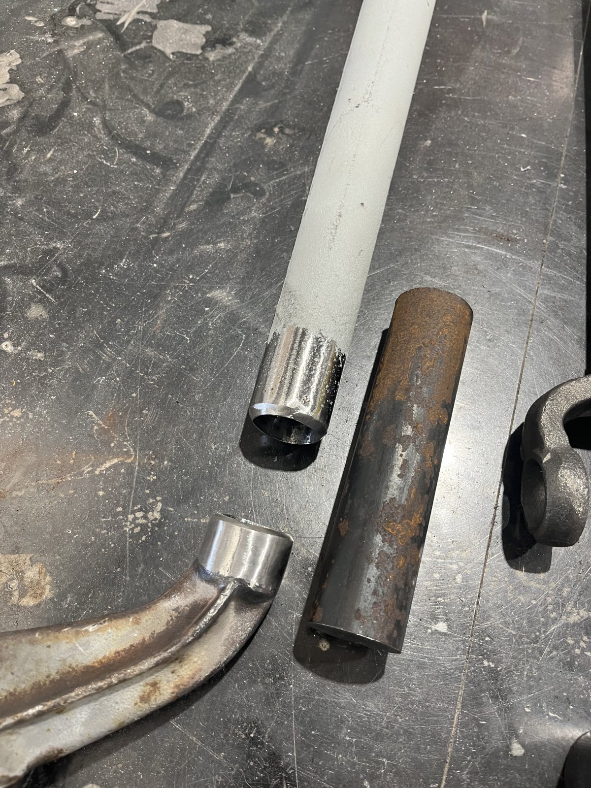

    Below I don’t have a 32 stock front wish bone or a nice 33/34. What I have to use is a 36 front bone and a model a rear ball. I’ve started cutting them and plan to make a slug the will go inside both and extend 40mm to get me to the desired stock 32 length. Will this work? No idea- I will try and see! EDC66047-59EF-4A92-A001-821034889A4B.jpeg 007F8AC9-10EA-4AC7-9216-D082A6918A65.jpeg C8AB4386-9145-49E9-B98C-50DDD5826FD8.jpeg F90244AA-209E-49AC-ABB1-35E4E9106747.jpeg 9117432E-EE50-4E32-BCB1-5AFFE06268AD.jpeg EEF50473-76A8-4F2B-B17C-2653280C3FB0.jpeg DB03A8B2-3FD6-44E2-AECD-17AF0890BAC2.jpeg CCDE8580-8968-40E3-8679-79F2D27A9193.jpeg E8CE5446-F20B-4523-8865-E8FE723AFFC8.jpeg FF77AF72-C347-4EA6-B379-E4734DD4D56F.jpeg D89AEE80-0FA1-4F7A-B832-9D2014C653D4.jpeg

  22. alchemy
    Joined: Sep 27, 2002
    Posts: 22,674
    alchemy
    The downward arch of the A yoke will give you more clearance to the oil pan than a 32 could.
    Stogy, jordabennett and The37Kid like this.
  23. The37Kid
    Joined: Apr 30, 2004
    Posts: 32,493
    The37Kid

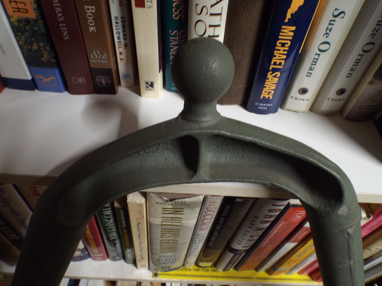

    Wonder if all the angles are the same of differ with an early Model A wishbone? I don't have a later on to compare this one to. DSCF7709.JPG Bob
    Stogy likes this.

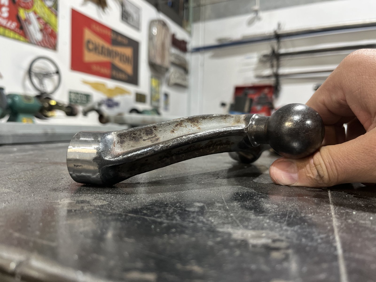

  24. I think the model a has a curve or downward arche more than a 32? Hope this will help for clearance
    Stogy likes this.

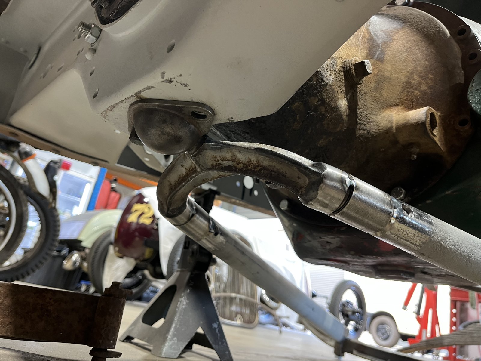

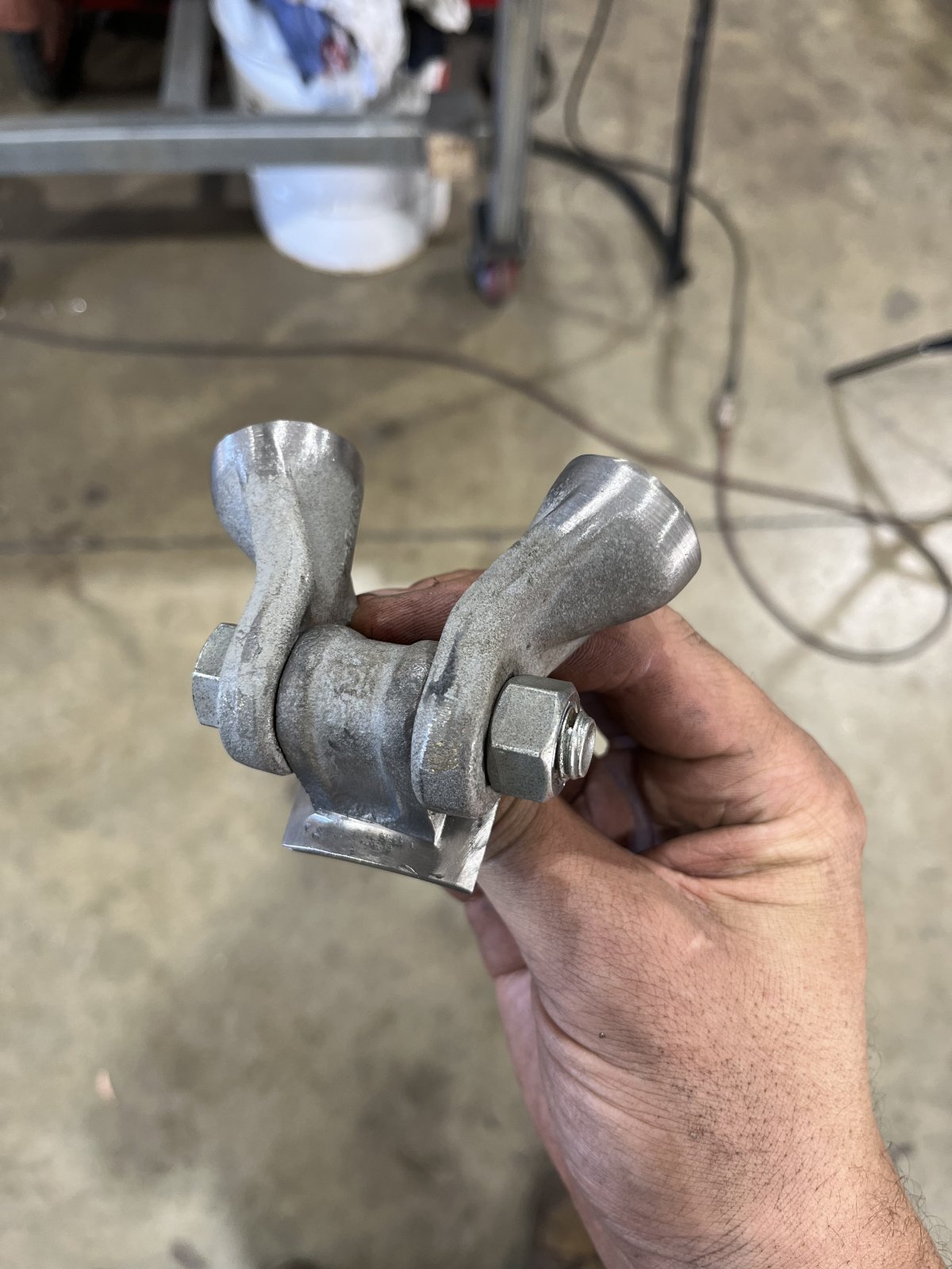

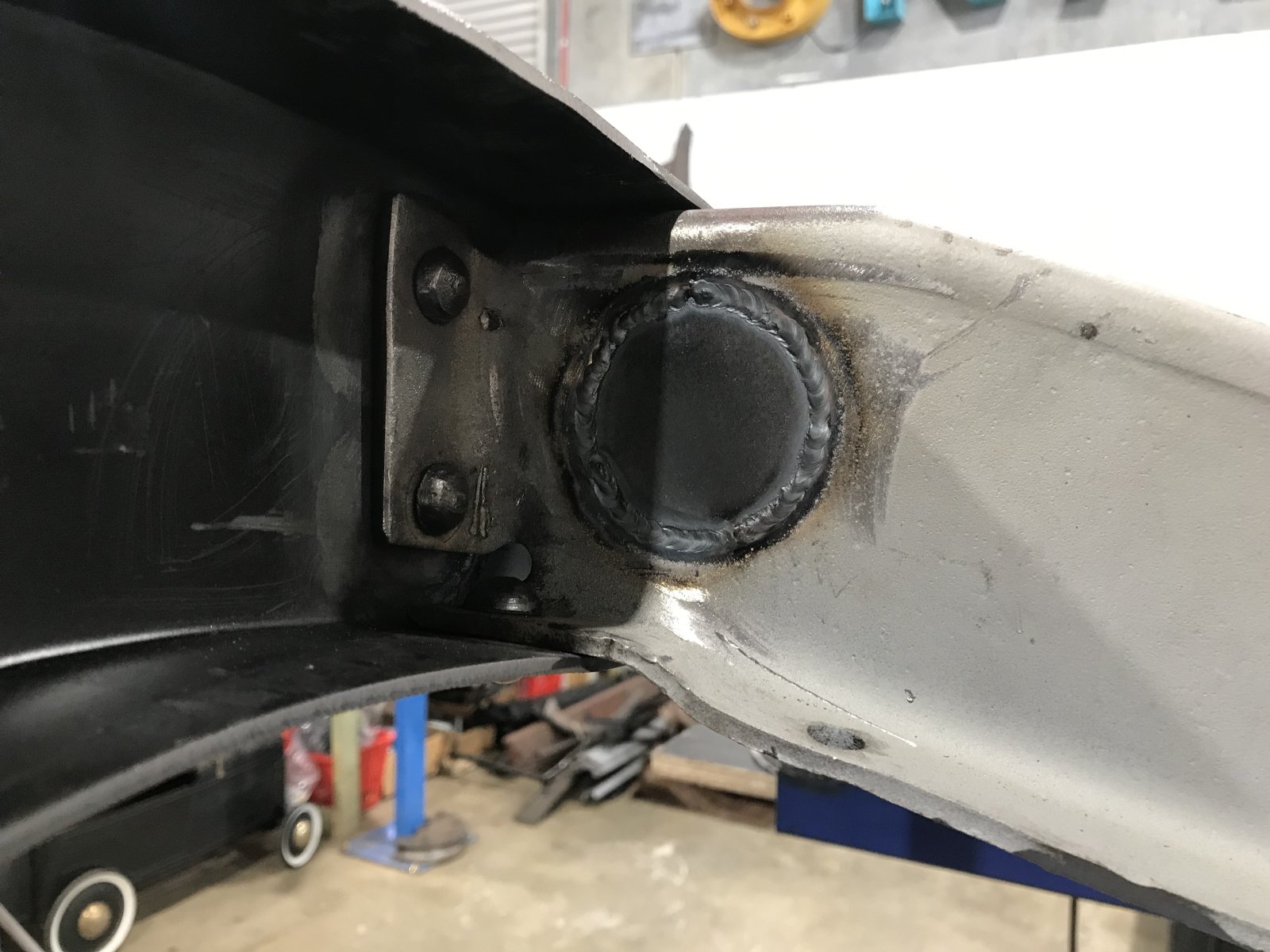

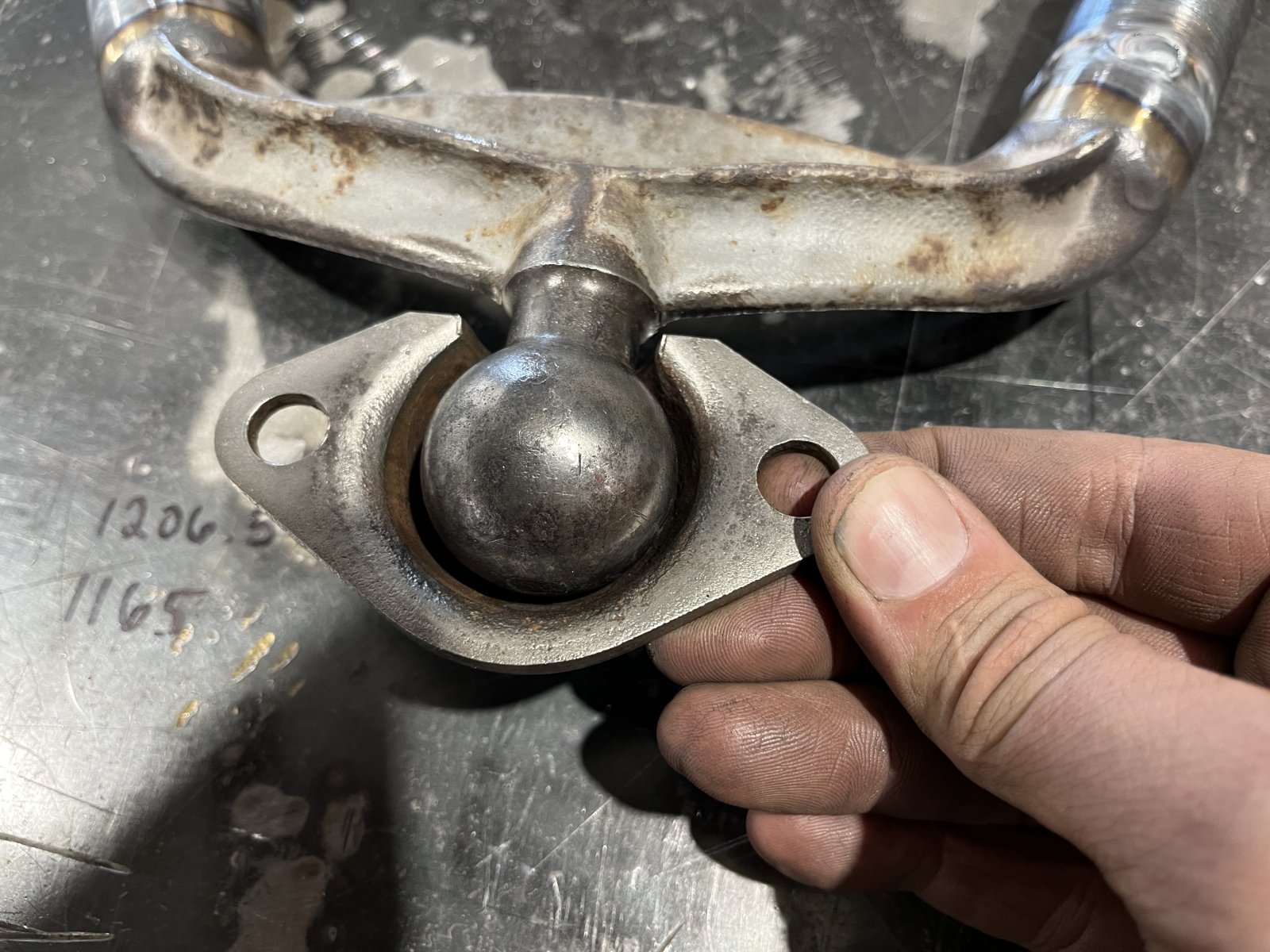

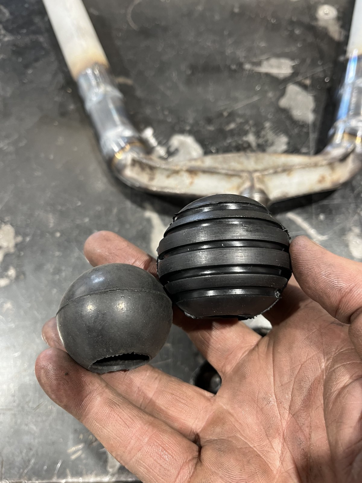

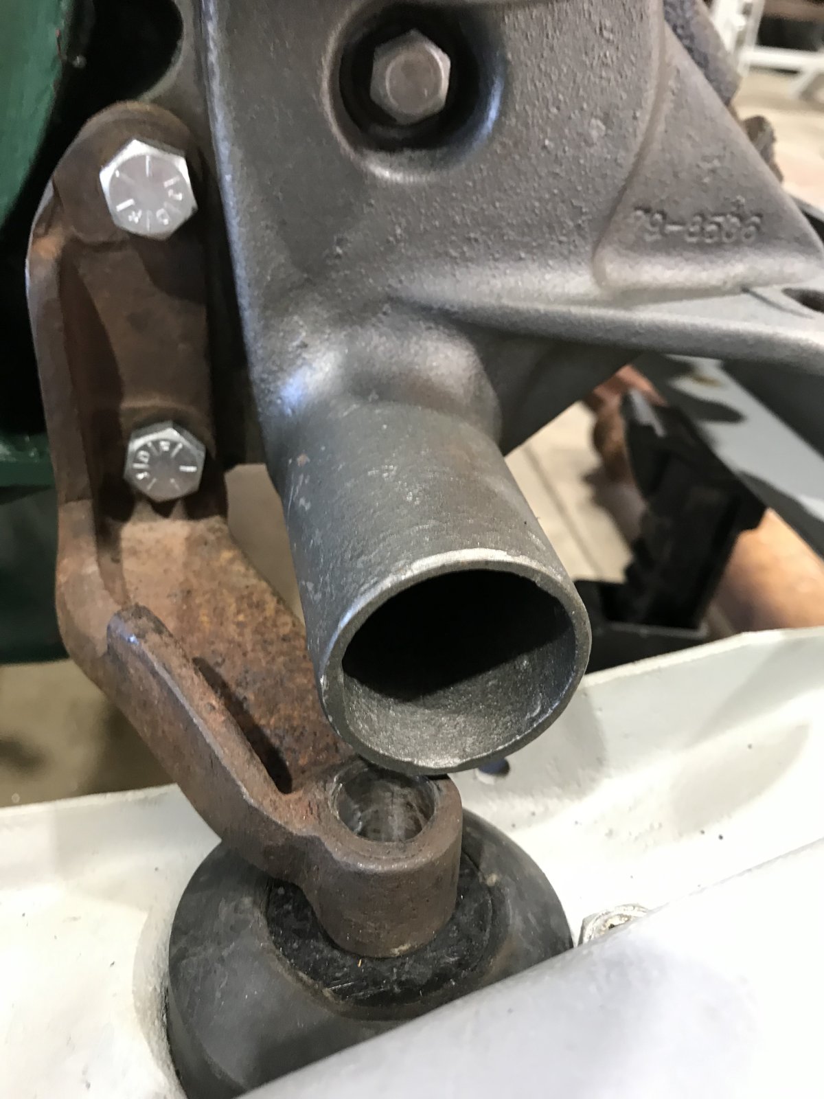

  25. I managed to get the spacers made and welded in. The 36 wish bone with the rear model a mount sits exactly the length of a stock 32. Only issue is the ball fits loose under the k frame, is there another piece im missing or does it just sit with in the crossmember and bottom plate? I have two different size rubbers but I believe the bigger one is for later model?
    9E9E943F-83AB-4FE6-8863-9974712C68EA.jpeg 628C5D2E-1AA0-46B5-A602-3FB61FC2C679.jpeg 9C9B50BC-A21D-4641-BF66-CF2B91E3E016.jpeg 01E87C70-0249-47C2-B850-DB4DD51D5B75.jpeg 41F6AB9F-E253-4548-8BA4-E0C260452B52.jpeg 8FA6C230-D5E8-4D46-9D1D-3C03DF23319B.jpeg 00F5F671-A9EA-45DF-9B8B-B4ADD57400D1.jpeg A1778E9B-F81B-443F-AB1C-821AEFC34228.jpeg 2A02C78E-4FA5-4F00-904C-F8D2B76E5A6A.jpeg 83E4F6E1-367D-4867-B1D4-28F85DD81B8B.jpeg
  26. alchemy
    Posts: 22,674
    alchemy
    The 32 rubber doesn’t fit the A ball?
  27. The smaller rubber (32 one fits loose. When it’s mounted under with the lower cup plate below the bolts bottom out and there’s still slop. If that makes sense using rubber (left) below 69DCCF1C-F87B-4C63-B05C-0A57C8505FD3.jpeg 581544F1-E1C0-49FF-8735-4AC8235DE78C.jpeg

    The rubber ball mount with the grooves is the same as what was on my stepped 46 bones, what ball worked for you ?
